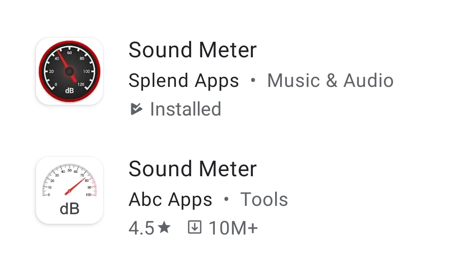

what are the apps names? yeah there are many rubbish ones out there so its disappointing that Niosh app is only on iOS
this noise measuring app by Bosh for android seems to be good. You might still need to calibrate it and sense check it. I think you can sense check it by going into a very silent room and see vs the reference value for what it shoudl be
https://play.google.com/store/apps/details?id=com.bosch.nvh_analysis&showAllReviews=true

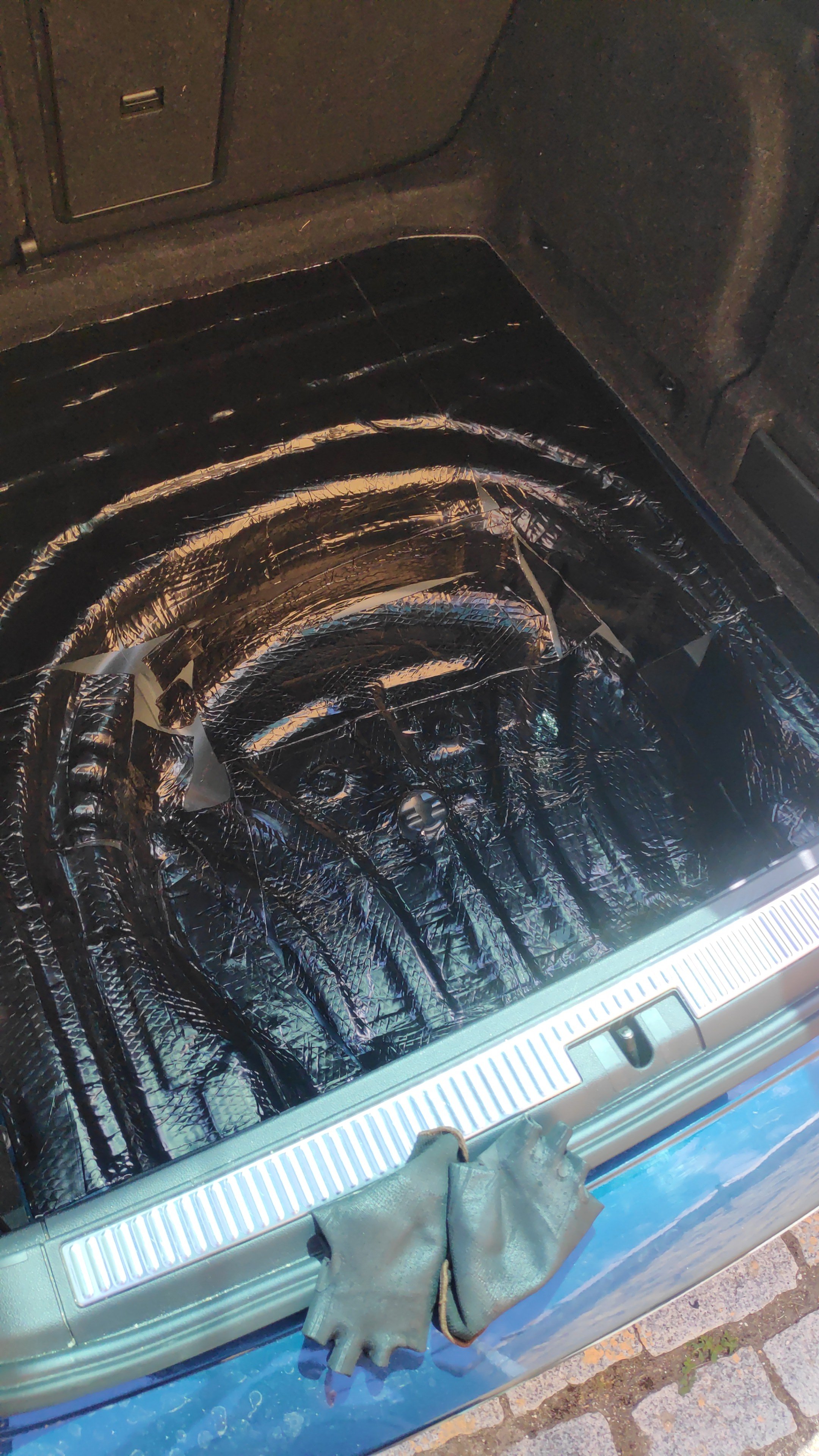

Yeah it’s my third stage now
after doing the boot and the doors.

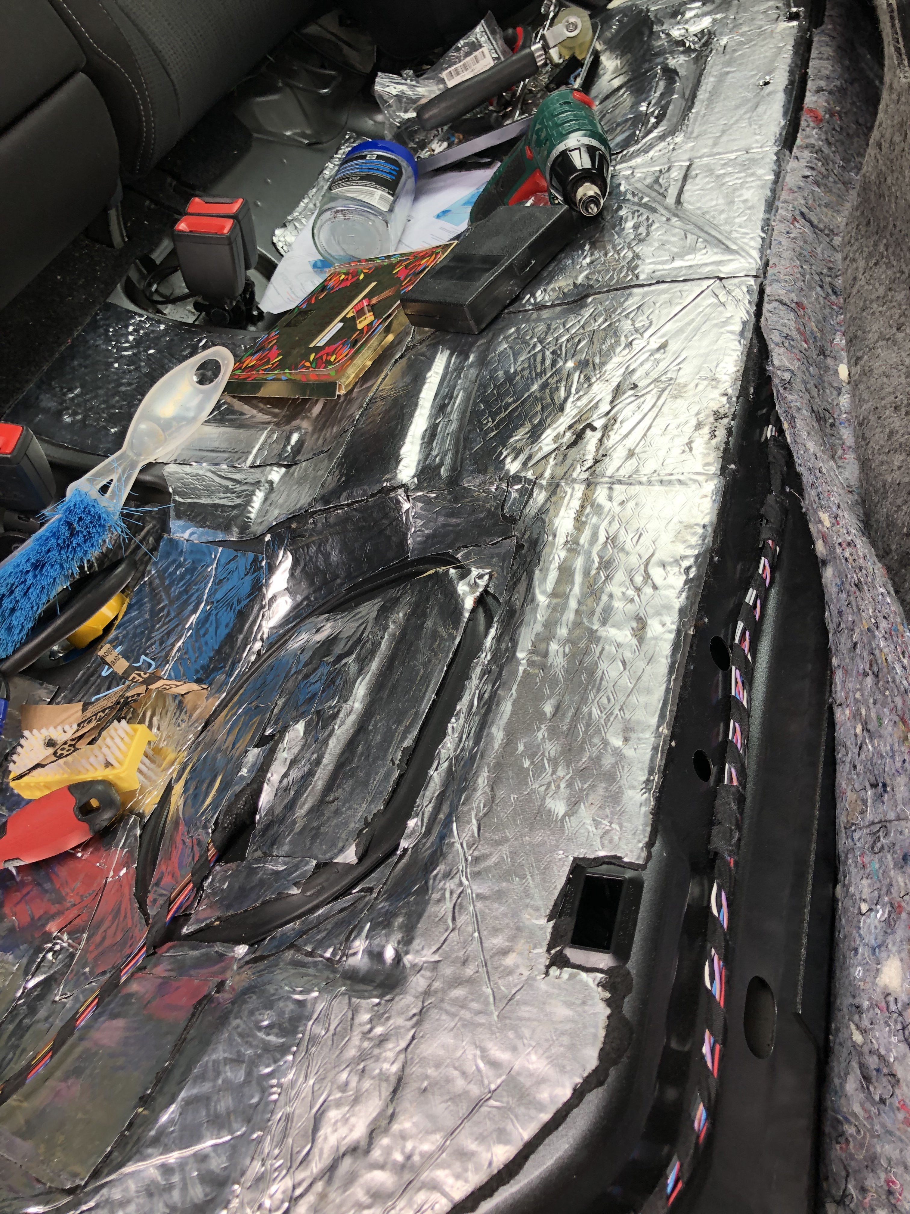

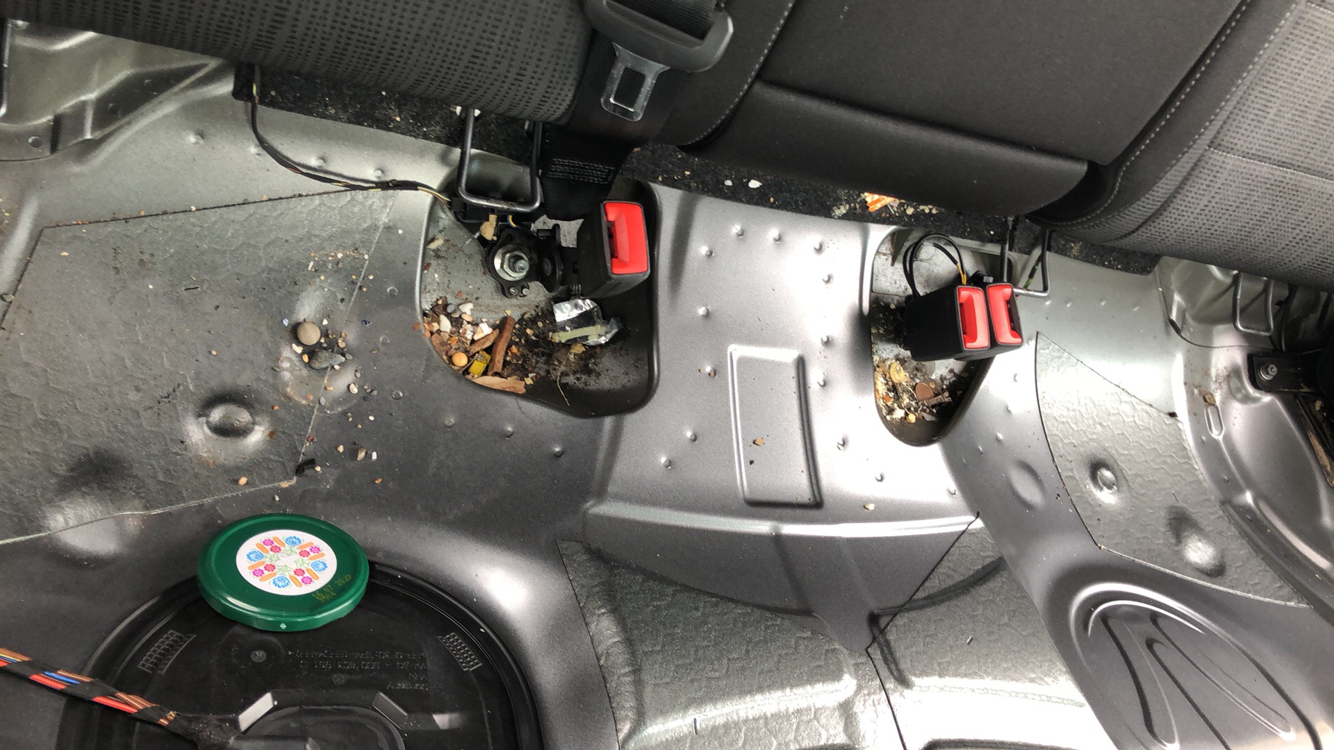

anyway I just started to working under the rear seats without taking the front seats out. The stuff kids leave underneath…
Also what should I do with those few openings I see in the metal sheets. e.g. under the seats. I see no obvious purpose for them but they there. With the antivibration tiles I can just leave them open but will be laying the MLV now and my understanding is I should aim to close any opening as the airborne sound will get through them. any one have an idea?

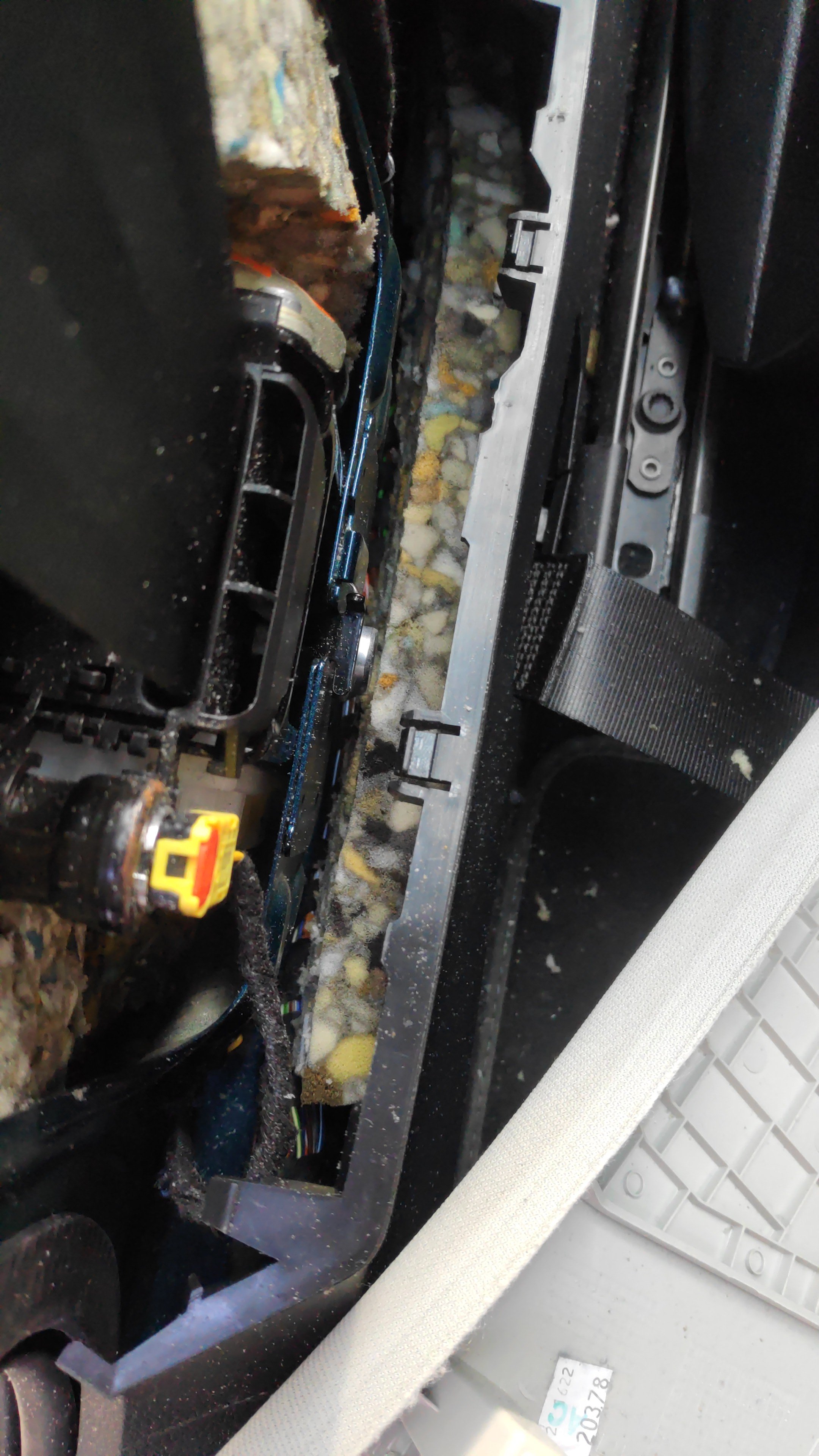

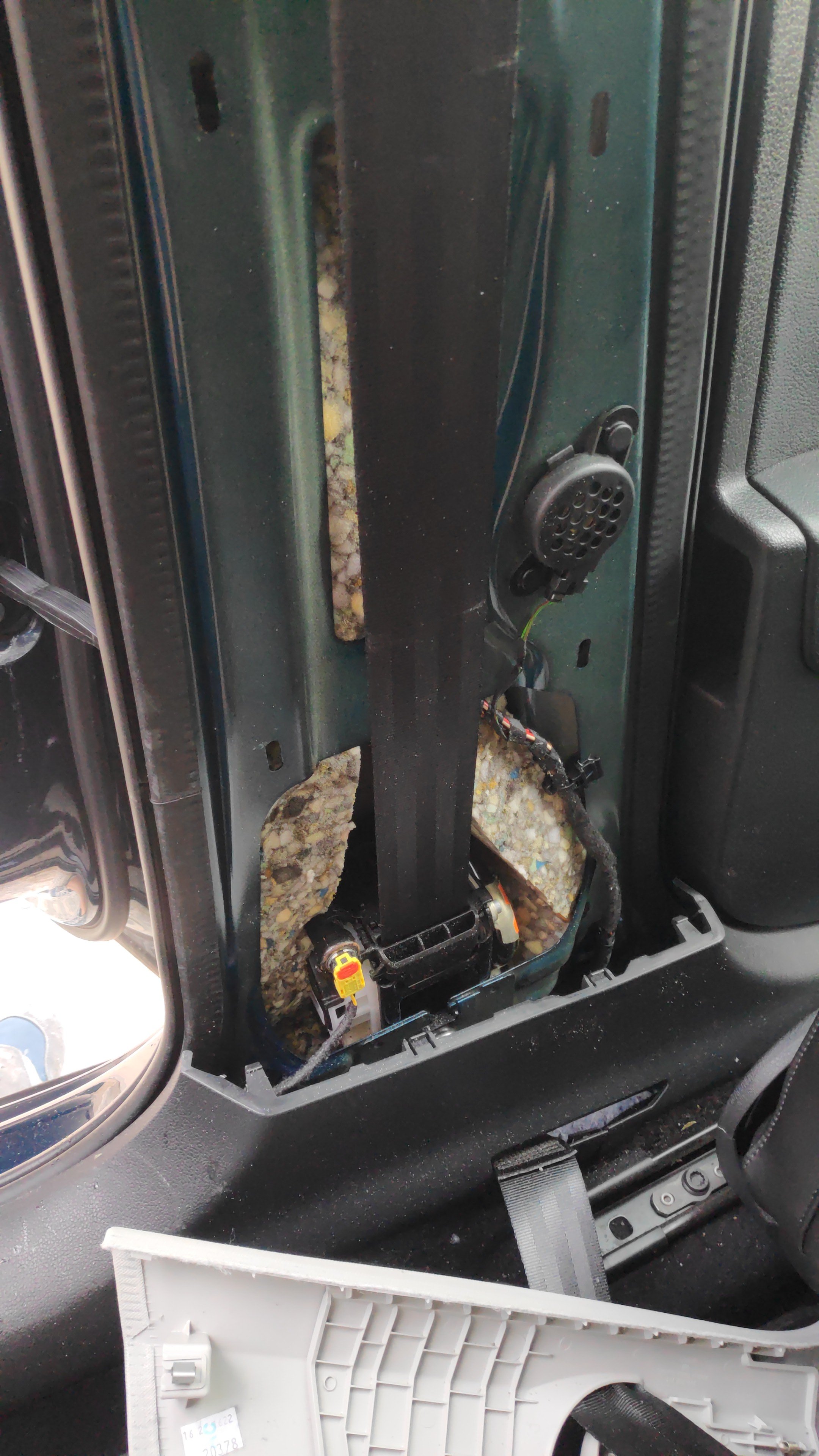

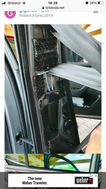

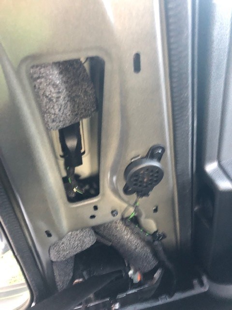

I just did the B-pillar on the driver's side.  I have stuffed high density foam up to the top of the belt.  I have not noticed a difference.  I have broken a metal staple and now the height adapter will not raise or lower.
I have ordered 14mm staples which I think are but you may not buy in a store tomorrow.
By the way, the screw cannot be dropped all the way down because the shape of the housing prevents it.
 Disappointed.  I'm going to do the trunk.
maybe I should have put noico butyl ??

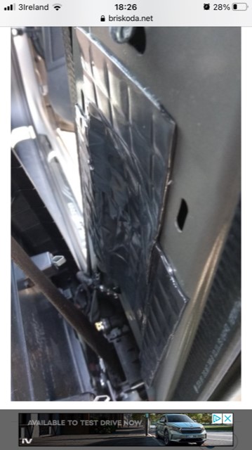

hey gabriel yes you should have stuck some noico on the metal parts, especially on the ouside of the metal outside. While it's good you put some on the plastic part from the inside it's the metal that is the main source of vibrations.
You seat regulator most likely doesn't move because you haven't aligned it whet re-assembling. When putting the cover back you need to make sure that your seat belt is set to it's highest position. Therefore open the thing again / take out the panels, and first check if you can change the seat belt height now. Most likely you can and if this is the case you only need to align the things for it to work properly

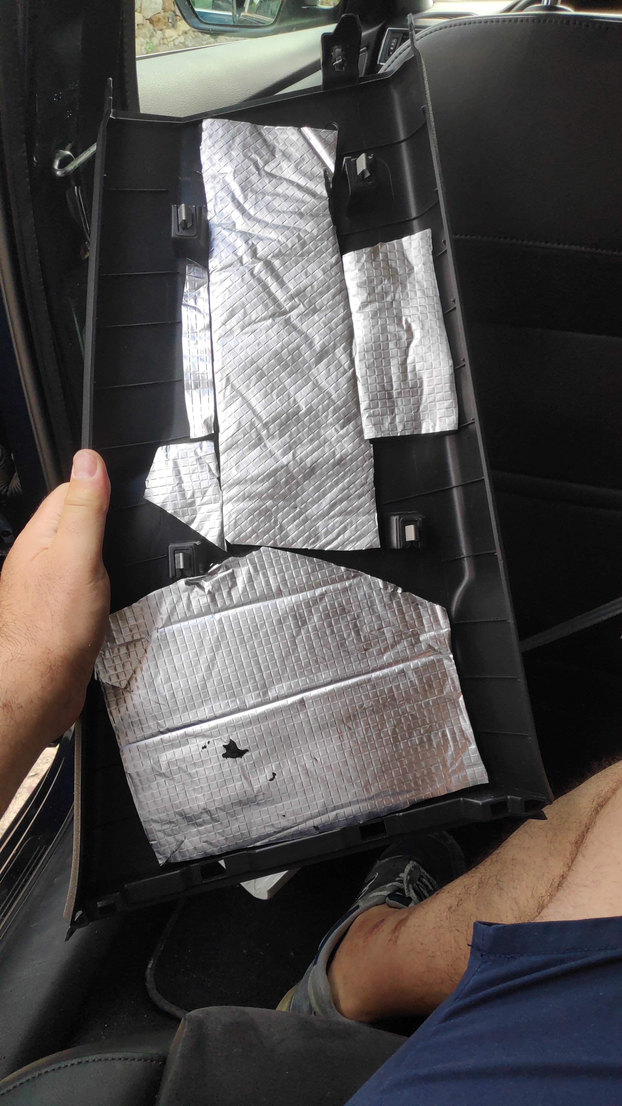

And add noico to the metal. please see what I did. I am using close foam carpet underlay (4mm) to stuff things. I put everywhere I could withouth preventing the belt to work properly. BTW you can't put too much stuff inside the plastic panel as it will start rubbing against the seat
please see my pics below. The first one shows the carpet underlay before it is properly stuck inside. Put as much stuff as you can but keep separate from the belt mechanism.
the B panels made a big difference in audible noise coming from the around my head.

Yes the blanket is there. Still the sits, especially the vertical part near the legs, are very resonant.
as for the holes I was referring to the round holes with no obvious purpose. there are no clips going through them so I cannot figure 100% out there purpose. These could be to provide some sort of access or to the other layer of the car or ventilation? but most likely there are there to reduce weight. There are such holes throughout the chassis and this was the most like explanation I found on the internet - weight reduction

BTW the improvement in noise after doing the boot, b pillars and doors is actually large. My wife and I finally don't find the car annoyingly loud, we can hear our conversations and other noises in the car with clarity. It was defo worth the effort. After doing the floor I'll see if I can still hear too much low hum from the road and tyres. If that is the case I'll do back wheel arches from the outside but for this I'll need to order more noice

That’s the holes I mean, on the vertical side where I haven't put butyl yet

Yeah that was my experience too. Once you do the boot and B-pillar it really takes the noise (on coarse chip roads) down from headache inducing and annoying to noticable but reasonable.
My main observation before I started was all the noise was behind my head. The B-pillar is a silly design...funneling sound from the sills right up to your head level.

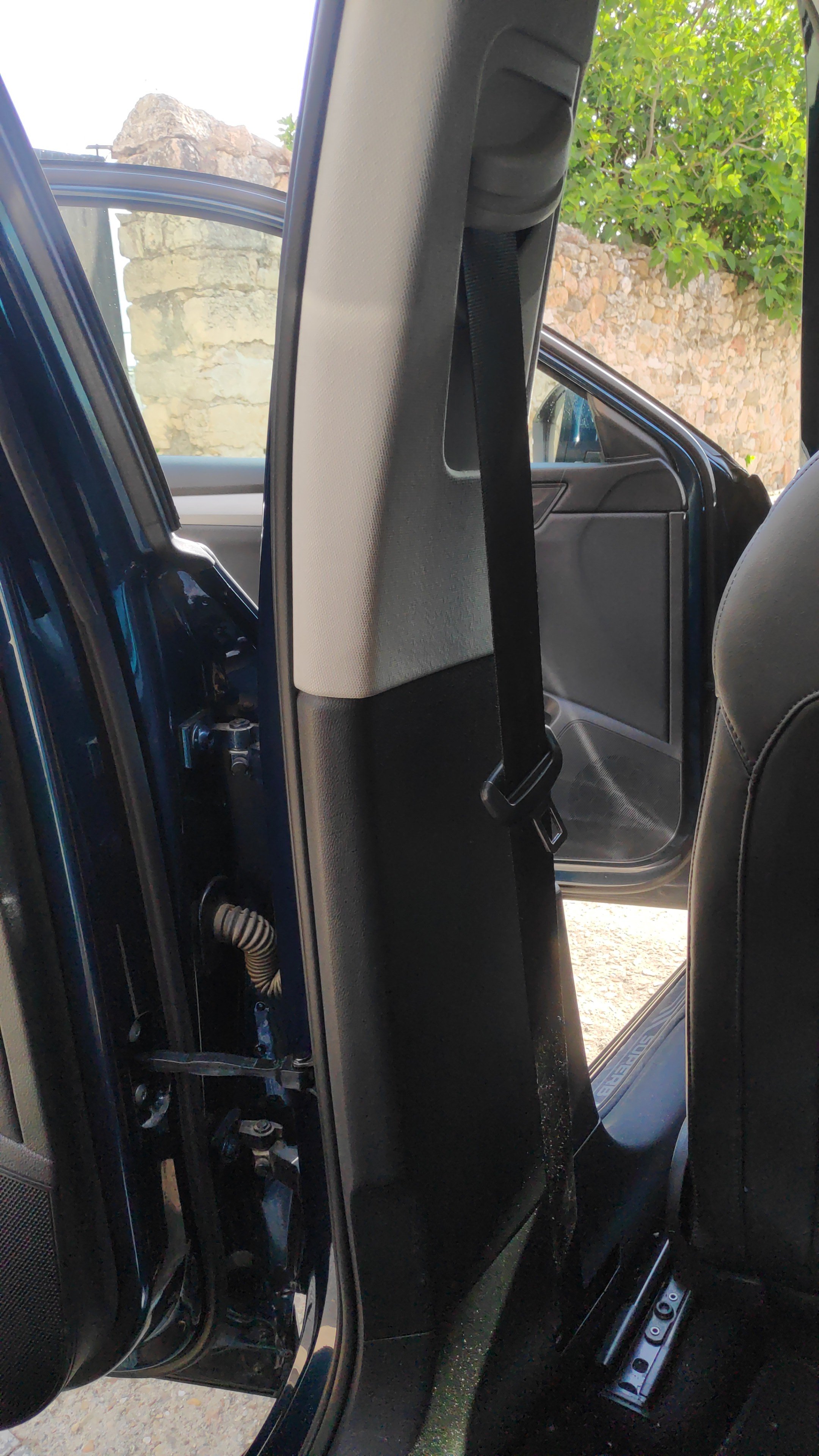

don't forget the b pillar. While you will need to open one plug, unscrew one screw, and pull out two small panels it will be a much quicker job than the boot and the effect is well worth it.

Honestly, I am quite disappointed.  I did the trunk and I notice some improvement but nothing great ... I will make the B-pillar better but I begin to question its effectiveness.  Where if I notice a lot of noise is the exterior rear view mirrors.  Has anyone done something with them?
