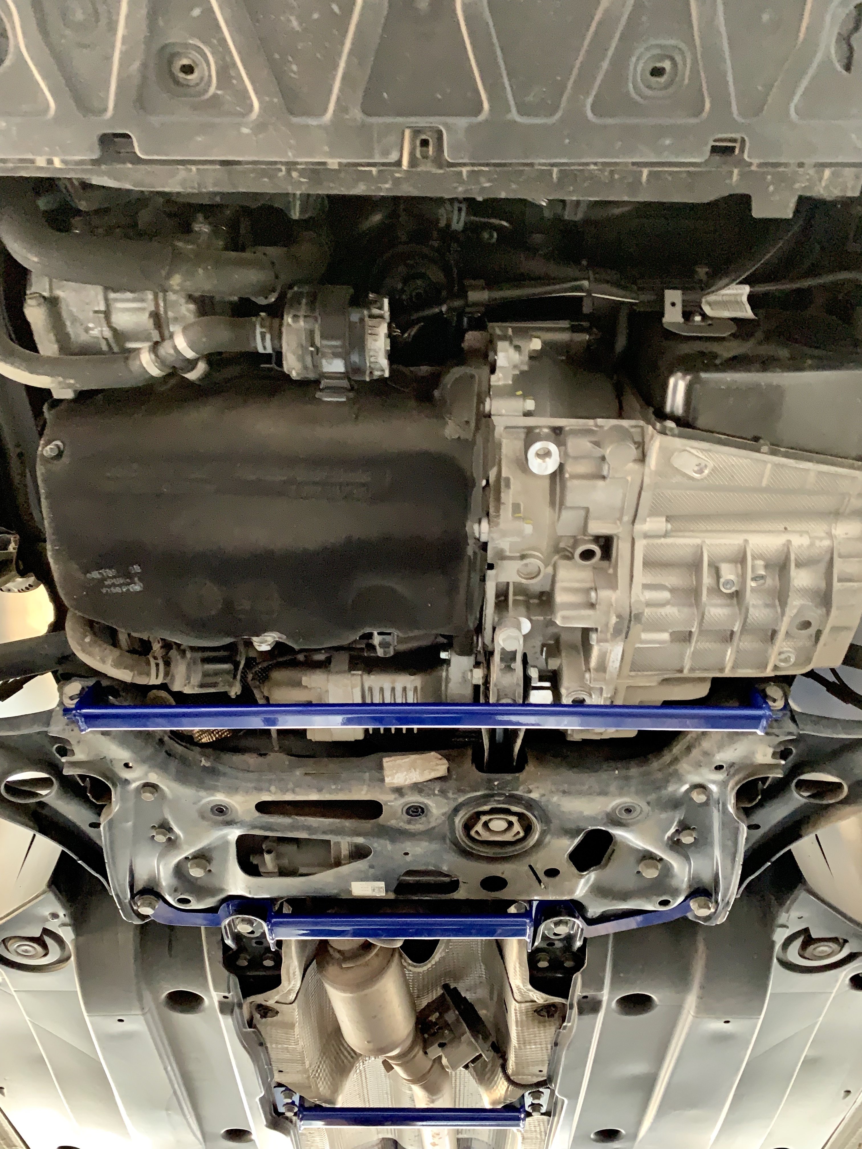

The big difference to what others seem to have done, and I'm looking for some feedback on this, is I'm looking at doing something to the engine skid pan. This thing appears to be quite flimsy and I'm convinced that there is a drum effect taking place in the engine bay as result. I'm going to try a liquid rubber spray on the engine side, given the exposure of the panel to the elements.

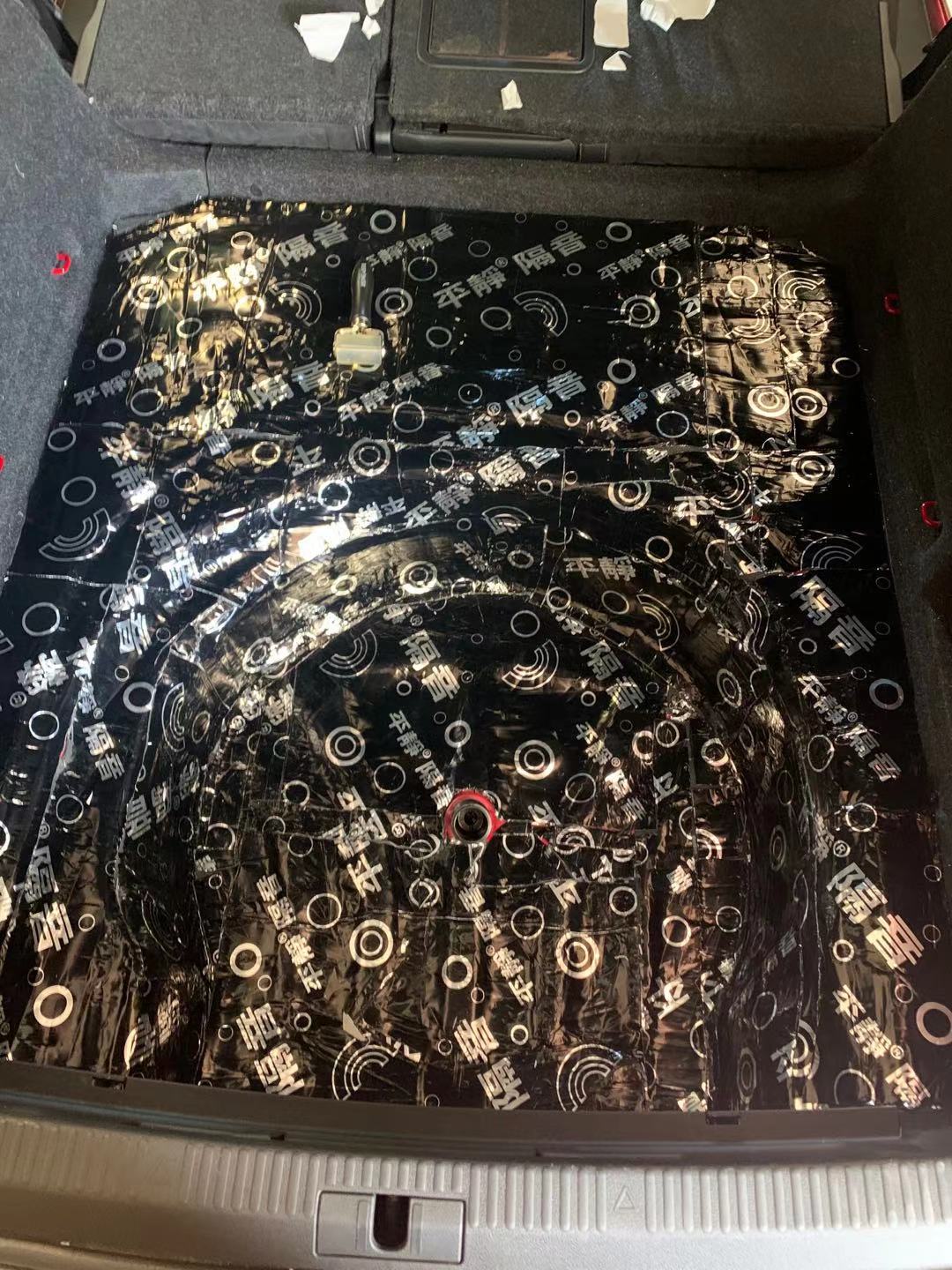

  • Wheel well noise, I'm told is a significant contributor overall so with this in mind I decided to try out the rears first.   Having recently been camping and totally filling the boot space to the roof

So, I’ve now done the boot, bonnet, wheel arches front and rear, engine skid pan and both underbody protection panels. I used 2mm butyl/aluminium sheeting (9kg, 2sqm) and rubber bitumen paint. +some EVA mat under the rear seat.

The function of the butyl mats is not to decouple. Its to damp, and so needs to be bonded to the metal surfaces. It's the same principle as putting your hand on a drum skin and hitting it vs hitting it with no hand.
