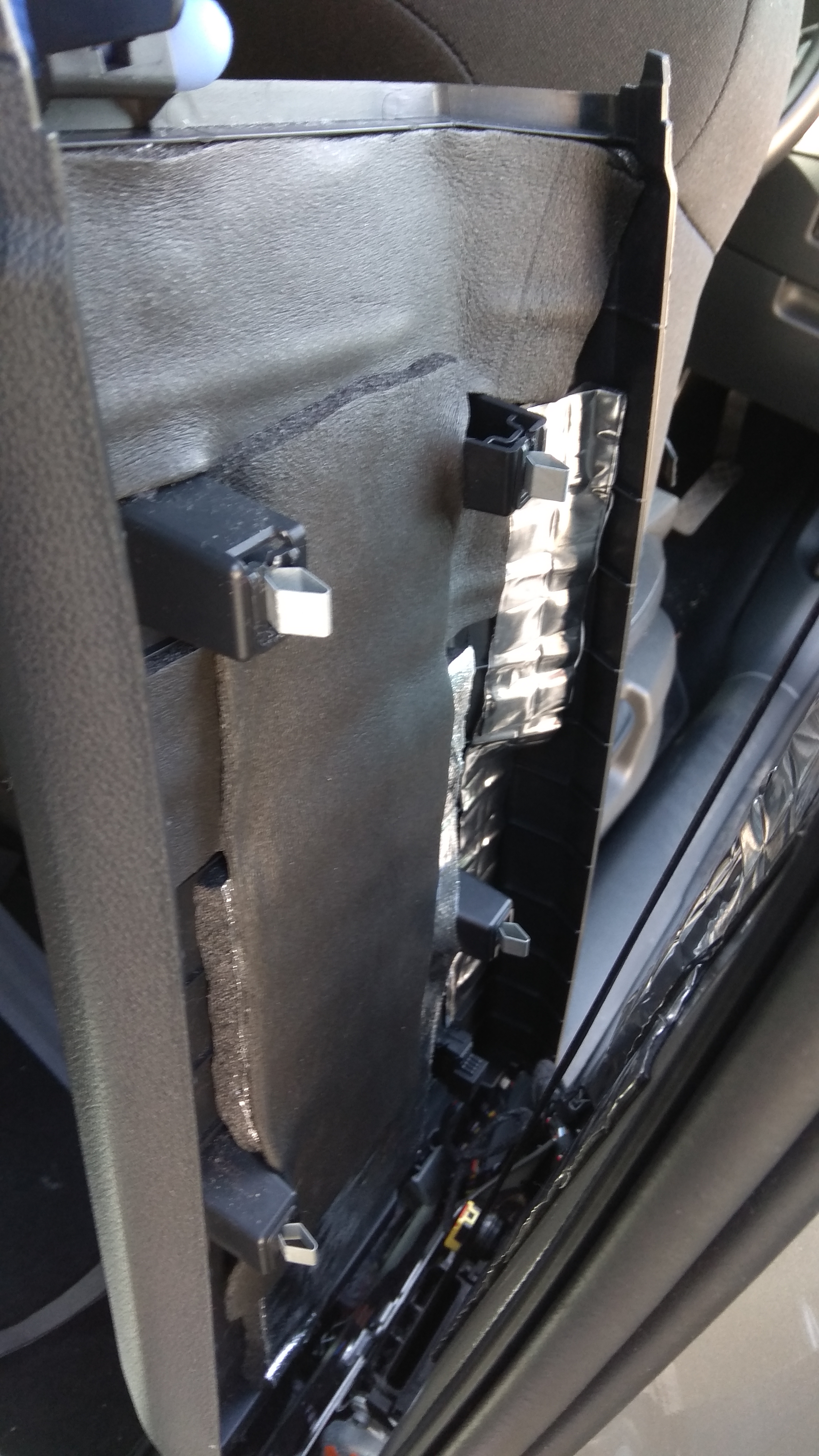

This is what I did with mine.
Really important to fill the voids where the B pillar meets the cill with closed cell foam. We have two Superbs in the family and my wife's has the noticeably more noise at ear level than mine after sound proofing.

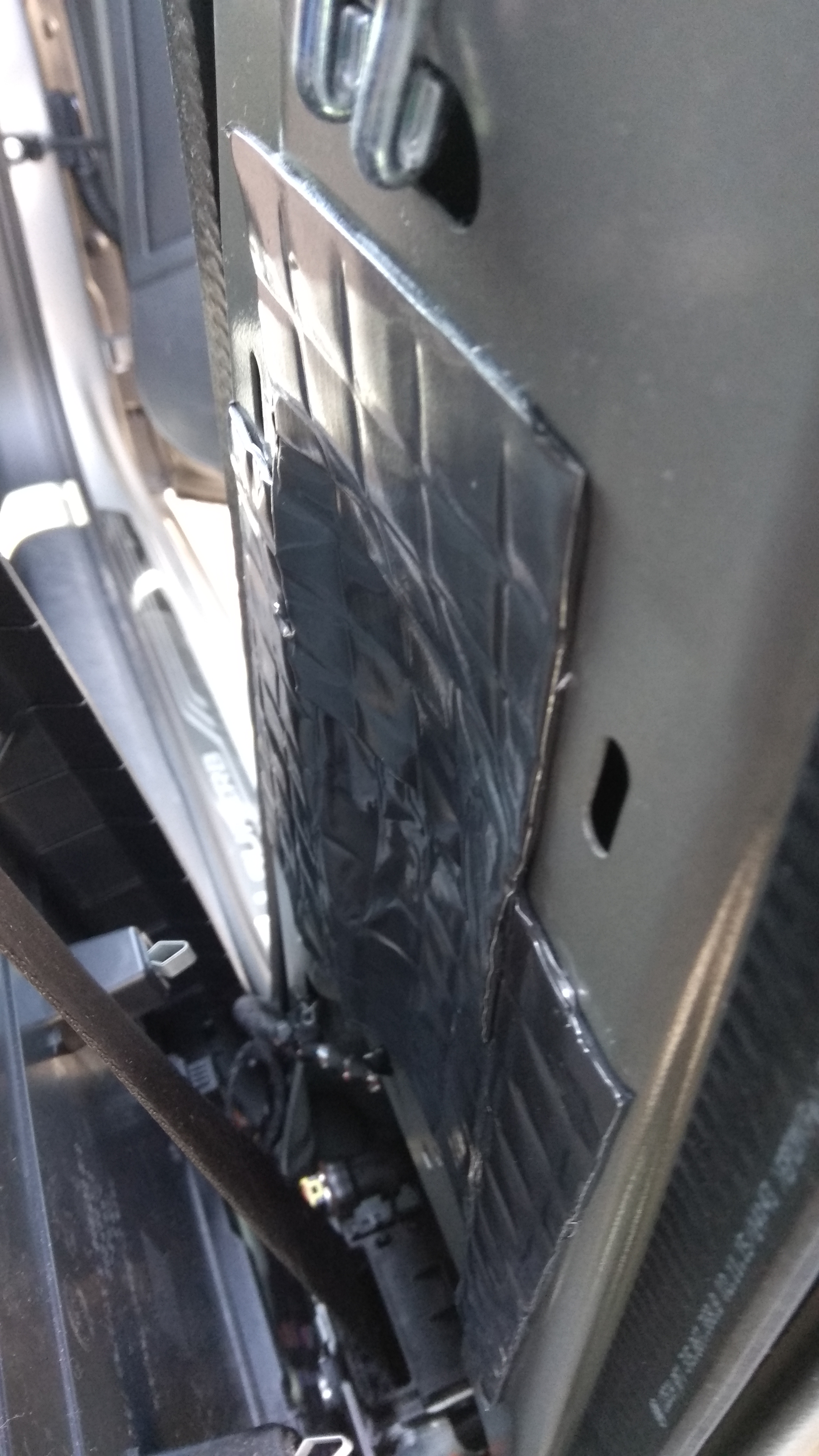

I already did the boot, the B pillars and the two front doors over the weekend. I put Noico on the resonant panels and in the cavities I stuffed rolled carpet underlay with bags of rolled mineral cotton. The B Pillars are very easy and a very low hanging fruit.  For the boot I uncovered the trim up to the rear wheel arches so it was a fair amount of work learning how to take everything out, a lot of surface to cover with butyl and to put it all back. There is really a lot to cover behind the trim, many flat thin metal panels.
The doors are on the harder side for a first timer with all the clips and connector.
After all this work I do hear a difference, the car isn't annoyingly loud anymore and I can much less hear the noise from the side, like the passing cars. Also conversation is now much easier.

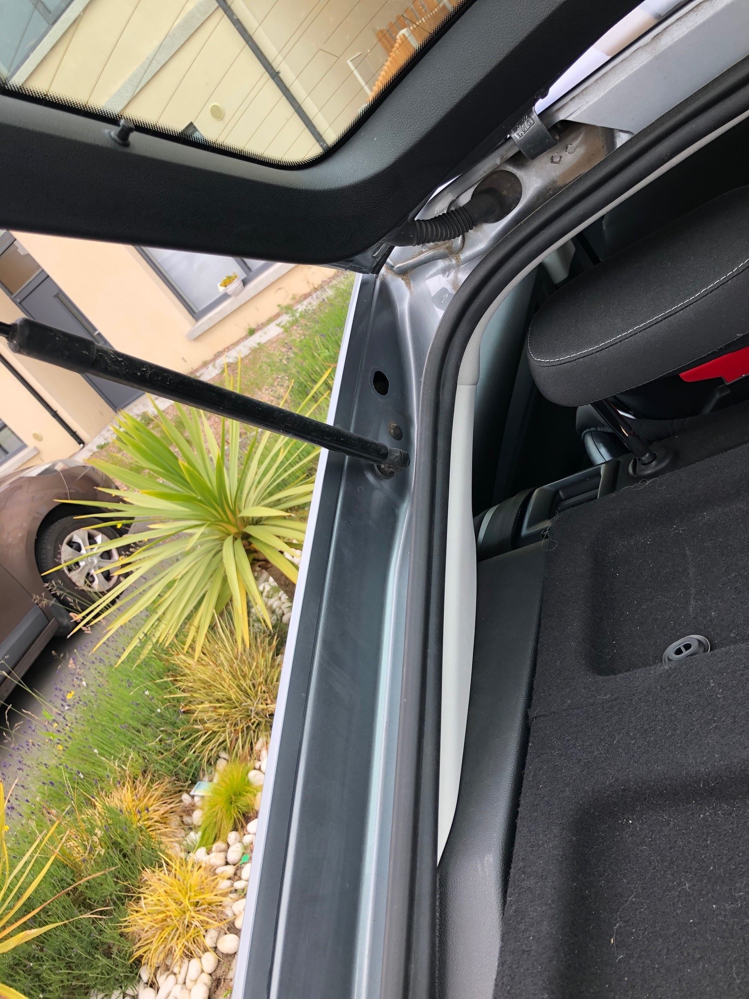

Also has anyone filled the cavity in the pillars C right under the tail gait? It seems entirely empty, at least on top,  is very resonant and there are small rubber plugs covering an entry to it.
Do I risk much by spraying self expanding foam into it? Would anyone know how the rear lights cabling is laid? I'd think it would be at the same level as the lights.
Pic of  hole leading to it below
