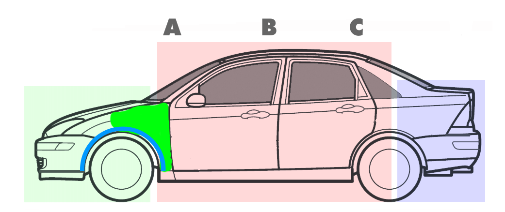

I also damped 1/2 the front fender (bright green) as I notice they stuffed some noise reducing baffle (large shaped and closed foam block) where the fender meets the door, and the outside of the liner (blue) about 90% of the area. I will take pictures when I do the passenger side.
After tapping the metal of the wheel-well fire-wall, it seems quite stiff and damped. I put some patches there but the main thing was the outside of the wheel liner and the fender. FWIW there was Wax spray everywhere in places, precluding buytl sticking. So I ignored those.

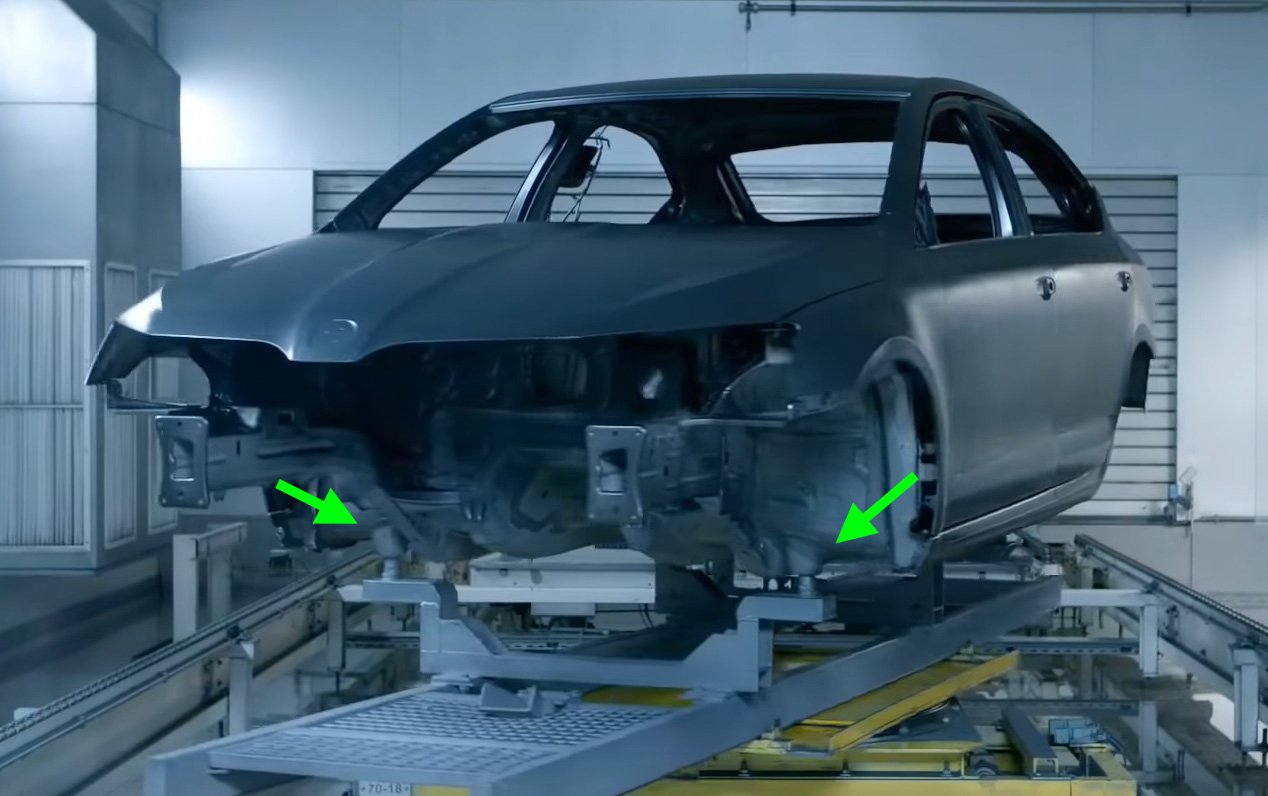

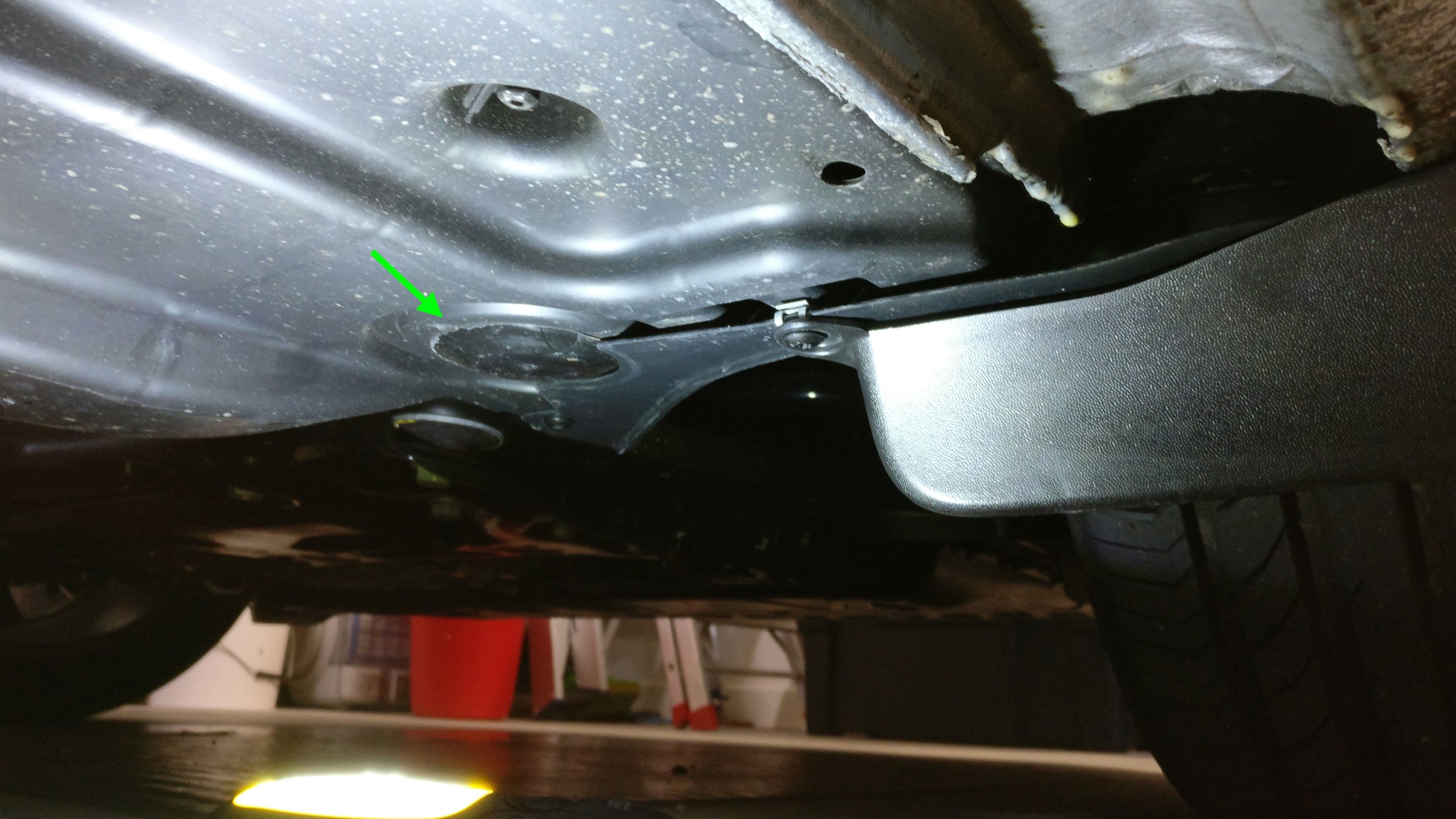

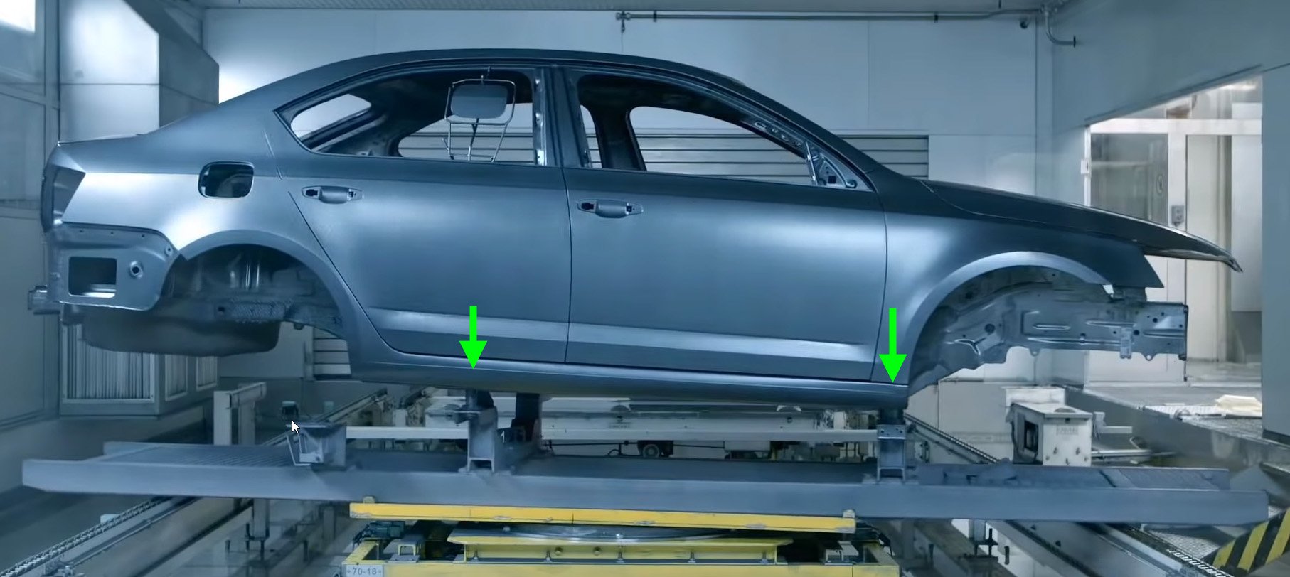

BTW once I had disassembled the liner, I found the factory jack points they hold the car with while making it. This picture is from the Superb III
The front one is under this plastic plug. Useful to know, Good place for Jack Stands.

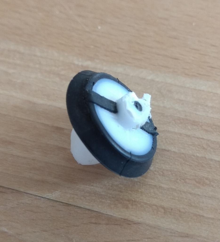

I know re the clips, I should have had some before starting.  The loss of one clip has not made any difference but if I was doing any more doors I would certainly have a few replacements on hand.

Yes. I have been looking for referred noise. For example the sills are quite 'ringy' and tubes, and feed into the B pillars. Which is why I matted the B pillar trim and stuffed some acoustic foam tiles up into the top of the B. I am also planning to stuff some into the sills which seem accessible from the lower B.
Basically looking for places where external noise can make its way into the cabin via conduction. I think I have reached the point where I need to replace the tyres tho to have any more significant benefits. I may ask my local friendly mechanic to put it on a hoist and see what's under the floor (hidden by plastic covers atm and my car on stands too low to take them off comfortably. May have tried it at 18 but wiser now :) ) .

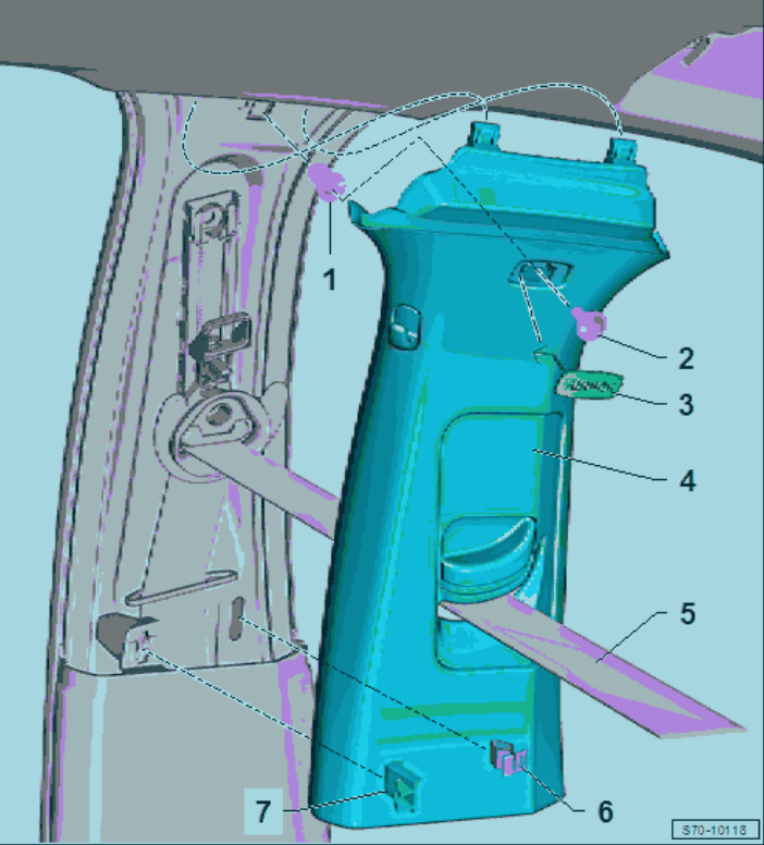

 Would love to know the procedure from removing B Pillar trim?  Sounds like a good one to tackle.
Here you go... (advice not the actual procedure ;) )
1. Move the front seats all the way forward and go sit in the back.
2. Prise out the AIRBAG badge (you will need a thin spudger tool). Push it all the way in behind the badge. The clips are on the left and right sides of the badge (on my 2018 Nov build anyhow). So go in, in the middle.
3. Use a magnetized torx tool to remove the screw behind the badge. Its about 5 cm back there. Use a magnetized tool, or a blob of blu-tak Because if you drop it, you won't see where it goes as it falls down to the bottom of the B pillar and you will be fishing for it in the sill area after removing the rest of the trim :)
4. Start with the lower edge, get your fingers in behind the  trim and pull sharply to un-clip it. Then pull it out and the bottom and down.
5. Start at the top of the lower section and pull level with the next row of clips and finally the lower ones
6. When working in this area, I put matting on the interior metal and the back of the lower trim. I then stuffed high density foam up into the top of the B pillar through the upper hole.
What I was trying to fix here, was any vibrations and sound tracking up from the sills into the B pillar.
TIP: To make working around the seat belt easier, I pulled out 75% of the belt from the tensioner and used a bulldog clip to stop it retracting to give me slack.

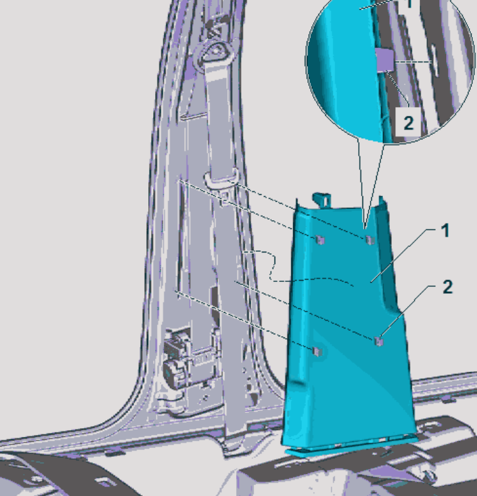

Were you able to remove and install both upper and lower B pillar trims without removing the long trim covering front and rear door sills?
I never disconnected the lower B pillar trim from the sill trim, They were clipped together, but the lower sill trim is not actually clipped to the bodywork again until about 40-50 cm either side of the B pillar (I think) and so the whole lower trim just swings away from the B pillar.
Installation then is just swinging it back into place and engaging the clips. Then doing the upper trim.
You can reach all the way to the bottom of the B pillar trim without issues.
