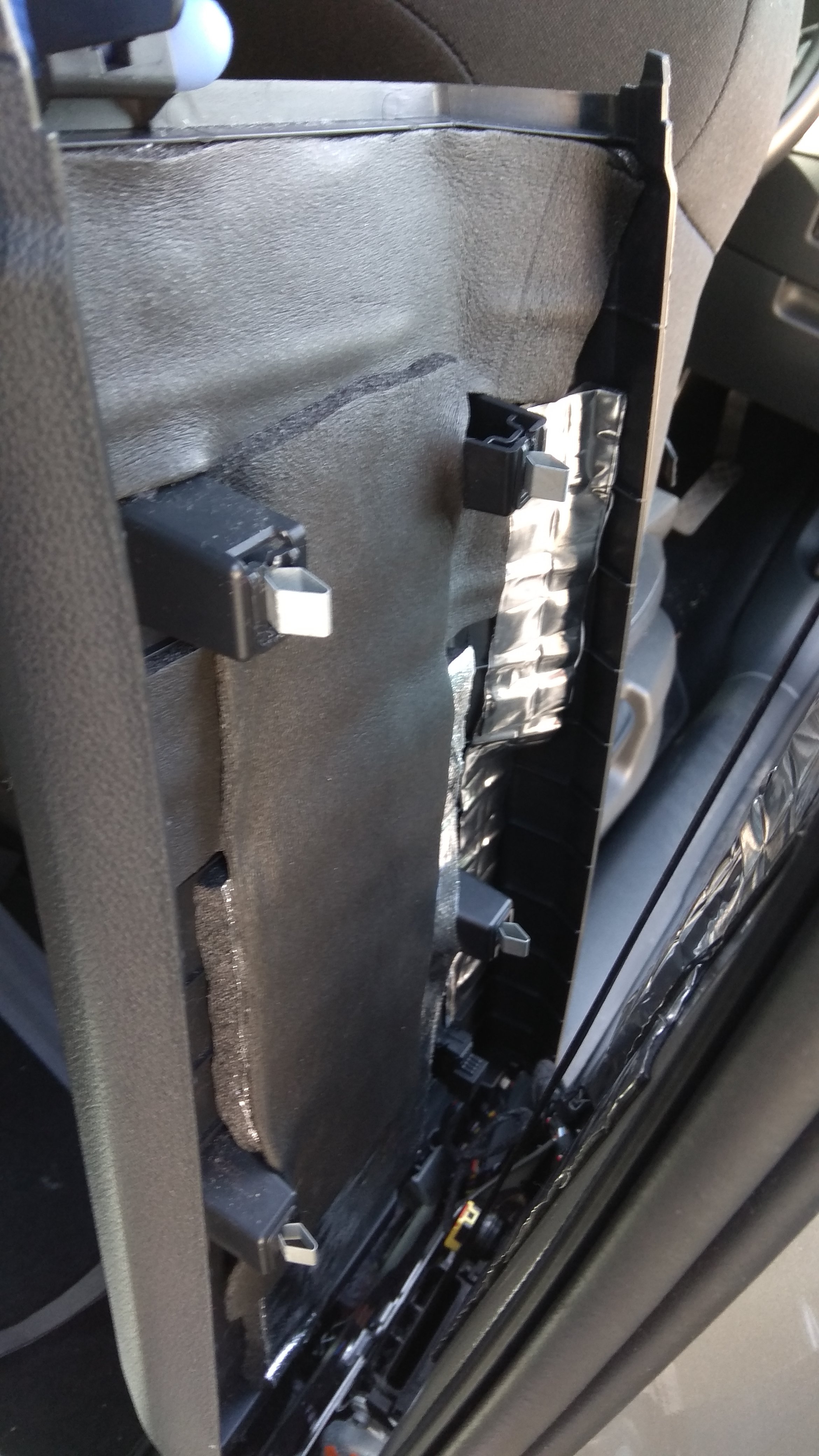

Just silent coat. There is not enough room between the seat-belt mechanism and trim for comfort. I was concerned about binding, although not hard to fix. But because this is my wife's car.... you don't want to cause problems! Just fix them :)
I do recommend finding some high density foam for the sills and B pillar cavity. Head down to your local rubber-shop and grab some 5 cm thick seat padding. Something you can scrunch up and stuff
This both damps/braces the metal around it and also absorbs internal sound bouncing around. Tap the sills mid-door and you will know what I mean.
Also rap the B pillar trim with a knuckle before you start, you will also see how cavernous it is in there.

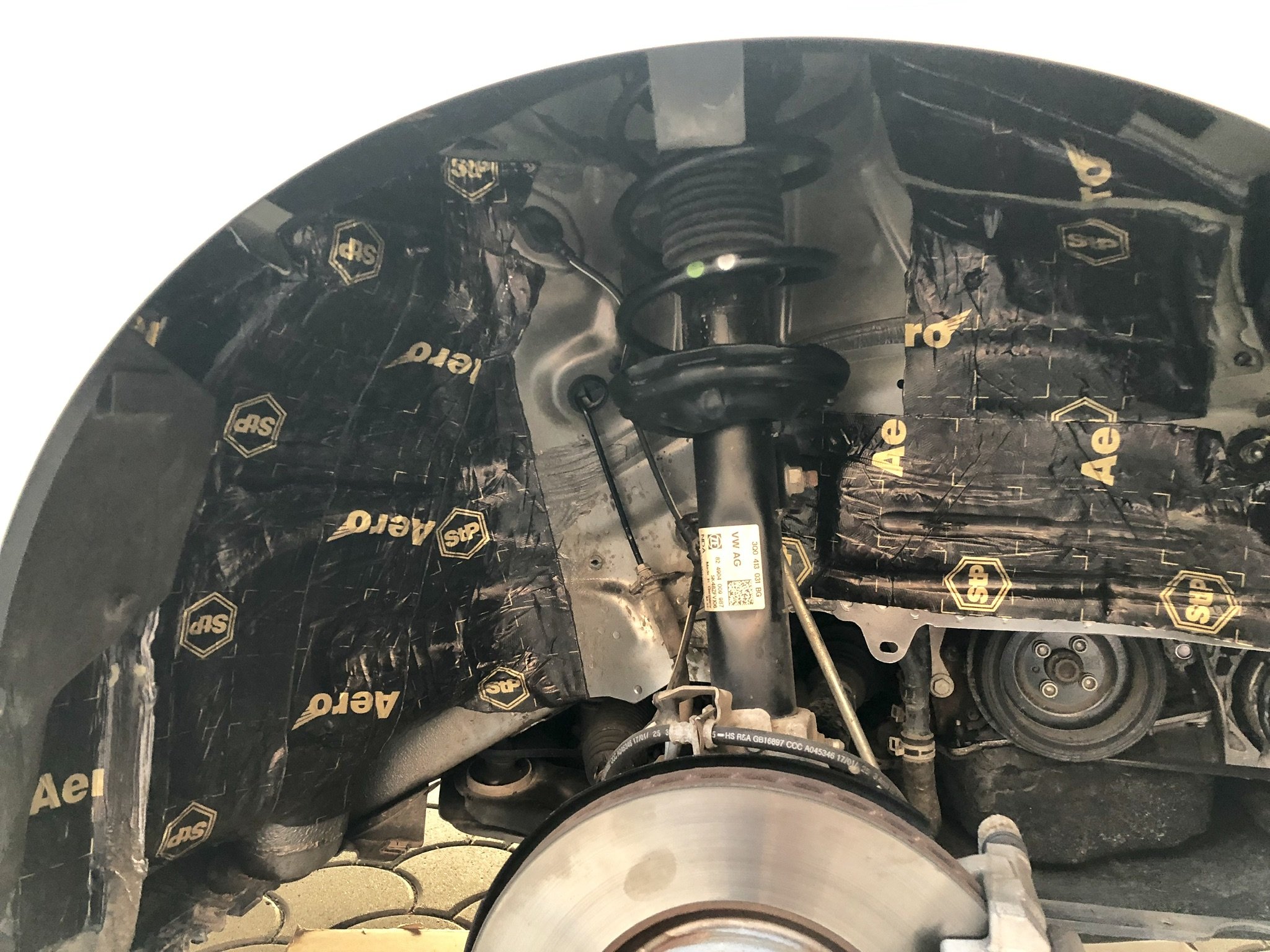

  • Wheel well noise, I'm told is a significant contributor overall so with this in mind I decided to try out the rears first.   Having recently been camping and totally filling the boot space to the roof

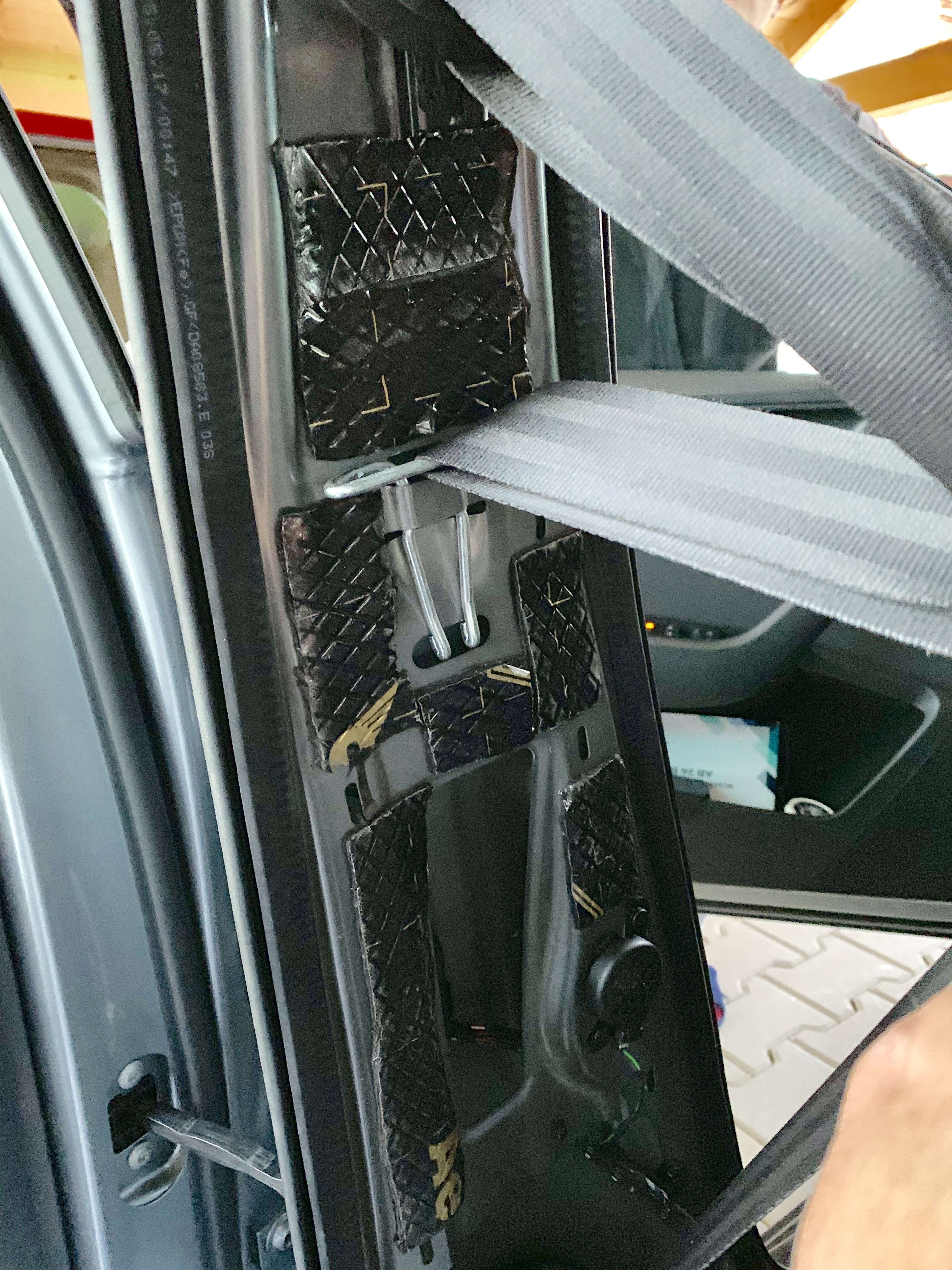

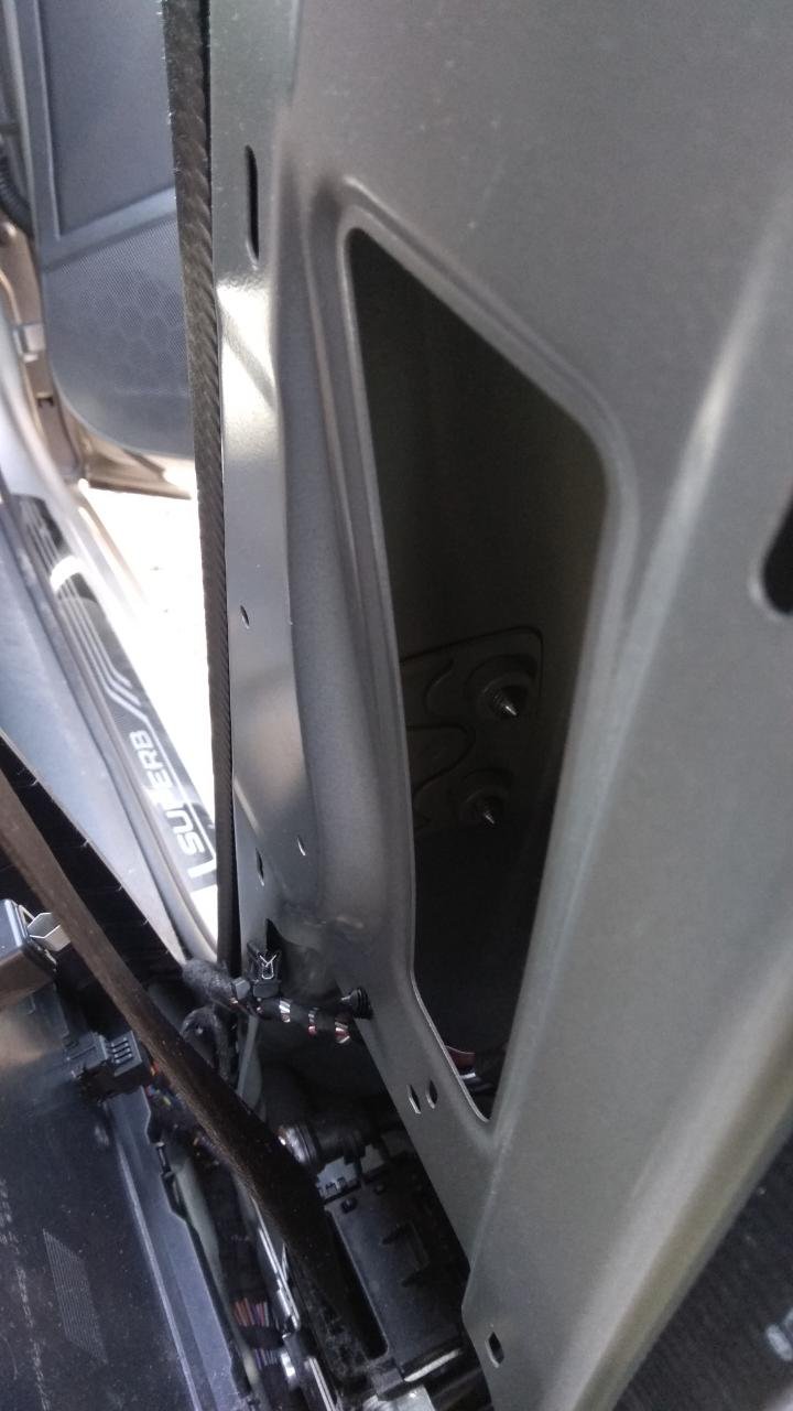

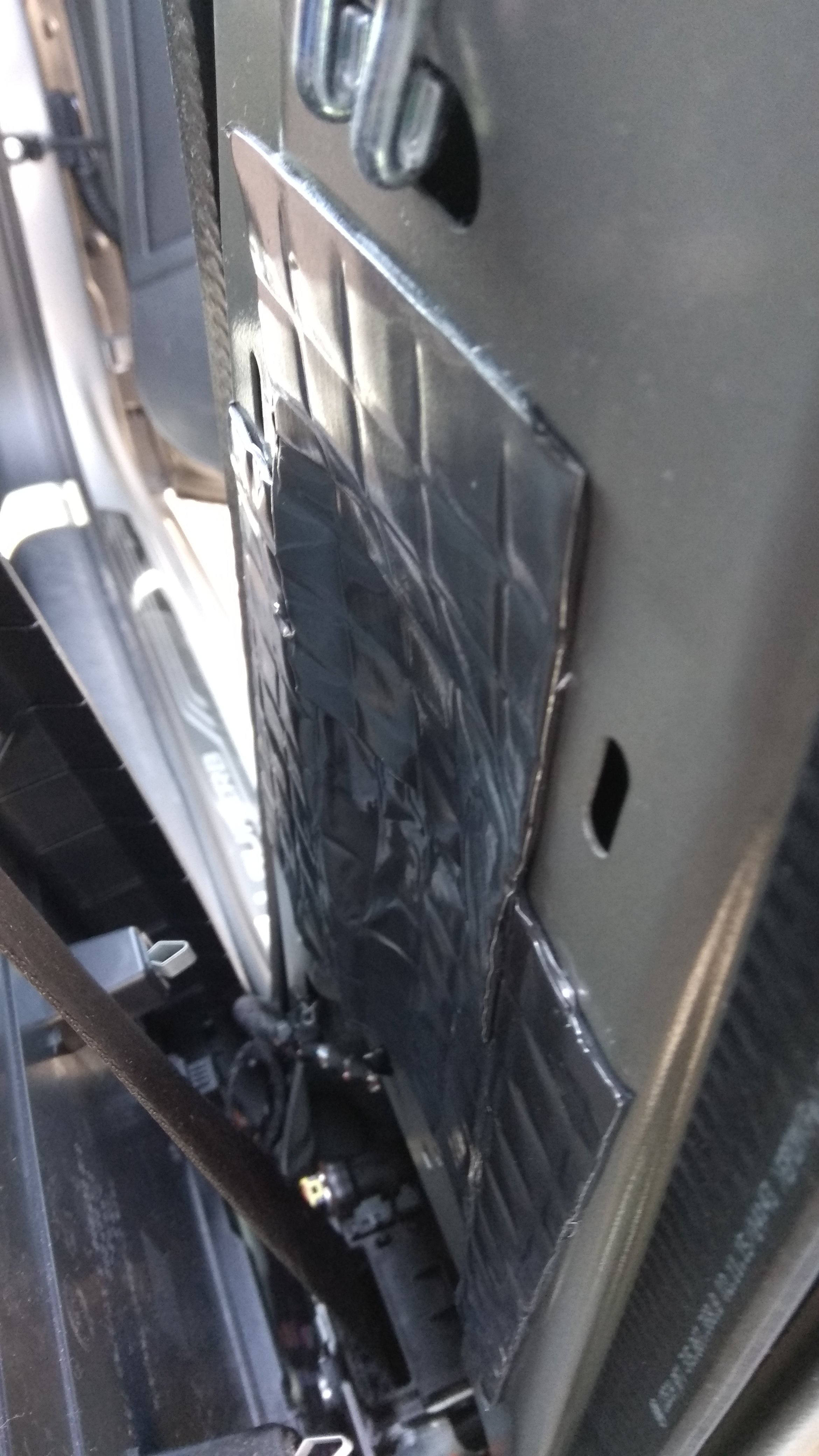

So have just finished soundproofing both B pillars.
Not a hard job but made a couple of small mistakes that I had to rectify.

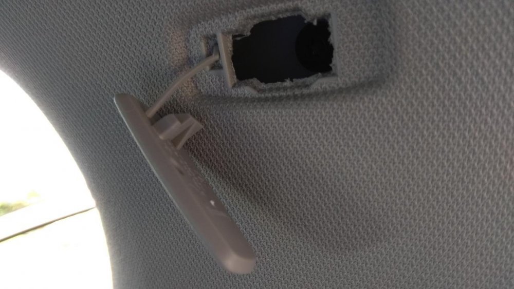

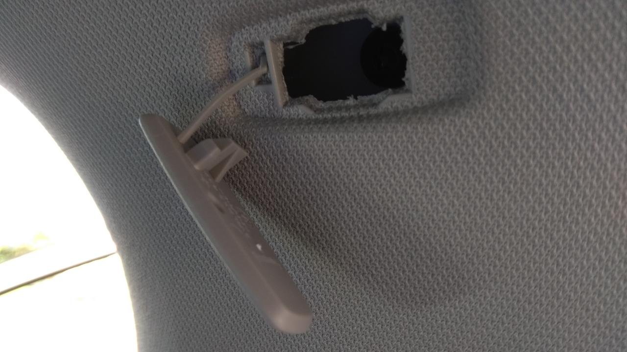

First off remove the airbag plastic cover, I used a knife, as described earlier prize from the middle. One of the tabs broke off as I removed it but it still went back on ok.
Then removed the T20 screw being very careful not to drop it into the b pillar. Magnetic tool is a must.then pulled the trim of firmly from the to lower tabs and slid the top b pillar trim down. The bottom trim pulled off easily as well.
Then went to work with the silent coat on both the b-pillar and the inside of the trim, also added some closed cell insulation to the b pillar trim. Careful not to make it too thick as it may interfere with the running of the seat belt. Each side of the seat belt mechanism there are voids into the sill. I stuffed these full of closed-cell to act as a buffer for any noise travelling up the B pillar.
Once fully insulated I fitted the lower trim, and now made my mistake fitting the upper trim. I fitted everything back replaced the T20 screw, only to realise I had not lined up the adjustable seat belt height mechanism, so the seat belt will not retract. Removed the trim again, lined up the mechanism and refitted and everything was ok. Very easy to make this mistake so be careful. Also be careful with that T20, it would be very easy to drop it into the b-pillar and you may never see it again.
Each side took around 40 minutes, I would class this as an easy job. Now for a drive to see does it make any difference.

Nice summary. Very similar to my experience, including broken clip, I did forget to say I attached the top trim and realised the seat-belt buckle was inside the pillar :)
I did price up genuine replacements seem to be about 10 USD. Knockoffs from Ali Express 4 USD.

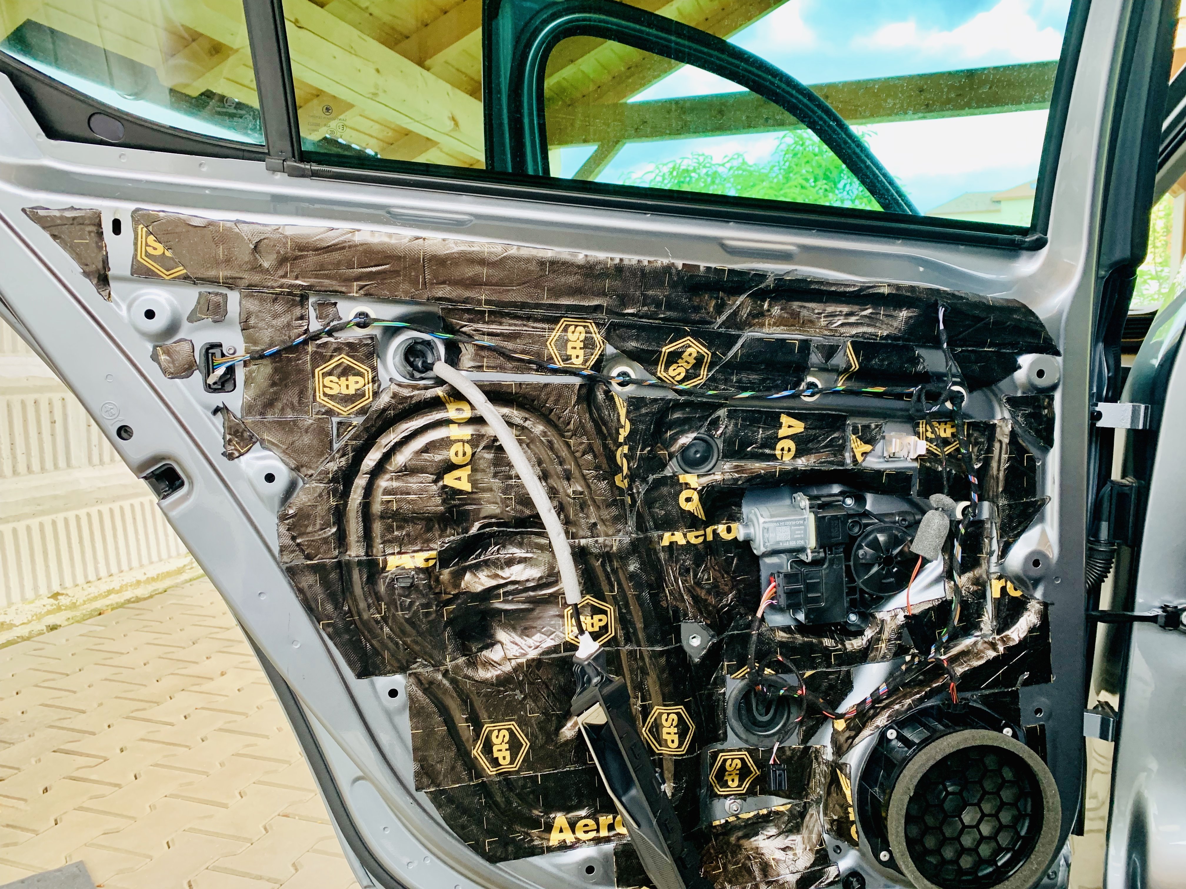

Hello again,
after many months of sporadic work I now have a silent car.
I put in numerous coats of STP on:
- the engine bonet
- the trunk floor
- the wheel arches from the outside
- the B pillars
- the doors
Additionaly I added braces under the car (https://www.hardrace-europe.com/fitments-3/skoda-1/superb/3rd-b8-3v-2016-present.html) and a front strut bar.
I now like my car. It is really quiet, it has no vibration regardless of the road surface, the turn in is so direct and the whole car feels like one single unit. It really feels like an Audi.
The effect is astonishing at High speed. Only noise comes from the mirrors - double-glazed Windows would surely make the car excepțional but I can’t find them anywhere. It is however a rather benign sound.
All the added balast has made the car feel like a little “elephant” but it does not bother my relaxed driving style and is rather appropiate for highway motoring (it’s the familly car you know).
What’s next?  Well the car is now a rattle and creack concerto.
Anybody silenced the center console, between the front seats? It drives me crazy!!!
Edited by gigolea
Forgot to mention that I replaced the Pirelli P7 garbage tires with 68dB Dunlop’s.

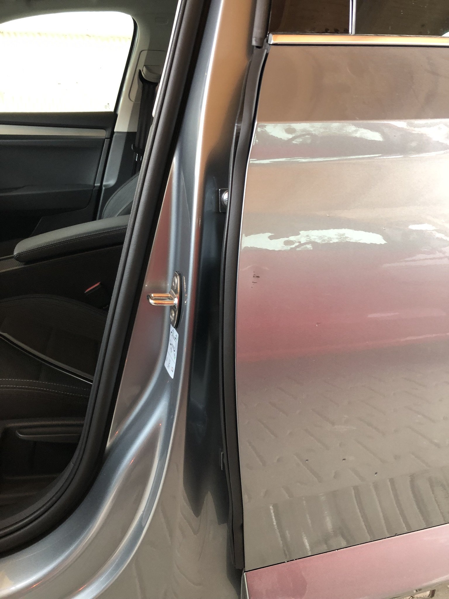

Forgotten about the door seal
