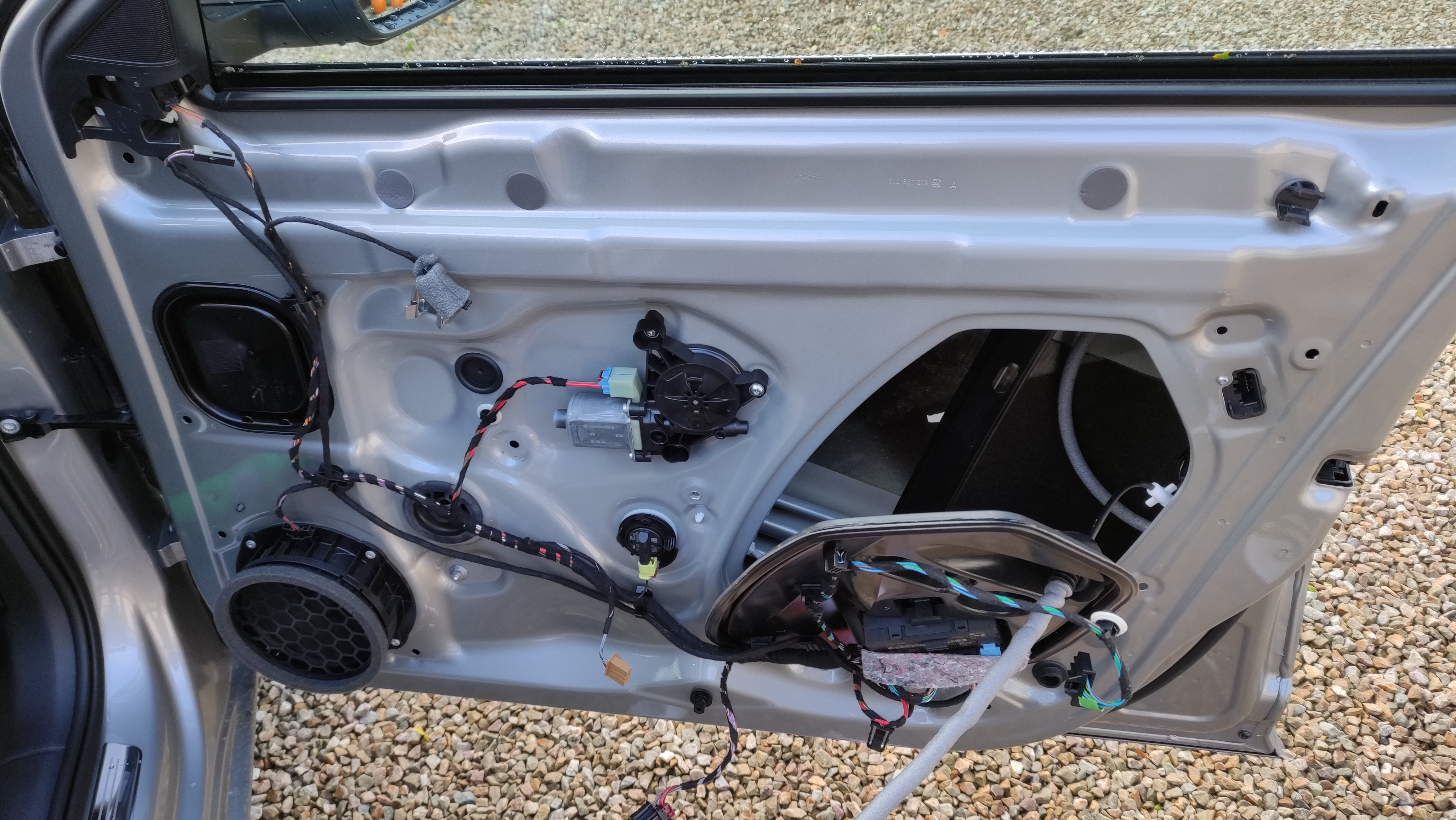

I have finally finished the doors (noico 0.4, 10mm kaiflex and 30mm wavy kaiflex) and now you can really tell the difference.  cars passing by can be heard far away, and driving close to a wall is not so unpleasant.  It has cost me a lot of work and I know I could have done it better, but for the time I had and myself, it turned out quite well.
Both front doors done this morning. Went pretty smooth bar a few broken door trim clips. I suggest getting a bag of these before you start.
2 mm Noico with 5 mm Noico red closed cell. Hardest part was probably disconnecting the various electrical connectors, each one with different (why?!) and some more more fiddly than others.
Once the door card was off and the large plastic grommet removed I placed a layer of the 2 mm as far as my hands could reach. I wasn't able to get much below the crash crossmember as access was tight. I then applied some 2mm to the outside of the door skin and to the reverse of the door card, finally covering as much of the door card as I could with the closed cell foam.
Did the passenger side first in case I made a mess of something. Also better to learn on this door rather than the door you'll be using most often.  Took about 4 hours not rushing.
Didn't take any good before and after photos unfortunately. Haven't driven the car but first impressions are are that it sounds more solid inside when slamming the door, outside the door slam sound is much the same though the door skin has a lovely solid feel when you tap it.
A couple of tips:
I used the round end of the 10mm spanner used for the bottom door nut, to press the 2mm in place, as it is hard to get the roller into the tight spaces.
Take pictures as you go of the various connectors as the last thing you want to do is to have the door card on and have forgotten one.
Don't forget having removed all the door card clips that the card pulls firmly upwards to remove.
When trying to pull the large plastic grommet out prize from one of the longer sides first.

I did the front doors some time ago and I was happy with the difference. My recommendations would be:
  • get a small stool ready or something to support the door card when you are taking off, putting back while you are disconnecting the cables. or just trying to fix somethign without disconnecting all the cables
  • you are likely to break a grommit or two. then ones I ordered from Amazon were too loose and did not fit properly
  • I put rolls of laminate carpet underlay at the bottom. My mistake was covering the back of the speaker and putting too many of them so that the window did not open. This mean reopening the door. But even with fewer carpet underlay rolls it makes a nice difference. You can find pics of this back in the thread.
  • I struggled tightening back  with the screw in the middle of the door card. I think it flipped (the nut) or something along these lines
  • As mentioned by Steviedakota take multiple pics of the cable connections. They are actually hard to confuse once you do it but it still helps the first tie round. Do count them when disconnecting and reconnecting!
  • I have still not completely  closed the drivers card door. there is an angle at which you have to put it back and if you dont the top corner next to the bonnet wont catch with the metal part of the door. It's nothing but esthetics though, the door functions just fine.
