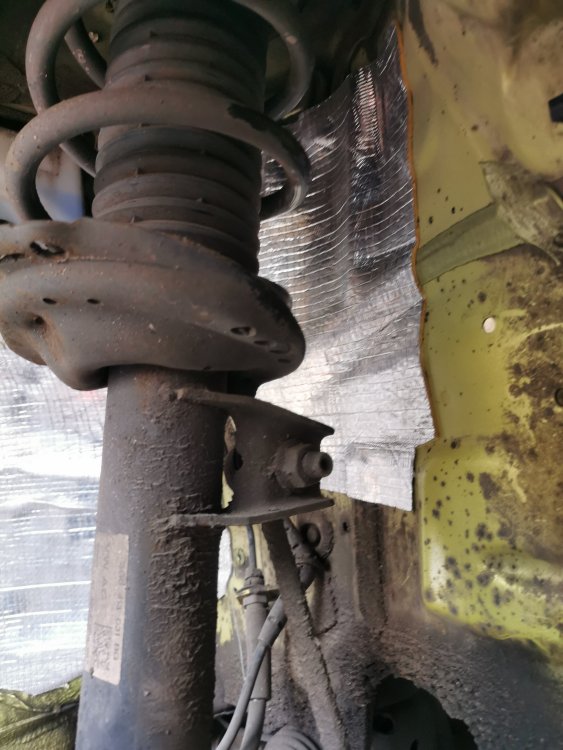

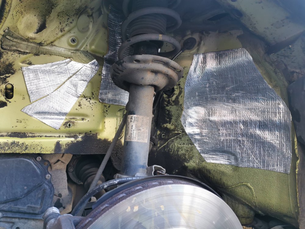

  • Had one week vacation and what would be better than do some sound proofing to Superb. This was my first ever noise insulation project so had a lot to learn and this thread was a great info source for
  • Wheel well noise, I'm told is a significant contributor overall so with this in mind I decided to try out the rears first.   Having recently been camping and totally filling the boot space to the roof

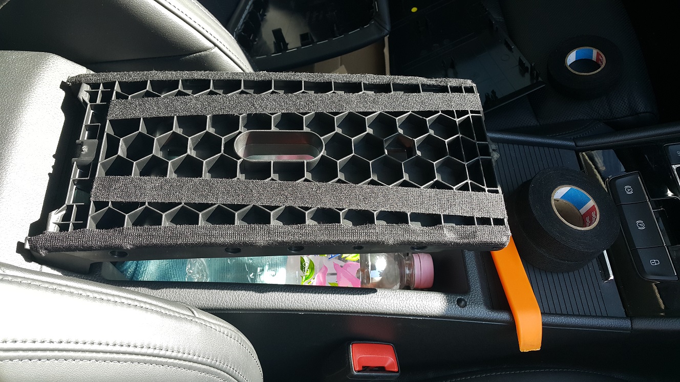

The squeeks I was getting were from the mid console box cover and on hot days from the wheel drive dial plastic glass. I disassembled the mid console cover and put thin strips of the floor underlay in it and the squeeking is gone. The same can be done with the plastic glass but I left it as is.

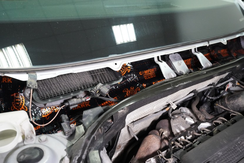

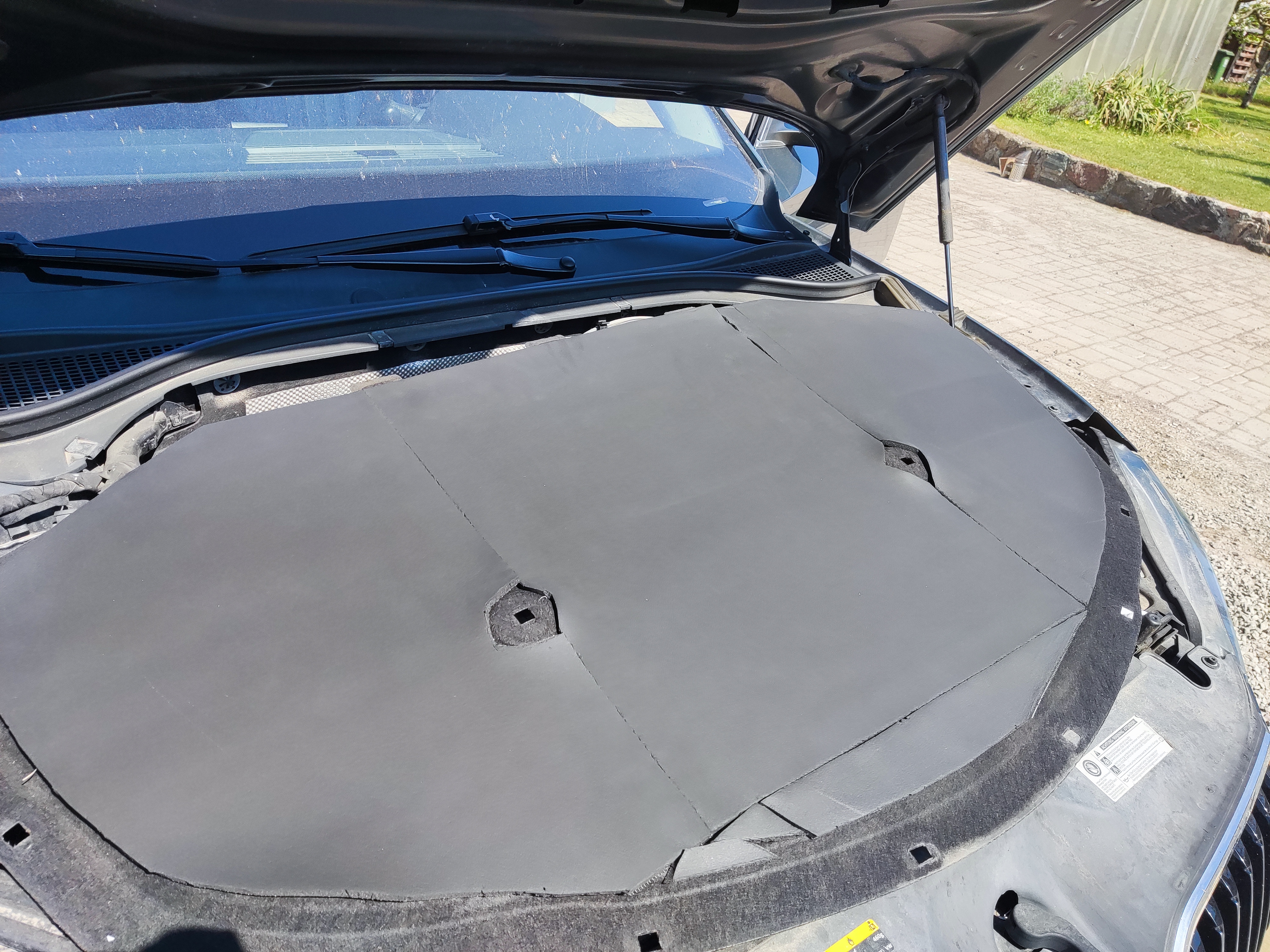

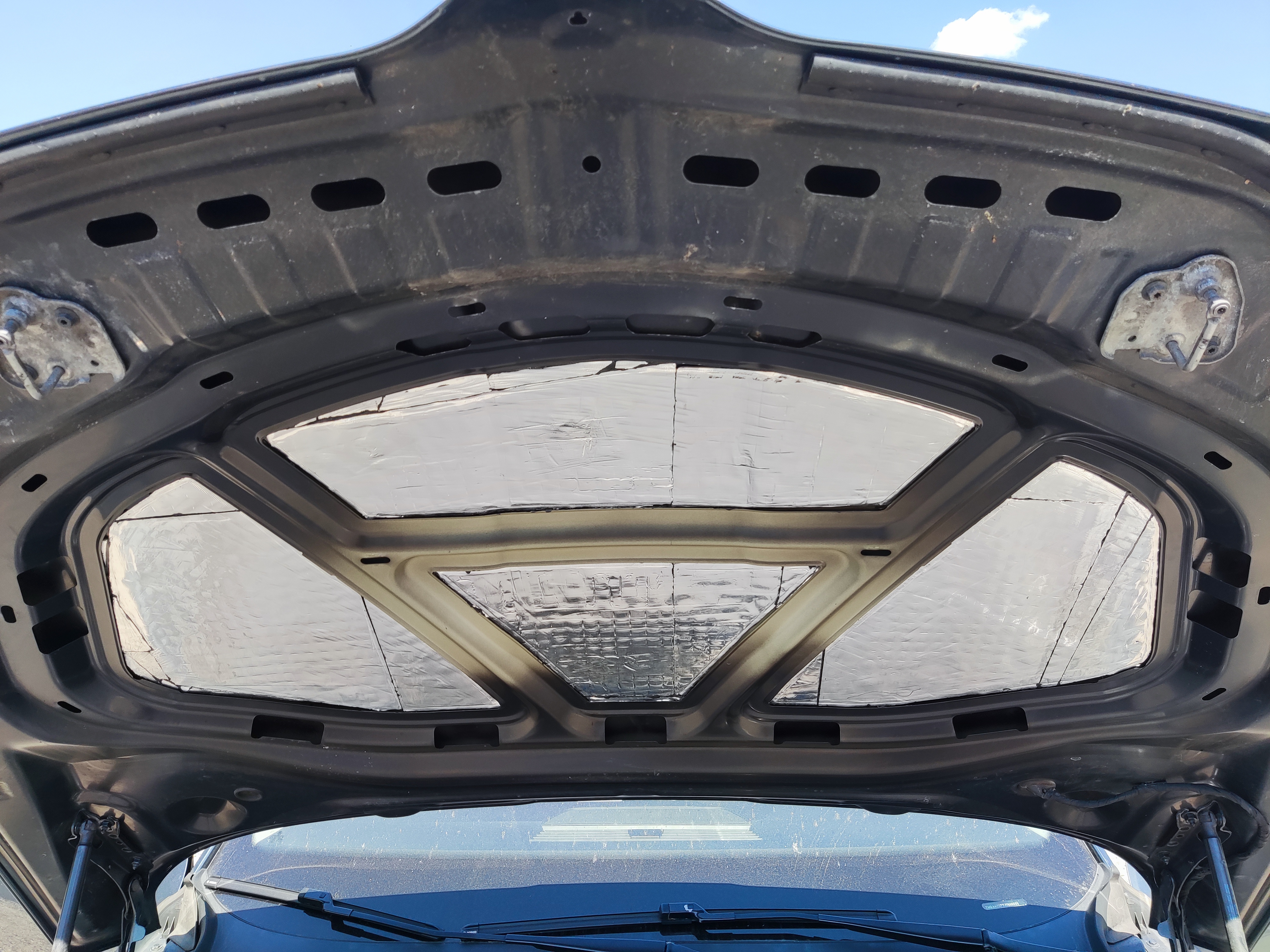

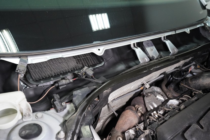

Hi,

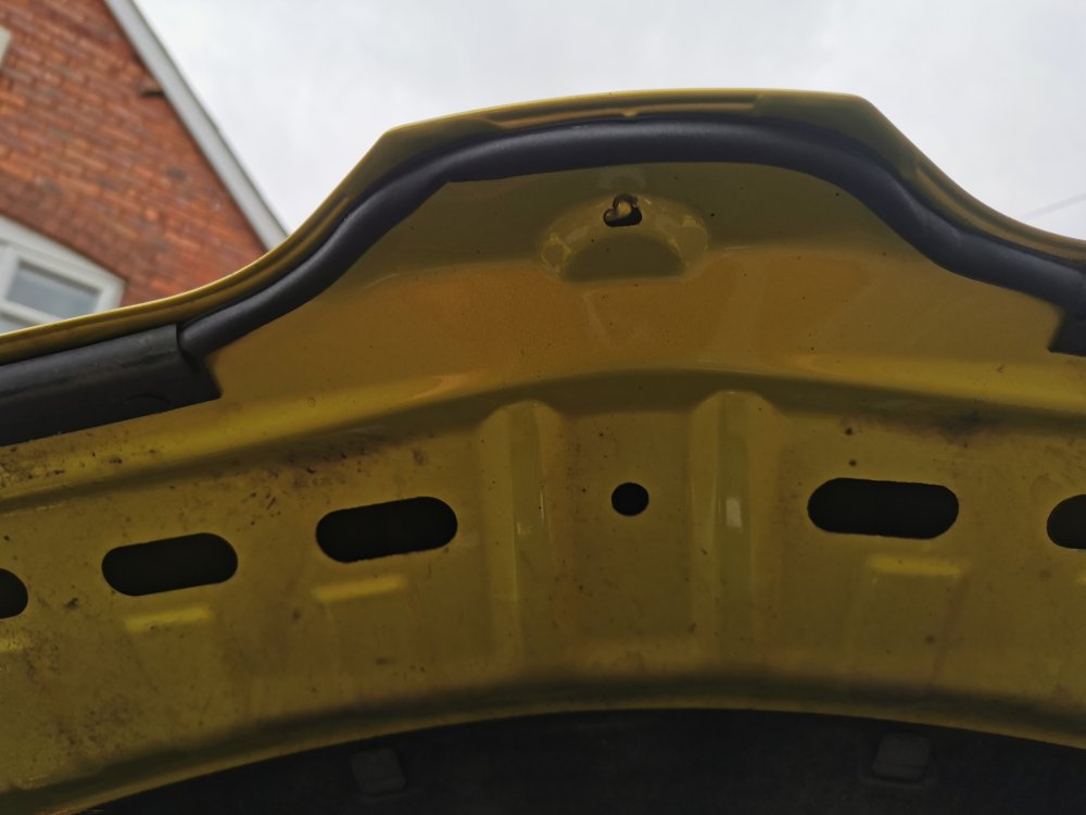

tried this weekend to do noise insulation on hood. But expected better results (engine tdi 2.0 110 kw).
I have found that on premium sound insulation packs profesionals is doing insulation under the windshield (adding 2 photos). Have anyone tried? Maybe it reduce engine noise more? Is there anų more ways to reduce engine noise?
Thank you! 🙂
Best way to reduce engine noise is to buy a petrol!
Not sure that covering the whole engine like that is a good idea either, apart from the fact it looks like a fire hazard you are smothering the engines ability to dissipate heat effectively.
I'd be very reluctant to put soundproofing material in a weather-exposed area like that (under the windscreen, in the scuttle area) as it could lead to rust in the longer term .  My 2016 2.0 diesel was definitely noisier than my 2021 2.0 diesel but I found that both ran more quietly on premium diesel.  It's not a major improvement but higher cetane fuel does reduce clatter and vibration.  You need to run two or three tankfuls to see the difference

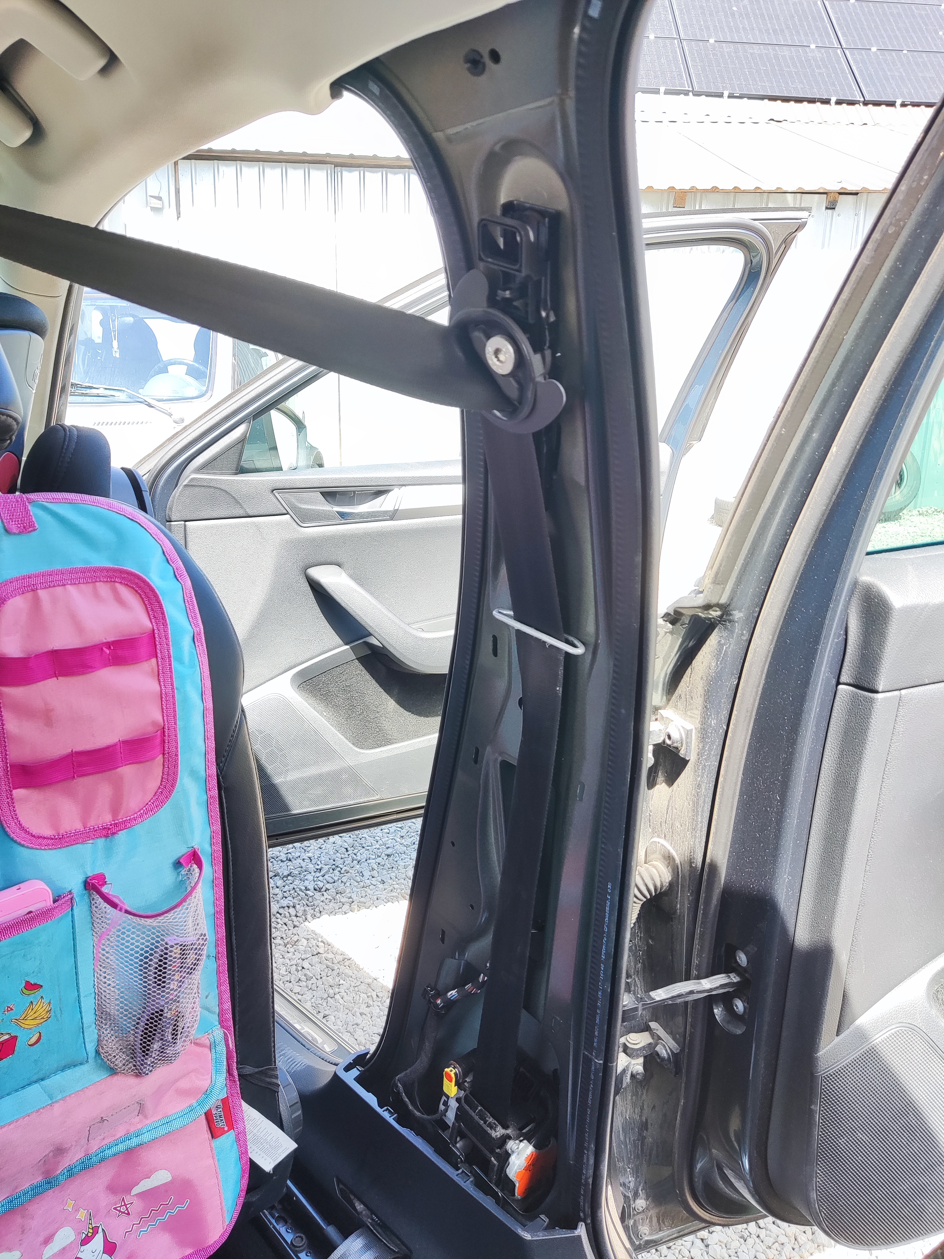

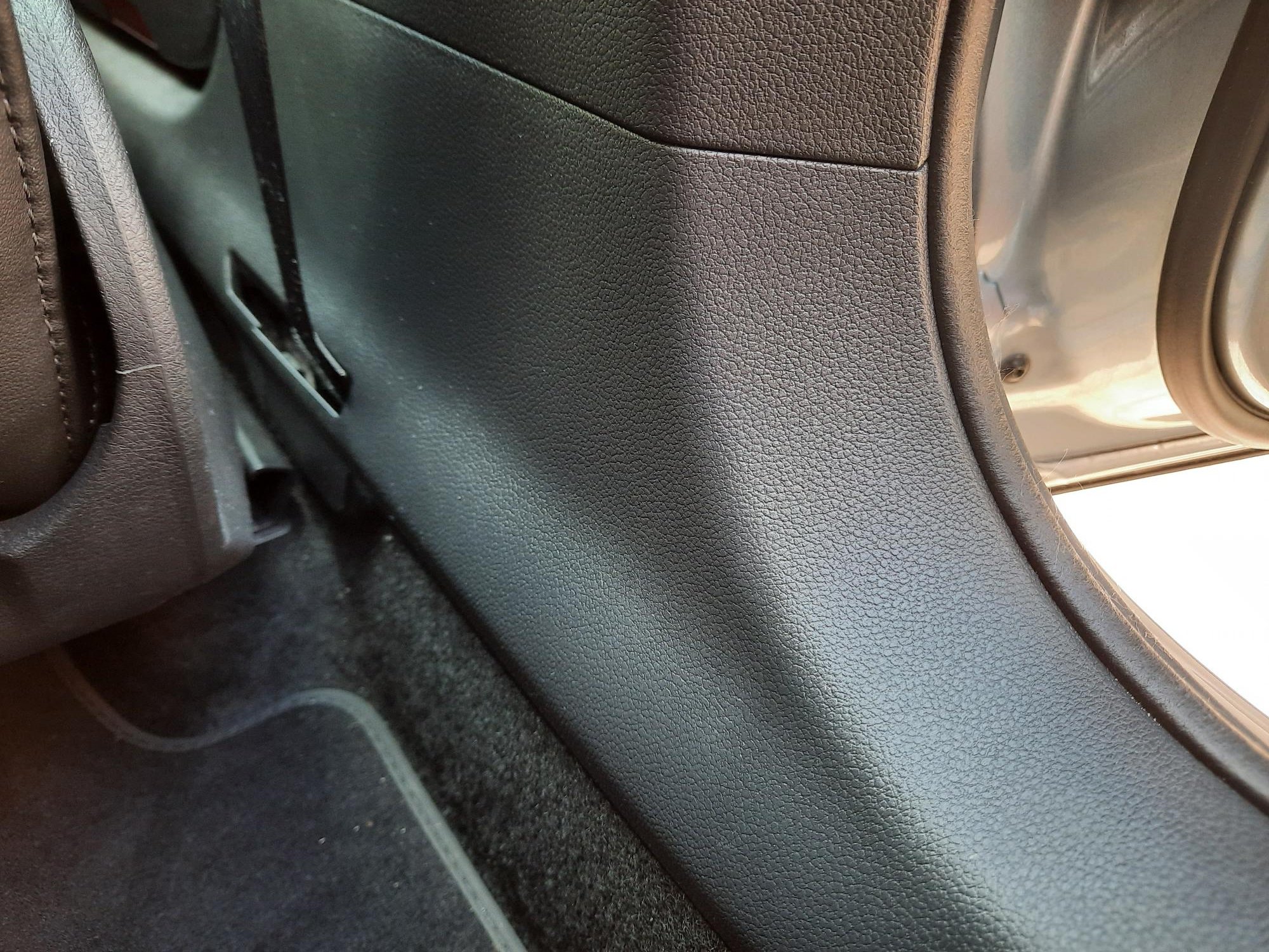

I have a 2021 Superb MkIII.

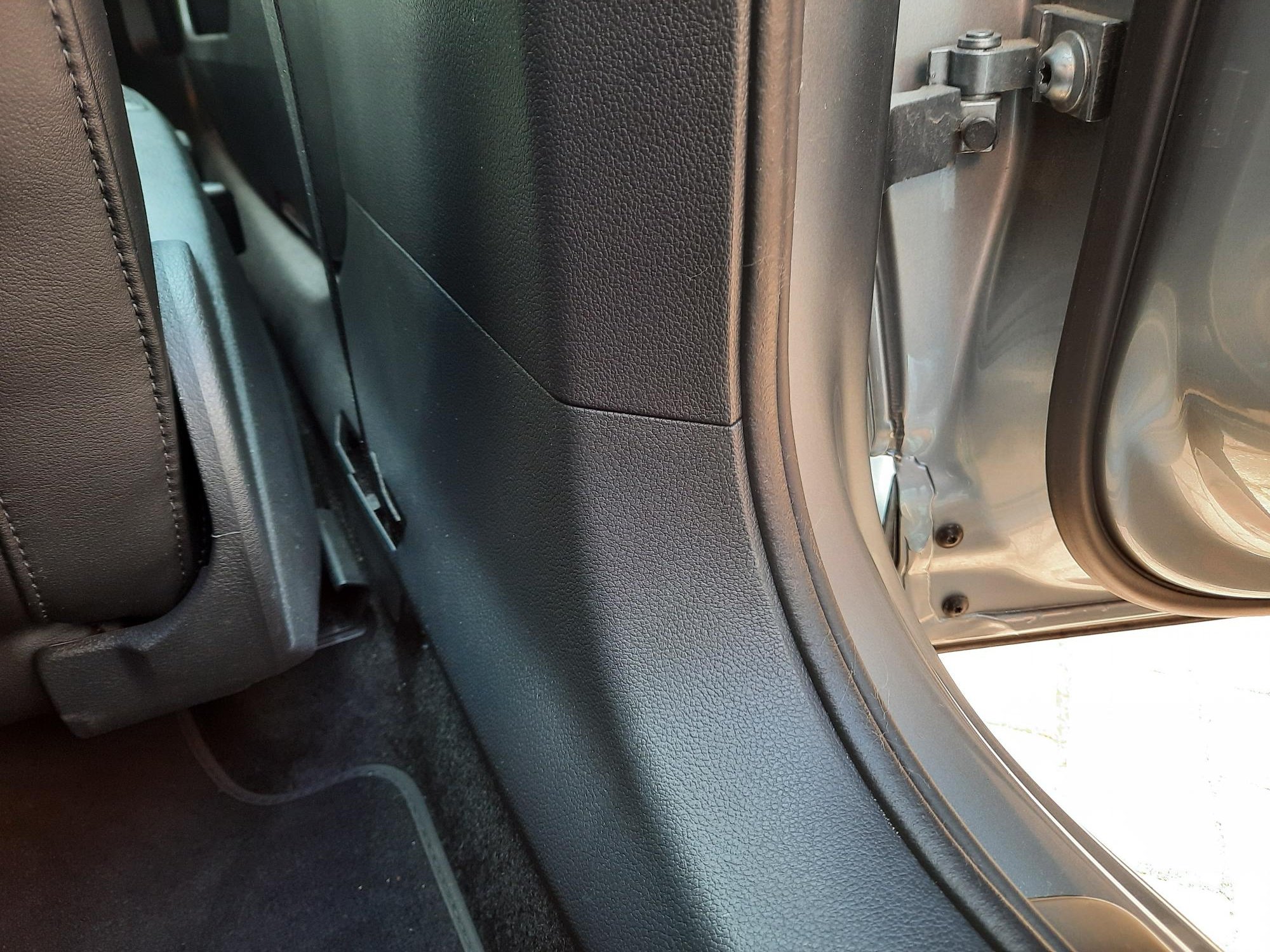

Does anyone know if it would be possible to just squeeze some foam between the bottom of the seat belt (where it's anchored to the floor) and the trim, with the trim in place, to save taking the trim off entirely and risk breaking something? There's a reasonable gap with the trim in place but I don't know if there's any wires down there etc. that might get damaged in the process. Trying to avoid taking off the trim and damaging the ABS cap clips that hold it in place at the top (read that is a common problem) or scratching it etc.
Alternatively, can the lower horizontal trim that stretches from the front to the back be taken off without taking off the vertical seatbelt trim? Wondered if that would be an easier option as figured the noise would be coming upwards so probably best to try and fill as close to the sill as possible and save the risks mentioned above with removing the top trim.
Pictures attached.
There would be little point in shoving foam down there when it is not a tricky job to do properly. B Pillar trim is actually very easy to remove and there are definitely gains to be made from soundproofing that area thoroughly as sound does travel up the B pillar.
Pictures attached.
I think bad idea, there is seat belt mechanizm, which could be damaged. It's is very easy to remove trim.

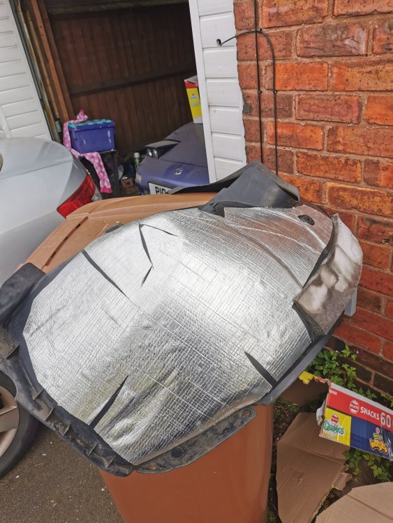

Thanks for your advice and reassuring words. I'll tackle it next (just in the process of insulating the wheel arches. 1 done, 3 to go). Any tips with removing the top plastic cover to get to the screw without stretching it or breaking the lugs on the back? I fashioned a piece of steel to prise it off but was too thick. Think a flat screwdriver might mark it.
If you talk about airbag plastic cover, I removed with very thin and strong knife 😃
Please don’t use metal, screwdrivers etc. Trim removal tools are cheap and won't damage anything.
The airbag plastic cover pops off easily. Just be careful when removing the screw that it doesn't drop inside the trim.

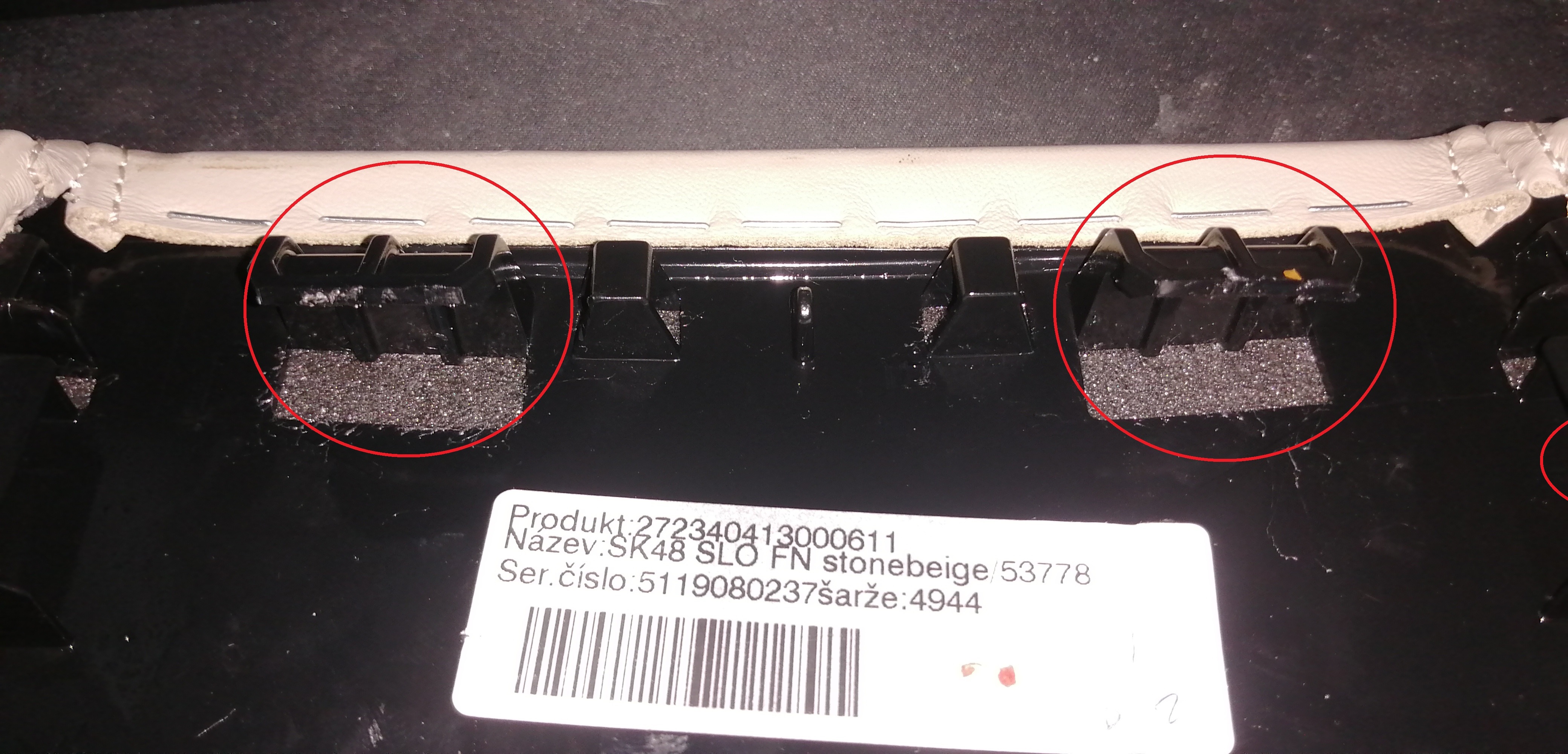

On 17/06/2018 at 12:43, MartiniB said:
the armrest now is quiet
I have the same issue with my 2016 model. Please, can you tell me just how you managed to remove the top cover, I can see that there are 4 clips that retain it, and I guess from looking at them, you have to release it from the back towards the front as the front clips look to me like they would just snap off if I try it from that direction? I have tried to undo the back 2 (bottom when the rest is upright) but they also do not want to come undone. Is there a secret or a knack to this please, I'm desperate to resolve this squeaking, my mk2 was silent, and I'm frustrated with the constant squeaking with the mk3.
@Graham Butcher
i can't remember how exactly 😞
99% that were these
41 minutes ago, MartiniB said:
@Graham Butcher
99% that were these
Yes, those were the 2 clips that I deduced were the ones to go with as the others at the other end are way to big and thick to bend. However, I'm really struggling to get these to release their grip. I think that most of the problem is because they are at the bottom and the armrest only goes upto the vertical position making access and visibility difficult.

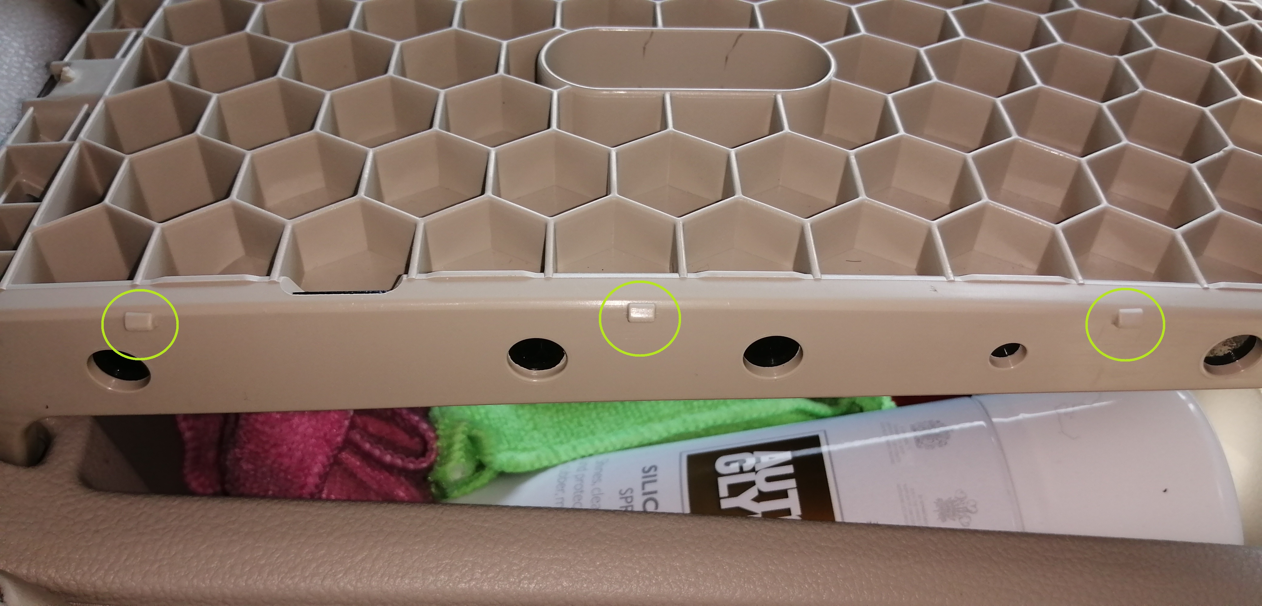

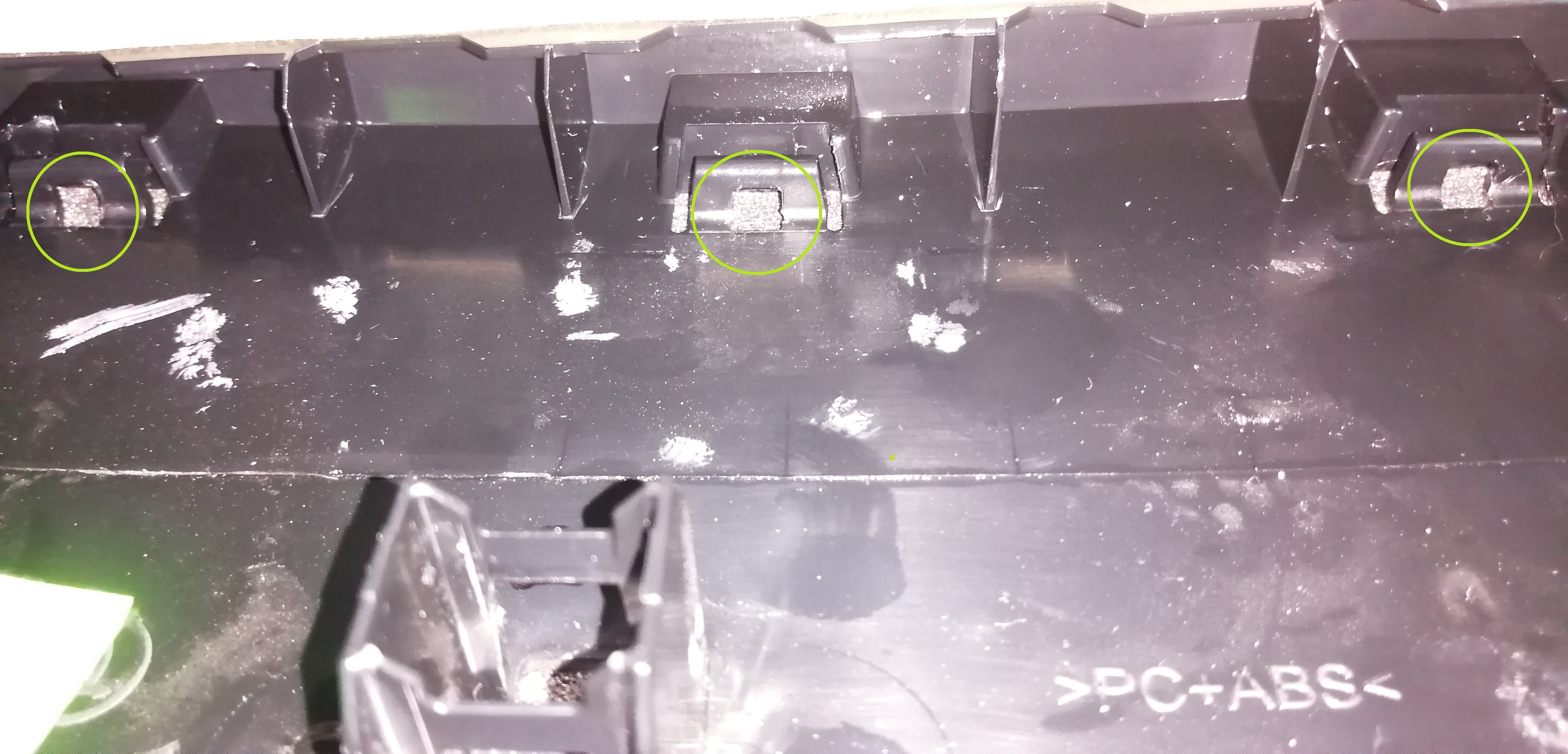

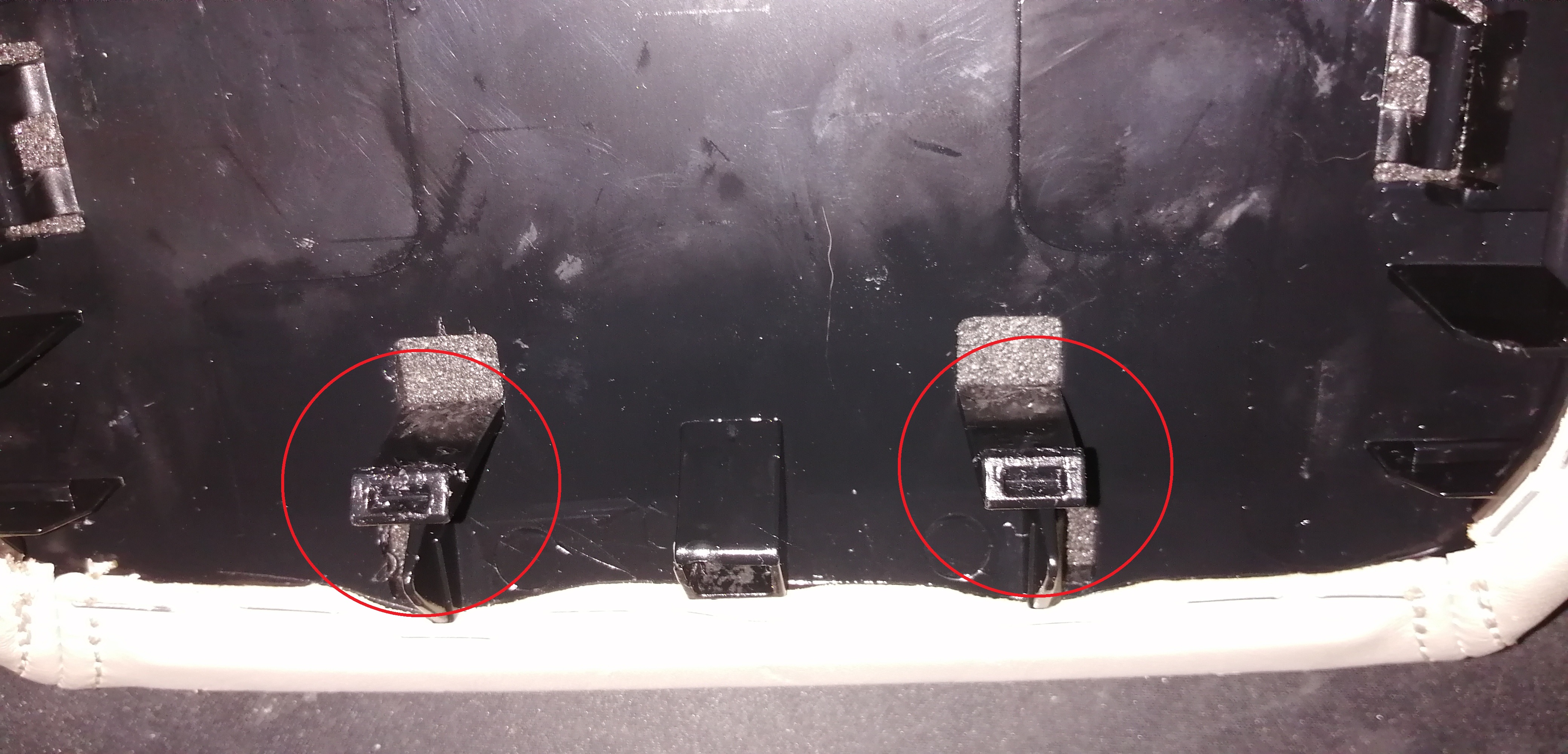

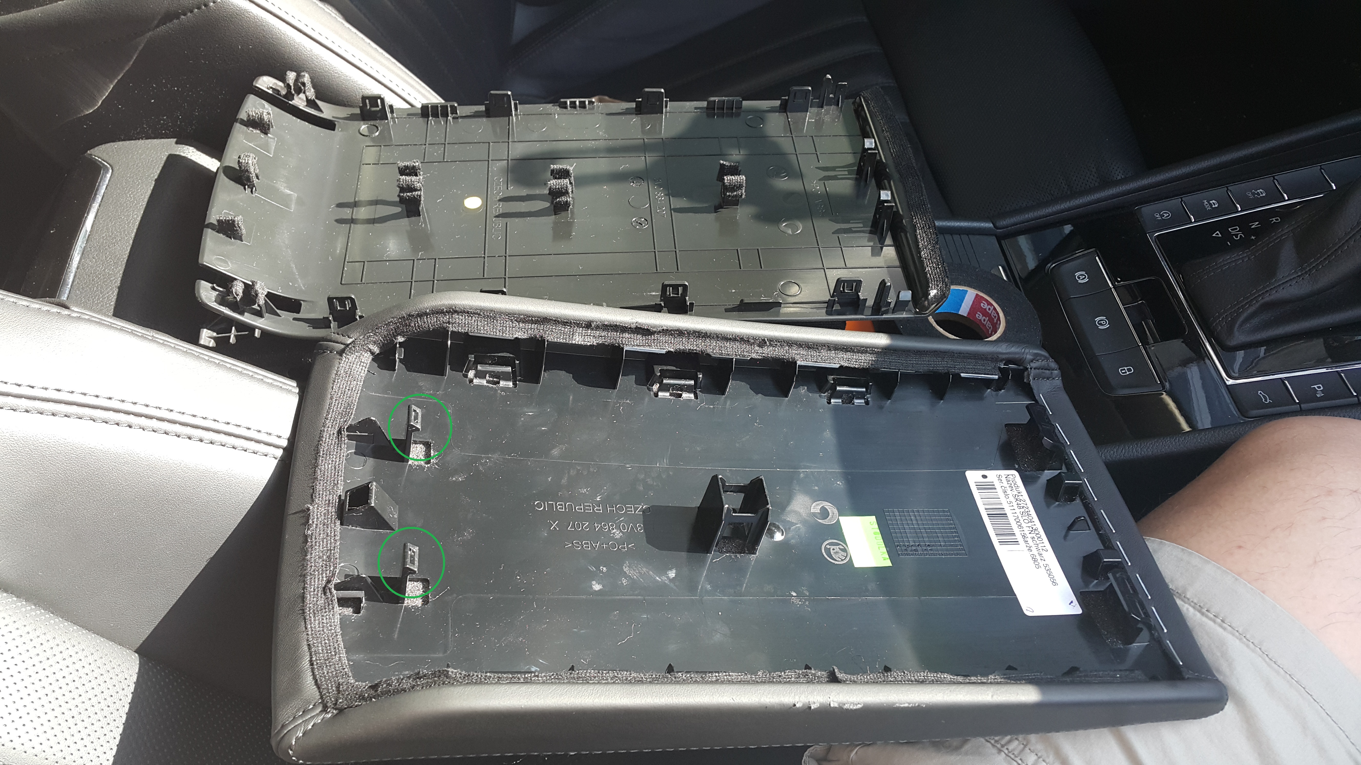

OK then, today I had yet another go at separating the padded top from the centre section of the armrest and after much swearing succeeded, besides the 2 clips that you kindly highlighted, I can now confirm that there are 6 others, well hidden the little blighters are as well. I had to enlist the services of my son as well to help as you need to be a flipping octopus to operate all the flaming clips 🤔.
In addition to the ones you highlighted, I have highlighted these pesky ones in green as well in the photos and these locate in the holes also shown in green on the other photo, 3 each side of the rest.  Those clips highlighted in red depict the visible ones that you can clearly see. Under no conditions attempt to move the 2 real big beefy clips, the ones that are situated towards the cup holder end of the rest, its the other smaller clips at the tunnel end of the rest, I highlighted both of these clips in red to aid identification, the ones not to try are by the label.
Now that I have been able to separate the padded bit the armrest is extremely quiet and the only occasional squeak seems to be from the door card if I rest my knee on it and and a squeak every now and then from the steering cowling which I'll attempt at a later date. More on this later when I've completed the rest bit.
