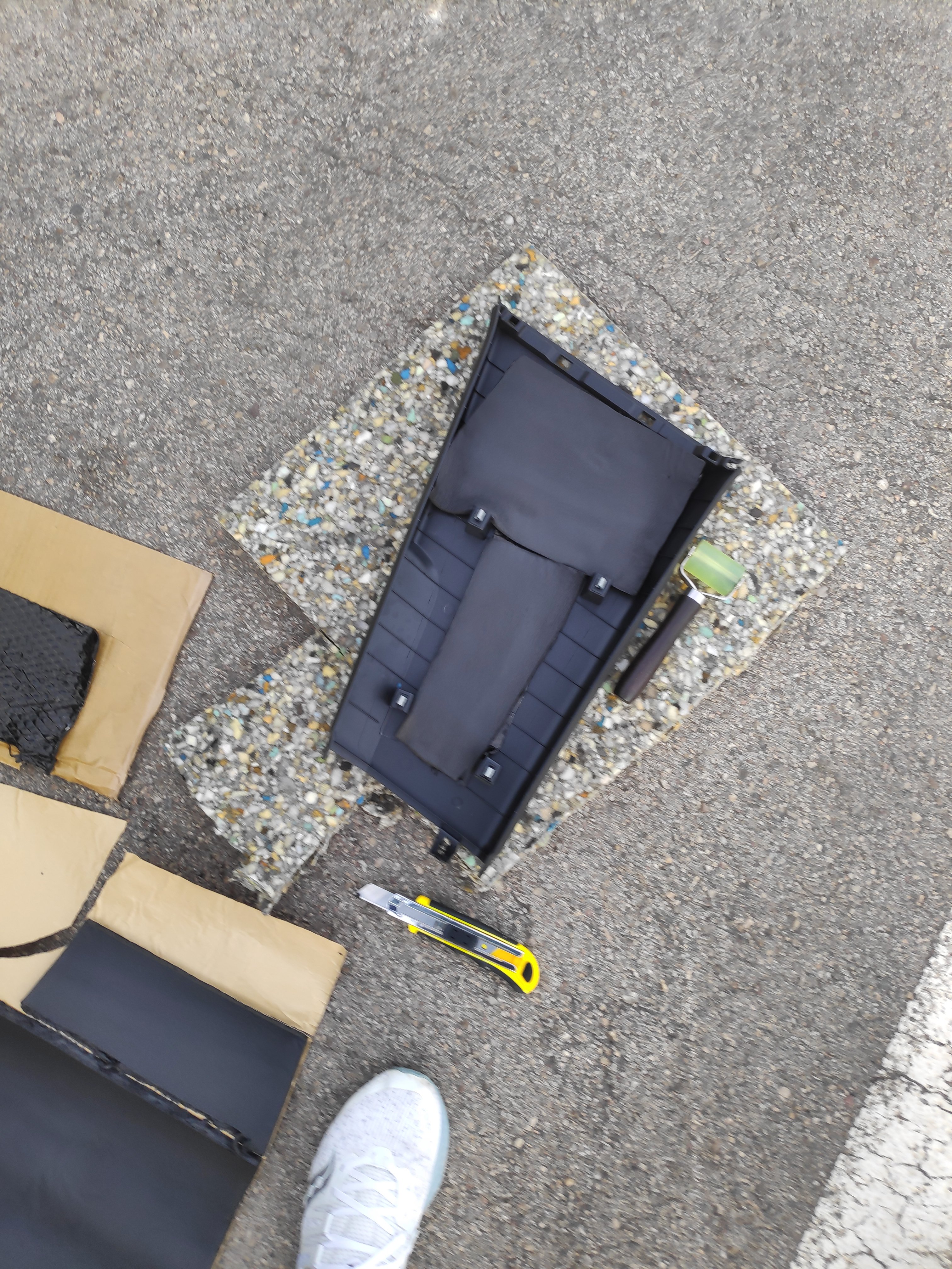

so today I completed my work on the floor. I laid Noico 2mm, carpet closed foam underlay as decoupler, and then MLV. This comes on top of the boot, the B Pilar and the two doors done a week or so ago.
This was pretty challenging and I started on Friday with taking out the back couch and laying Noico there. This would have been very easy if it wasn't for the couch not wanting to slide out. I must have spent 30min trying to do what the workshop manual was telling me to do. Only once I applied my whole body weight the thing slid out from its sockets. Other than that it was the easy bit with just laying butyl
Next I proceeded to disassembling the entire console in order to be able to remove the carpet and the underlay beneath it. Unfortunately these are installed in such a way that it's impossible to keep the carpet and underlay intact without taking apart at least some bits of the console. So I entirely disassembled it. I think I was also partially driven to doing this by seeing multiple pictures on the internet with the consoles out.
Looking back this I think I would have rather cut the carpet and the underlay at the 1 or 2 narrow strip that go over the console to avoid the hassle. I believe such cuts wouldn't make a difference to the quality of fitting while would save me loads of time and allow to get the carpet out. Or perhaps I would not take the carpet out at all, I would just remove the seats and bend the carpet sideways to uncover as much floor as possible. While it would be inconvenient to work with it would probably do most of the job and save loads of time
Anyway, the console was out, so was the carpet and the underlay. I laid Noico beginning from the rear bench (number 4 in the attached picture) and going towards the front of the car.  Unfortunately I started running out of the material hence the very front (around number 3 in the picture), is covered only partially but still to a good degree.  A school error on my side but I was trying to use large, uninterrupted pieces of butyl so somehow lost count of how much was left. I should have started from the front. and work my back towards the bench.
Luckily there was already some sound proofing material laid there by Skoda and the very bit under the feet / the pedals has a thick rubber / foam mat.  I also added smaller strips to the sides and top of the console and other minor panels along the chassis.
I stuffed hollow spaces around the seats (number 1 in the picture) with carpet underlay and this did a great job of sound deadening them. this also is very cost efficient as a big roll of carpet underlay is probably 20 euro and it can be stuffed in many other cavities in the car.
In the next step I put the decoupling layer using my carpet underlay. Unfortunately it doesn't bend as great as some of the dedicated materials I see on youtube but I think it did an overall good job. Finally I laid MLV sheets. The bit with the frame for the seat screws, I did not cover it so there is a break in MLV. I didn't glue MLV sheets together either. I saw people doing it with contact concrete to create impenetrable barrier but although I bought some glue with an intention of doing the same I started to run out of time and had to cut corners. I realised that since my MLV sheets overlap each other by quite a bit and because they are quite heavy and will be weighed down by a further layer of Skoda underlay + carpet there is no need to freak out about some potential gaps .So I taped the stuff together (the tape was really crap) and started reassembling the things. In the picture it is not finished yet and looks a bit crap but I tightened the fit later.
After having done the boot, the B pillar and the front doors I arrived at 73db-74db at 120km/h on my test motorway with coarse surface. This was a big noticeable improvement over the original noise levels whose db number unfortunately I don't know. At73db-74db we already found the noise levels acceptable (but not excellent) at the test speed and surface while we were pretty happy at lower speeds or on better surfaces. A reminder I have 18inch wide tires which simply came with the car.
Doing the floor and rear seat bench helped cut the level by around 3db on the test road and change the frequency of the noise to a much nicer, less intrusive one. 3db is quite a lot, I believe it could be approximated to around 30% cut in audible noise.
Currently there is now markedly less vibrations coming from the bottom of the car and whatever comes is much, much easier on the ears. On other benchmark road parts with poor surface but lower speed limit the vibrations have stopped altogether while they were annoying before.
Was it worth it? Yes, but perhaps doing the back arches would provide a similar gain with less work, this I won't know until I get there.
There are a few lessons learnt.
As pointed by Digifish covering the entire rear bench in butyl might not have been the most efficient thing as the couch is made of a very thick foam which absorbs most noise. And this is true - after covering the rear bench with Noico I drove the car with and without the couch on and the difference is enormous.  So the couch itself is a great sound absorber and saving the butyl used on the bench and using it in the front might have worked out better. It would also save me a few hours of work
I would avoid taking the entire console out, I'd rather make two small cuts in the underlay and the carpet to remove them. Or I would just fold them to the side and laid Noico on the floors but forego sound deadening the panels on the console. That's my work-benefit analysis. This was a large part of work so it could be a good trade off to get some less sound isolation but saving yourself a hassle.
There was some collateral damage. I am getting an airbag error. I think this originates from me disconnecting some of the wiring directly under the seat before I figured out this is not the way to take the seats out. While I reconnected the thing possibly something went wrong, I will need to have a look at it again and I suspect I will unscrew the seat bolts to get good access to the bottom of the  seat. I will also check the cable box under the carpet.
I am also left with around 10 screws which obviously I forgot to put back in their rightful places. These most likely come from some obscure fittings. The console sits very well so I don't think these 10 leftover screws are a big problem.
The floor side plastic panel doesn't sit perfectly at the very forward end. The additional thickness of Noico+carpet underlay+MLV shifted everything up so one or two metal clips don't hold as firmly as before.
Finally, the rear couch clicks out after a bit. Most likely the extra layer of Noico is an issue. The D-shaped hooks are not long enough to click in properly into the plastic grommets (number 4 in the picture).  I have put the child seat back so the couch is weighed down for now and clicked in. But longer term I might need to take the plastic grommets out, click them onto the metal hooks, and then put it all into the metal openings?
So I guess the next thing for me is to address that airbag error and in foreseeable future doing the rear arches, the bonnet and maybe the rear doors. But due to my wives pregnancy it might be weeks or even months before I get there. I don't have any noico left anyway.

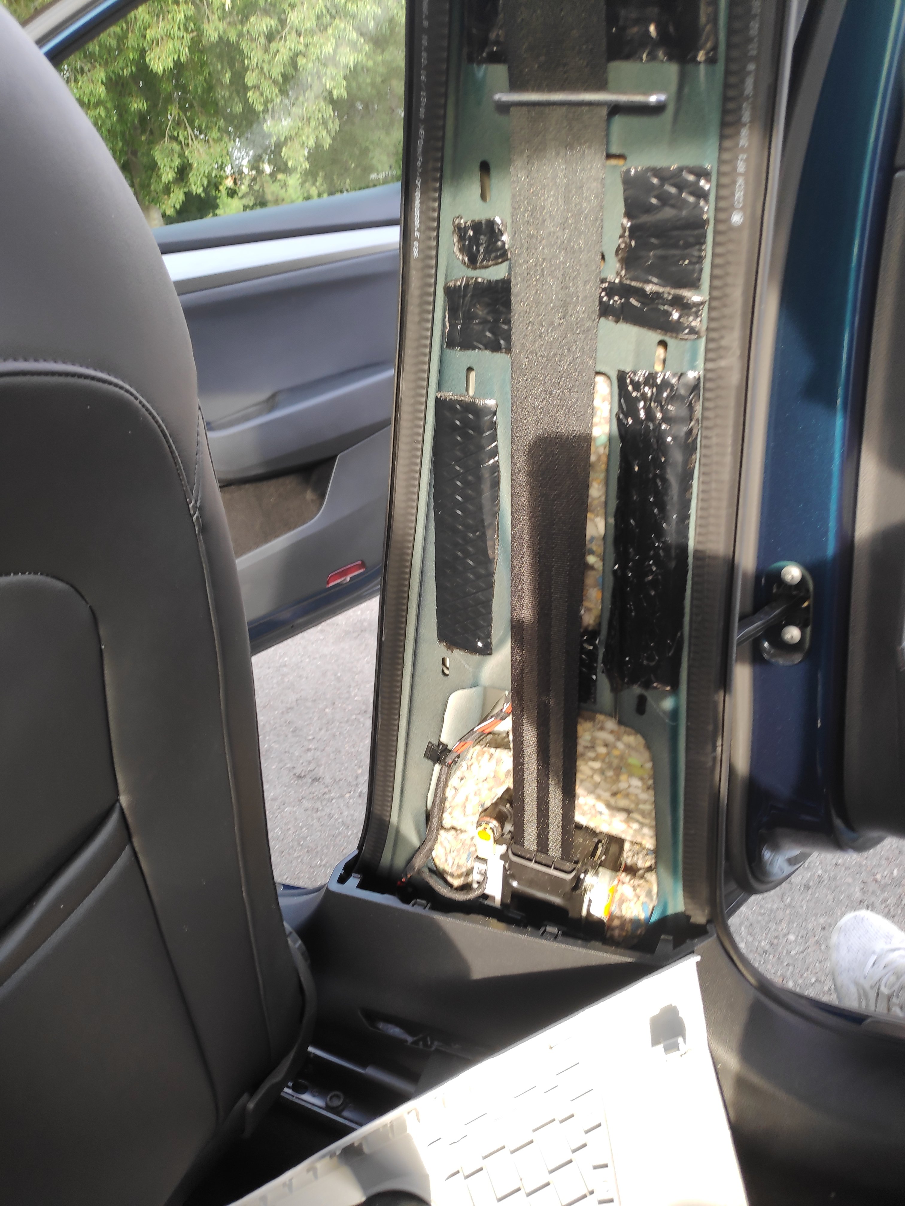

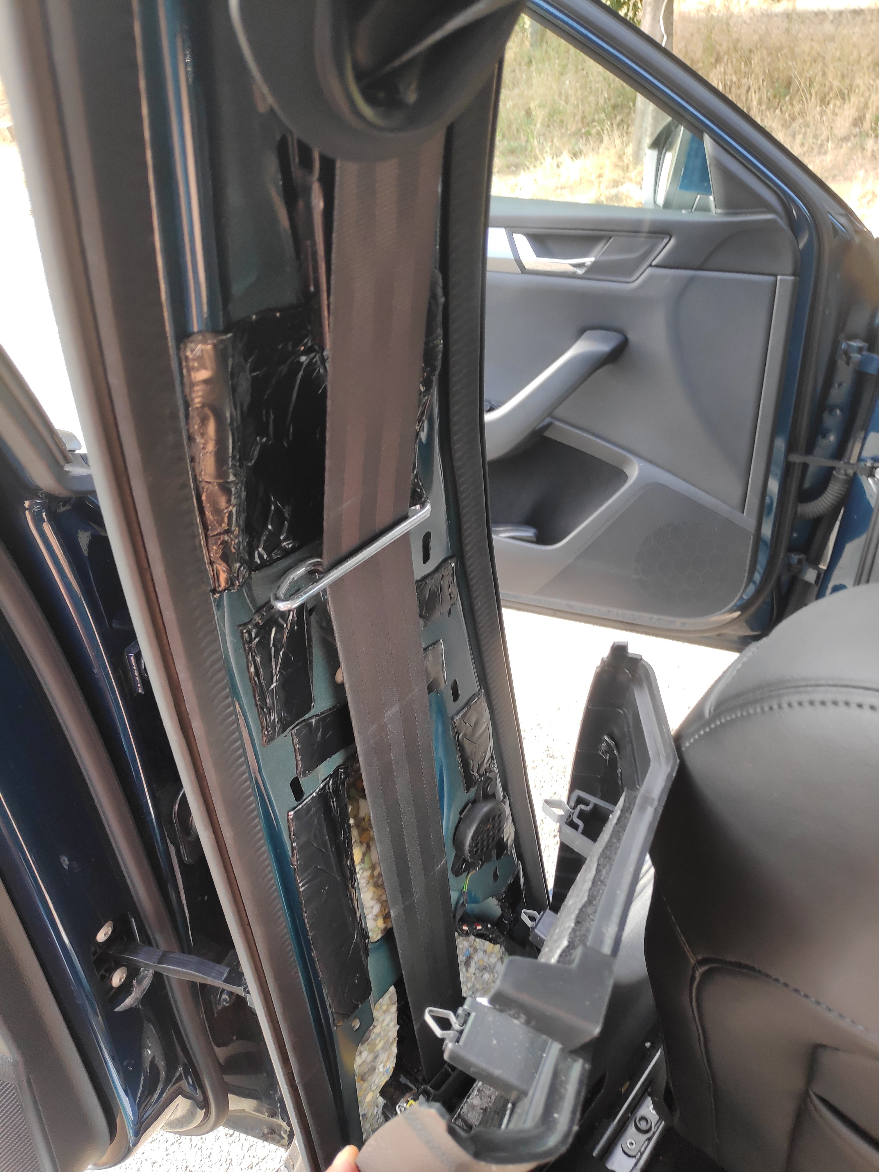

Well, this afternoon I finished the and improved the b-pillars,  knowing what to do does not take long.
It is very hot in Madrid and the noico sheet can be extended by hand.
 I keep hearing aerodynamic noises and may have discovered a new noise.
 I realized when doing the passenger side that Noico can be put inside the pillar, so now I have one made and the other not ...

Neither of the two belt height adjusters works for me, and I have left plenty of space so that it does not affect anything.
3 hours ago, Gabrielem said:
The translator has played some tricks on me in this forum ...
I'm going to see if I can try the app you told me today.
Another thing.
Hey I know I told you that the belt adjuster and the plastic panel
adjusters must be at their highest level when putting things back together as this is what the manual said. But when I was putting one back 2 days ago it didnt work and I had to align them visually. Its a simple thing Ill
send you a pic sometimes this week to show the bits that need to be aalignsd. In any case dont worry, it will take you 10min each
