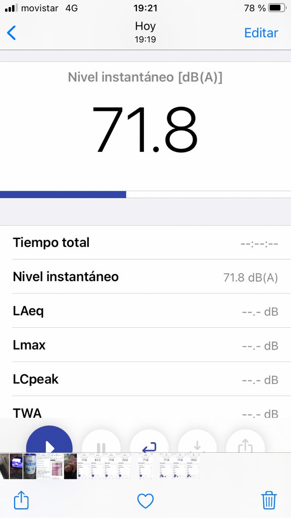

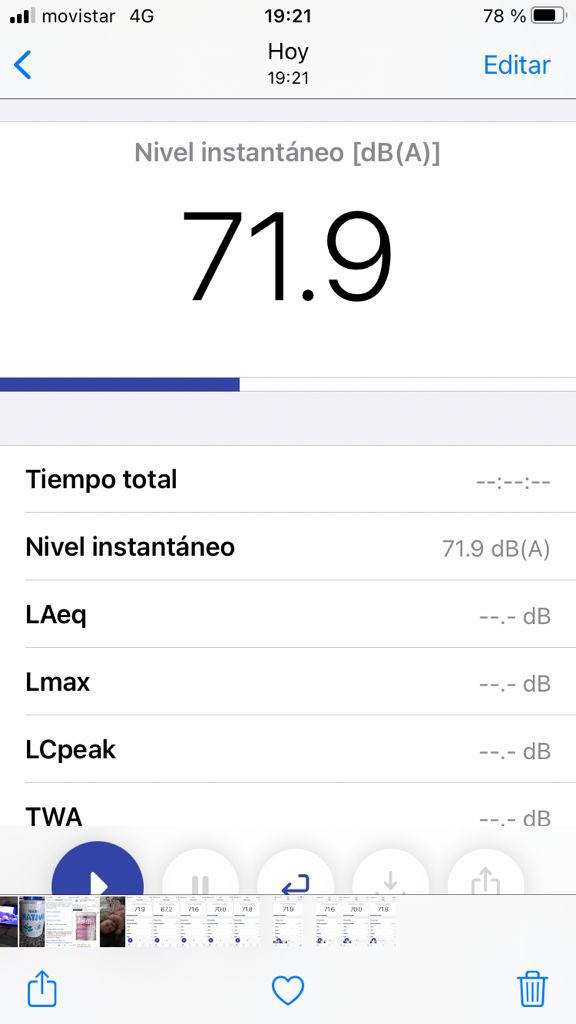

The lowest measurement that my wife has managed to record acid of 70.0 decibels

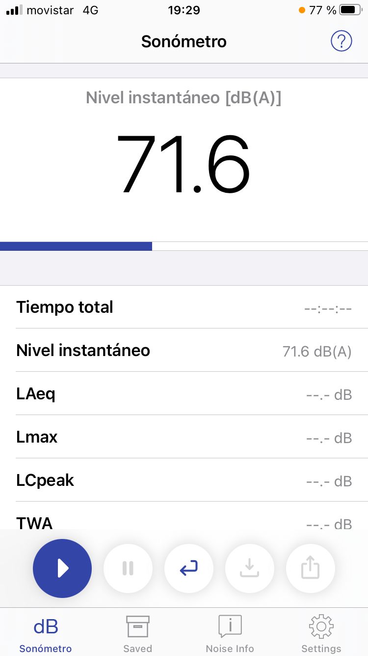

Measurements at a speed between 100 and 130 there is not much variation.  measures in the radial highway m40 in Madrid an area with good asphalt.  I'm going to measure and on other types of asphalt
this would correspond to
what I am getting at 120 km/h on poor porous asphalt but after extensive soundproofing. I’d need to check at 140 km/h what I get at.
I guess most Of your noise is also the wind and engine plus some tire noise.
just to confirm you had the AC / ventilation and radio off? BTW I place my phone in a holder that is clipped to the front ventilation so what I register at my head level would be a bit different than what my phone pics.

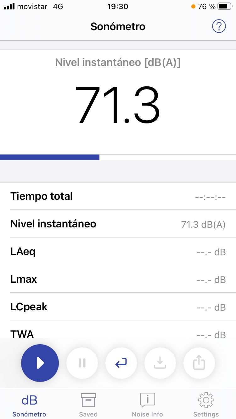

The measurement has been made by my wife in the left rear seat (behind me). I wanted to do it in front but a strong storm has fallen and there was no road to play dumb ...
I'll make another measurement by putting where you say with the air off.

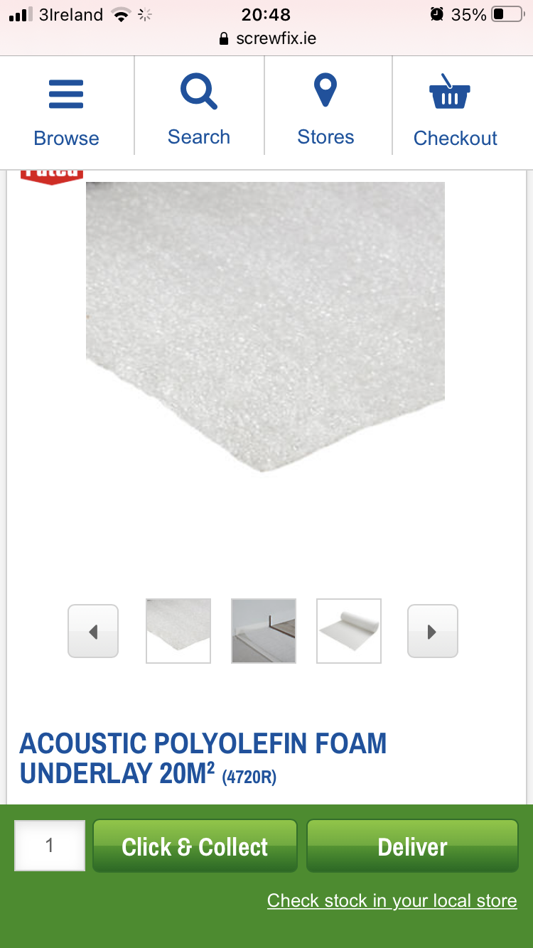

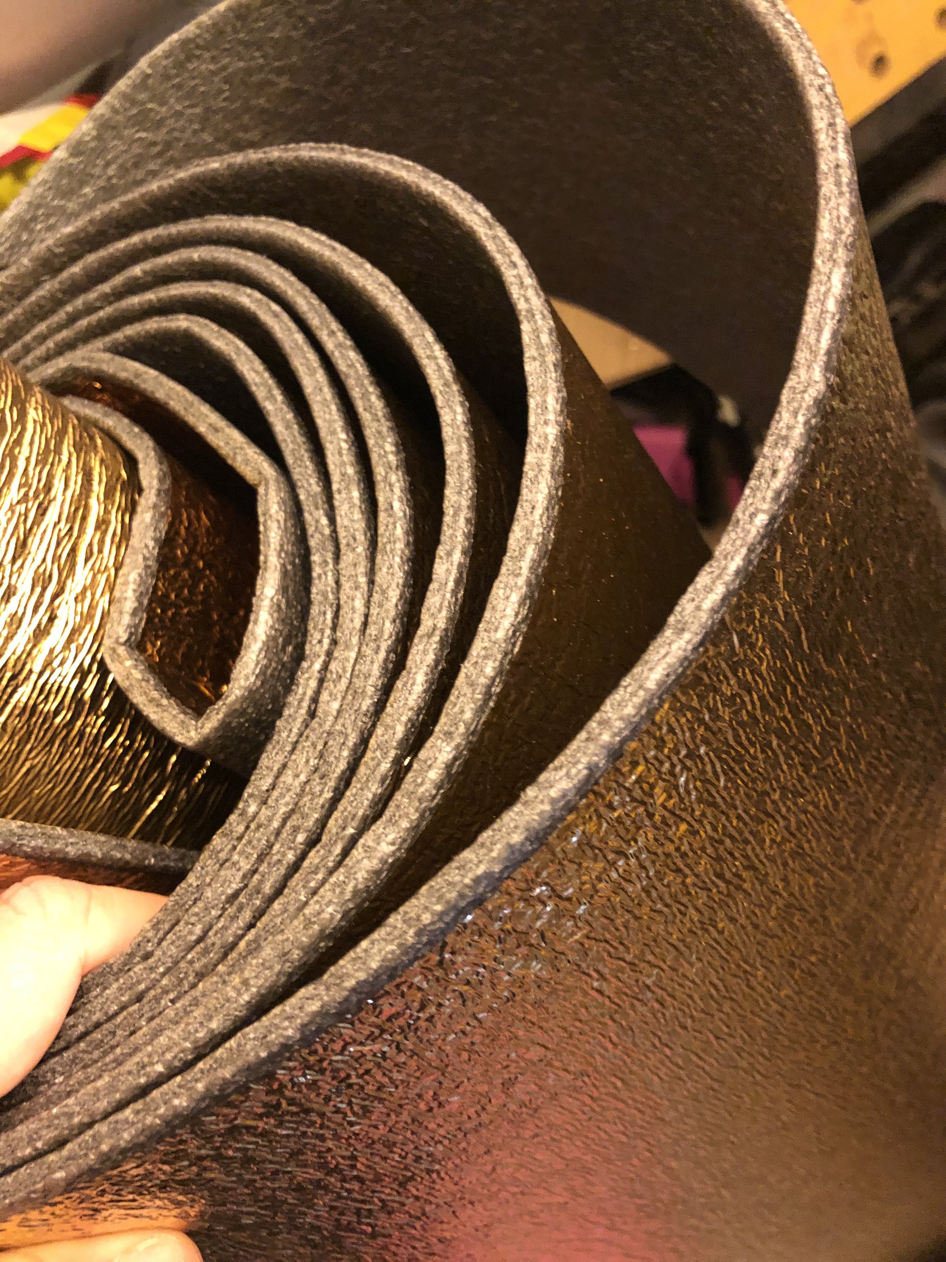

BTW my foam carpet / laminate panel underlay is much thicker than the picture from the internet I attached. I'll send a proper picture this week. this thing is super cheap for what it does.

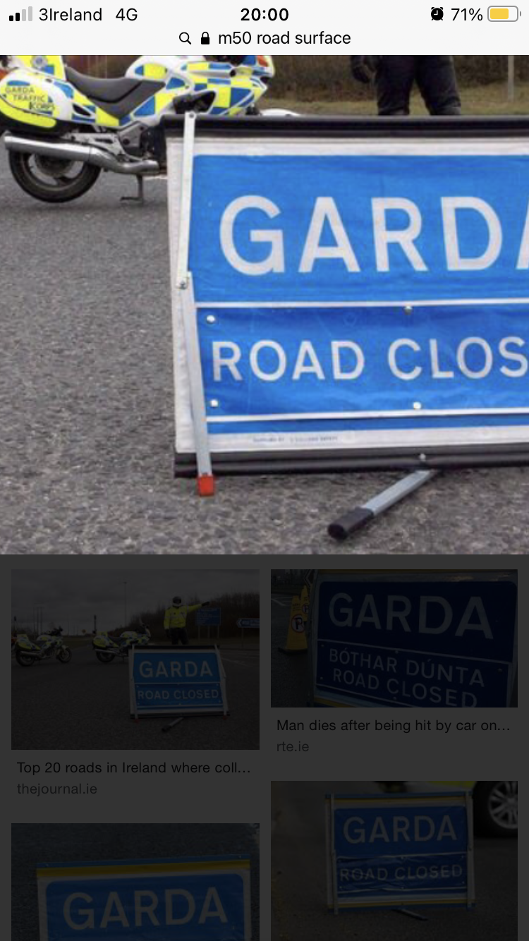

i just went for another drive and at 120km/h and I get roughly the same values as you. This is on a coarse stretch with the surface being the type you see in the picture I got in the internet
i can confirm that there is no major increase in noise level between 110-140. Before I did the sound deadening of the floor there would be a
major increase in noise depending on The speed. So 120 km/h was loud, 110 acceptable, 140 km/h way too loud. This must have been caused by vibrations which are largely eliminated now. If you experience the same absence of major noise increase
as the speed increases it indicates you don't have have as much vibration issues on your roads.
I also drove over the part of the motorway which I would describe As relatively smooth and then my db level falls to something like 67-68db. This means nearly nothing in terms of noise and vibrations coming through the floor, a tiny bit of tire noise through the doors, and of course wind and the motor hum. It’s a very nice noise level and combination.
also attached is the oic of the carpet / laminate panel underlay I have

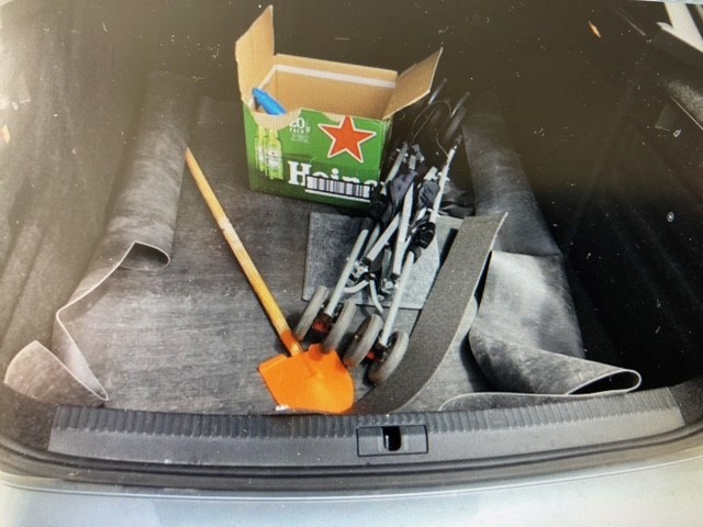

Today I laid my remaining half of mass loaded vinyl on top of the boot cover to see if I can get much more soundproofing after laying butyl there Sadly no game changing improvement. I think I will put  it next on the wheel arches covers  to see what achieve there

I tried yesterday but I can't upload stuff more that 200kb (0.2mb) large for some reason. Anyway a low resolution picture is below. I simply laid the VML roll I still have on top of the usual boot cover. No visible improvement

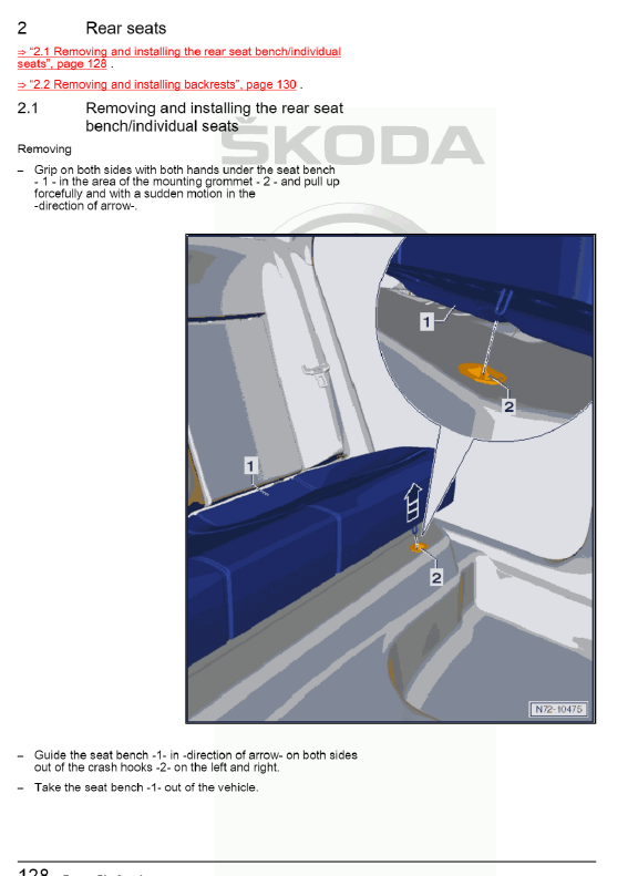

Any clues for lifting the rear seats in the estate to pad out the underside.
the rear bench (the thing you sit on) or rear seats (the thing you lean your back against)? I took out the first one, you pull up on both sides and it will click out, than you have to pull it towards you while pressing downwards. The first bit was super easy, the second one took me a lot of time, my couch didn't want to unhook. There are loads of videos on youtube.
If you mean the rear seats then no clue

hey I have more pics but the system doesnt allow me to post them. I'll try to pm you
Thanks for that info ! I was trying to lift from the back! No wonder I wasn't having much luck!

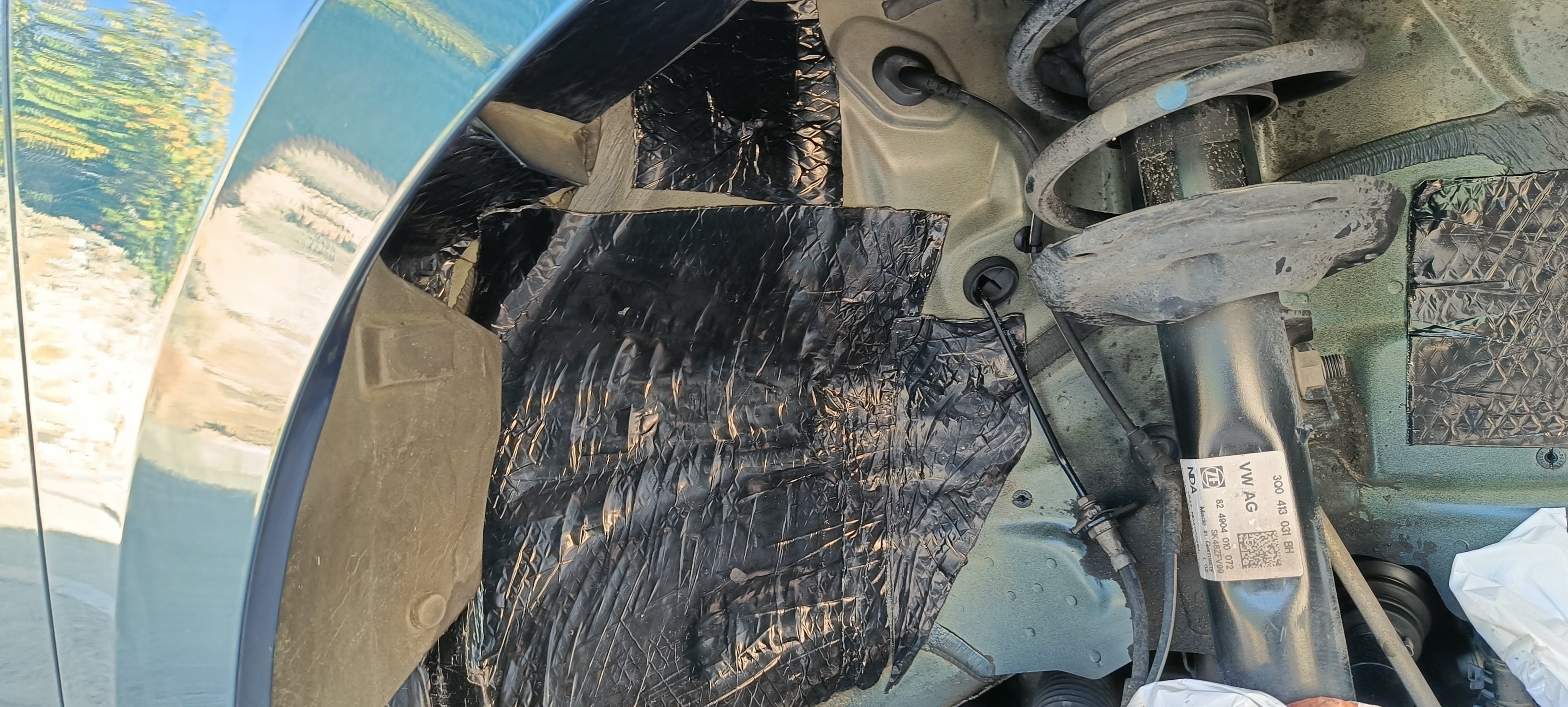

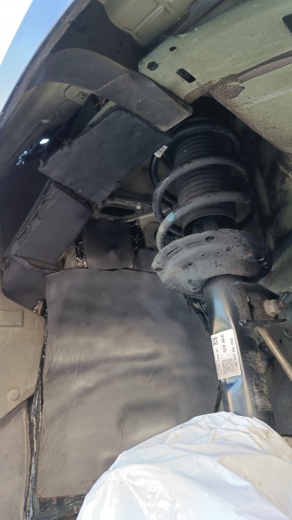

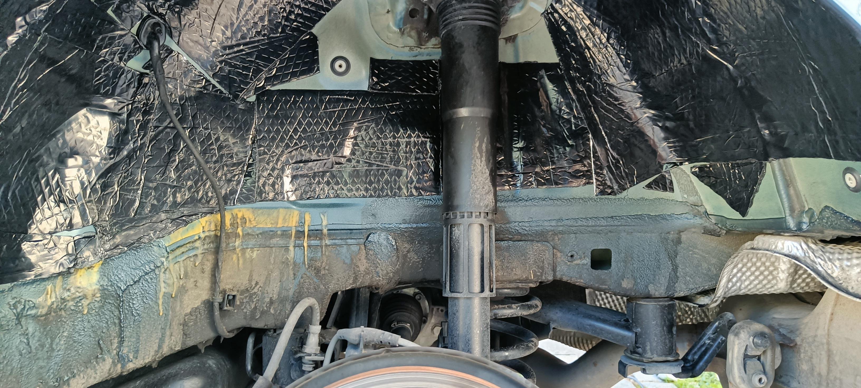

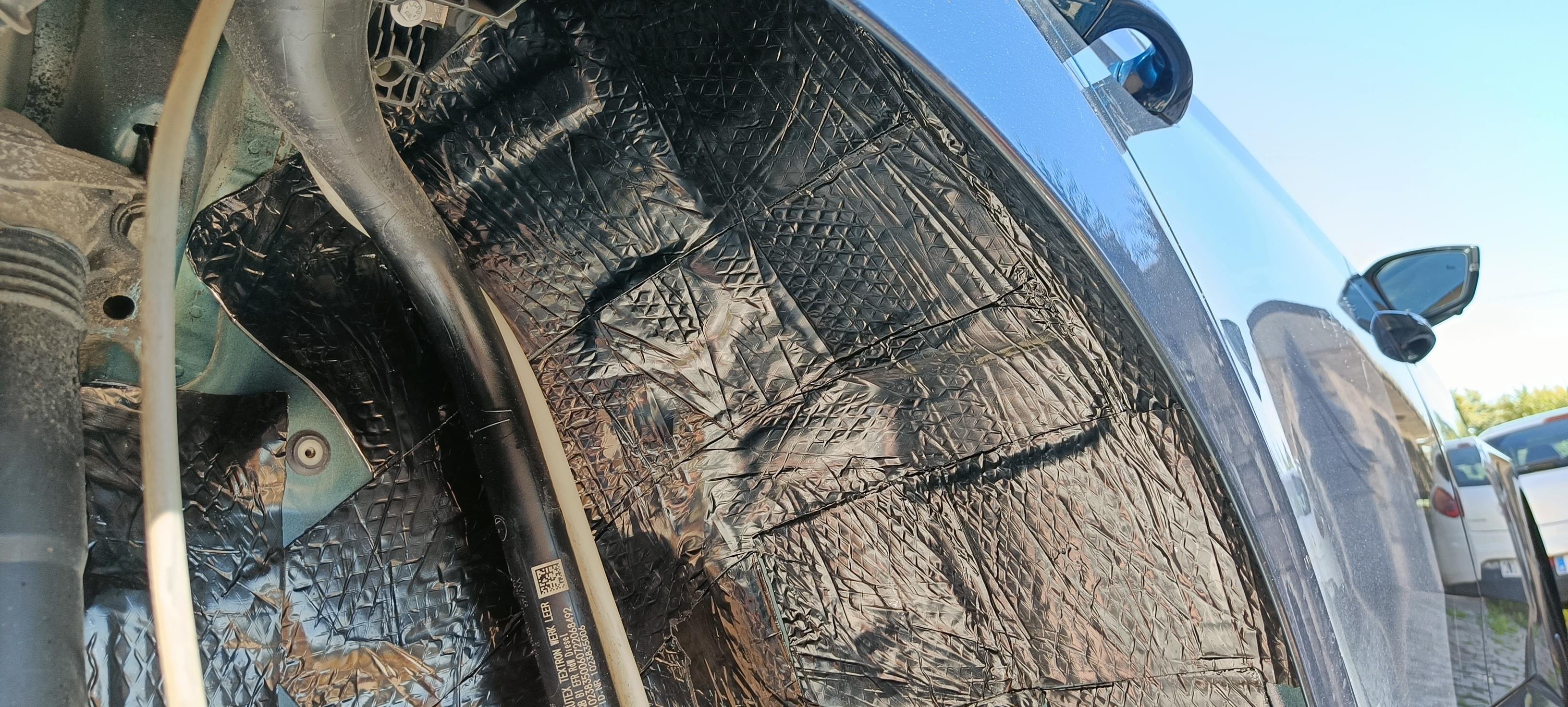

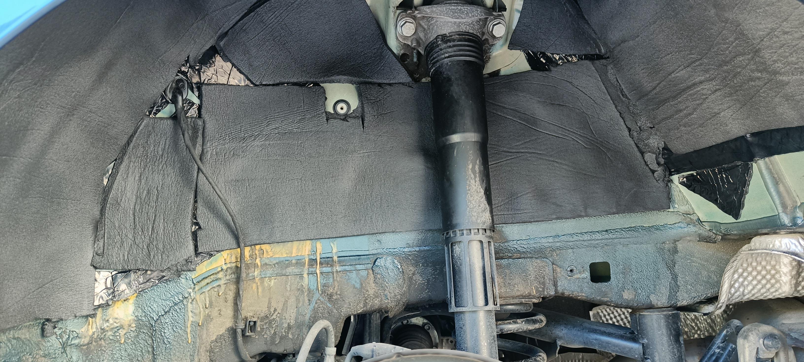

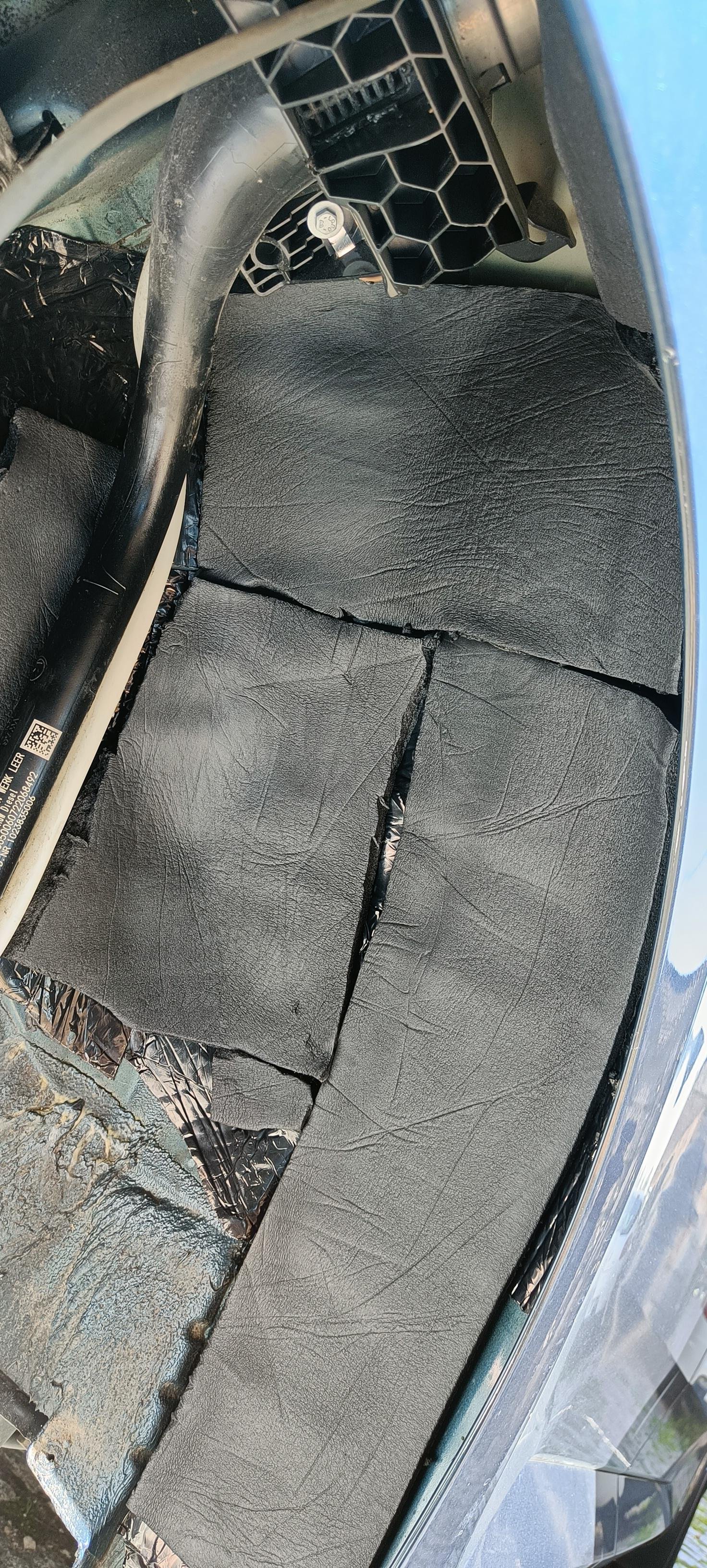

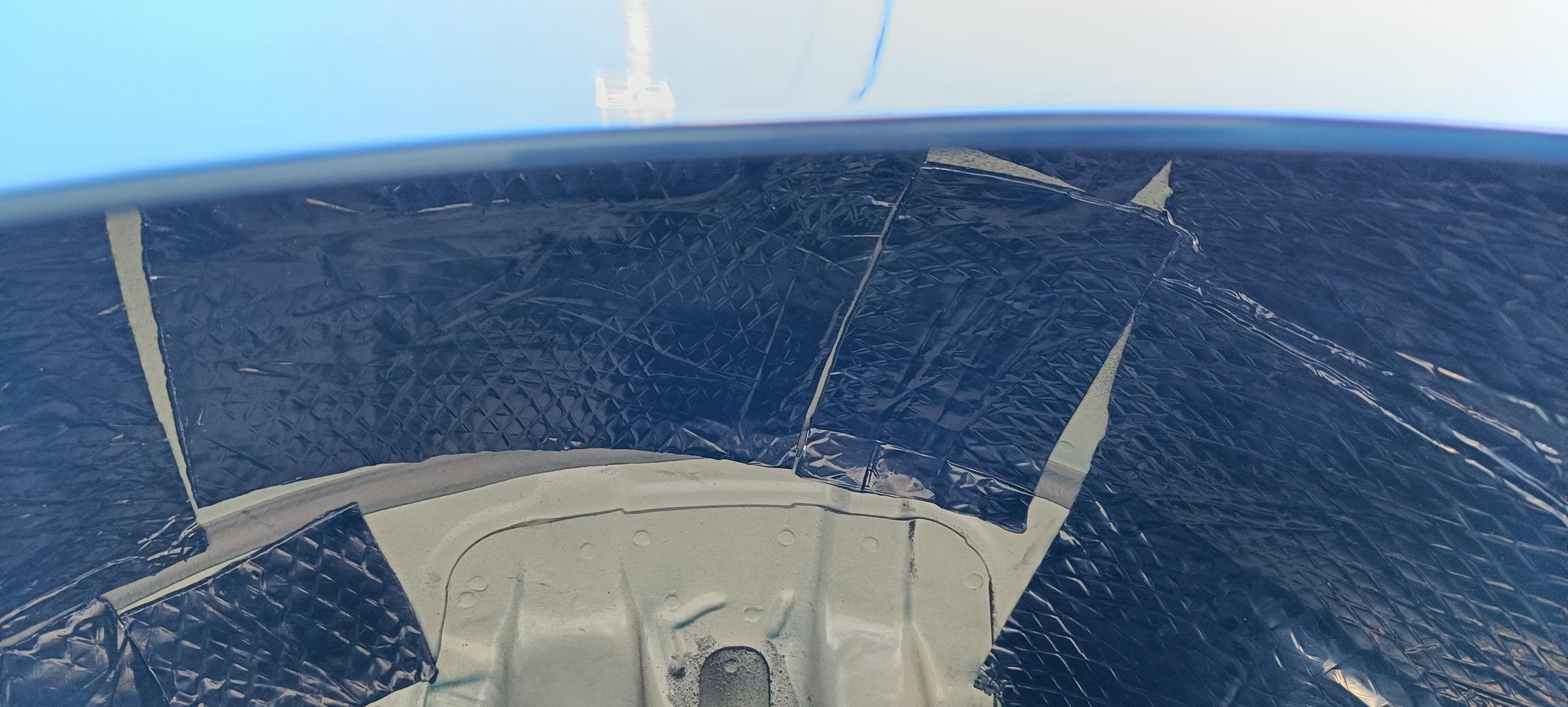

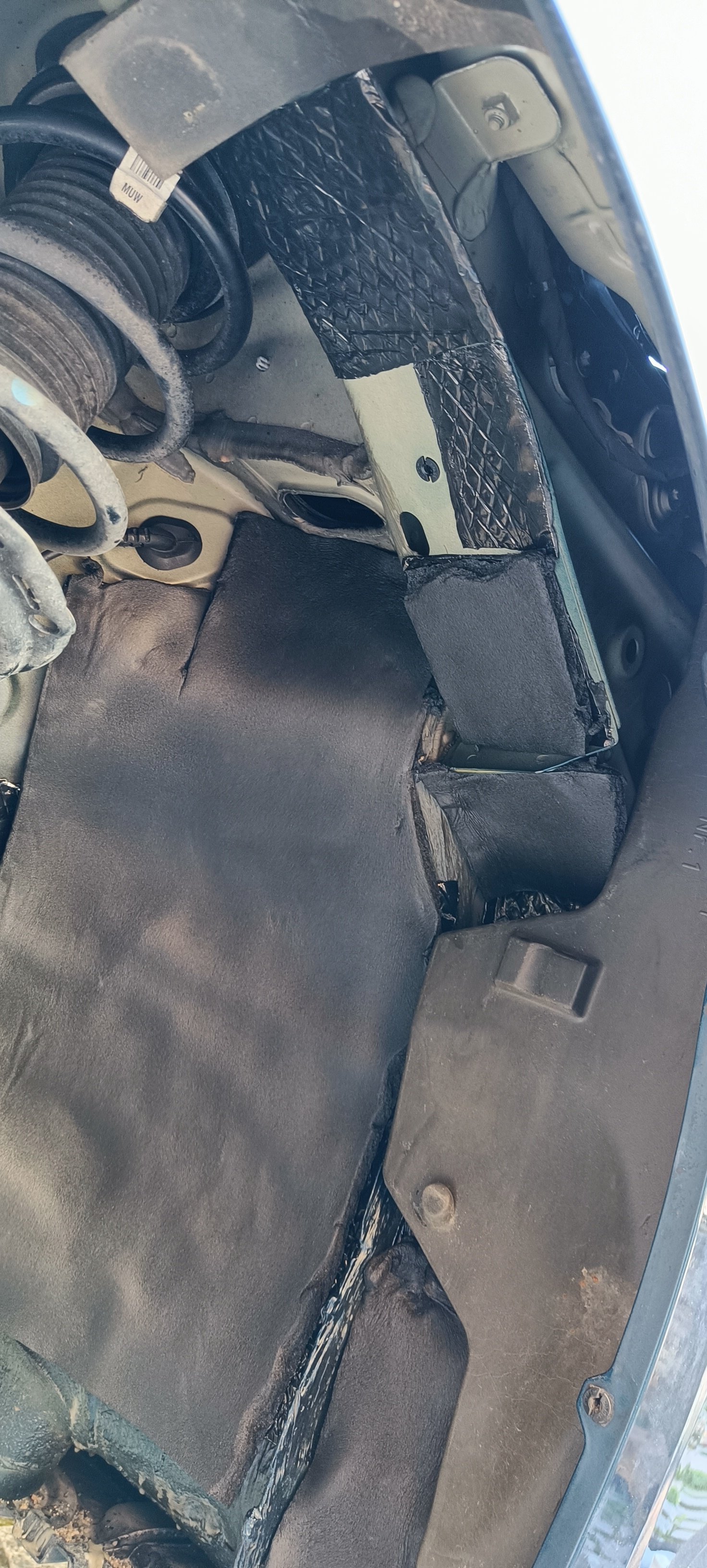

Hello! I continue with the soundproofing, yesterday I did the rear wheel arches from the outside. Noico of 0.4 mm and kaiflex of 8mm from Aliexpress, in 5o kms by highway in Madrid I have not noticed anything from the front. To say that this stretch of highway is quite smooth. Today I will do the front wheels and as soon as I have time the doors.
Hey Gabriel,
So are you saying there was noticeable improvement or that you couldn't 100% measure it because the road was so good there would be no noise anyway? Would you be able to do the front only, without doing the doors yet, and test it on a rough tarmac before and after?

22 hours ago, lukk said:
Oye Gabriel,
Entonces, ¿está diciendo que hubo una mejora notable o que no pudo medirla al 100% porque la carretera era tan buena que de todos modos no habría ruido? ¿Podrías hacer solo el frente, sin hacer las puertas todavía, y probarlo en un asfalto en bruto antes y después?
After doing the forward steps as well, I would be hard-pressed to tell if there is improvement or not.  Perhaps there is a more attenuated noise, but quantifying it in decibels would be difficult.  I will do some measurements with the iPhone app that I did a few months ago for the same section and I will check.  Currently I can say that it does not compensate the work with the result.

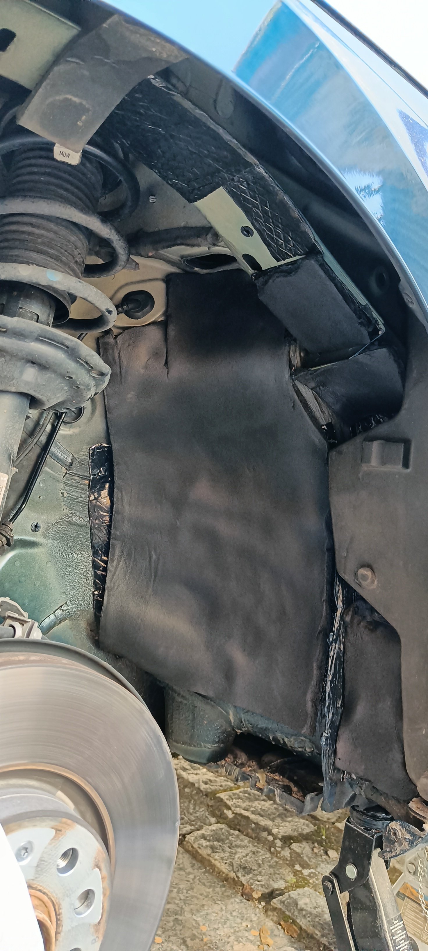

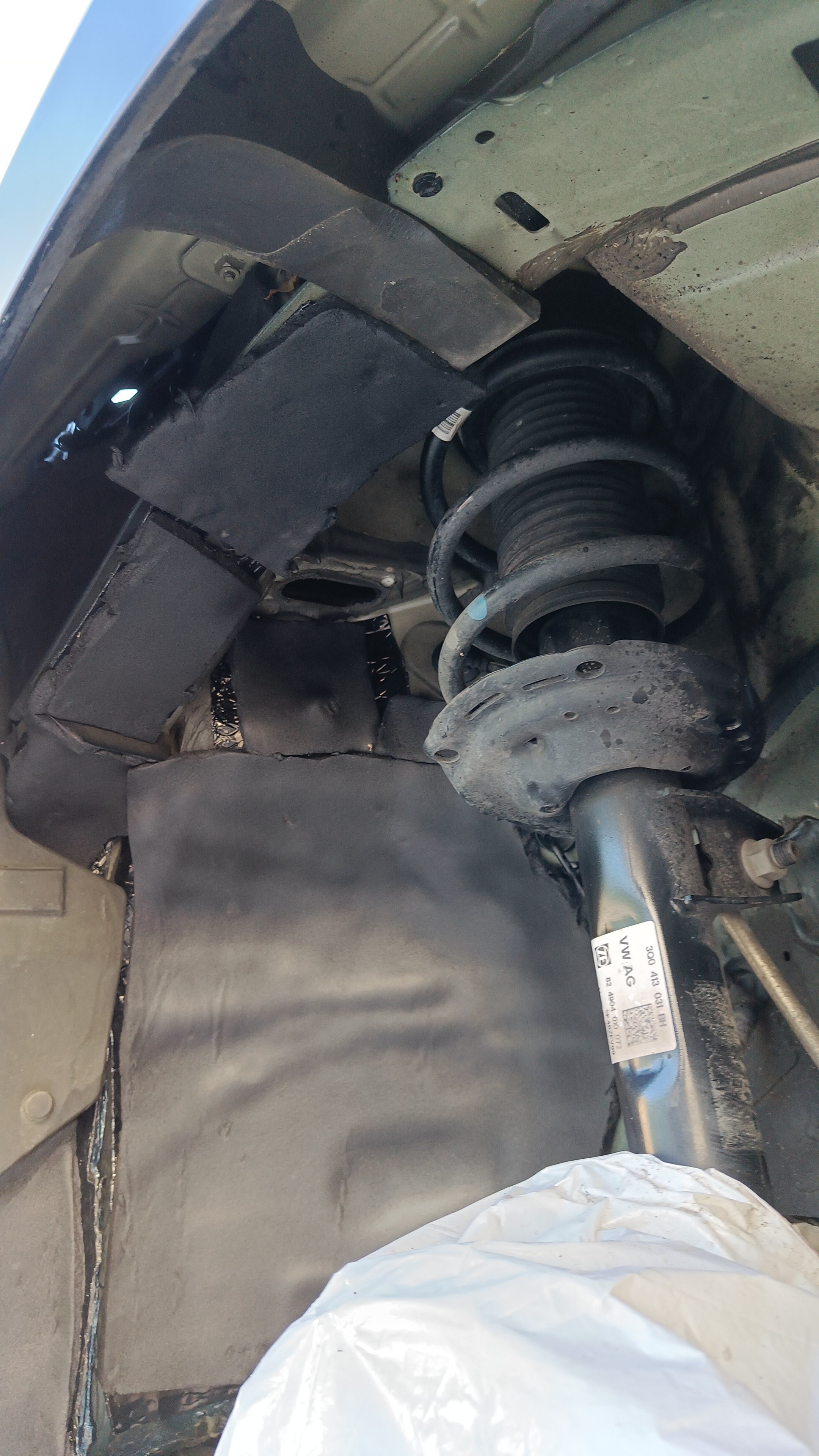

I did one of the front doors yesterday.  I made a rookie mistake by overheating the tweeter cap and melting it, tomorrow I'll look for another one that sure isn't cheap.
The change is brutal.  This is very noticeable, the noise reduction is amazing, considering that it really only had the driver's door finished.  I hope to finish 4 this week.
