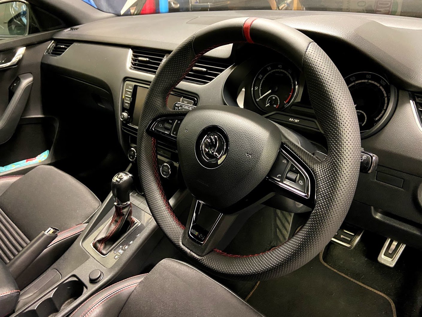

Fitted a new steering wheel today 🥰
I’ve never been a fan of flat bottoms (😜) and one of the best upgrades on my old S4 was a chunky RS5 wheel, so when a round steering wheel with DSG paddles popped up on eBay I grabbed it and sent it straight off to Jack at Royal Steering Wheels. They did an amazing job - thickness increased by 2mm, fresh perforated leather to match the original, red stitching and a cheeky red sight ring to finish it off (inspired by the Golf GTI Clubsport).
Took around an hour to swap over and transplant the trims and buttons. Feels so much better to drive now - the new wheel fills out your palms and it no longer bumps through your hand when manoeuvring.  Love it!

This might not be everyone's cuppa tea, but for me it was well worth it.  Call me old fashioned!

Never had a flat bottomed wheel, once talked to a bloke in a tyre place who had endless problems with an audi with a flat bottom wheel that several garages could not make it line up correctly when driving straight ahead, said he was sick of it.
Anyhow great thread, nice motor.
Cheers @kentdale 👍
I'm super OCD about a straight steering wheel too.  Took mine back to the local alignment shop to get it adjusted twice after having the Eibach springs fitted.  Gotta be right though!
