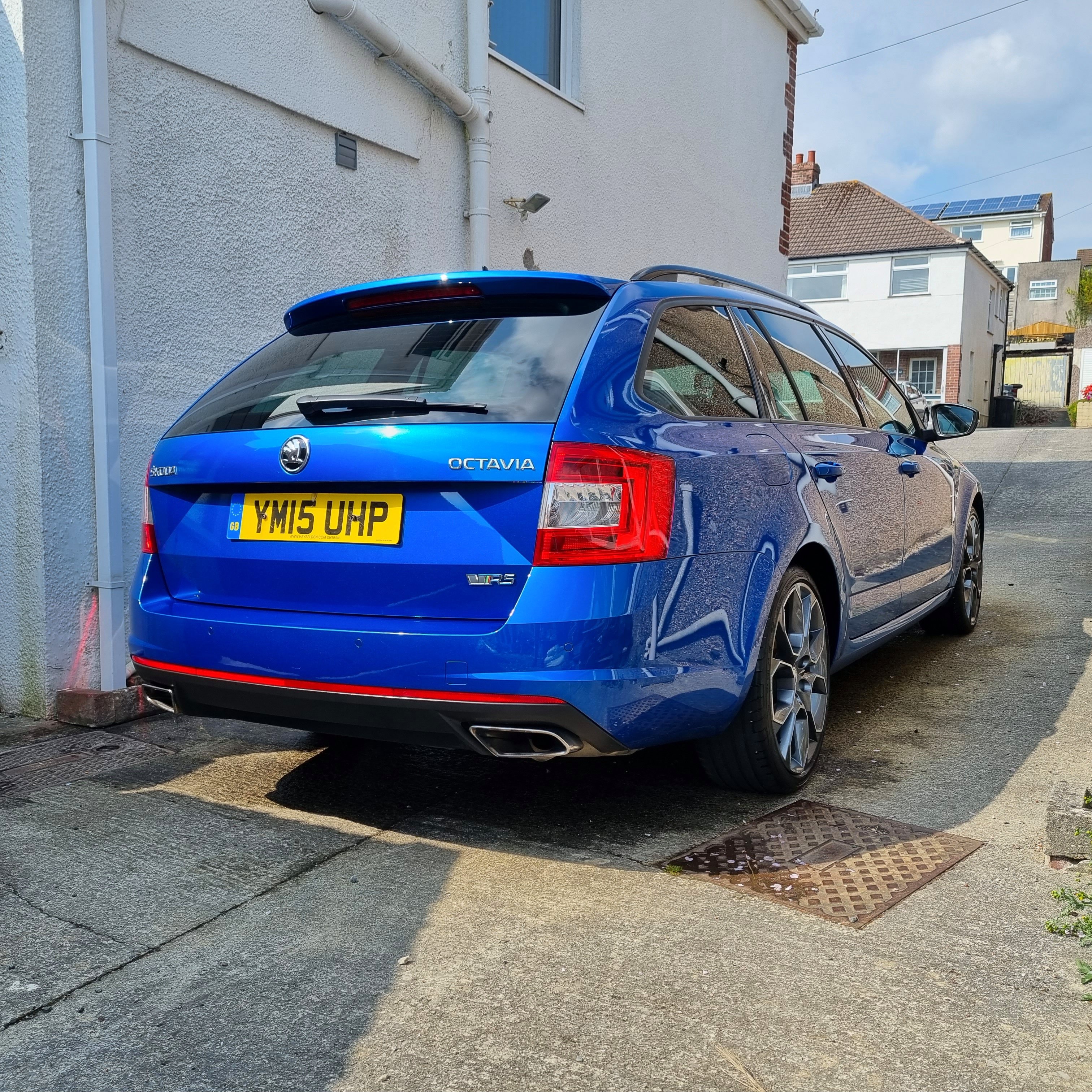

  • A few photos showing off the refurbed wheels and new brakes 🤩

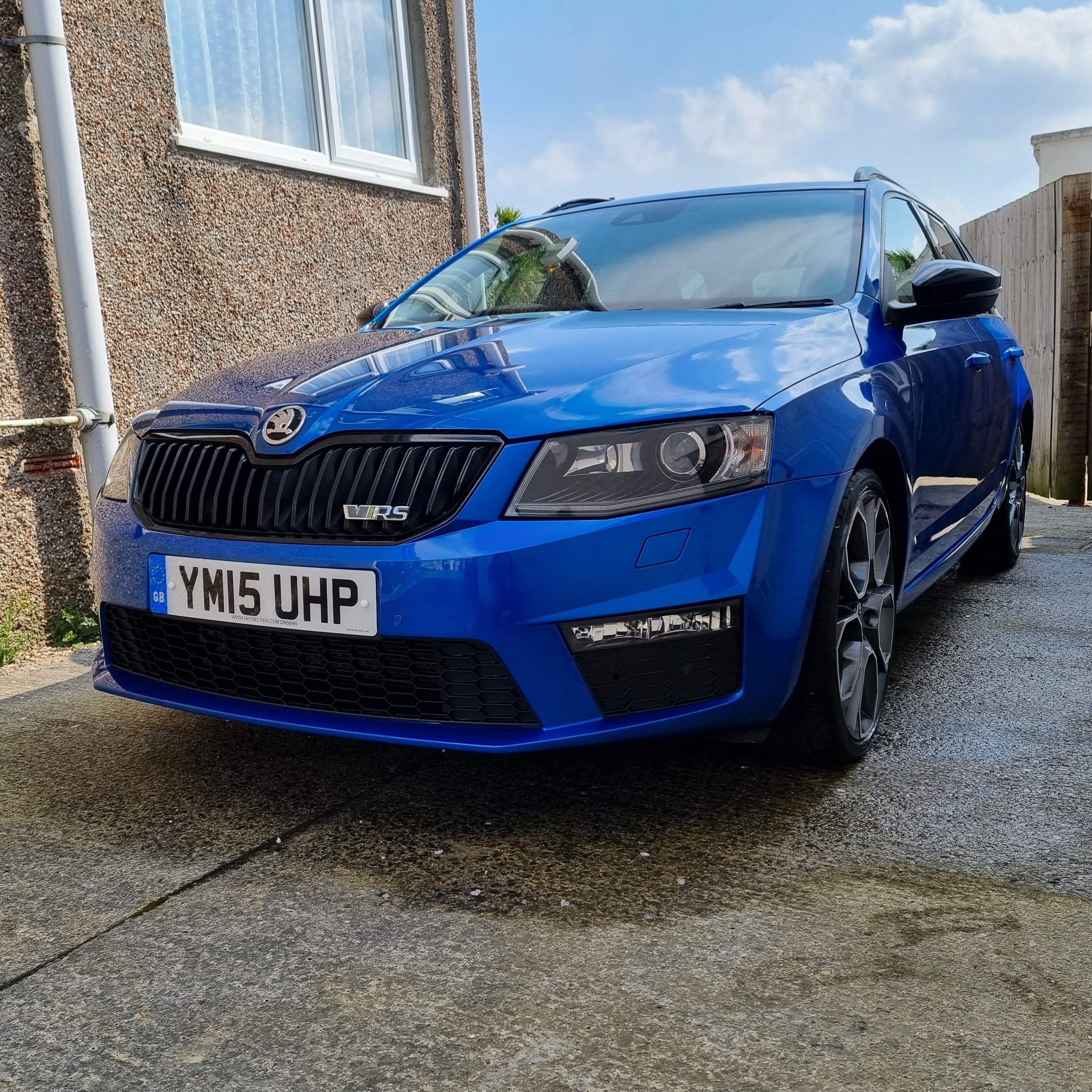

  • Couple of recent photos taken with the roofbox fitted, ready to swallow up all the gear we 'need' for our family trips
