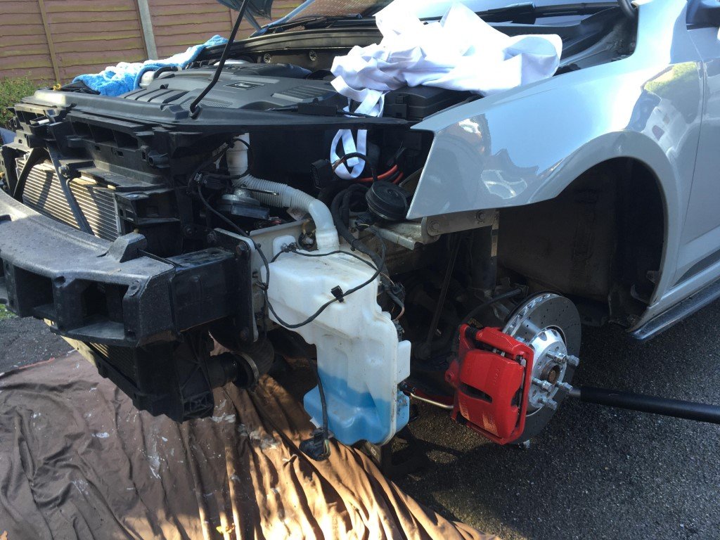

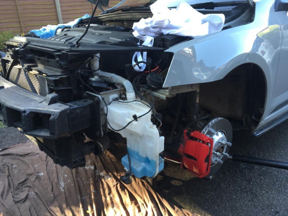

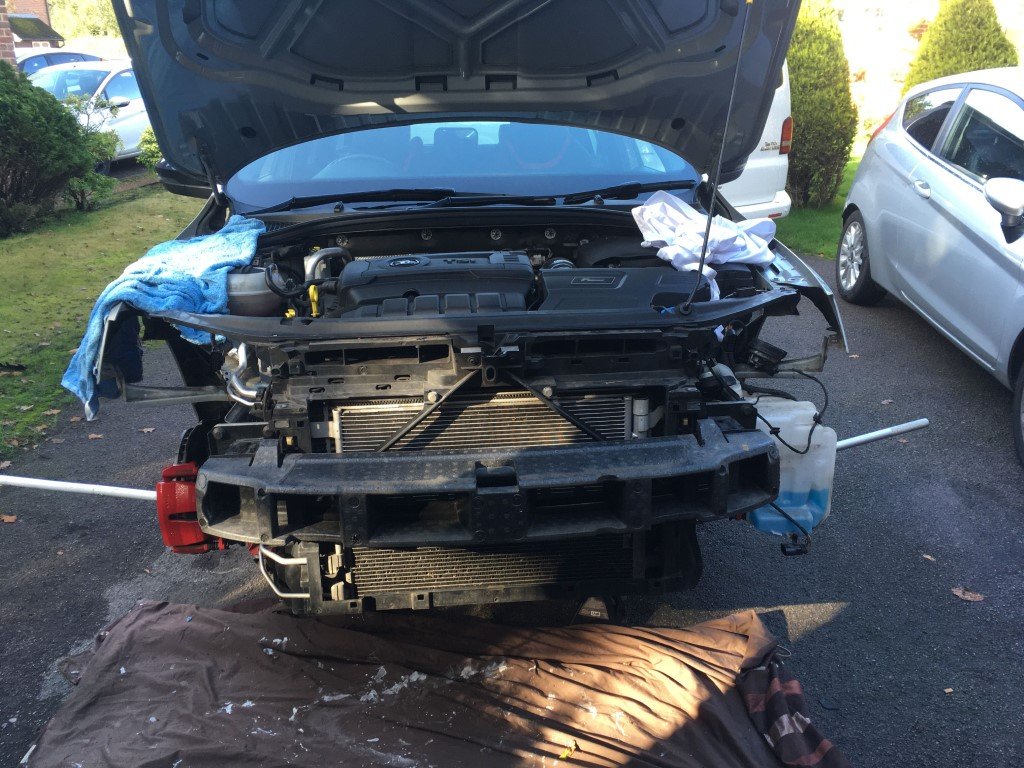

Wheels, arch liners and bumper removed:

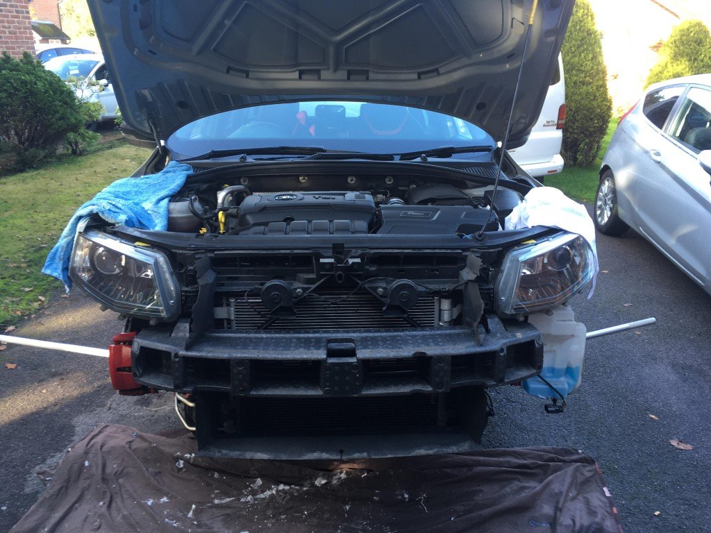

Lights and horns removed:

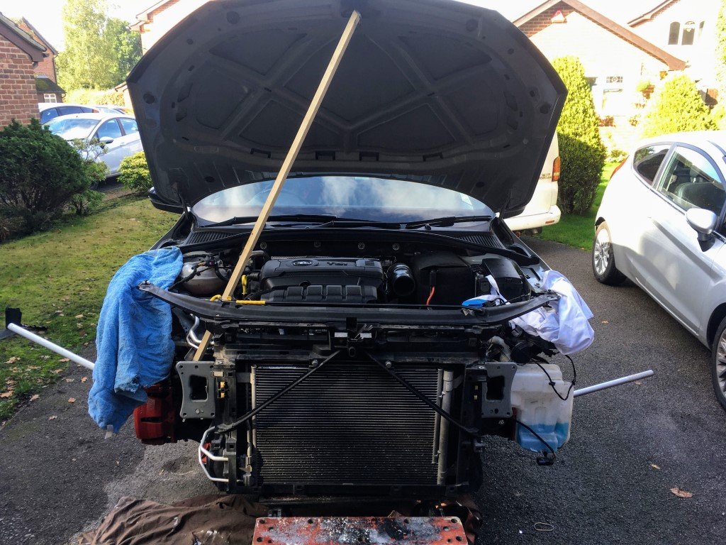

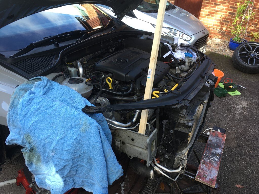

Air guides and crash structure removed (note the ghetto bonnet prop – the structure that holds the bonnet up also has to be removed):

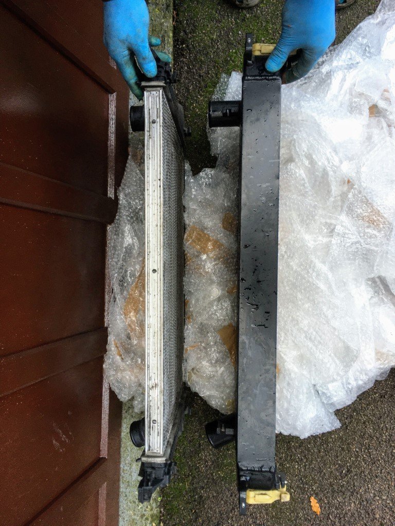

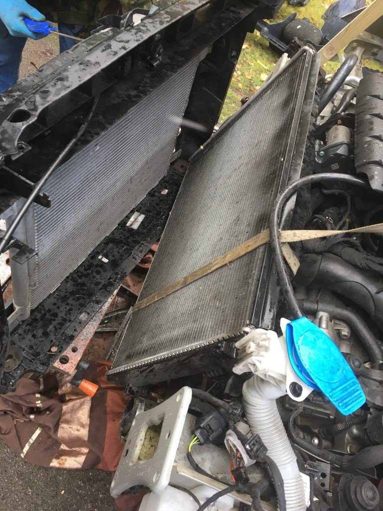

Radiator pack separated and original intercooler removed (it sits in between the AC and coolant rads):

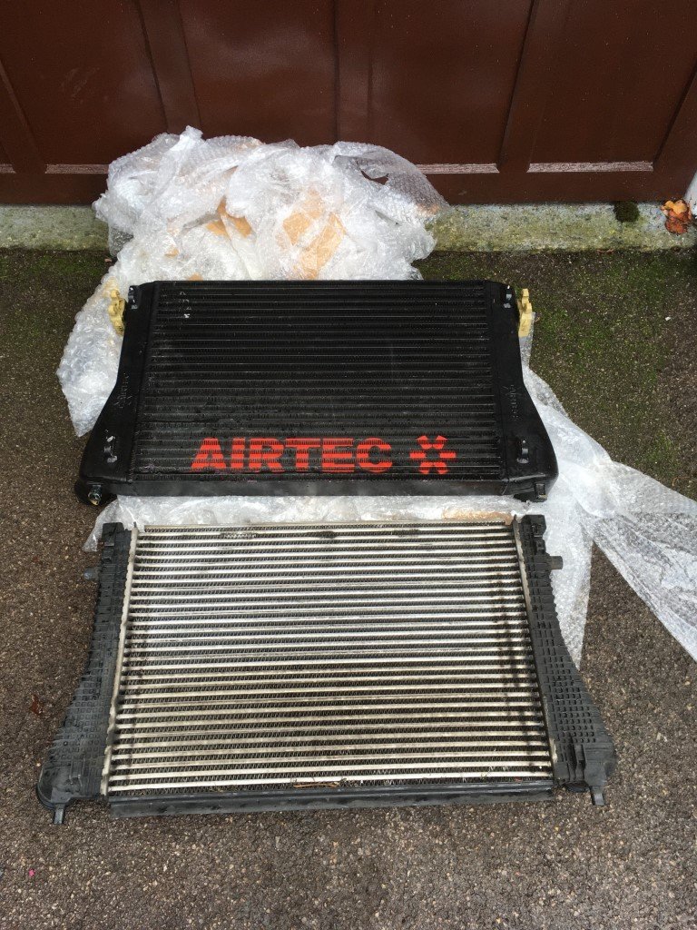

New intercooler is roughly the same height/width as the original:
…but crucially is much thicker, with a less restrictive core and twice as many cooling fins:

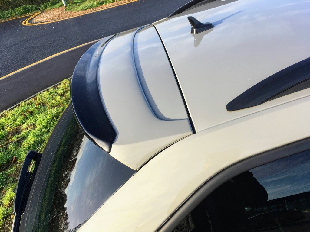

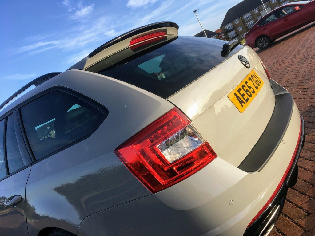

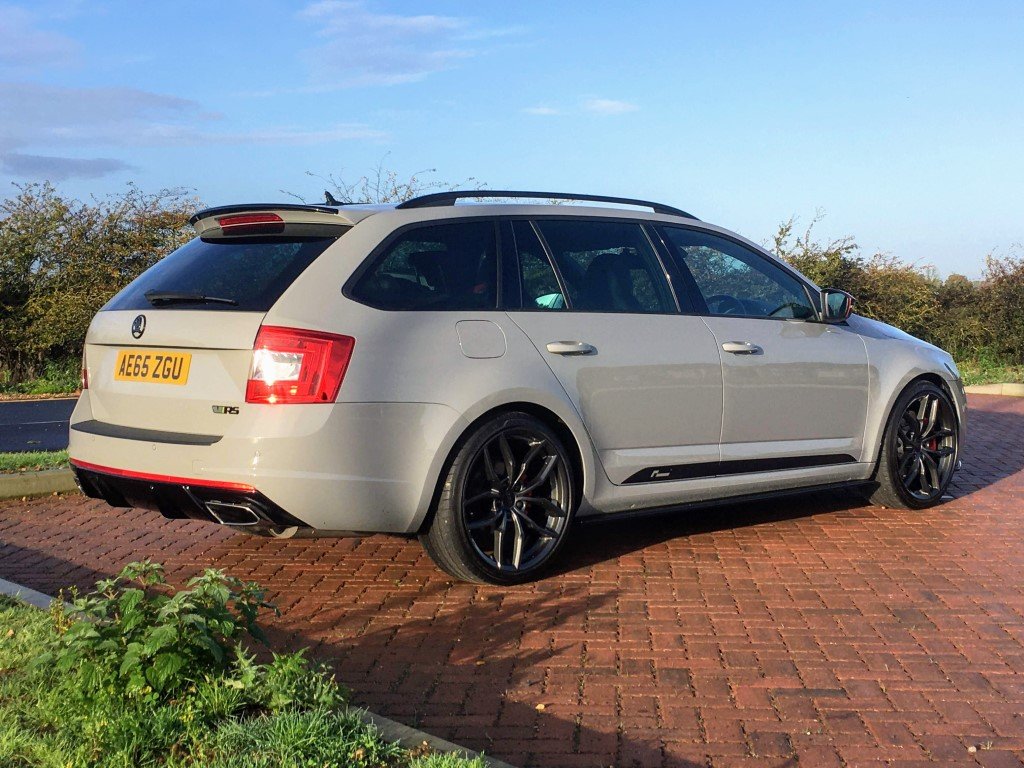

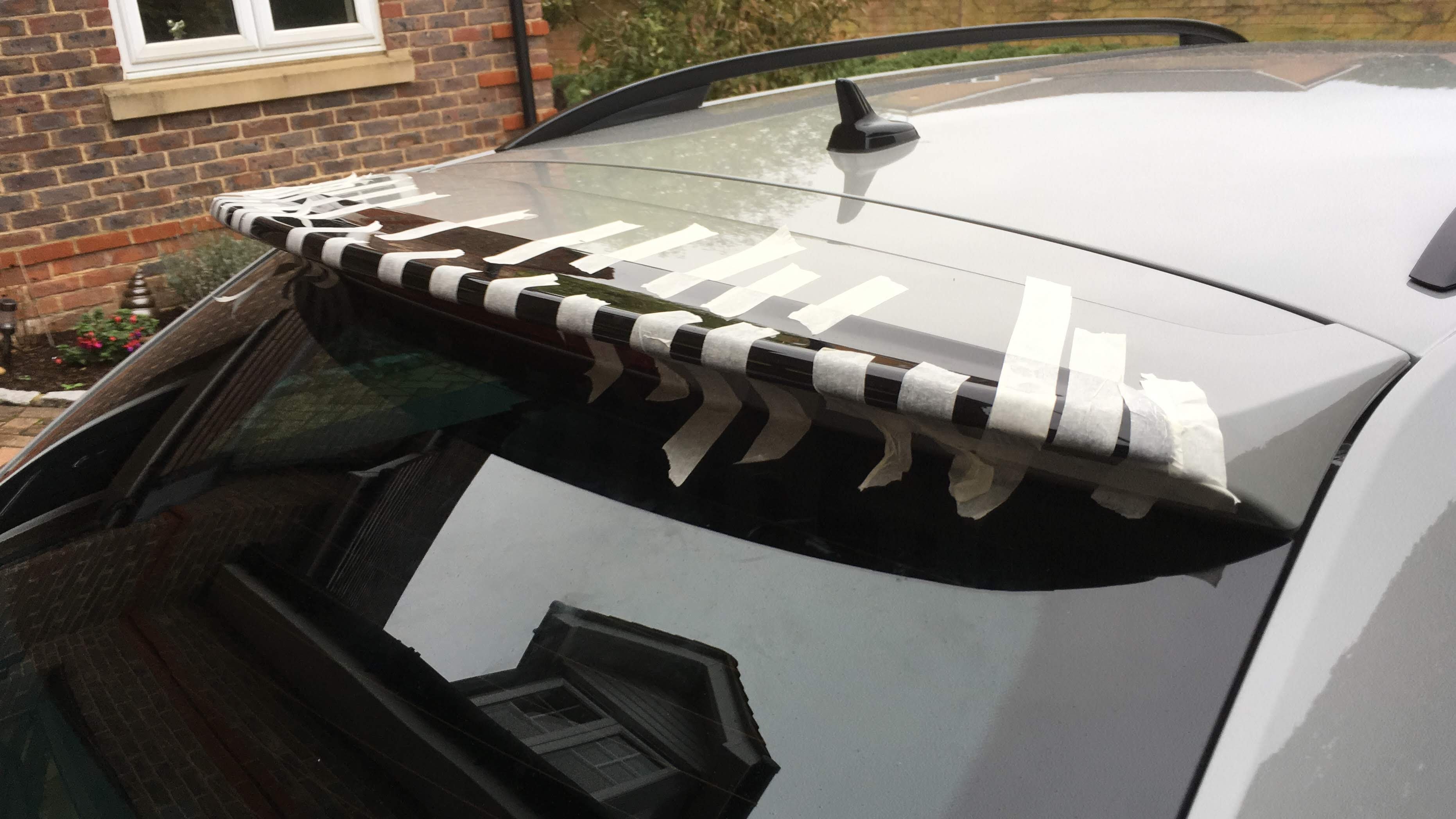

Another nice mod ticked off the list this weekend - Milotec rear spoiler 😎
This was kindly supplied by Alex at AKS Tuning and I believe he still has some in stock from a recent group buy.  Grab one while you can as they look awesome!
The instructions state that you need two people to fit this, and after tackling it alone due to the usual free time constraints I can see why!  Prepping the spoiler is a doddle, and it fits like a glove, but as it's bonded with adhesive you need to hold it in place whilst taping it down so that it stays secure for the 24 hour curing time.  You also need to wipe away excess adhesive that appears when you press the spoiler onto the bodywork, but I managed it alone and I'm very happy to report that it's still attached to the car 😄
Goes really nicely with the other bodywork extensions (front splitter, side skirts and rear diffuser), so just the tailpipes to de-chrome and job's a good'un 👍
