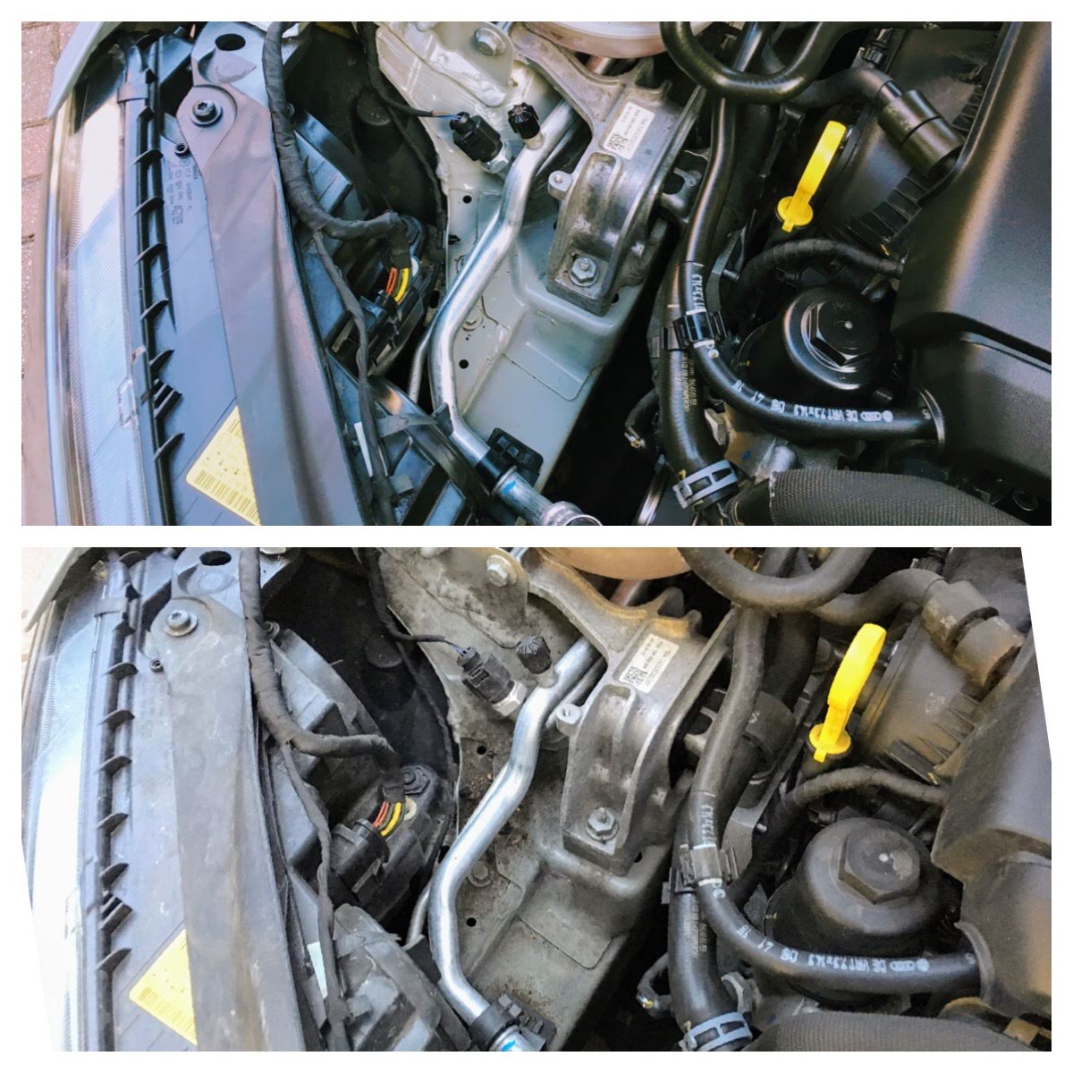

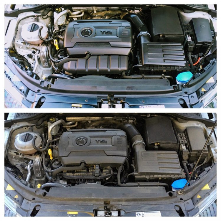

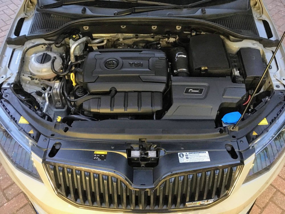

In preparation for the forthcoming intake modifications I spruced up the engine bay this weekend.
It was so grim beforehand that I needed to de-grease it with a strong solution of Fairy Liquid before dressing the trims with 303 Aerospace Protectant.

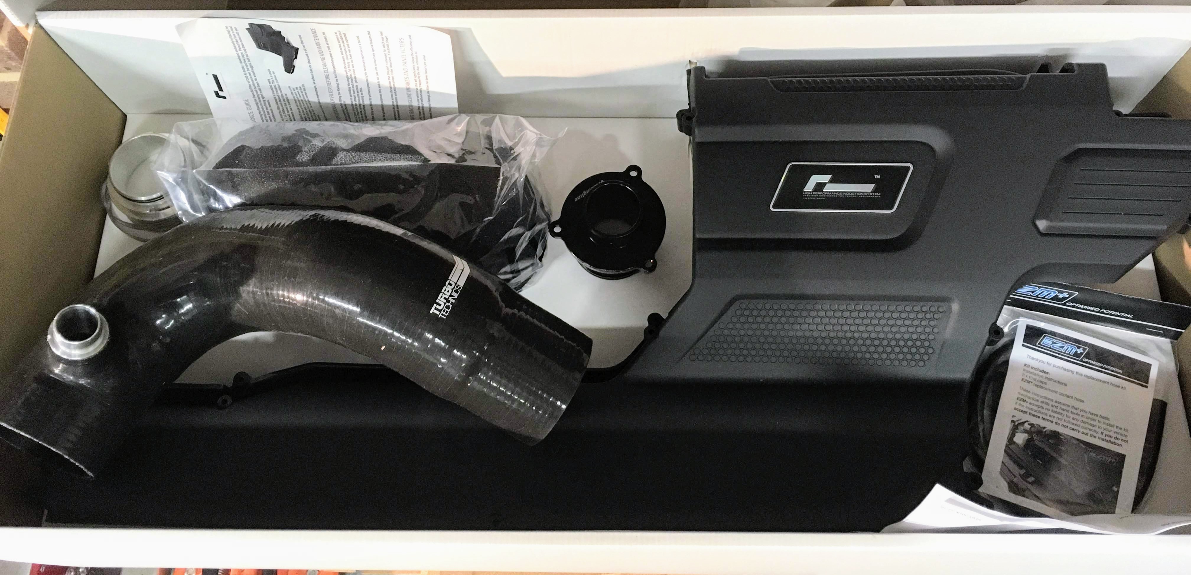

Also added the inlet manifold cover to tidy things up a bit.  Part numbers for anyone who's interested:
  • 06K103925AA - Inlet manifold cover
  • 06E103164 – Pin
Passenger-side
Driver's side
Much better!

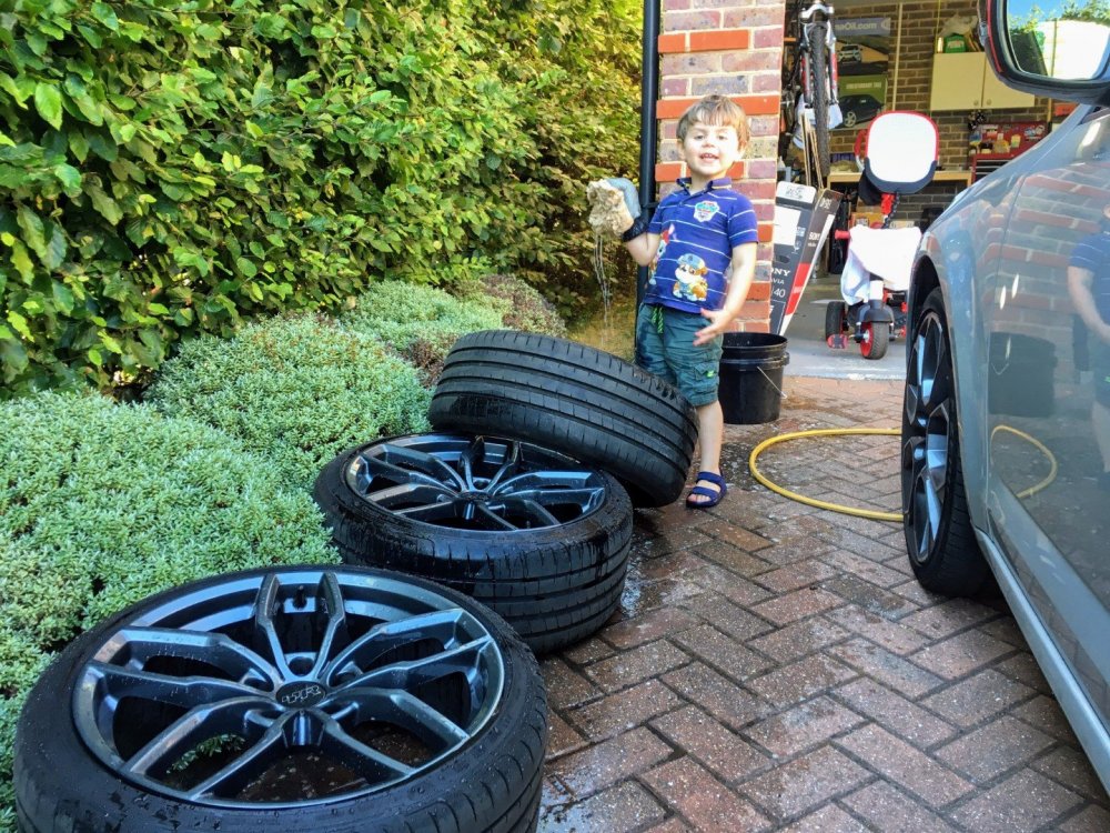

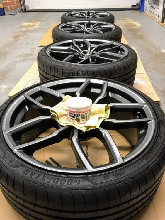

  • A few photos showing off the refurbed wheels and new brakes 🤩

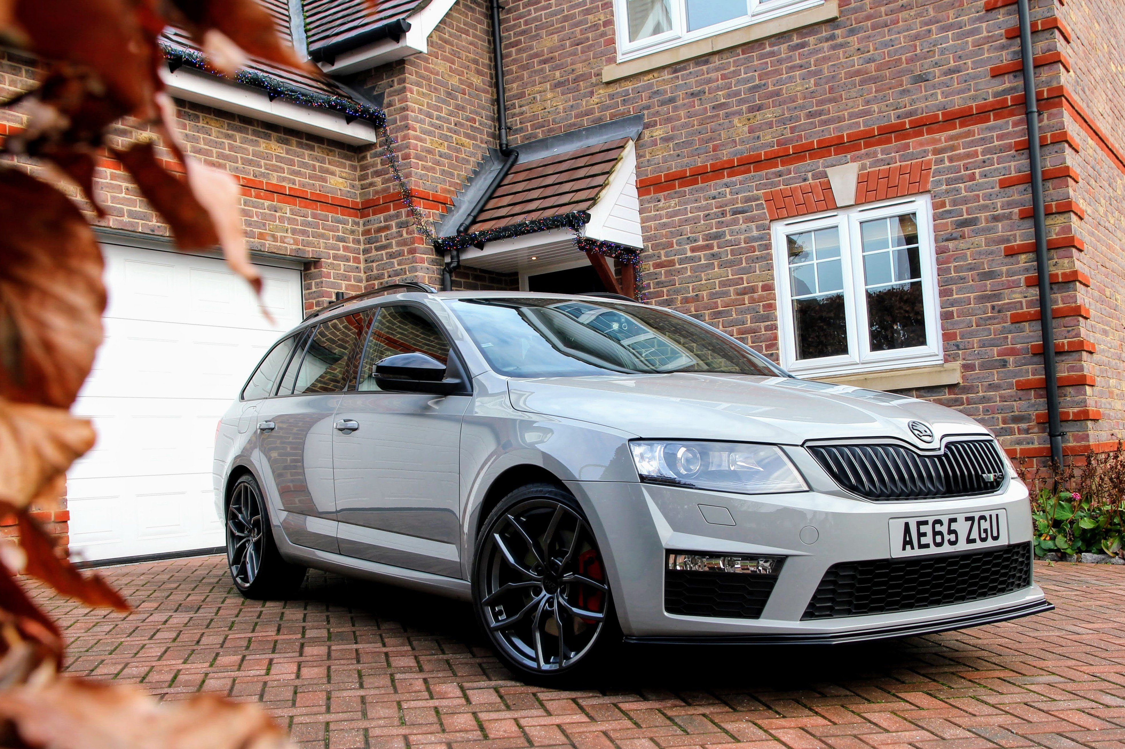

  • Couple of recent photos taken with the roofbox fitted, ready to swallow up all the gear we 'need' for our family trips

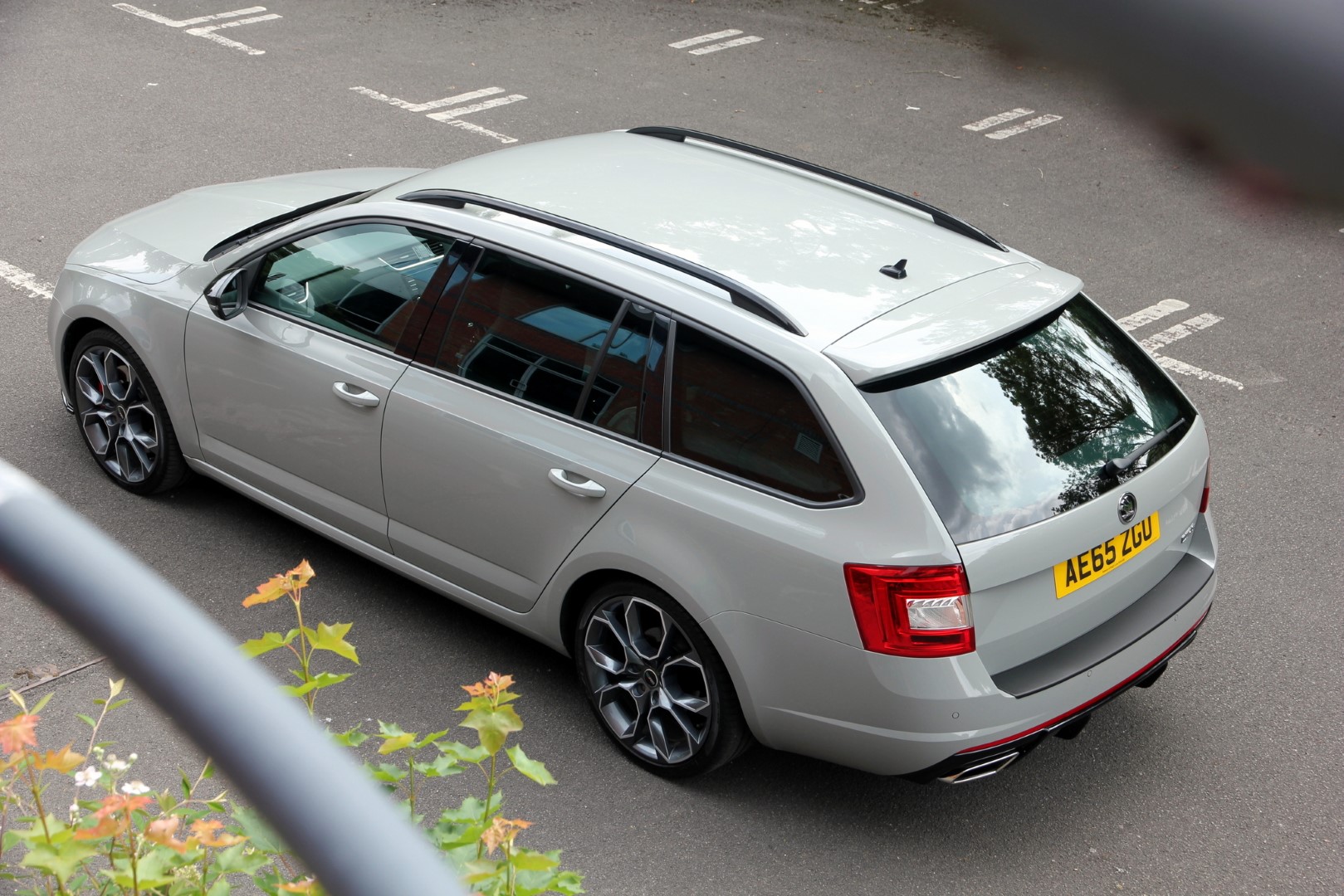

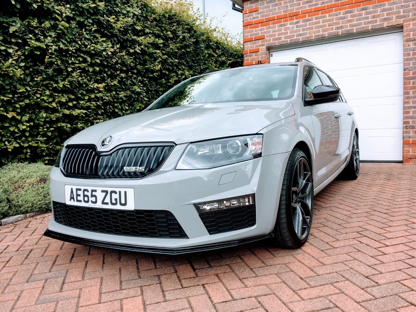

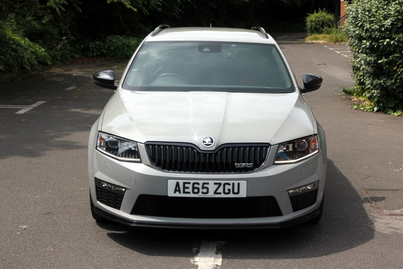

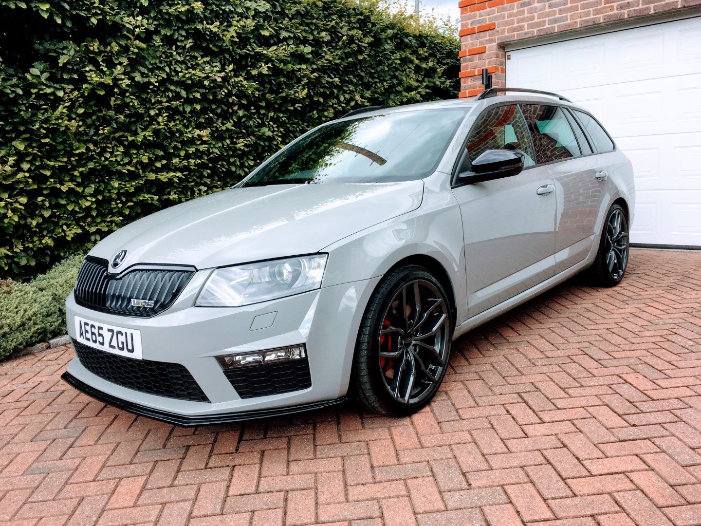

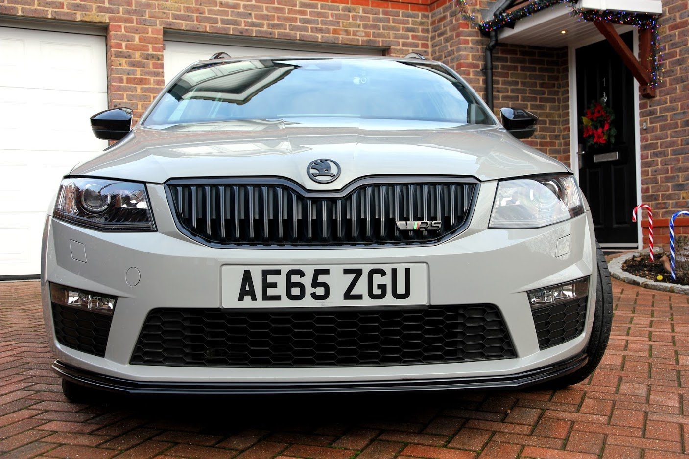

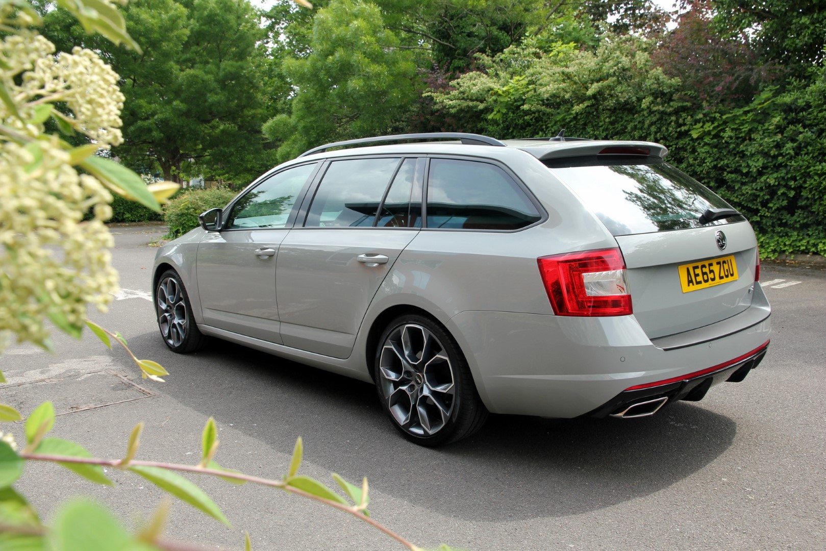

Looks awesome!  Love the style of the photos too.  Did you install both yourself?  Wondering if the front bumper needs to be drilled? :)
Edited by Baillie
Cheers @Baillie :thumbup:
Yes, I fitted them myself.  For the front you need to jack the car up and get it on axle stands.  The new splitter is held onto the car initially using 4 of the existing screw points on the undertray.  I also used some masking tape around the front edge to keep it from dropping down, but if you have a helper this stage would be much easier.  You then use the remaining holes in the splitter as guides for drilling, and screw through into the lower edge of the bumper with the provided self-tappers.  It's very secure in the end, no sealant or glue required.
So yes, you will end up with a few holes in the bumper.  But if you removed the splitter you could fill these quite easily, paint them with a touch-up kit and be none the wiser.

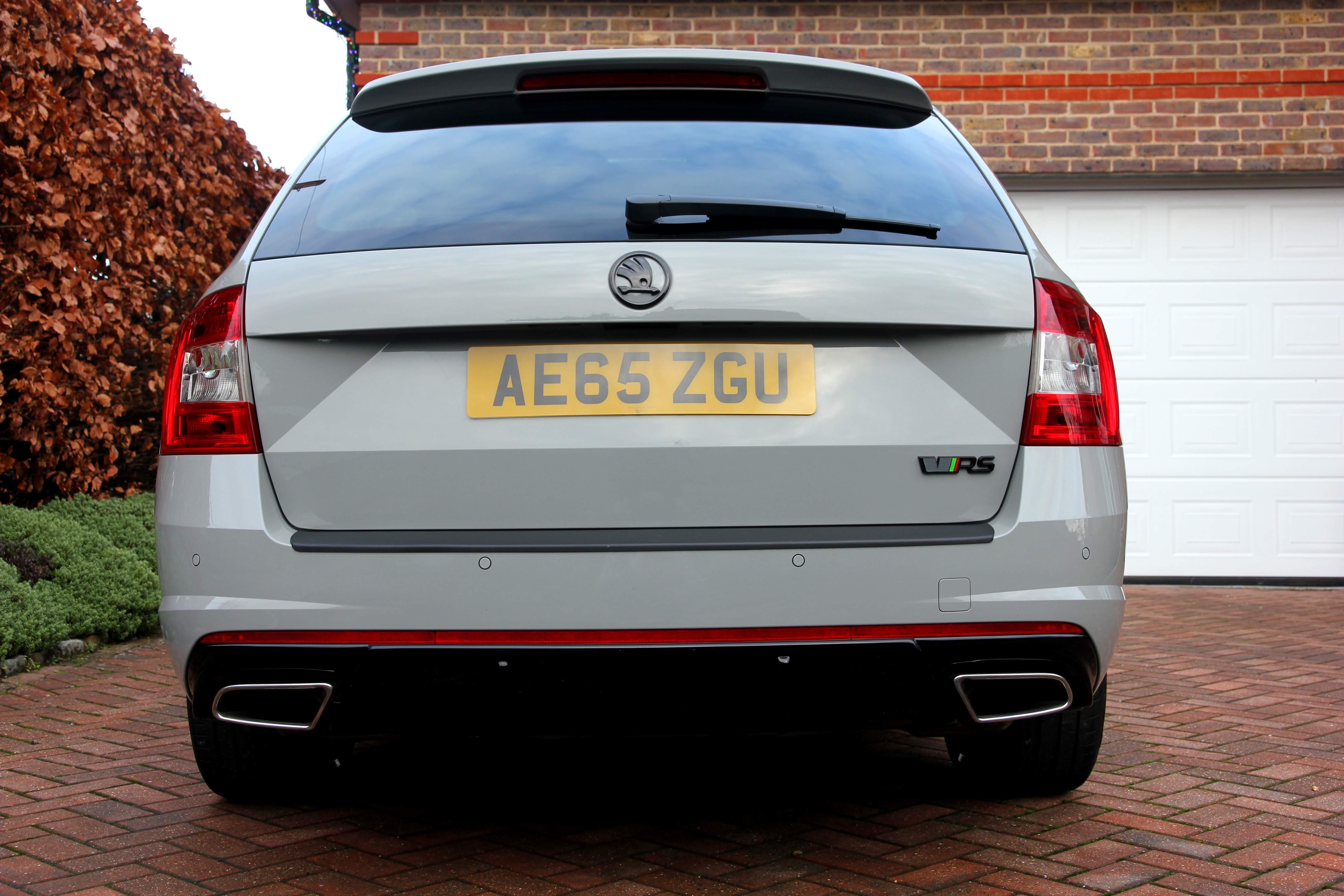

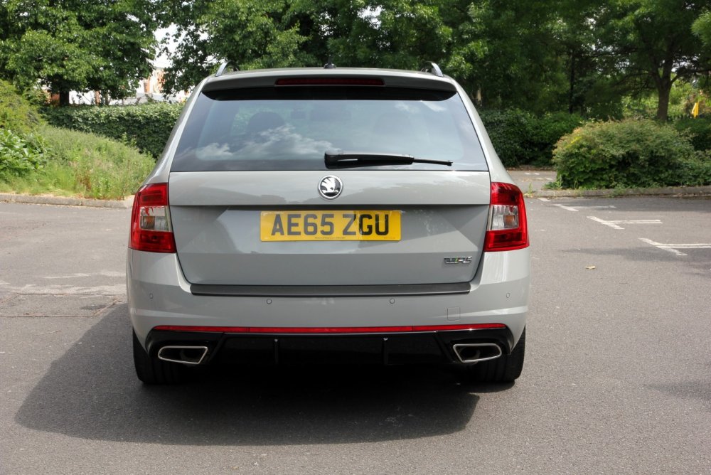

How hard was it to fit the rear jay
@p5stokes the rear was a bit more of a challenge. The tricky bit was removing the old diffuser, the tabs are pretty stubborn. I used a combination of brute force and trim removal tools to persuade each of the tabs along the top of the standard diffuser to let go of the bumper.
Once the old one is off the Rieger one slots in really easily and fits perfectly. You then use the supplied screws and spacer washers to secure it, with only two holes to drill (one on each side of the car).
Really like the intake pipe. Good idea how it replaces the stock hose and turbo elbow.
I went for the racing line elbow and hose as a kit
Thanks @Bannon87 - It's a nice design, the only downside being that it's more difficult to install than the VWR elbow.  I suspect the gains for it being a single piece are minimal over the VWR setup, but it was recommended to me by MRC Tuning (and seems to be the intake pipe of choice amongst Golf 7R tuners too) so I went for it.

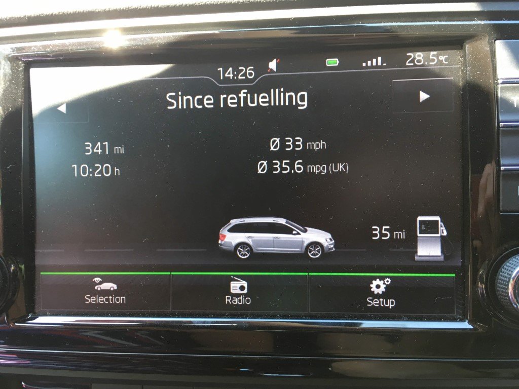

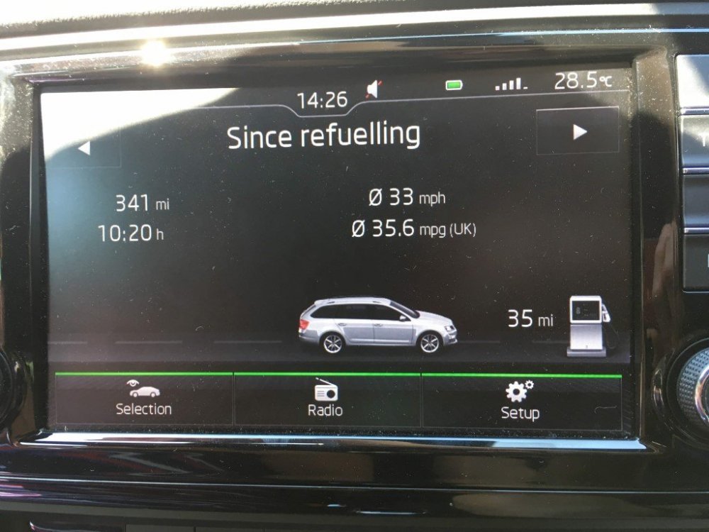

We took the Octy on a family holiday and I have to say I was really impressed with it.  Looks awesome with the roof box installed too B)
  It was comfortable, quiet, seriously practical (especially with the roof box) and despite running the A/C constantly and getting stuck in a fair bit of traffic on the way there it still gave me nearly 36MPG:

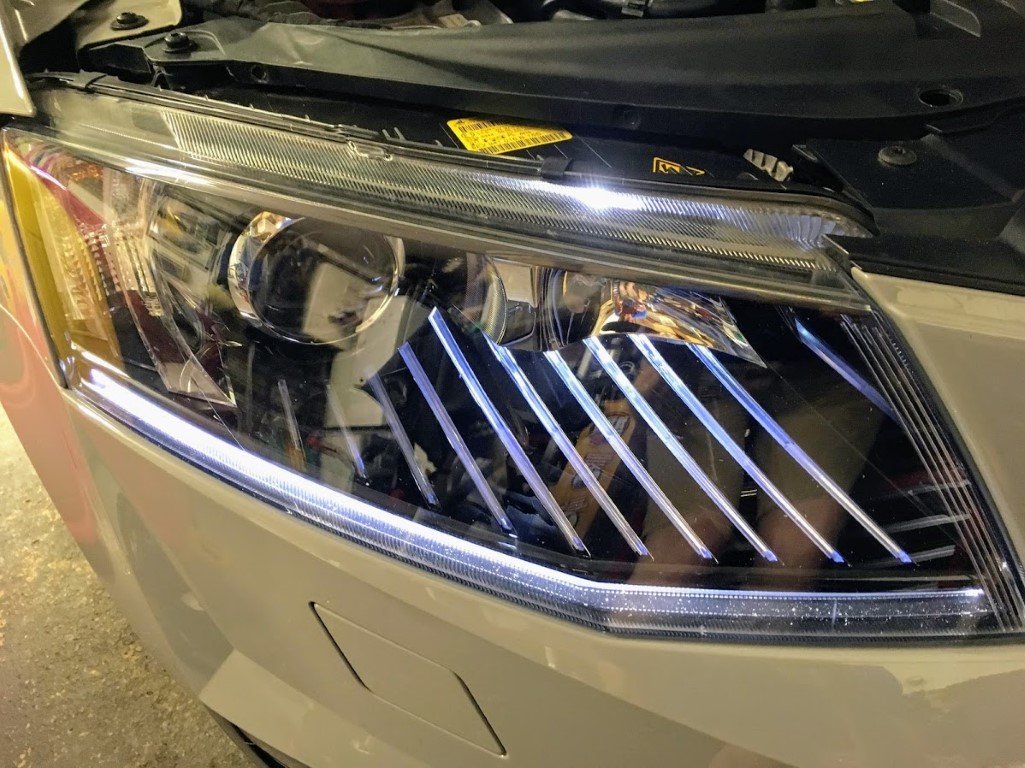

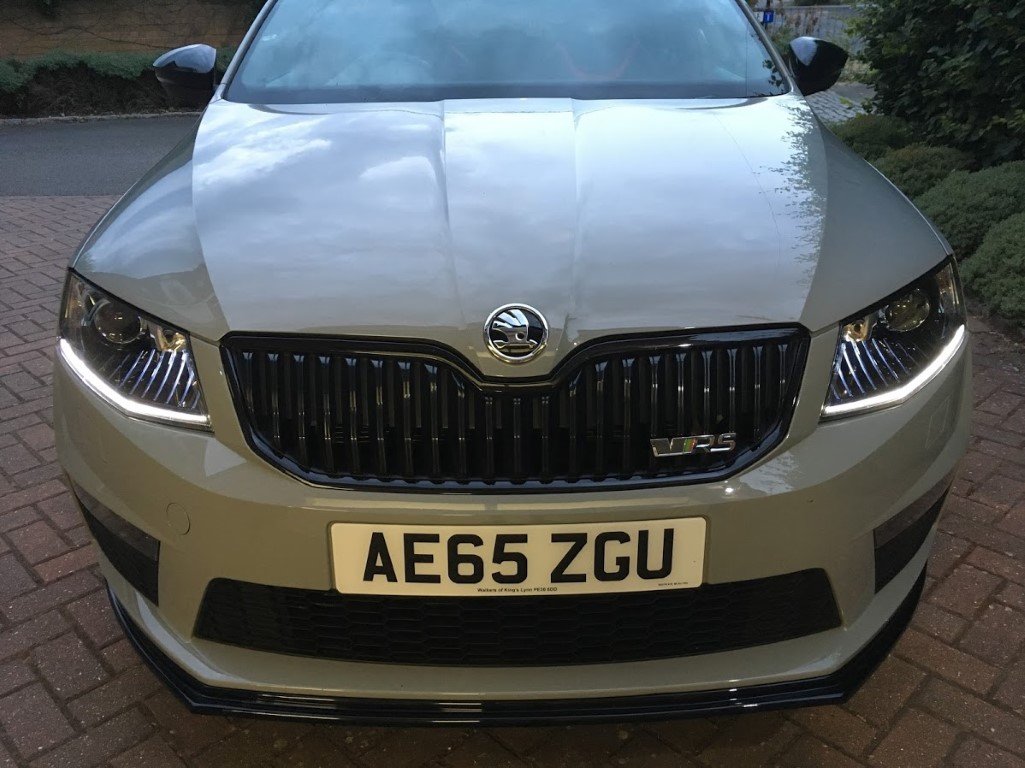

Oh, there is a minor update!  Just remembered a cheeky mod that @SashaGrace reminded me about - LED sidelight bulbs.  Thanks Sasha!
I used to swap the sidelights for LEDs religiously on my previous vehicles, but as the Octavia has DRLs I'd not given it a second thought.  I just happened to already have some CREE LED bulbs and they worked a treat!  Very subtle difference, but the "eye lashes" now match the DRLs and generally look more vivid.  Nice touch :nerd:
BEFORE:
AFTER:
Was surprised that the originals were tinted blue, and yet they still produce a yellow-ish light.  Very odd.

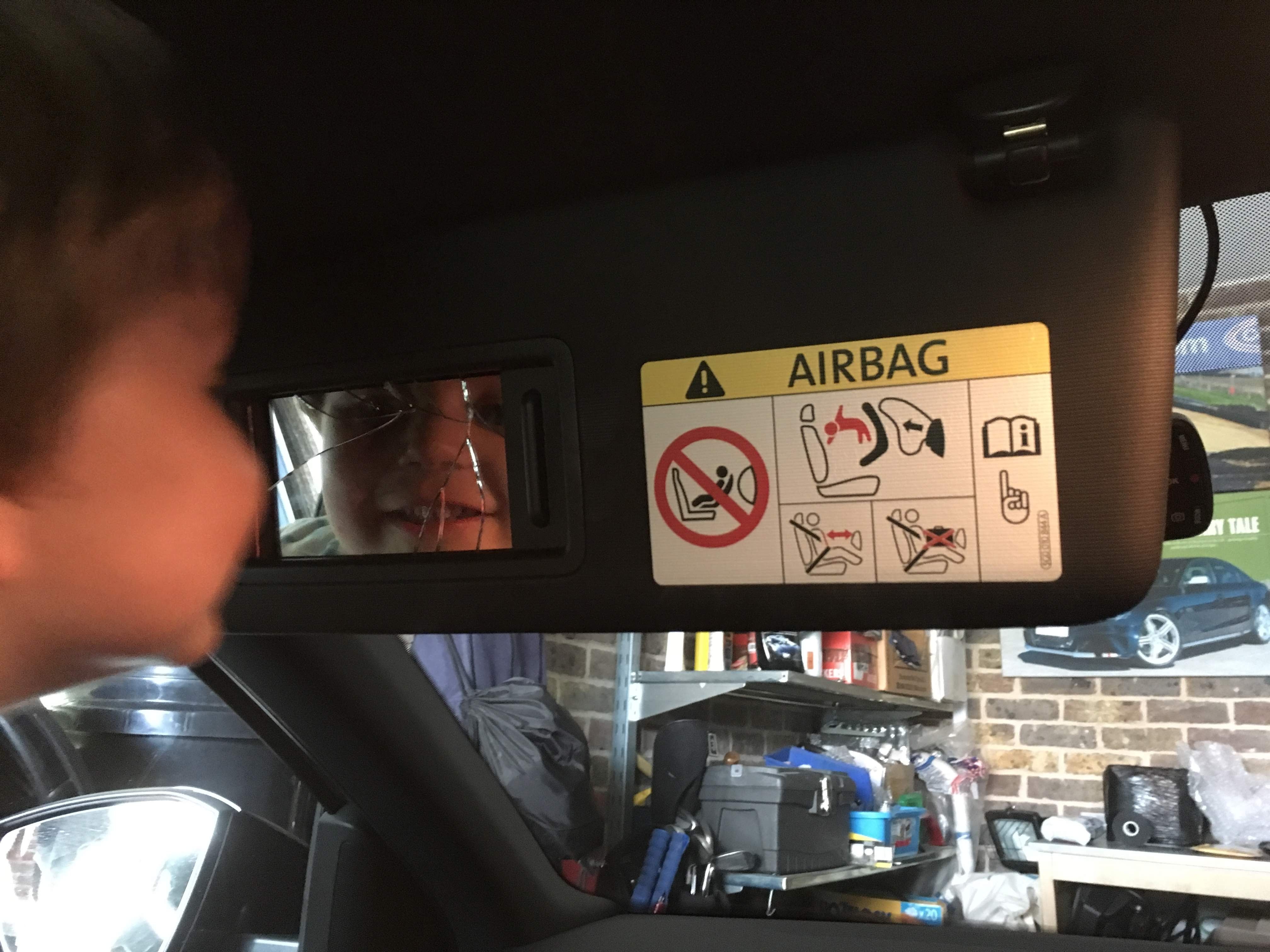

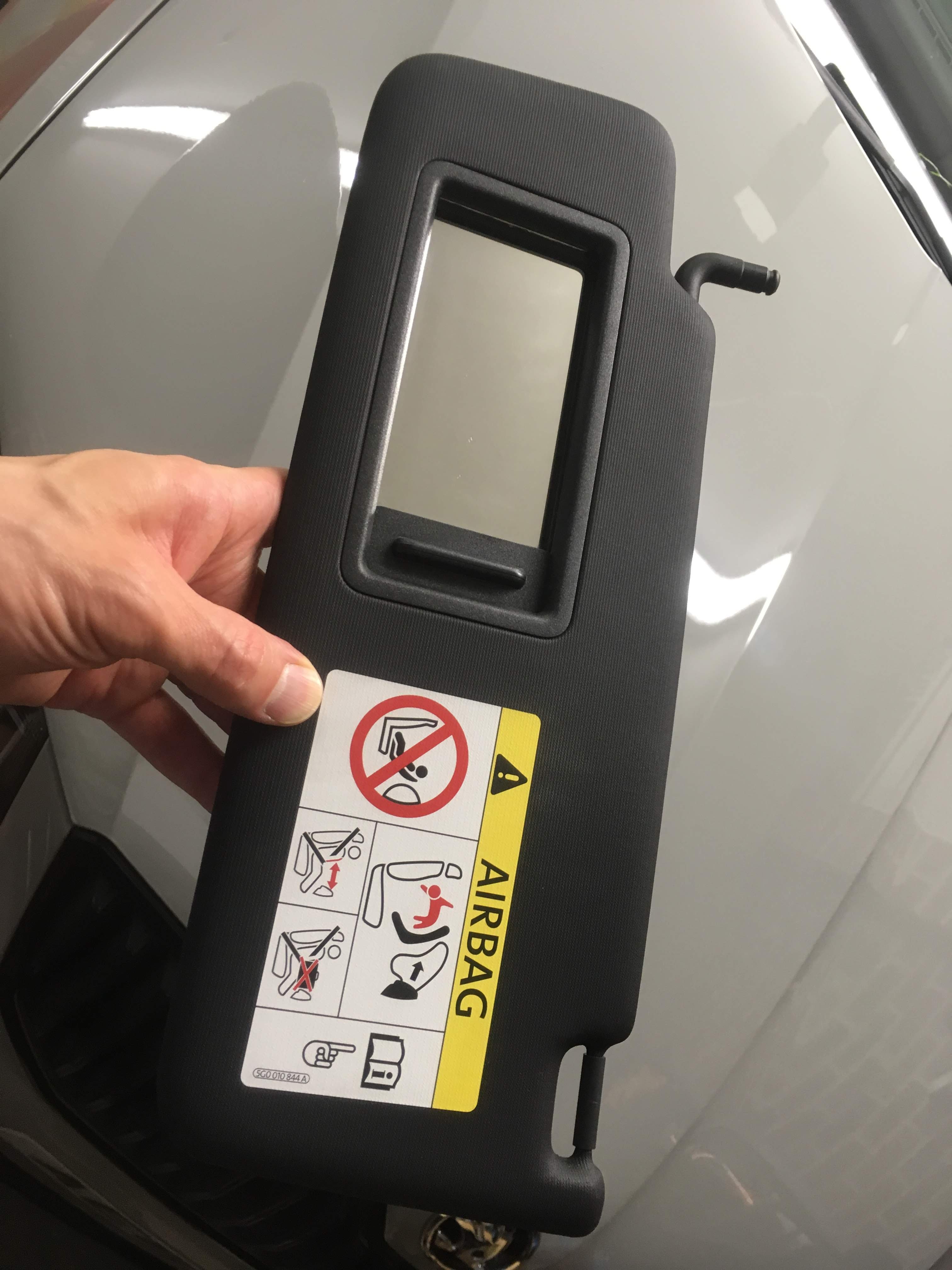

The mirror turned out to be a really simple job!  I was worried that I'd need to peel back the headlining but after sourcing a spare part from a breaker's on eBay they reassured me that you just pull down very firmly on the main pin (that it rotates on from the corner of the roof) and it pops off.  I've heard people being charged ~£100 at the dealer for these to be replaced so I was happy with my £25 part.
Old broken mirror - 2 year old son providing the muscle for pulling it free :D
New mirror - mint condition from eBay
I was going to take a photo of the finished article but the job was so simple I just walked away after that - sorry folks :biggrin:

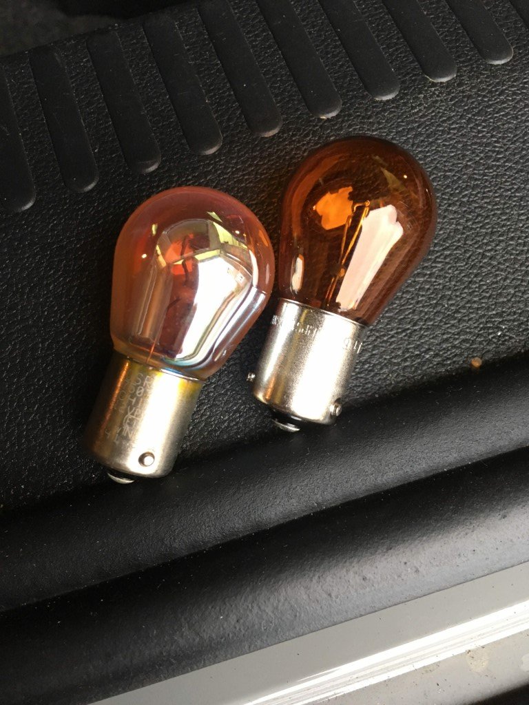

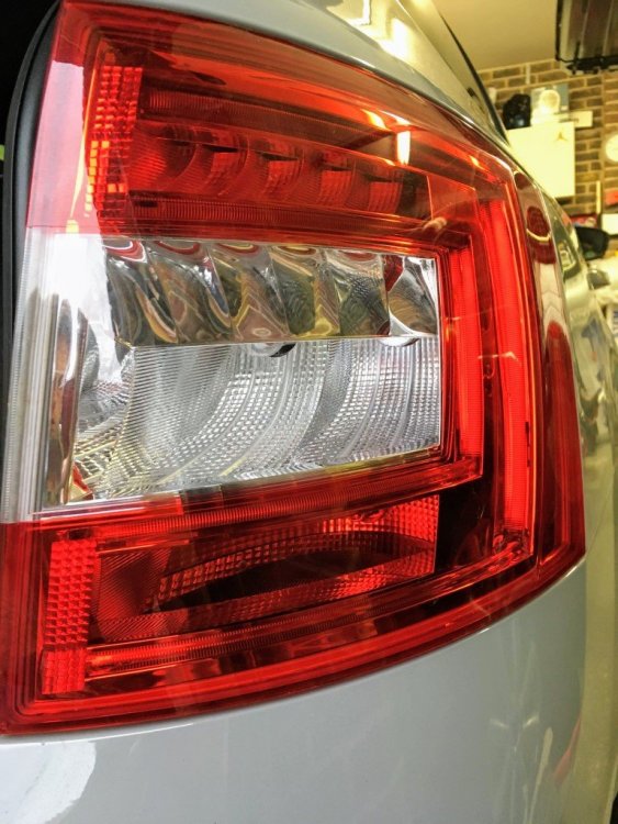

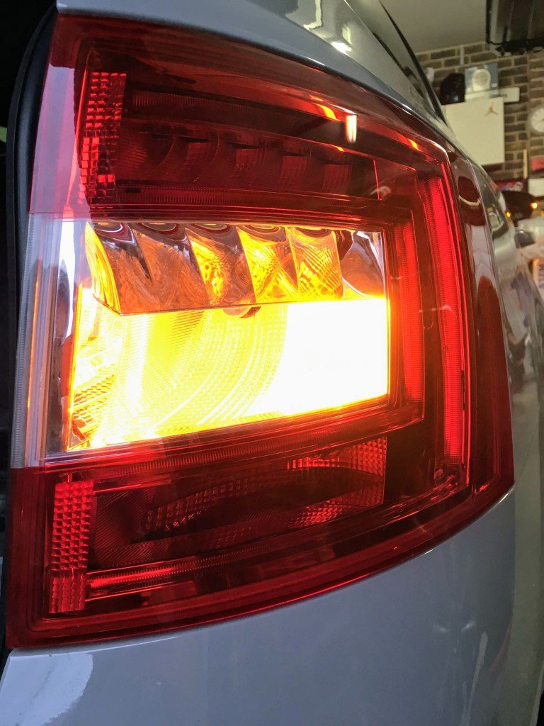

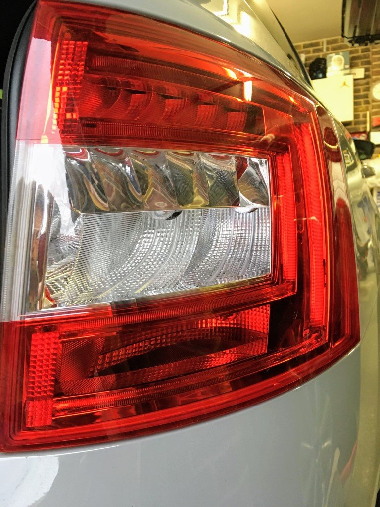

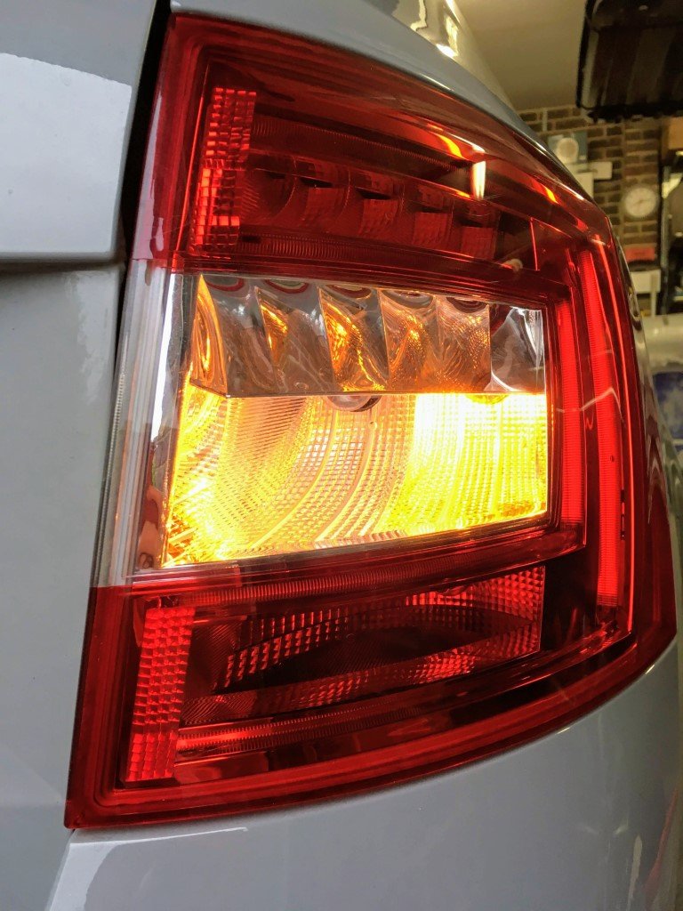

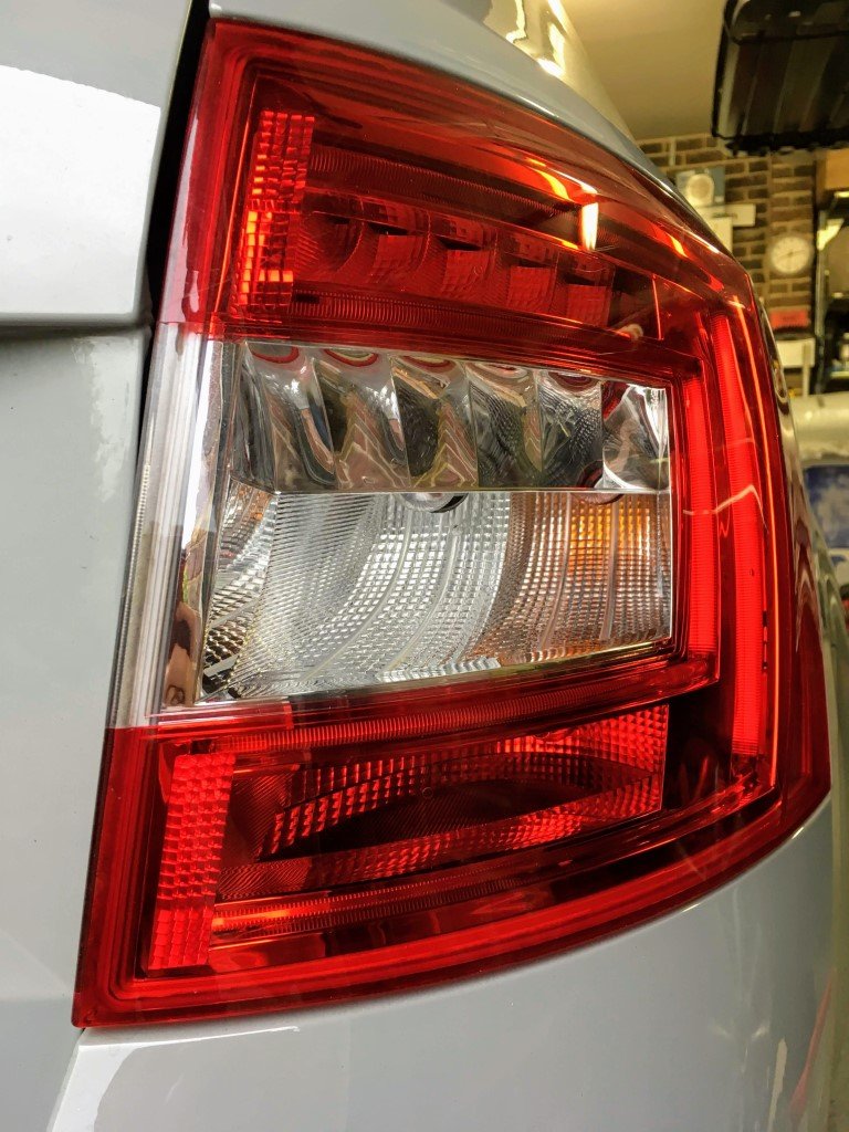

Another lighting upgrade, this time on the rear.
Diadem bulbs fitted to replace the horrible OEM orange indicators:
Before
IMG_2003.thumb.jpg.2732410be42e8ca069d8718b551bd5d7.jpgIMG_2004.thumb.jpg.4f618e974b0cc2c2a8edf06ff4d80684.jpg
After
IMG_2007.thumb.jpg.63c725023359d2044cfd4e2438d12cb5.jpgIMG_2008.thumb.jpg.0313398166e65ed4abc1723e101ec5ee.jpg
Link to bulbs please. Do you know if these would also fit the fronts?
Haha, what am I, your personal shopper?   Cheeky bugger :rofl: :kiss:
As it happens I had these bulbs leftover from a previous car so I don't have a link for the exact ones I used, sorry.
They're a pretty standard fit though - these should do the trick (don't hold me responsible if they don't though): https://www.ebay.co.uk/itm/OSRAM-PY21W-Diadem-7507LDA-02B-12V-21W-BAU15s-Signal-Indicator-Bulbs-Twin-pack/292148282557
Edited by jaygemson
The fronts are different to the rears.  Rears are PY21W and fronts are PWY24W, according to this post at least: https://www.briskoda.net/forums/topic/391390-led-indicator-bulbs/?do=findComment&comment=4555832
Sadly changing the front bulbs requires breaking into the rear of the headlamp unit and then applying a Skoda repair kit (~£9 per side).  I'll be doing that at some point so watch this space!
