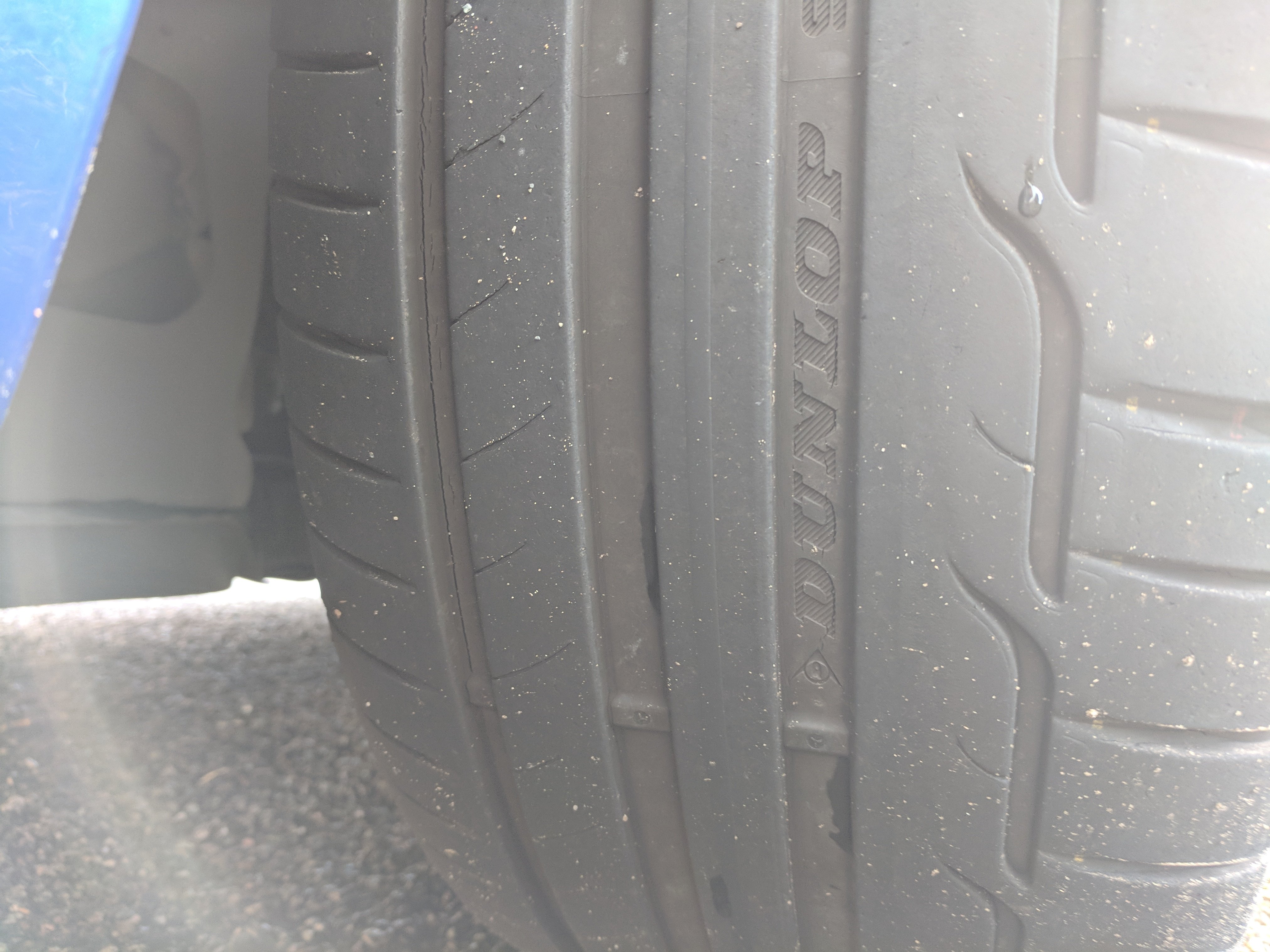

Yesterday I had to move the car at work so the security guy could lock the side gate. When I parked up I thought I'd just check the wear on the front tyres, as I'm now 7500 miles on from picking up the car in April when it only had 860 ish miles. I wanted to see how the Dunlop sportmax were wearing. When I saw the crack in the bottom of the groove I was a little bit shocked. This is only on the front near side tyre, all the other 3 are fine with no signs of the same.
Thing is I would say that this is a manufacturing defect and it should be covered by the warranty and changed. Has anyone else had any similar experience of this nature and how did it get resolved?

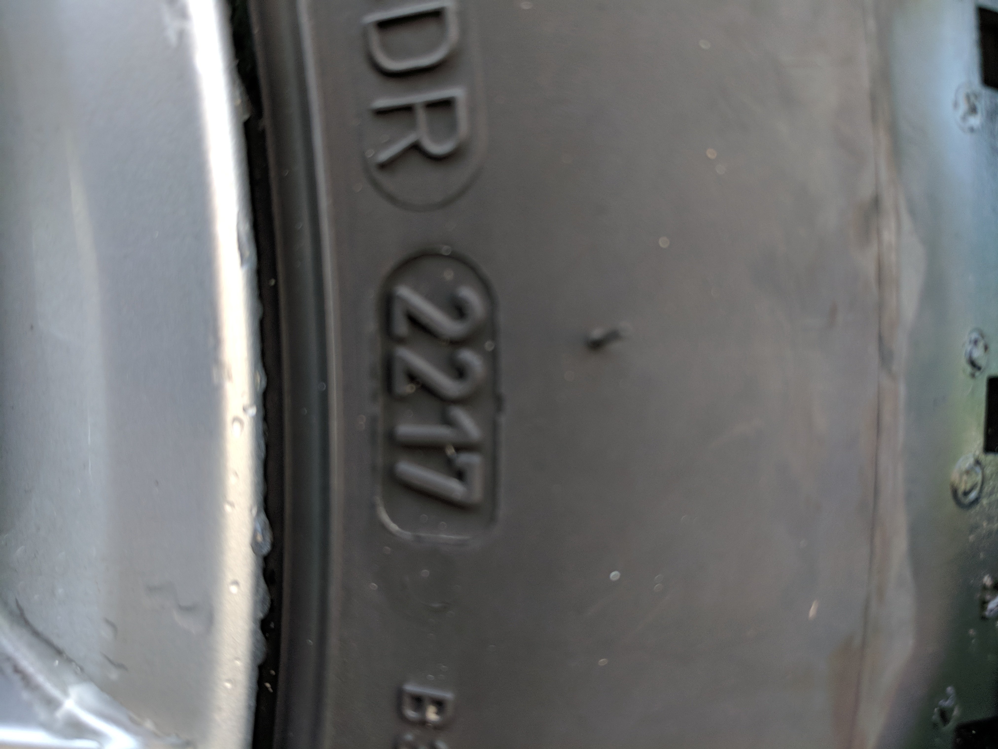

Thanks all, I can confirm that all are the same week/year code as in the picture, 2217 that's w/c 29th May 2017 they were manufactured and the car built, shipped and registered early Nov some 5 months later.

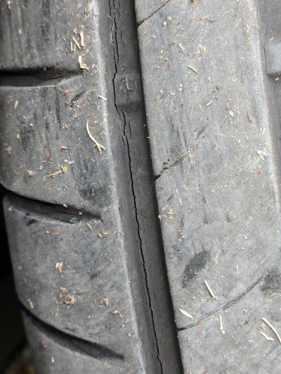

Plus another picture of the tyre, it's much cleaner as it's been wet here today. The crack is only on the inner groove and on one side.
Dunlop have history of this sort of cracking...   The SP01 being an example.  There were many reports of such cracking around 2008 and 2009 and we had all 4 SP01s on our Octavia 4x4 crack after about 10k miles from new, although ours was worse with the carcass showing.
I won't ever use Dunlop's again...
Ive had a look at the tyres on mine. Got the same problems with the dunlops. Cracking on the rear but the fronts don't have the problems at the moment. Mine were made in week 11 of 2017!
That eliminates any 'rouge' tyre having been fitted along the way.
Wear across width of tyre appears fairly even which would tend to rule out the tyre having been run at inappropriate pressure for any length of time as being a contributing factor.
I can't remember if it was this site or another but I've seen threads where someone with microcracking in grooves just popped along to his local kwikfit and asked them. They examined the tyre, took a couple of photos and filled in a form and sent it to Michelin I think. A few weeks later got a call back and said yes Michelin says its a manufacturing fault and tyre replaced. Not sure if he had to make any contribution for wear.
There doesn't look to be too much life left in that tyre looking at the wear bars and with a tyre that's from a manufacturing point of view over a year old and 7.5k on a used car I don't think there will be any warranty.
Its always worth a go with the retailer but I think you need to be prepared to buy a new tyre ..... I'd replace mine if it had done that

I called Skoda UK and they advised that I take it in to the local dealer for checking.
I did so this morning and waited while they took it in for inspection. After roughly 45 minutes, I got a text message and any email with my inspection report via video.
The cracks were said to be quite normal these days and are a regular occurrence. As the cracks are very slight and none of the chords under the outermost layer were not exposed, they have advised me that I should not be overly concerned.
I'd asked them to also look to see if they can set the eco mode to be on as default. This was not possible, as it's a new characteristic of the model.
Oh well, my mind has been put at ease as both the master technician and the mot tester were of the same opinion regarding the tyres.
They even washed it for me, all completely free gratis:thumbup: all the staff at Bristol Street motors in Chesterfield were spot on.
I will keep my eyes on them for any changes in the future.
