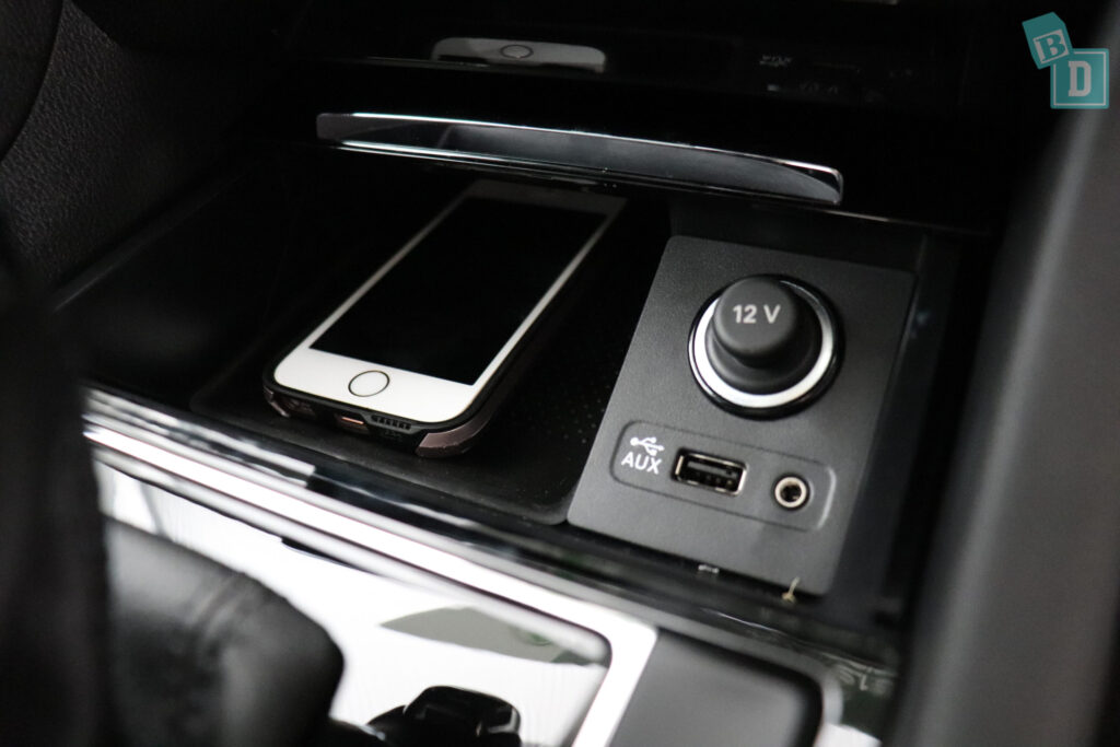

This is a generic photo of the space...

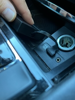

My intention was to remove the lighter plug, get a low profile USB cable and place the dongle over the flat face of the sockets on the right.

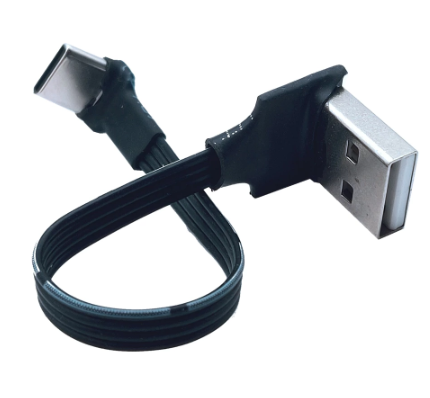

The USB cable was easy enough to find on Ali Express (https://www.aliexpress.com/item/1005001952745125.html?spm=a2g0o.order_list.0.0.21ef1802lllfSP)
The dongle (https://www.pairr.co/) arrived and was as small as i'd hoped. However one of the issues with it is that the USB-C plug hole is deeply recessed so I really needed a USB cable with a straight plug rather than a right angle plug. I forced the bugger in and hoped for the best. I placed some stick on velcro patches to the back of the dongle and placed it onto the surface of the plugs as planned.

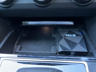

Pretty pleased with the result. The dongle fits neatly in the space, the lid closes and the dongle is functioning as promised.
Interestingly the dongle powers up as soon as the USB port is powered when the car is unlocked so by the time i've sat down in the seat and started the car, CarPlay is on the screen instantly with no startup screen wait.
Minor Problems:
One problem I've noted is that the MIB2.5 Columbus will sometimes forget or not see the USB port being used. This was solved by resetting the unit by holding the power button down
Another drawback is that because the unit communicates over the phones wifi signal the resonse on the screen is slightly delayed. This means there is a split second delay on the swiping between CarPlay screens, although the button commands are pretty much instant.
Overall pretty happy so far and my cable sadness is all gone!

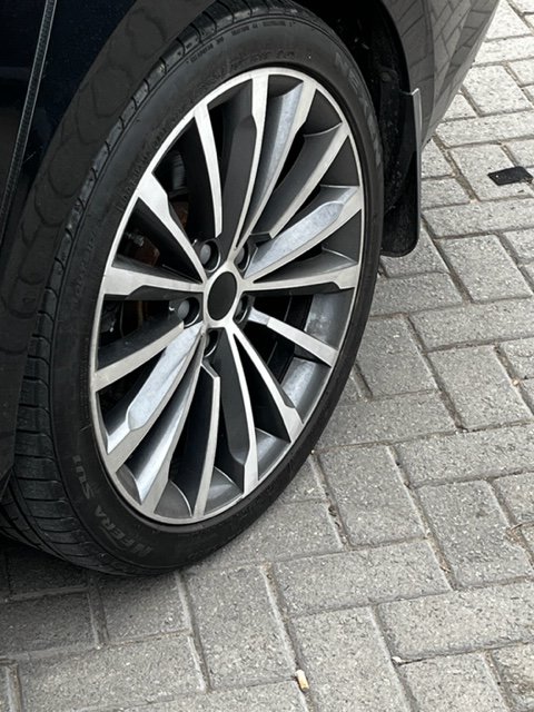

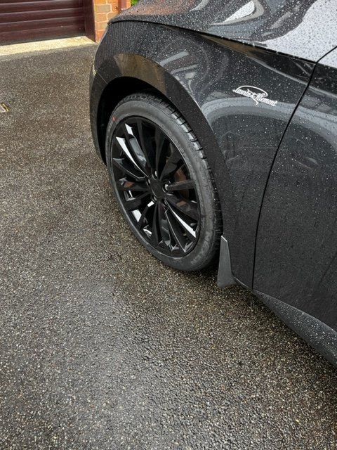

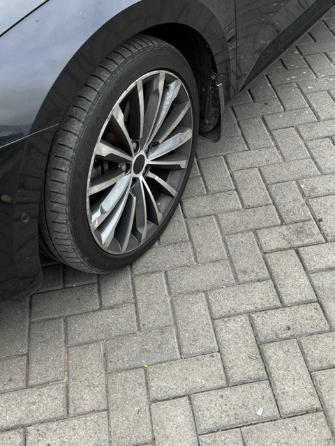

Mine goes in for 4 x alloy wheel refurb tomorrow (19" Trinity). I'm changing from diamond cut Anthracite to powder coated gloss black & no diamond cut to match the paintwork (nearly). Should get it back on Friday this week🤞. I'll post some pics then.
All done. What do you think?
Before.

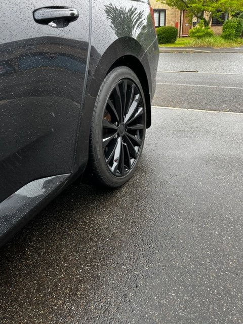

After.
IMG_1068.jpg.e20e26feba588159eb1c97684e8ab921.jpgIMG_1069.jpg.a578ccaf36893595da2aef5cf4d5e1ef.jpg
The only thing I'm not happy with is the rusty inner hubs & calipers. Which means I might have to have a go at them myself. Other than that I think the wheels look pretty good & give the car a meaner look.
Hmmmm. Each to their own Colin, but they’re not my cup of tea.

I like the standard look although I do think gloss black suits the car and are an improvement, a wheel refurbisher told me diamond cut alloys that are not painted always deteriorate quickly.
