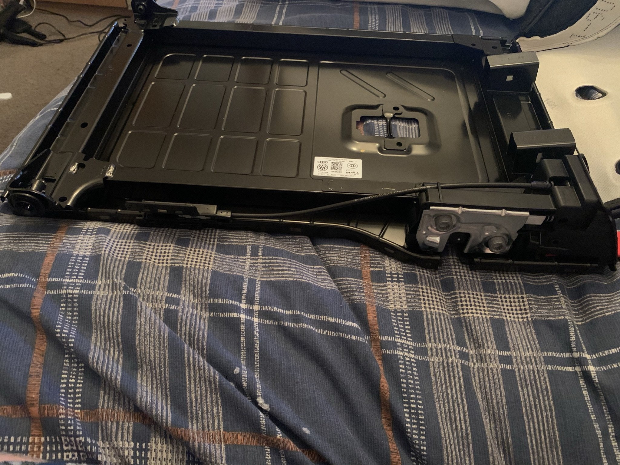

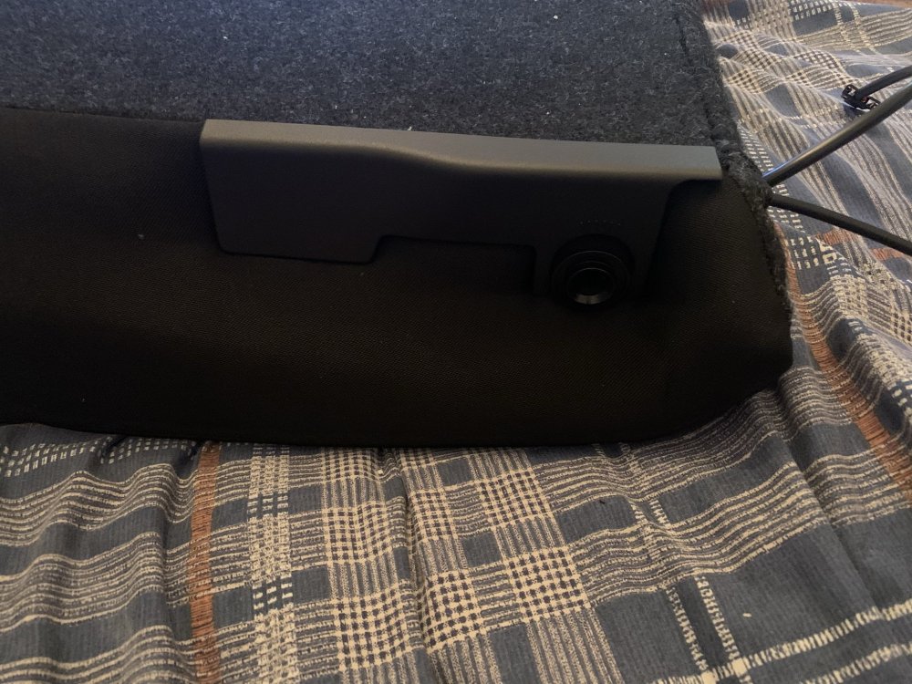

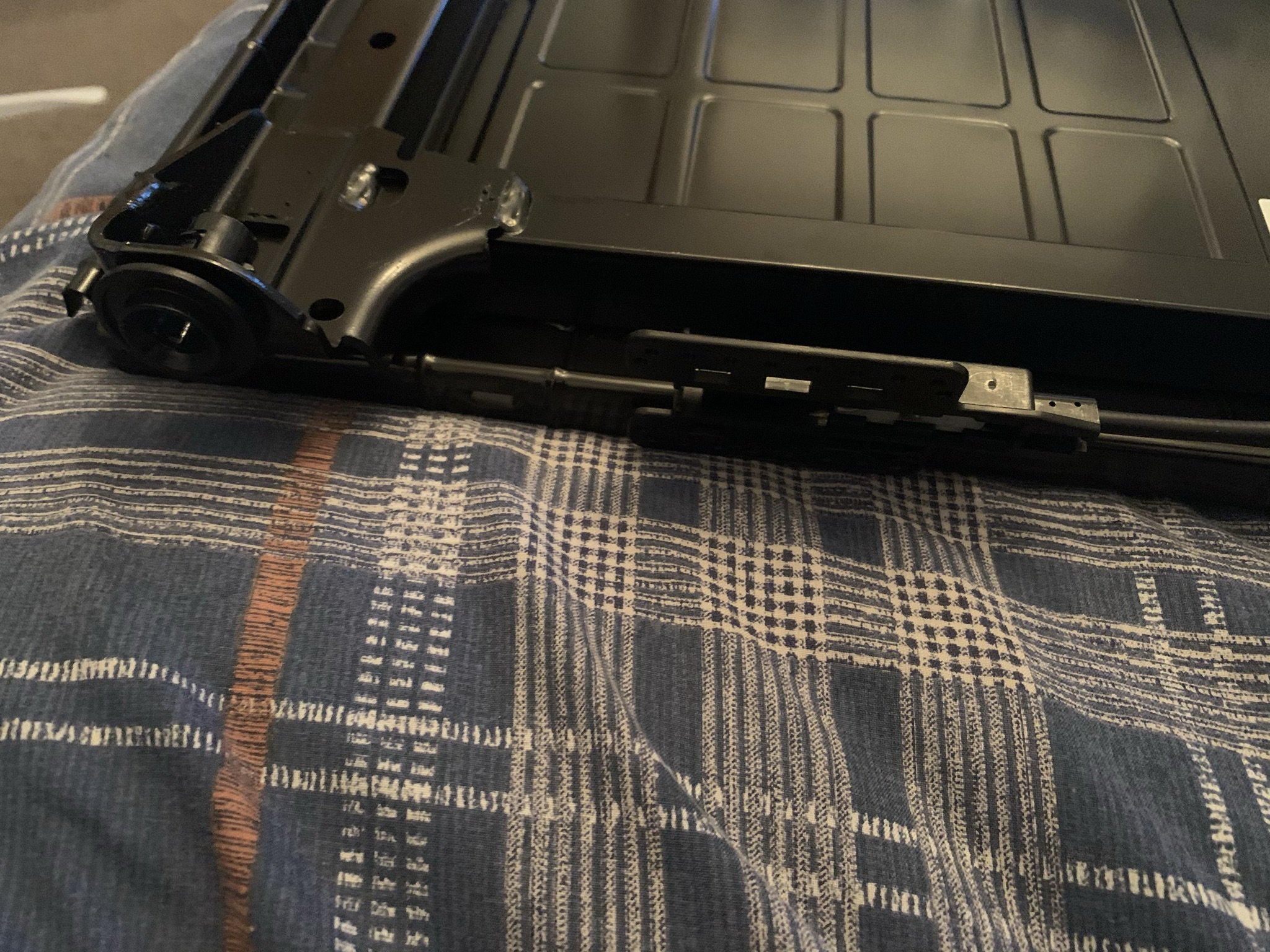

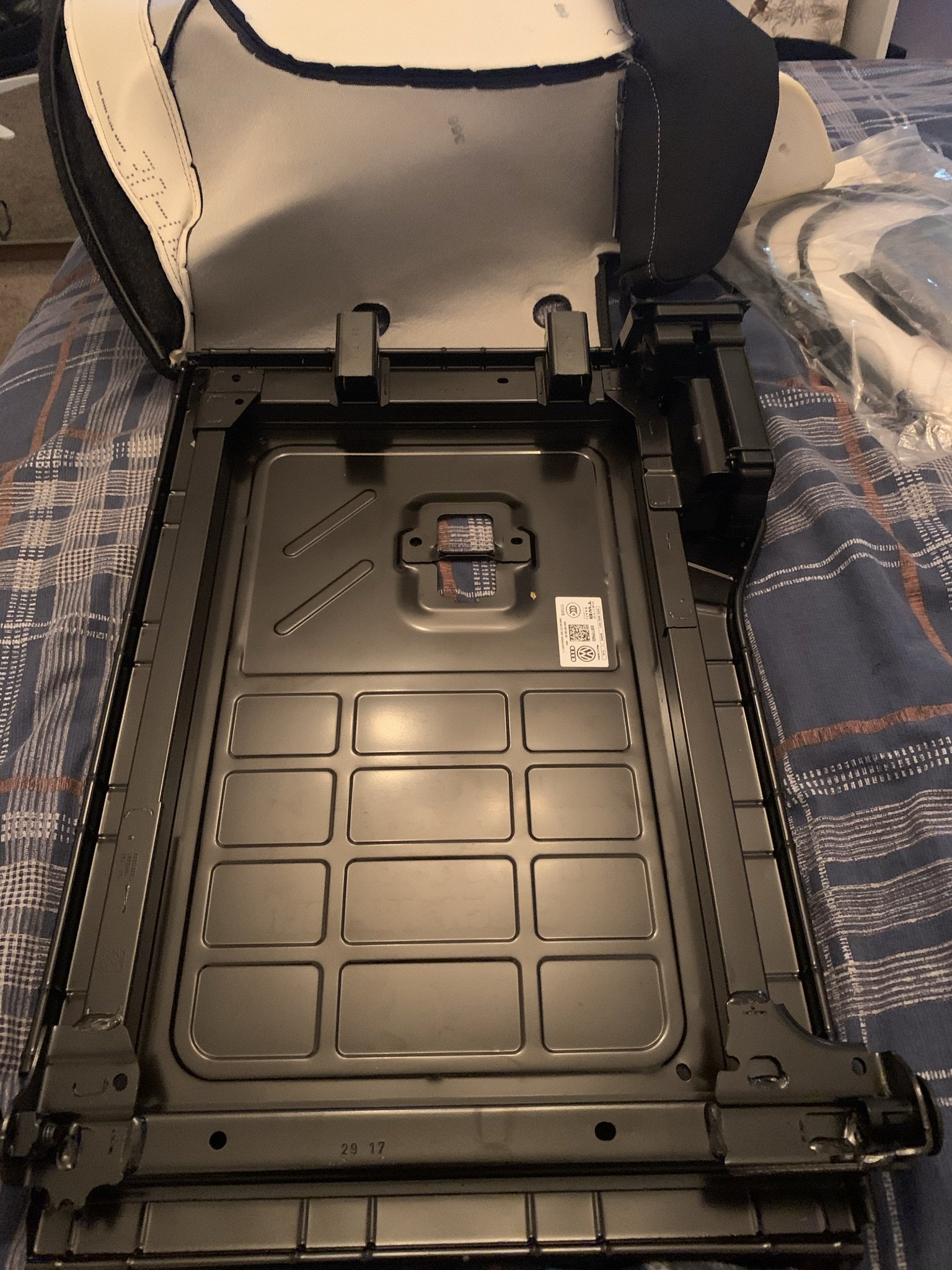

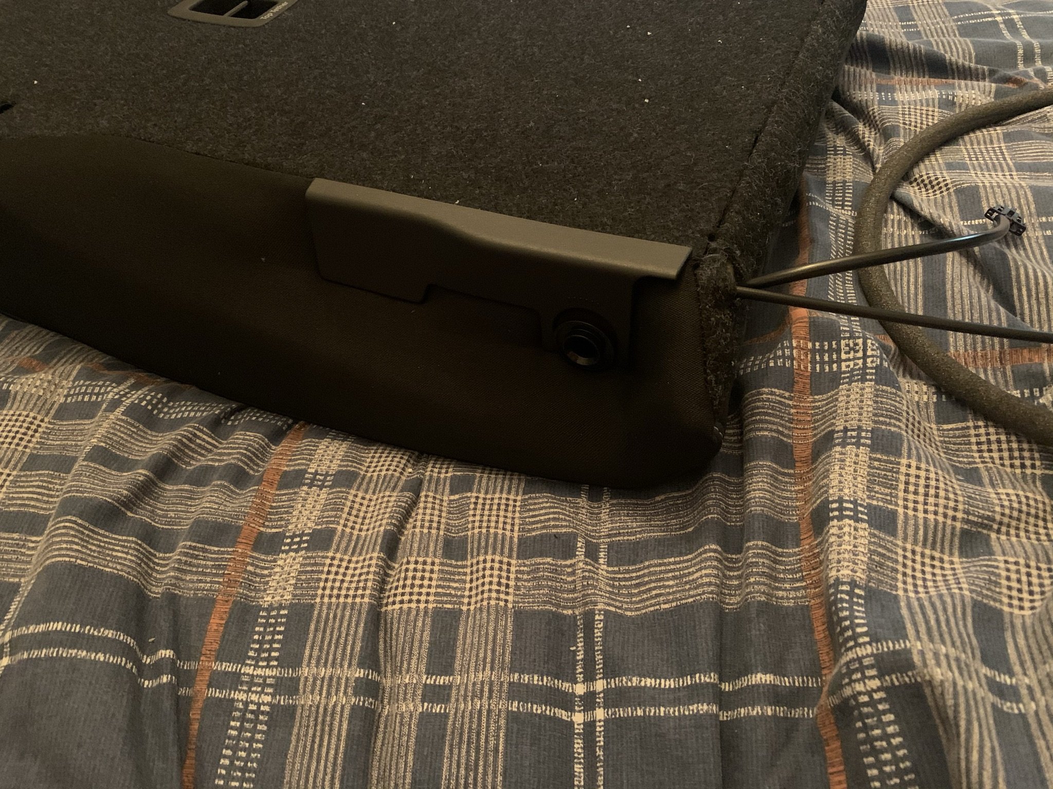

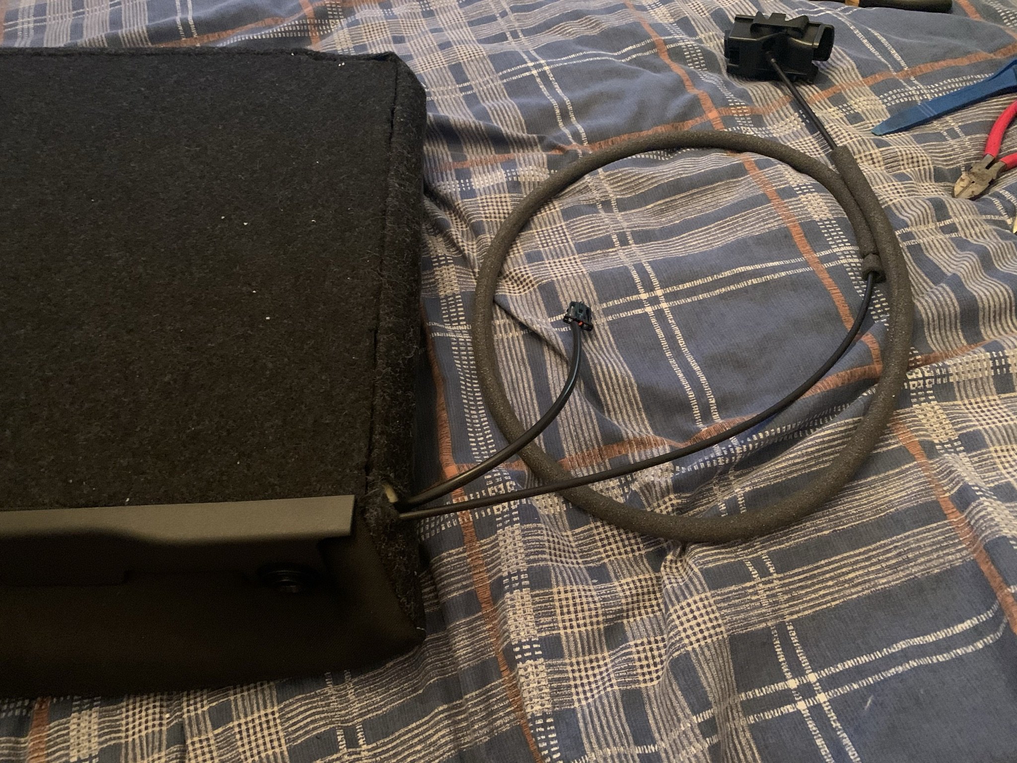

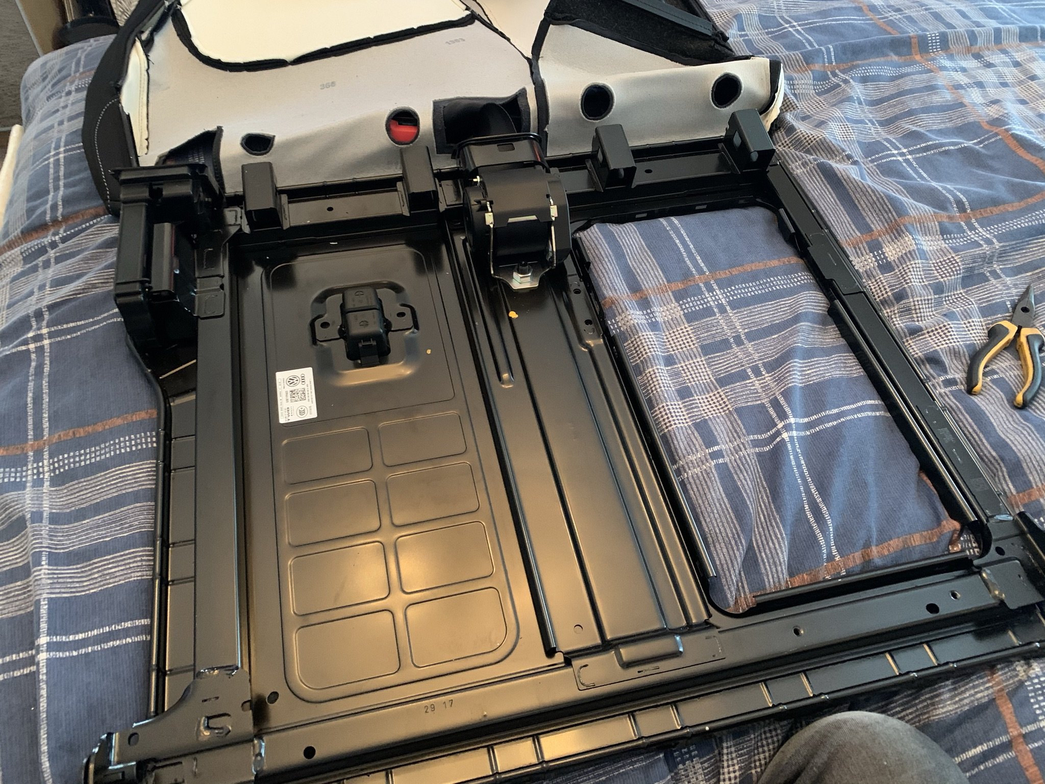

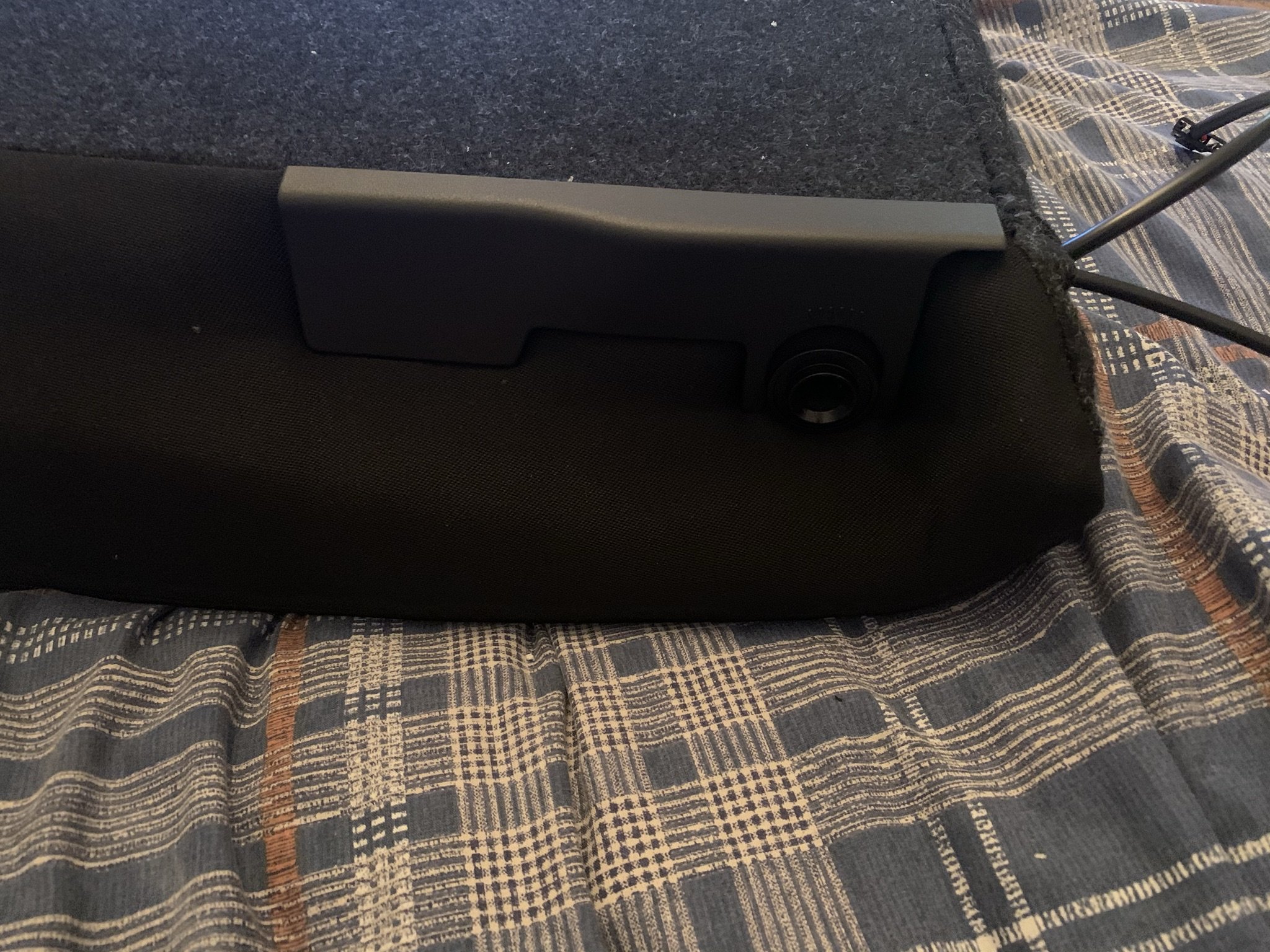

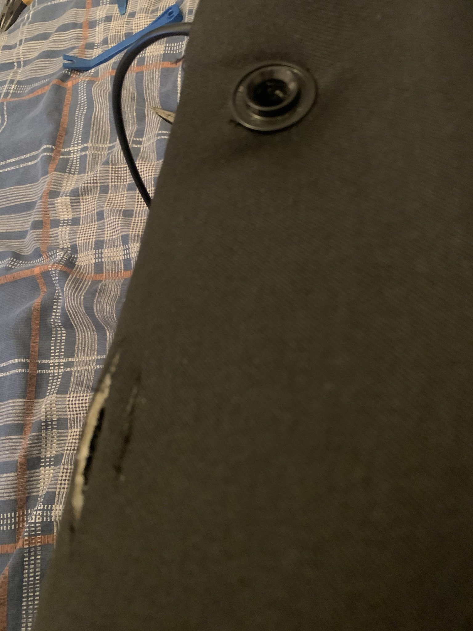

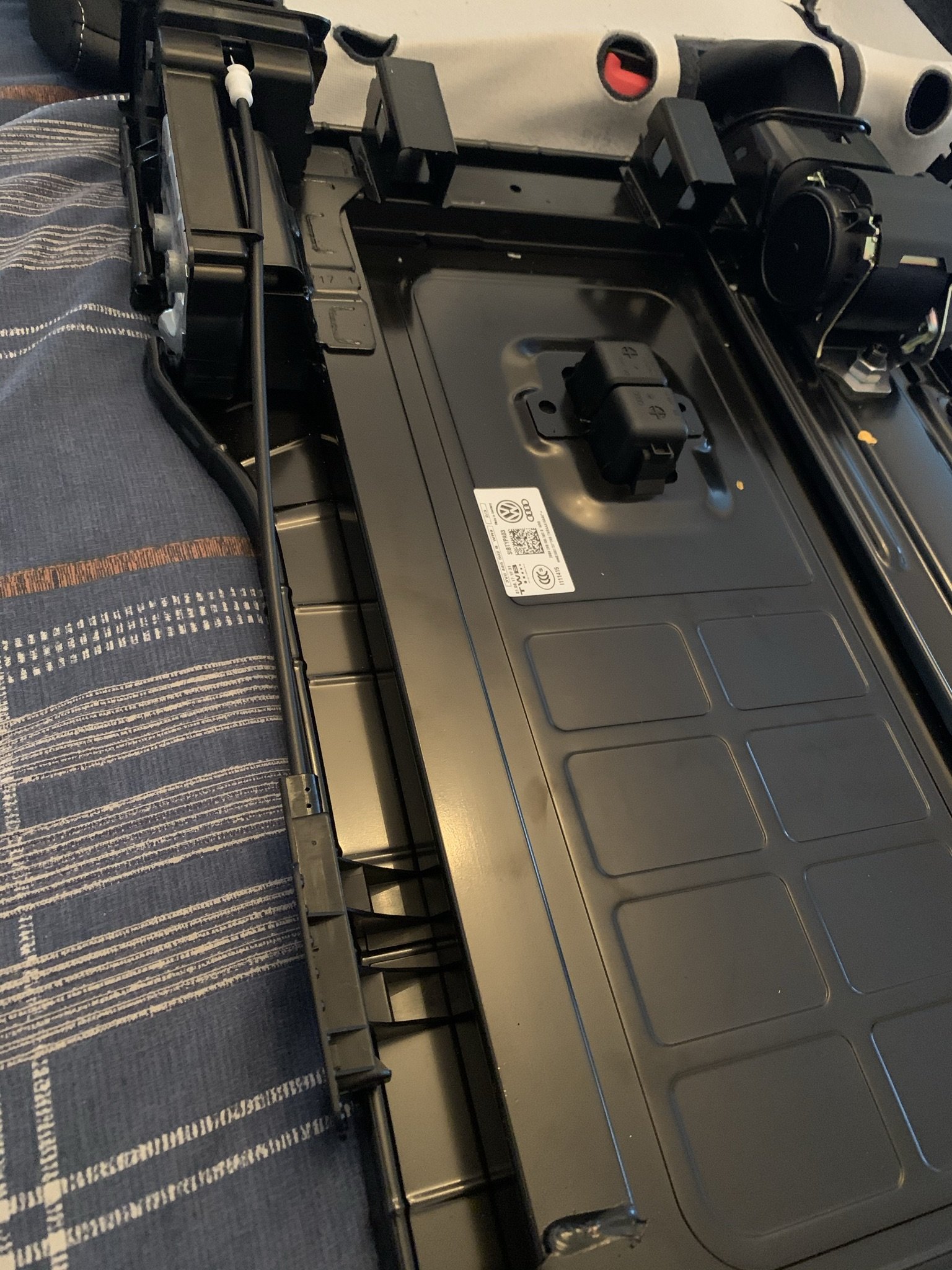

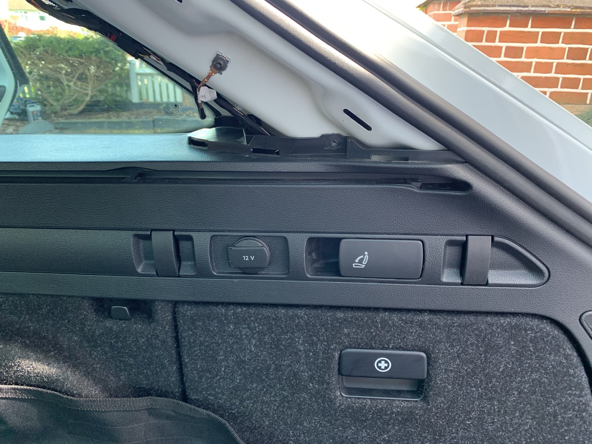

So as requested by @coppertop heres an update to the rear remote seat release - this was done on an estate and there are slight variants in part numbers depending on model shape and trim colour.
So the simple method would be to just buy a rear bench with the feature already installed but not many superbs being broken and fewer with this feature means its fairly uncommon.
Everything works perfectly but there is 2 snags!
- You have to cut your fabric to allow the brackets to fit!
- There are 2 part numbers for the main metal frames - each cost £450, the difference between them is unclear physically but parts show 1 is remote release, 1 is standard. Now the job is complete I can tell you the difference, the remote release ones have a sprung loaded bushing on the outside edge, this is to force the seats flat once the lever is pulled - Im not paying £900 for 2 seat backs and you cant buy just the bushing seperately. I dont have a remote bushing so cant tell you how it works but im guessing just a coil spring and some plastic. Im hoping to work out a DIY solution in the future.
Now regarding parts, there are only 4 bits required.
- Lever for each side - etka shows cables are seperate but take note - THEY ARE INTEGRAL and buying the lever will come with cables too.
- Cable and connector for each side - this part clips into the latch on each seat and has a 30cm cable and a plastic bracket that clips into the seat. the lever cable clips into this
- A black plastic cover that goes over the cable connector and guides the cable out the bottom of the seat.
- hog ring/C clips for when the seat is stripped down
Parts arent crazy money and cost about £100 all in. Im not gonna do be doing a write up for this one as its fairly self explanatory and just involves youtube and learning to reupholster a seat cushion and how to fit hog ring clips, and how to strip the cover off the seat. Below are some pictures for guides :D

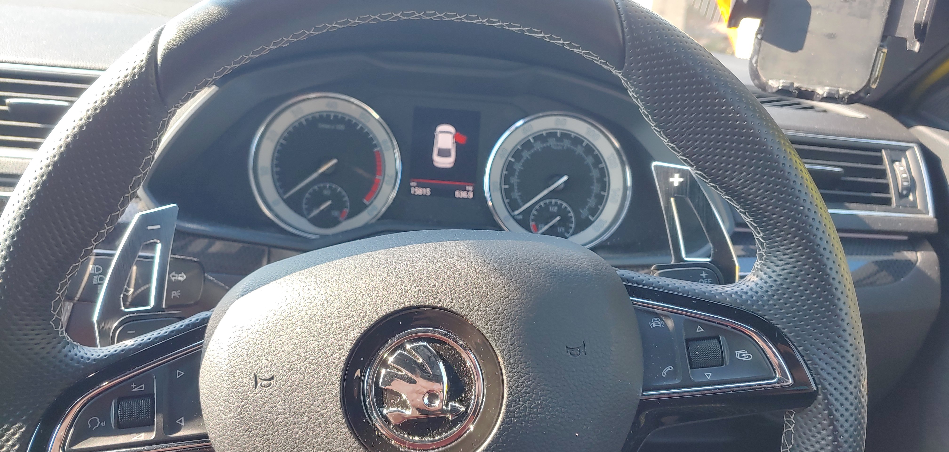

so ur saying it is quicker for u to move ur off arm off the steering wheel and on to the gear selector, then shift up/down.......than it is with shifting with the paddle-shifter at ur finger tips?!?!?
phwoahhh
regarding catching the knee, yes, it can happen, however i always leave my car with the wheels straight, hence shifters r at 9 and 3 positions.  won't have any issues then getting in/out of the car.
phwoahhh
I'm used to driving a manual box, so having my left hand ready to change comes naturally. I didn't find an immediate improvement after fitting the extensions, maybe that will change with practice, but they're not game changing for me so far anyway.
I park on a hill, facing downhill, and always turn wheels into face the kerb, so my steering wheel is never straight ahead.
Ah fair enough. 👍
I like using the paddles every now n then, however I find myself always having to reach for the stock paddles with my short fingers.
The paddle extensions however makes the task much much easier for me. :)
