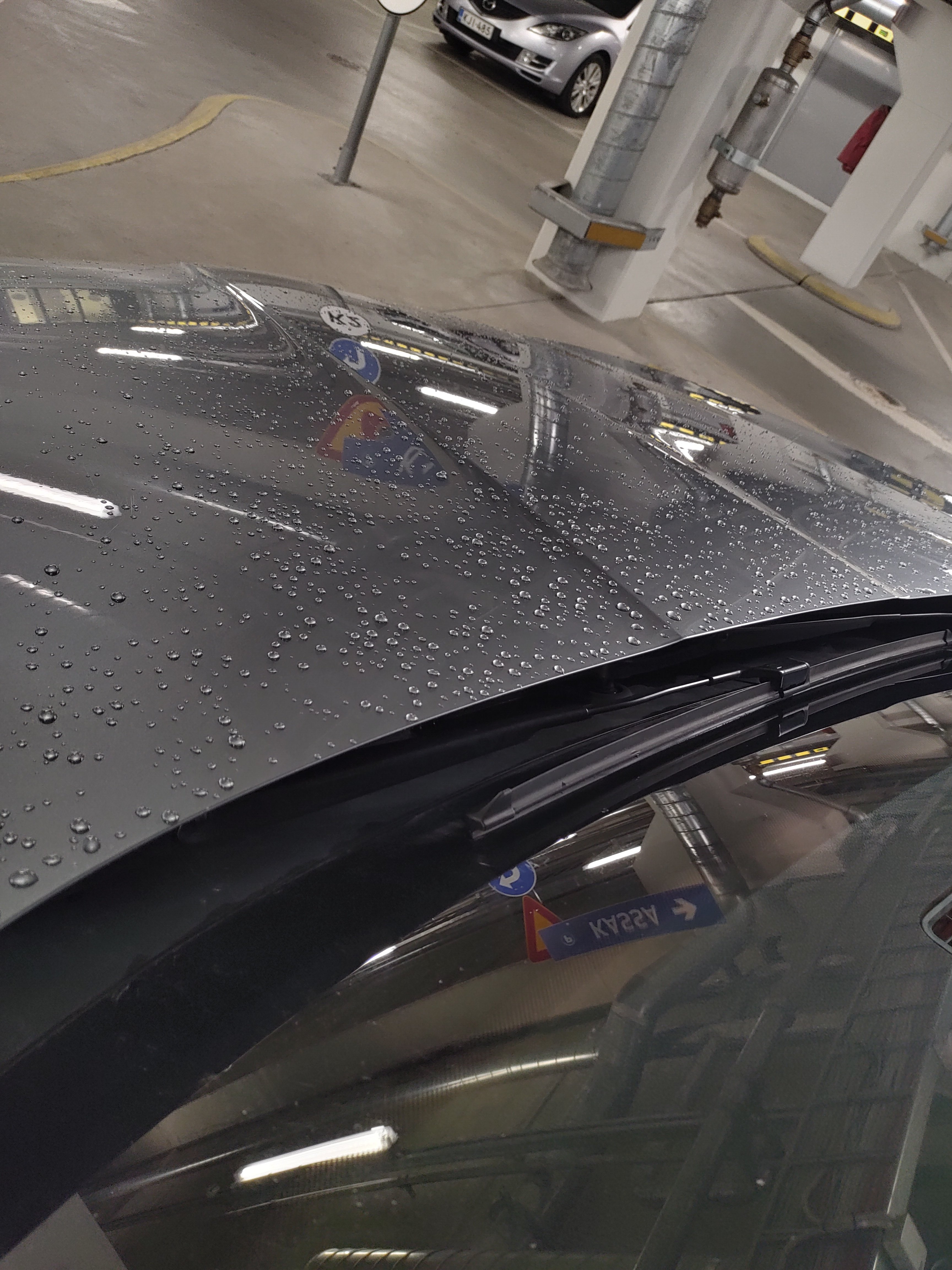

I cleaned it. Turns out the wax from the other week is really nice, pearling is superb. Of course it rained within a hour of the car being done, but hey.... the insects came off really nicely with some special stuff from the detailing place. Very impressed.

Wow, what wax did you use?
Collinite 476.
37 minutes ago, brettikivi said:
Collinite 476.
I have the liquid Collinite and it's similar. In fact, I dare say the sonax brilliant shine detailer also does the same. All excellent beading effect.
476 is a good one, old school but good.

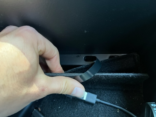

Easy USB Power to Central arm rest console.

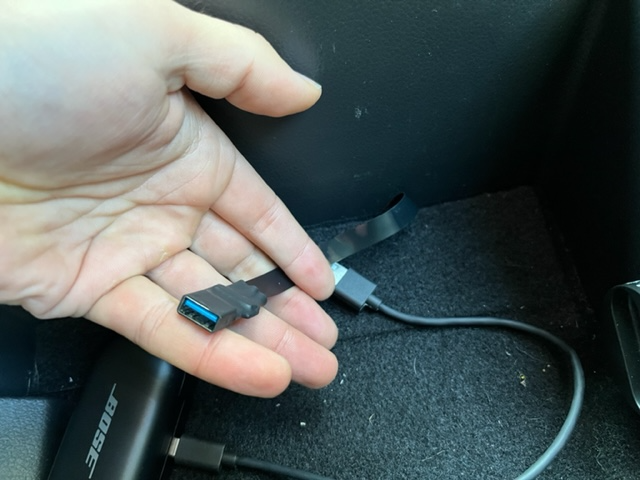

I hate cable mess so having to loop around a cable to the rear 12v plug or have cable mess up the front gave me the sh#ts and early Superbs don't have power to the central console. So something had to be done about it and I didn't want to have to graft onto wiring and pull the whole console out. Decided to have a crack at it with some ribbon cables. Took a punt and guessed a 50cm USB-A (male) to USB-A (female) cable from AliExpress might do the trick:
I removed the rear ashtray drawer (pull right hand side up and out and then slide the left hand hinge out to the right) and removed the felt liner of the central arm rest console. Using some string with a loop and a wire coat hanger i threaded the string back to the rear opening and threaded the USB cable through to the middle hole in the central console:
Then shrink wrapped the female end to make it look nice and protect it a little:

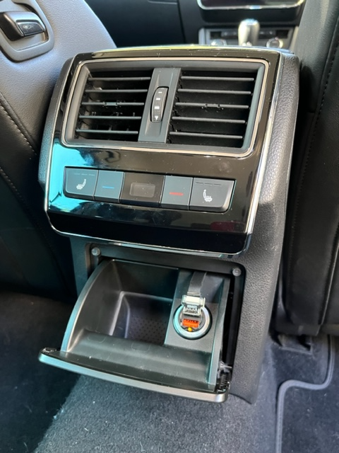

And then simply replaced the rear ash tray drawer with the cable over the top and plugged in a 12v dual USB socket and plugged in my USB cable.
Works a charm and still leaves the kids a rear USB charging socket for long trips. When i get round to it I'll shrink wrap the rear USB plug to protect it from the kids and make it look a little cleaner.
Turns out a 50cm ribbon cable is the perfect length for this. The cable behaves nicely with the opening of the drawer and gives about 15cm of lead in the console. When not in use it can easily sit down in the lower tablet space below the trap door too. Apparently the cable is good for up to 5A when lengths up to 50cm are used, which is more than it'll ever need to carry to charge the odd phone or my ear buds.

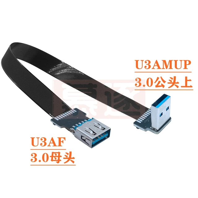

Any chance you can link to where you got these from please?
Yeah sure:
Flat usb3.0 male-to-female transfer FPC elbow usb extension line up and down left and right bend 90 degree USB connector
https://a.aliexpress.com/_mNC7Xk6

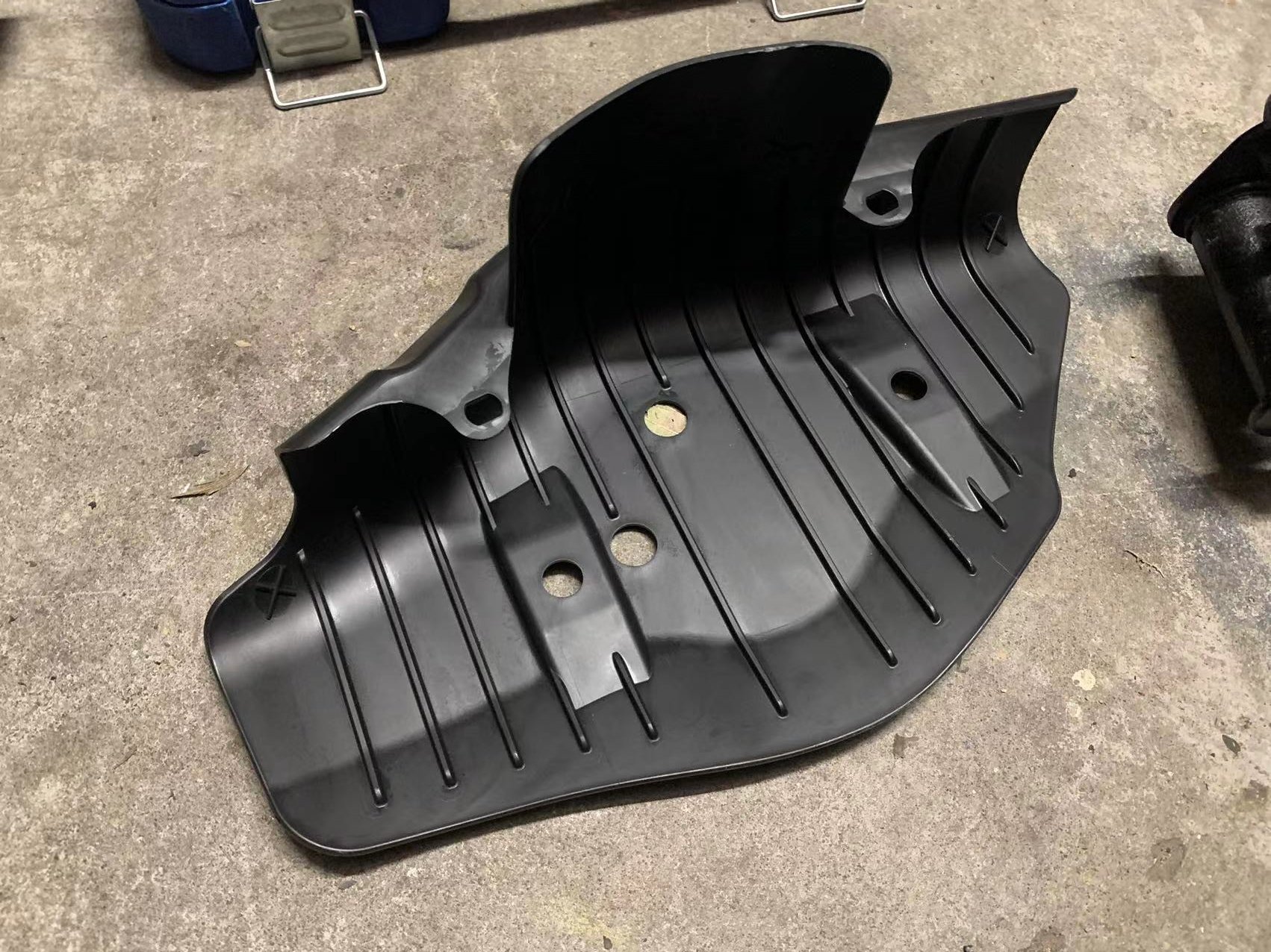

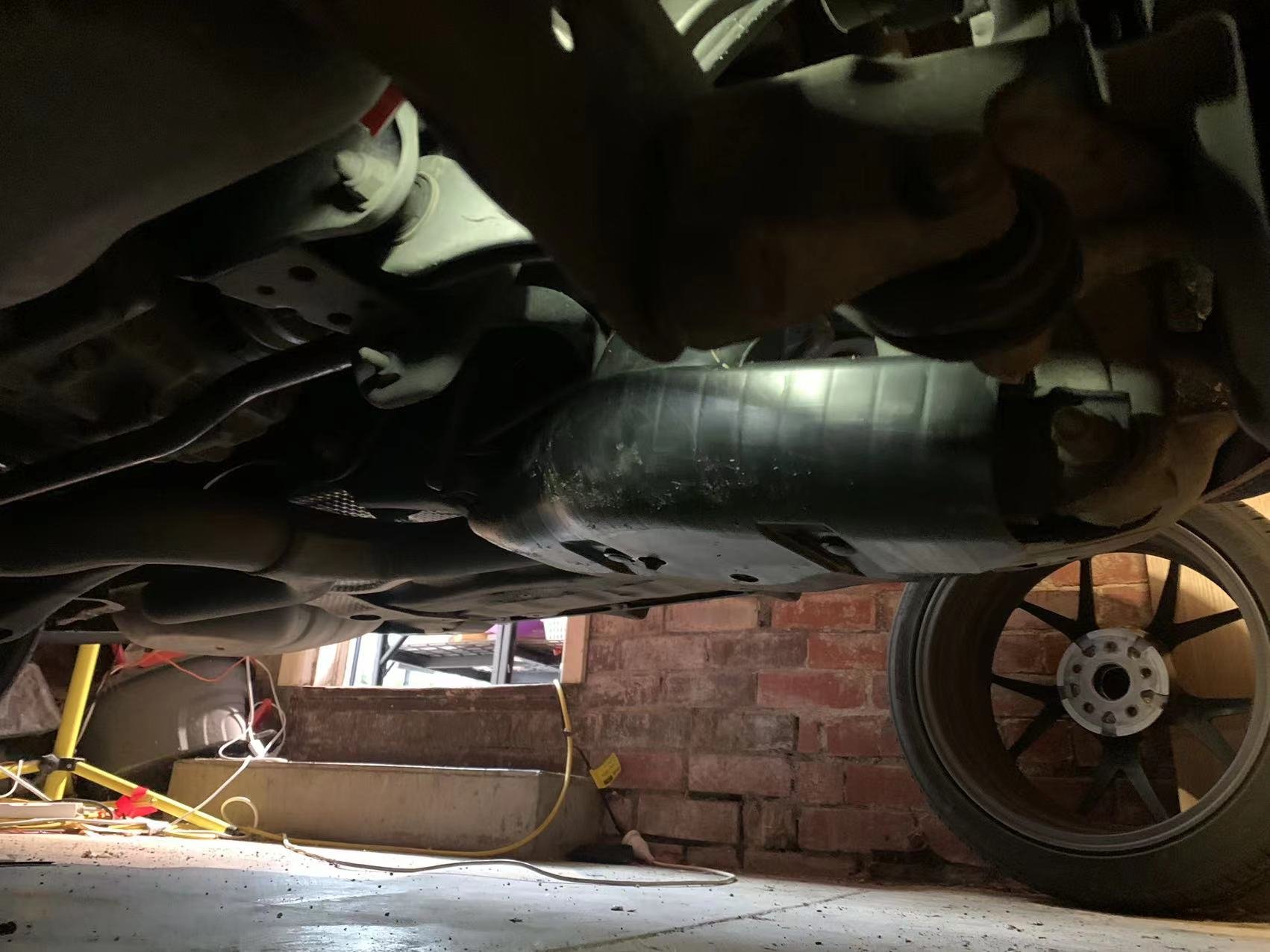

Installed Golf MK8 rear lower control arm cover today.
Super easy install, basically plug and play.

What’s the benefits to these? Any reduced wind noise or anything?
Interesting, I guess improved MPG (as well as a bit more protection) is the motivation?
