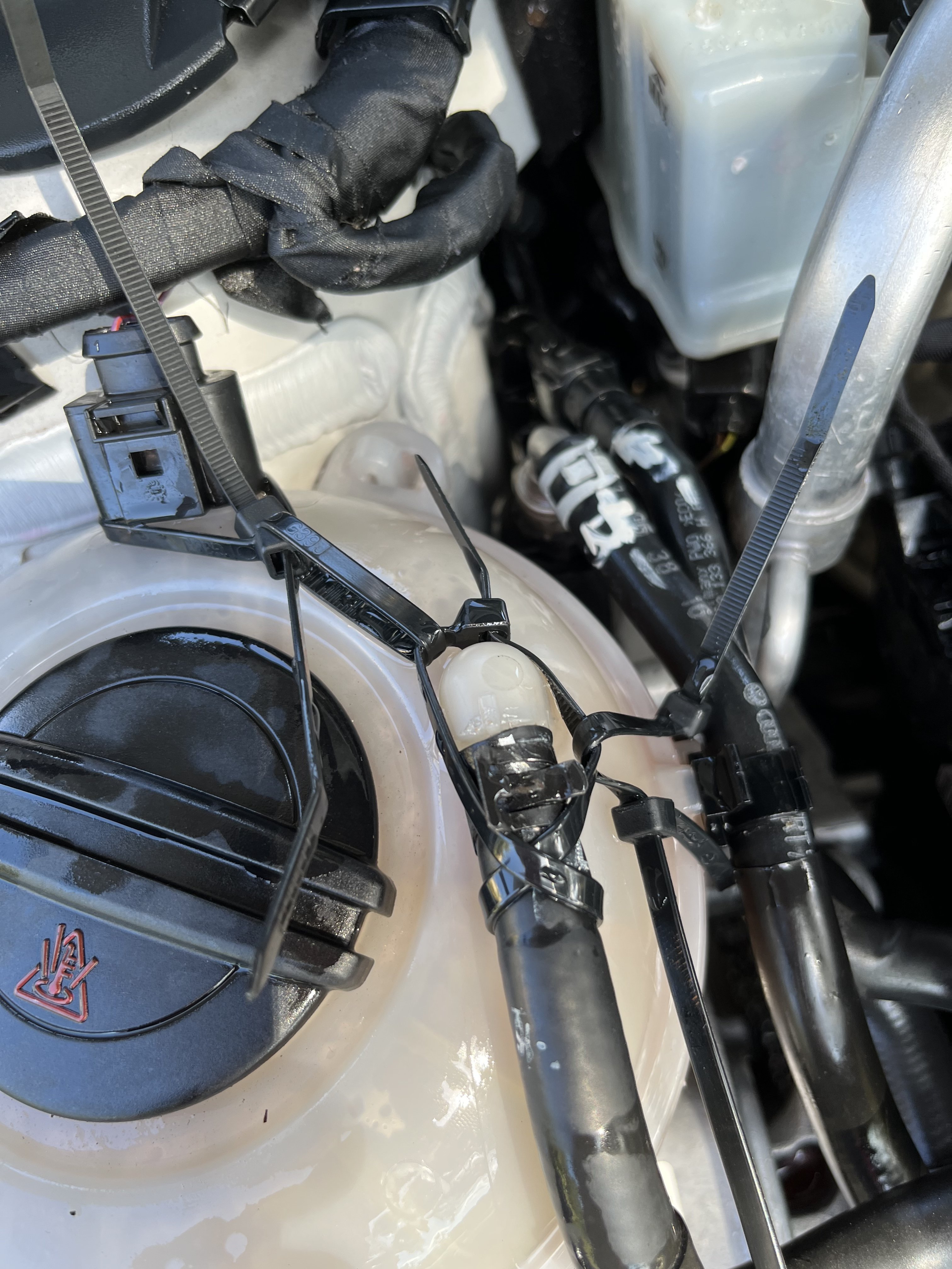

I was sitting in the car idling on a work call when a huge white plume exploded out from under the bonnet yesterday. Turns out the nipple on the return pipe for the coolant reservoir snapped off under pressure covering everything in pink coolant.
So anyway, a few zip ties and liters of water later and we were off and driving again to the mechanics shop leaving a trail of drops behind us. Apparently this is quite common in MQB cars. All fixed now…

Personally ive never seen this kind of failure not on any MQB platform vehicles. Only really saw it on Vauxhall and BMW on brittle connectors. Very strange!

It was bizarre. Just sitting there idling and all of a sudden poof! A white cloud of smoke streams out.
I called my mechanic who handles a fair bit of VW service and told him the coolant reservoir hose was ****ing boiling coolant and he literally said “let me guess, the return hose pipe snapped off”.
I took a closer look at the broken pieces once it cooled and the plastic does look pretty thin there. Probably more importantly the pinch clamp that holds it on was sitting about 10mm back from the end of the black hose towards the end of the plastic nipple which is where it is weakest.
Anyway, was simple and cheap to fix. New reservoir was delivered to the shop by the end of the day and the hose now has a screw clamp right at the base where it’s strongest.

maybe happened when the timing belt got done, heavy handed mechanics   😂   they normally disconnect the reservoir and swing it out the way with the hoses still connected,
any  strain on the connector might cause a crack which eventually fails xxx amount of months/ years later.

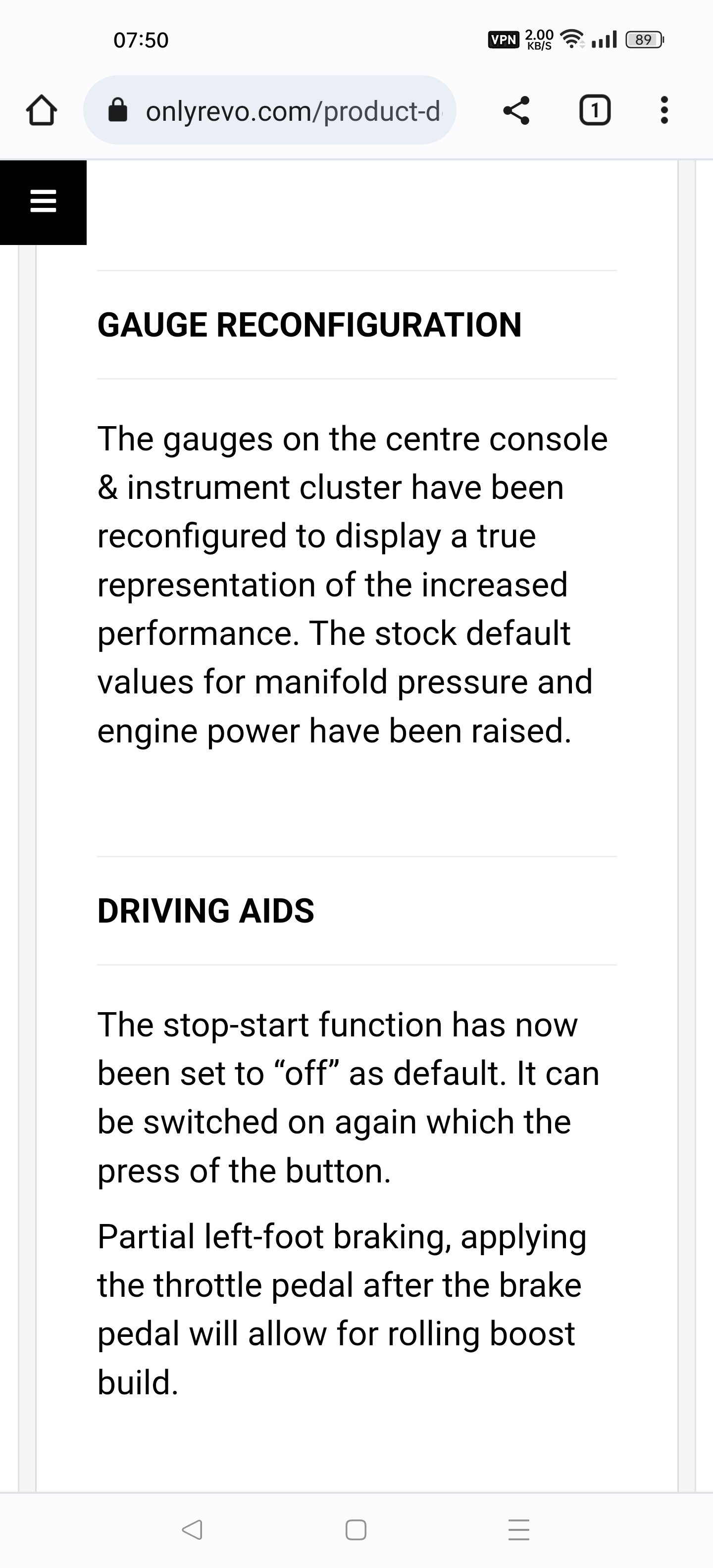

I forgot to say, a nice bonus of the Revo map is that it defaults the Start-Stop system to off, so no need to push a button every time I get in the car.

That must be a new feature because I don't have that on my Revo stg1 which was installed in 2020.

Double checked on the drive to work this morning in case I was going mad. The feature does work and they call it out on their website now.

Interesting. I wonder if there is an upgrade option available which could be added on to my next service maybe? I think I will enquire with my local Revo VAG independent when the time comes. Having said that, some of those features mentioned under "gauge config" look like they are related to a digital dash which I don't have so this latest revision of the software may not be backwards compatible with older Superb III models.
I might just ask Revo directly & see what they say.
