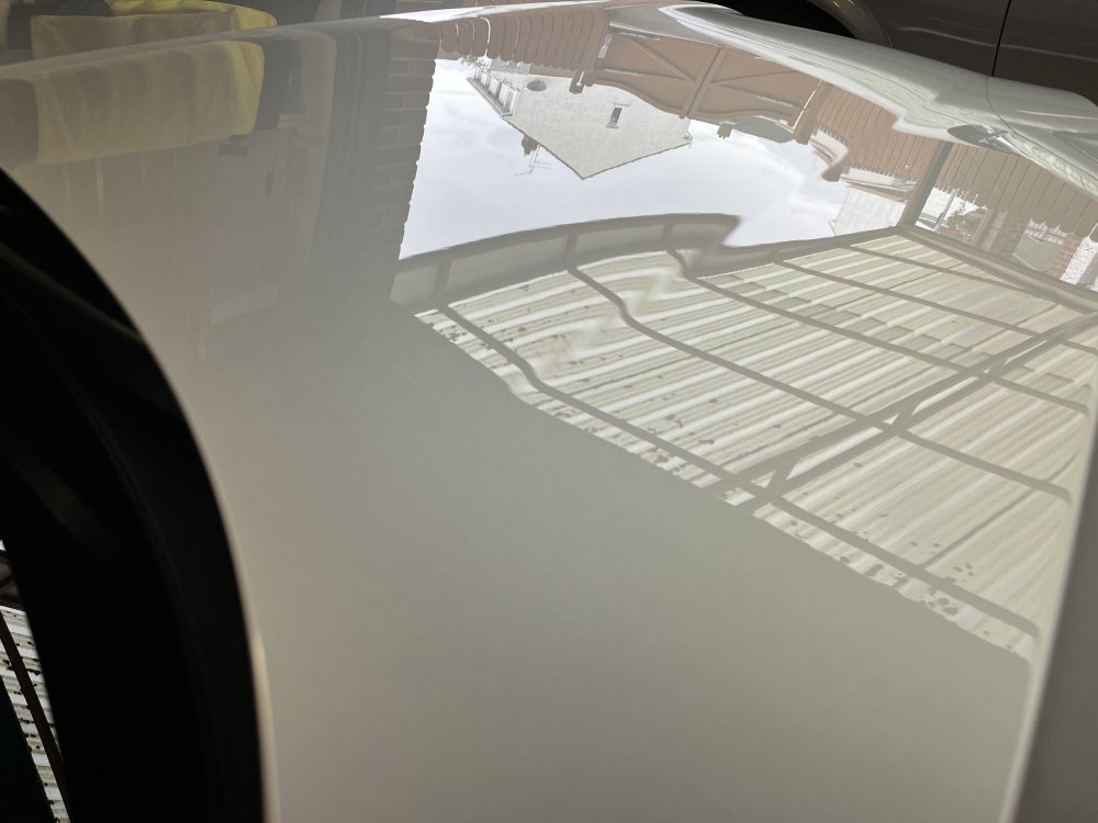

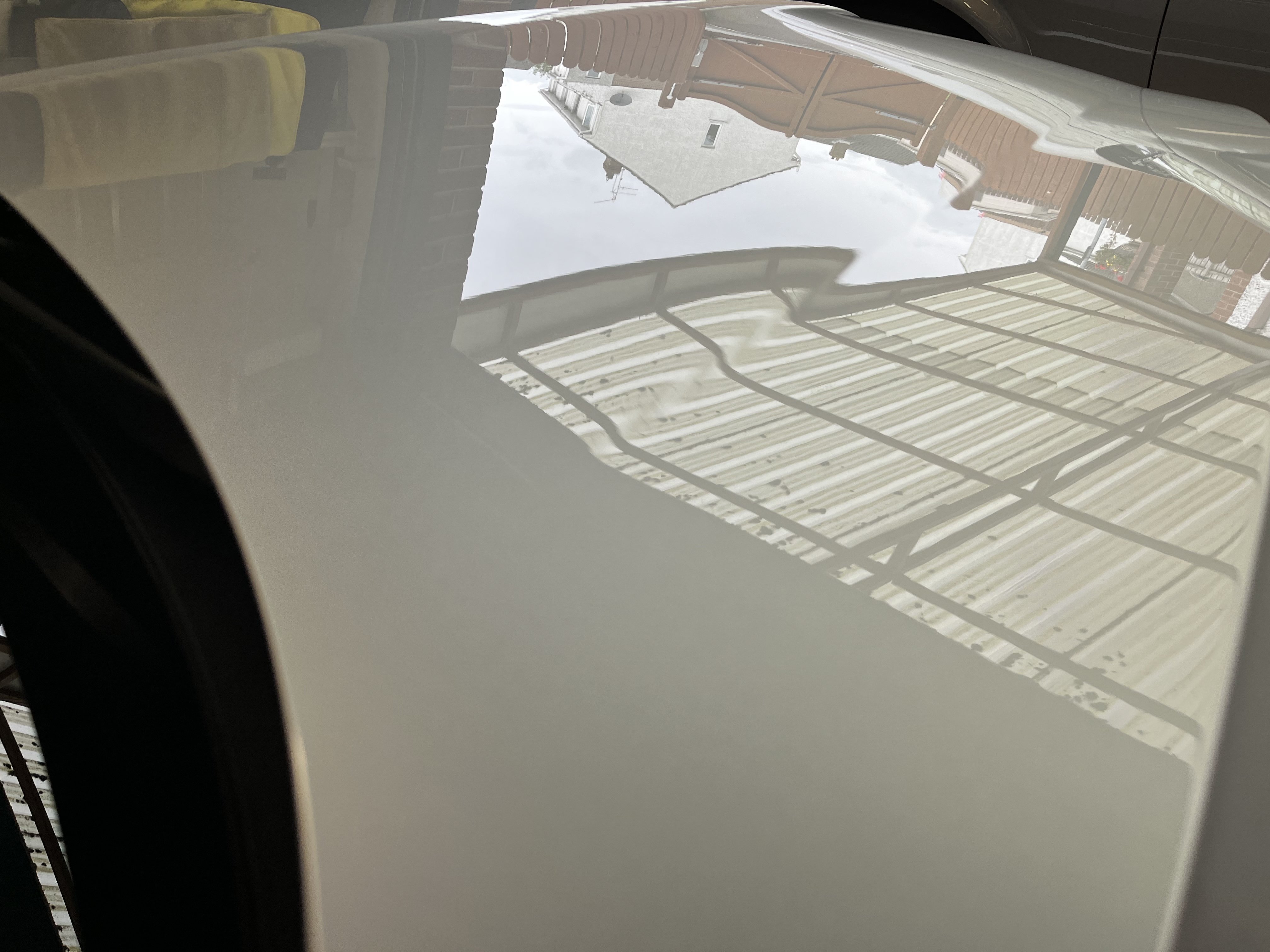

As promised, some pics of my detailing job these lasts days:
The glossy black door covers, always very scratch sensitive:
Before:
After:
Top part of the passenger door (it's a LHD ;)):
Before:
After:
Not very easy to "catch" the swirls with a camera... But these 2 examples are very representative of the improvement.
Other pics with complete view coming soon... ;)
Before:
After:
Before:
After:
Impressive results for a self confessed beginner with a DA. What products did you use? e.g. cutting compound, polish etc.
I'm interested in doing something similar on my car which has swirls & a few bird lime marks.
@Colin170CRI had planned to use Menzerna 1500 to 3500 (I had bought a 1500/2500/300/3500 pack on a french detailing website) depending on the deepness of swirls, but.. I had forgotten them home... 🙃
Then I used my father's products: Meguyars' #83
Besides I used a Hex-logic white pad (heavy cut) from Chemical guys on my DA.
The clear coat is very hard or... Meguyars' #83 and/or my pad not abrasive enough... or swirls very deep. As written above, I've removed only 70-80% of micro-scratches 🤔
But don't be fooled by my pics, the resolution is quite poor, there are still some swirls. I should take better pics of the results. ;)
But thanks anyway for the feedback. :)
