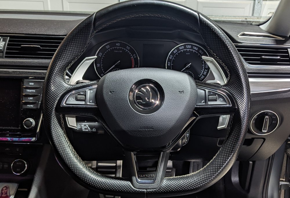

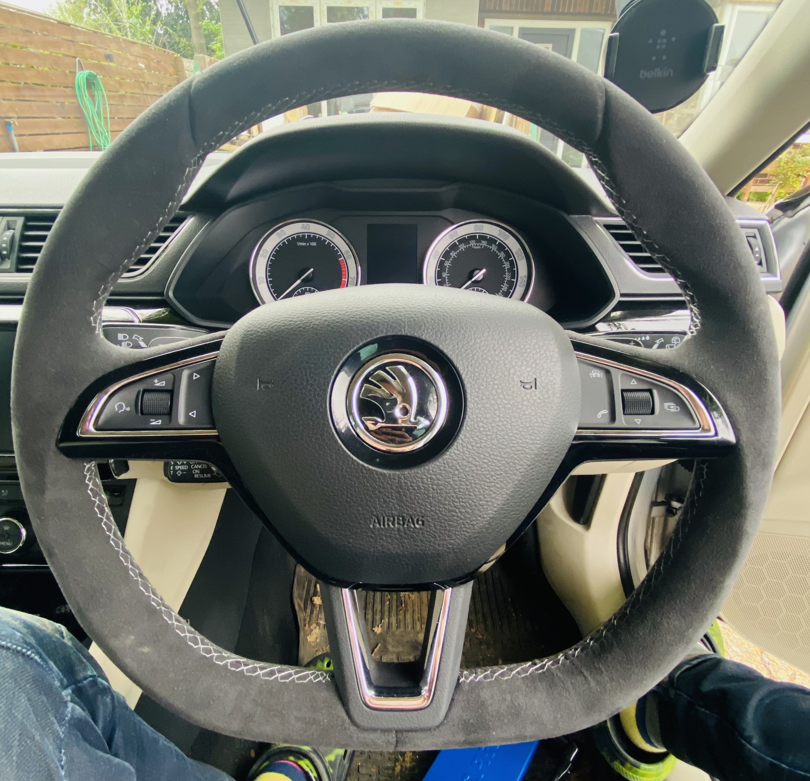

Just fitted a flat-bottomed alcantara steering wheel to my L&K wagon. Ordered from local skoda dealer. Total steal at ~£260. Surprised that buttons came included. Disconnected battery. Figured out how to pop out the airbag with screwdriver. Disconnect wiring loom and button loom. Used torx head and took old wheel off. I also ended up removing horn fuse under the bonnet. Night and day difference. Feels amazing and sporty. One of my best mods so far. Dash lit up with many errors after battery reconnected and started. But these all clear after a short drive.
Nice work.
I did that recently too - but not the Alcantara version.
I didn't disconnect the battery when I did mine.
Much better look n feel, and the Leyo Paddle Shifters finish it off nicely.

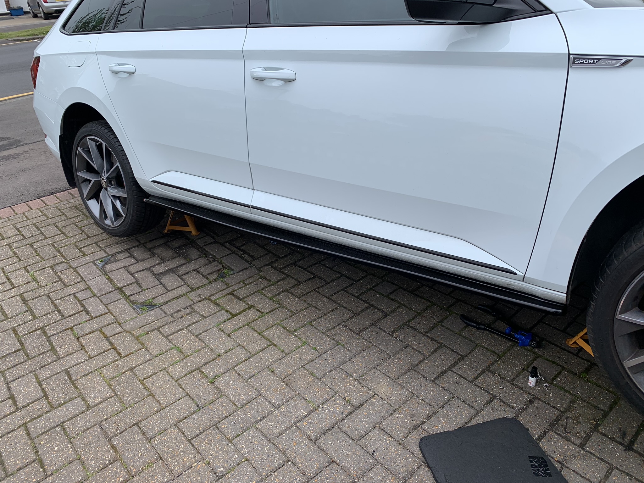

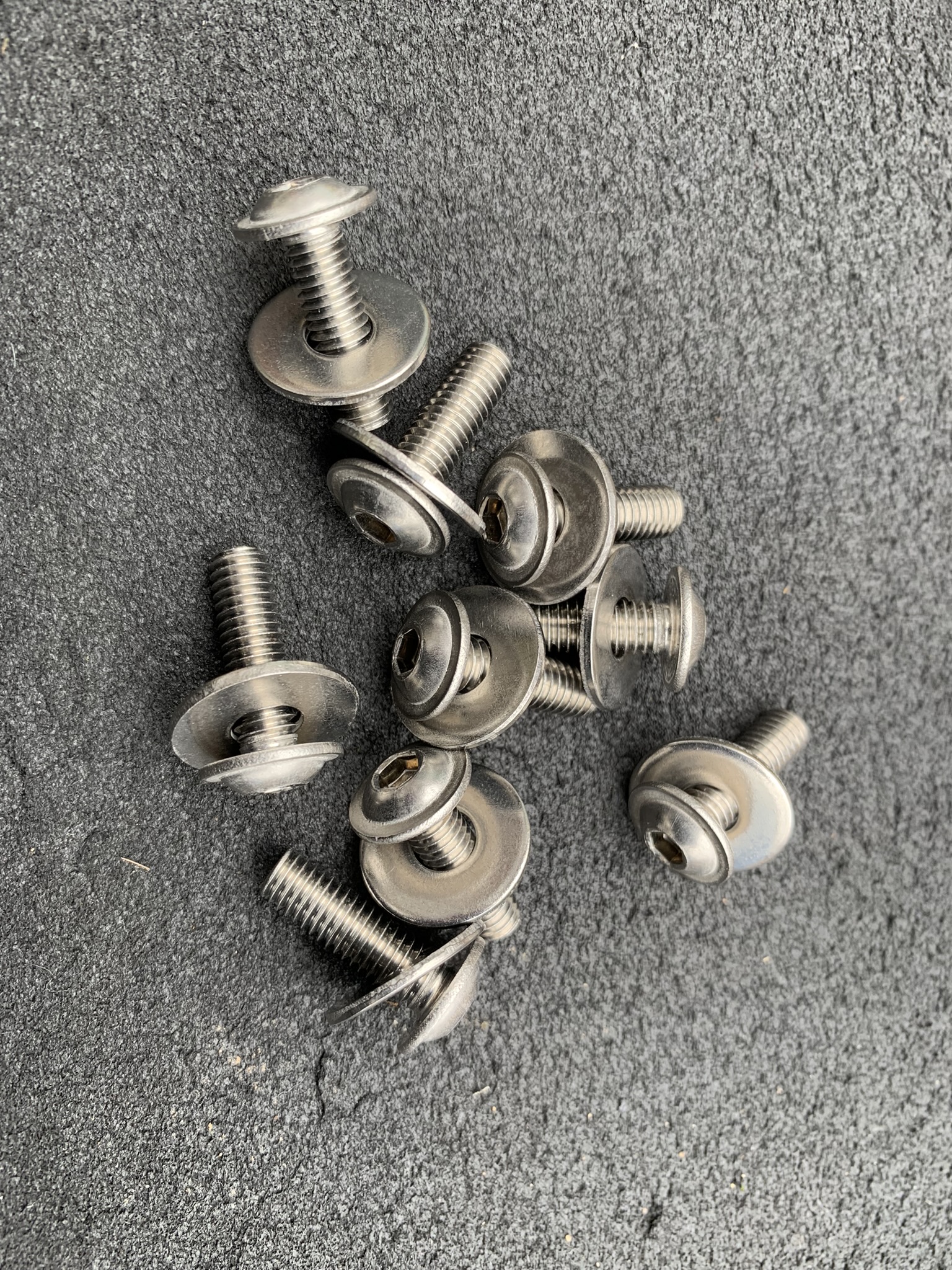

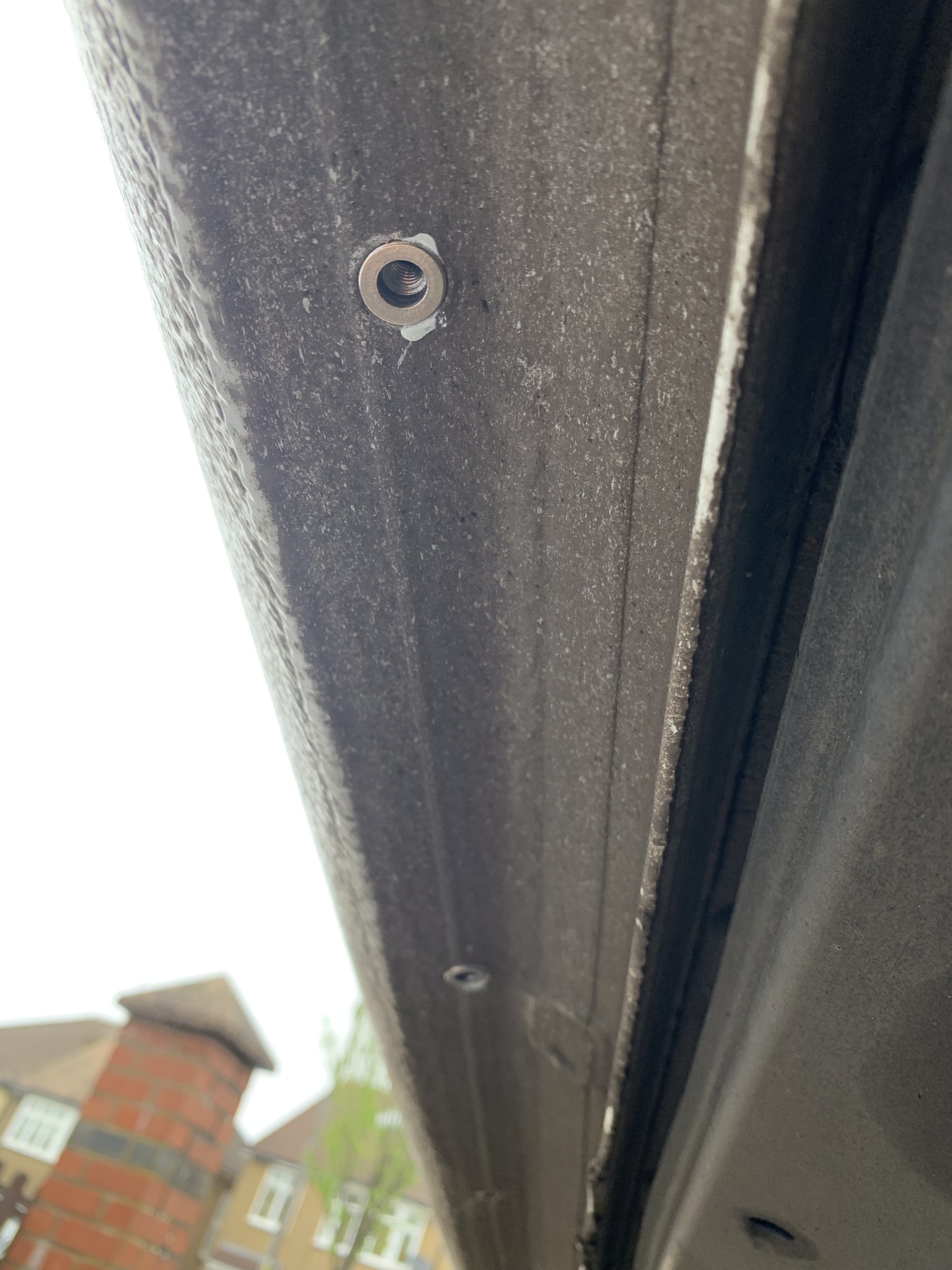

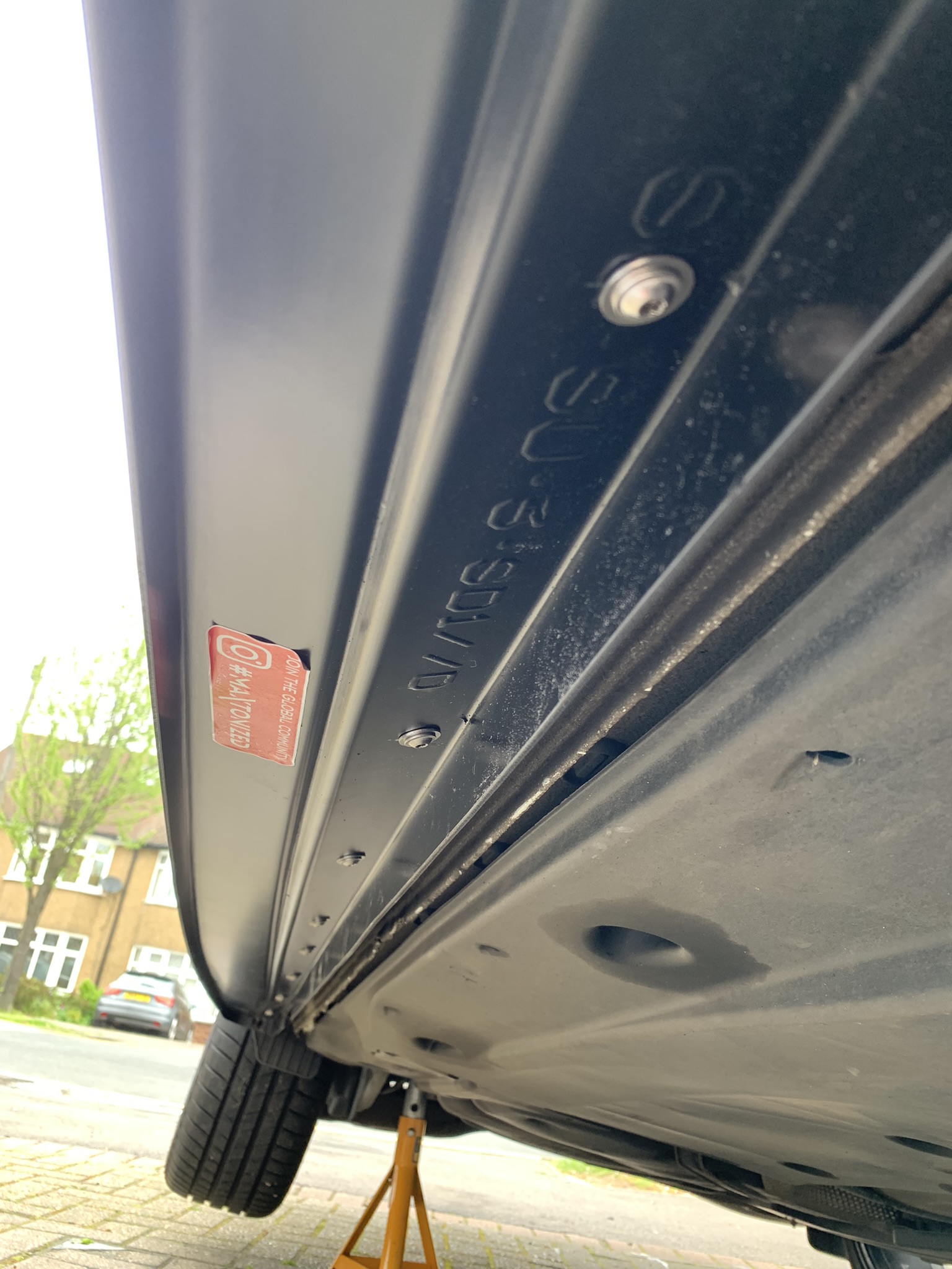

Ive got to say, for the price of a maxton kit the fixings it comes with and instructions are shocking!
They really expect you to just slap some tiny self tappers through the sills and that will hold the side skirts on. Really not good enough in my opinion.
Instead I went down the route of drilling the sills, painting the now exposed metal, fitting stainless steel rivnuts flush with the underseal. Then fitting the side skirts with stainless steel bolts and large stainless washers as well as a good seam of PU adhesive to prevent water getting into the area.
All of these extra parts cost me £15 and a good few hours of my time. But at least I dont have to worry about rusting out sills or my side skirts falling off.
Excellent reinforcements u've done there.
I've heard various stories about the poor instructions and fixtures that come with various Maxton products.
The Rieger products r great in that regard, hence why I went with Rieger side skirts and front splitter.
