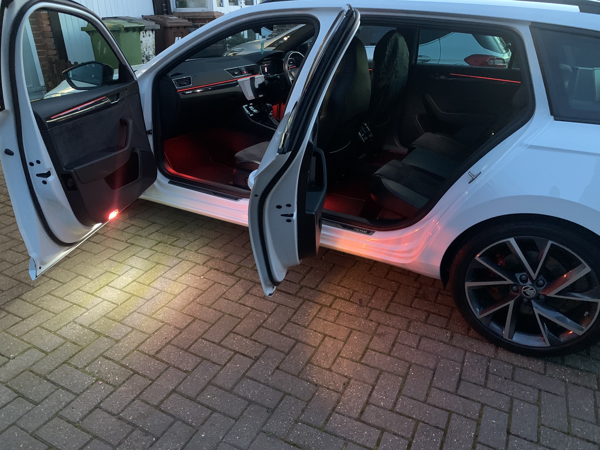

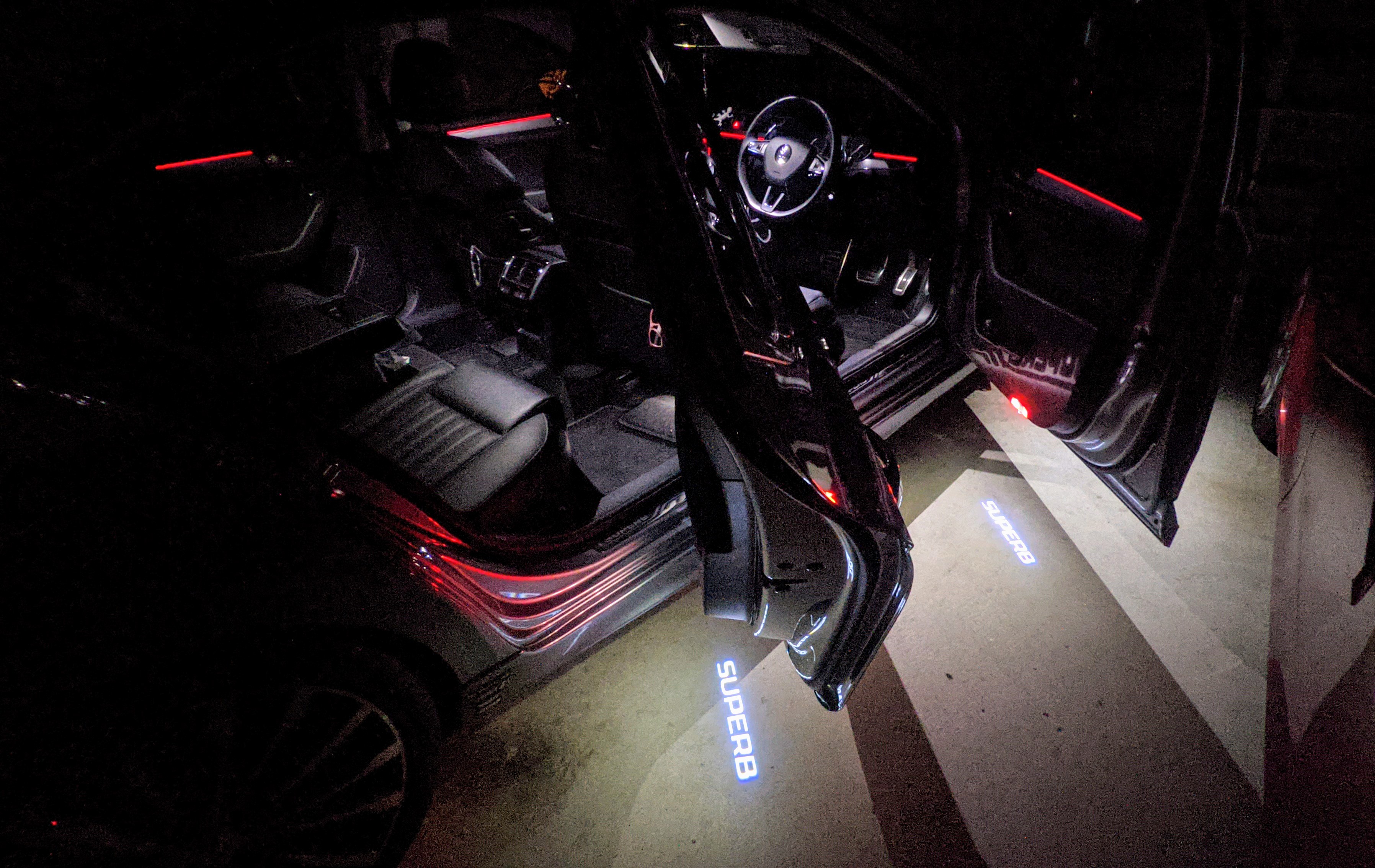

We now have rear kessy handles working as well as fully working rear door warning lamps!
I highly recommend the "Superb Ghost" lights from Kopacek as they add a nice touch, without loosing any shine on to the ground.

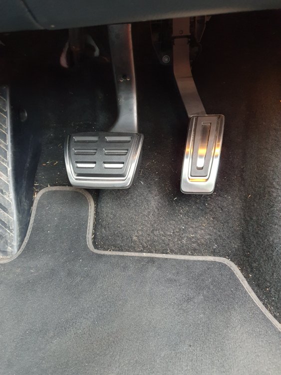

Today I fitted RHD DSG brushed metal pedals with the following part numbers
5Q2721647A
5Q0723131A
The acceleration pedal was extremely tricky to fit.
Trick to use hot water to make the rubber soft and a trim removal tool so you can pry it onto the accelerator.
The brake was a doddle as just popped off and on.
This now has the Sportline/Monte Carlo look
Edited by John1701
Clarification of work
Bloody thing kept sliding off when I was on the M6 Toll last year. 🙄 Bloody dangerous. I had to buy some superglue in the services and stick it on. Thankfully, its been fine since.
