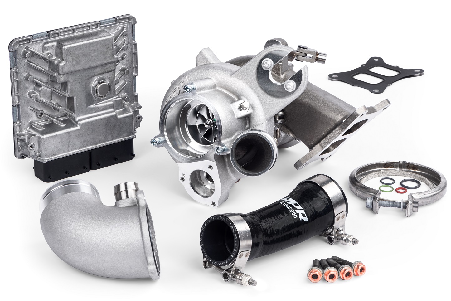

no IS38 on the horizon for me, instead i'll b going for APR's DTR6054 turbo
but first i need the bigger APR intercooler.

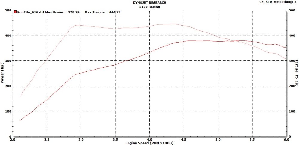

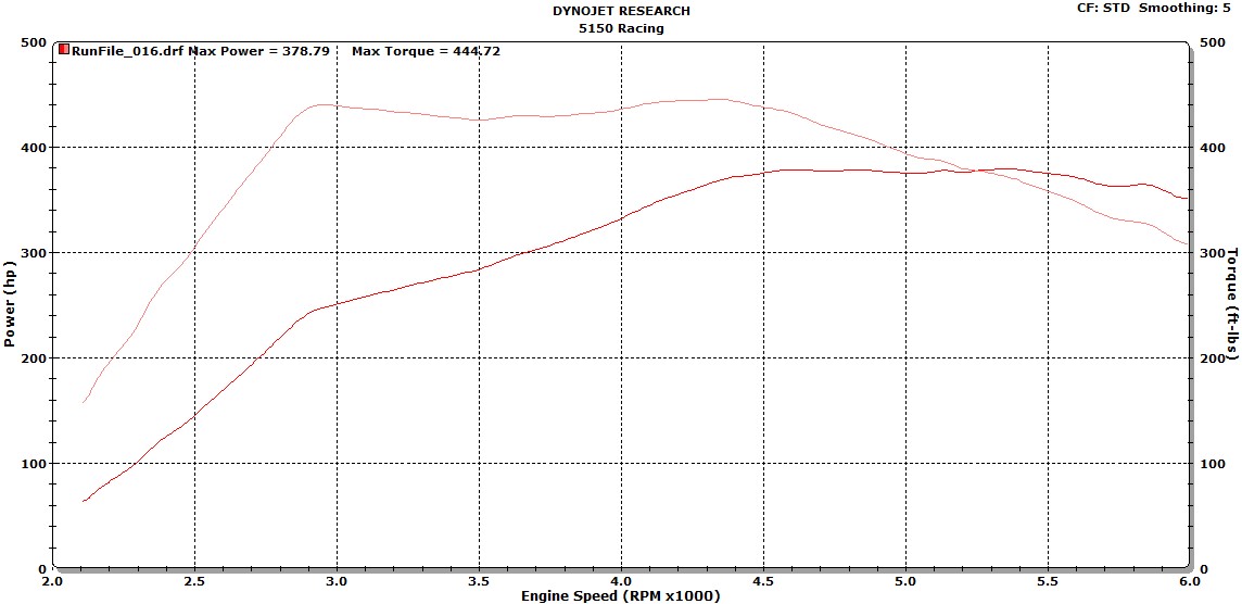

What if I told you there was a much cheaper option available to you that could get you this sort of performance...

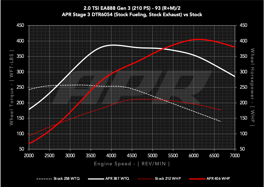

vs the APR figures on the Stage 3 package...

the DTR6054 is drop in turbo that is easy to transition from an IS20.
works with the existing factory components, including factory intercooler if desired and reuses factory wastegate and diverter valve.

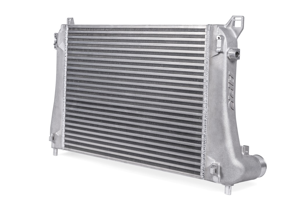

although, to make the most of the turbo, an upgraded intercooler, intake and TCU tune is recommended.  i just need to upgrade my intercooler as i've already done the others.
comes with the stage 3 software, which also has the optional FWD file that will limit wheel spin by limiting how torque hits.
i had a conversation with the APR tuner here, and they say that it is perfect for my setup.

That's good that you have a local dealer. That counts for a lot as Stage 3 normally needs tweaking of the OTS map to finish it off so you don't want to be running all over the place.
That first dyno is actually your humble IS20 tuned for e85! Would just need a downpipe, intercooler and HPFP. It's a shame APR stopped development and sale of their stage 1 E85 products after the EA888.2. Judging by the numbers the IS20 guys are getting on corn it would have eaten into their stage 3 sales.

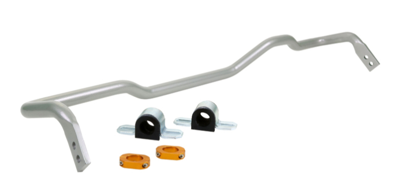

Finally got around to installing a Whiteline adjustable Rear Sway Bar a few days ago. The standard sway bar on the AWD is 22mm, this is 24mm solid steel and I had it set to the hardest of the two settings (so equivalent to 25mm). I kept the factory end links (I'm not going to track this vehicle!).
Definitely worth doing, and transforms the cornering response - it now has a much sharper turn-in, very flat, smooth and precise and a great addition to the Eibach springs. Happily, it's removed much of the inherent understeer and greatly reduced the sense of bulk and weight of the Superb when it's cornering. Ride comfort is unaffected.
Is this the S3 / RS3 part from Whiteline?
Whiteline part number BWR25XZ, for Mk 7 Golf R/Audi S3.
