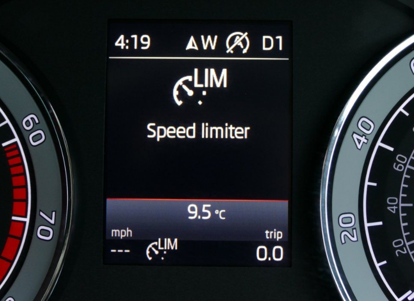

The Speed Limiter will not whinge at you, it will not go above the set speed unless you cancel it or press the accelerator fully down.
I have my speed warning set to 5mph above the Speed limit, this is completely different to the Speed Limiter.
Start your car and press the button underneath the cruise control stalk. You will see a change in the display in between the Speedo and Rev Counter.
You can not have Cruise and Limiter on at the same time.

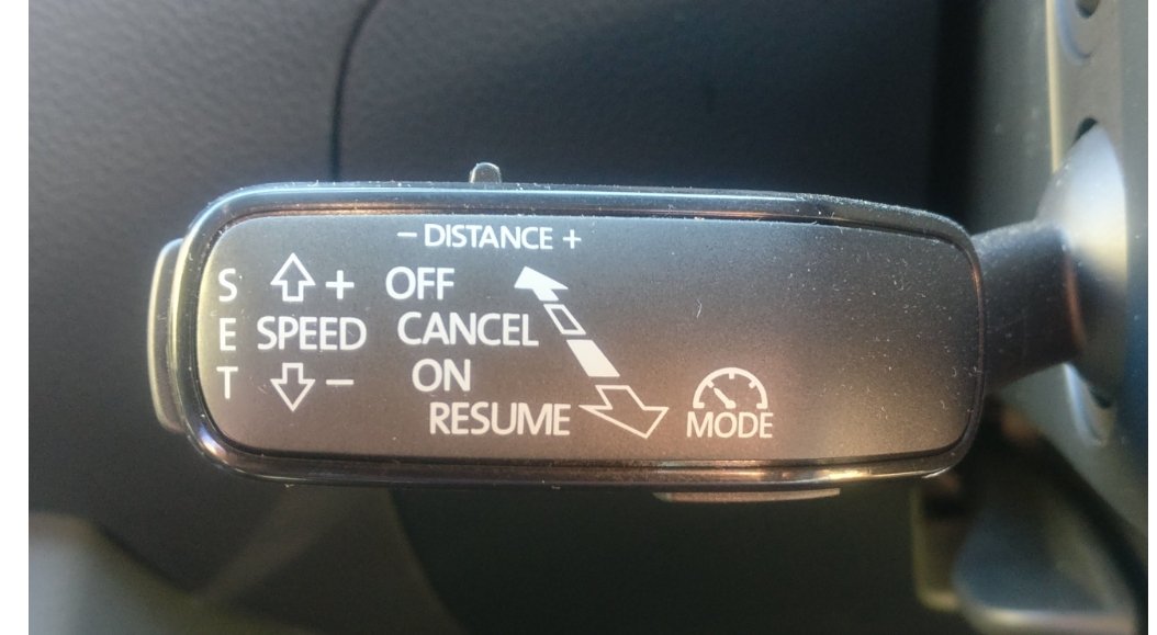

This?
Press the Mode button to toggle if you have one.
Edited by vfrvrs
i thought i remember reading somewhere that the MY16 Superbs does not have that "mode" button.....
Yeah I’m pretty sure mine doesn’t have that button. I’ll have to check when I get my car back. Currently driving a Karoq courtesy car after smashing 2 alloys on an invisible traffic island :D
