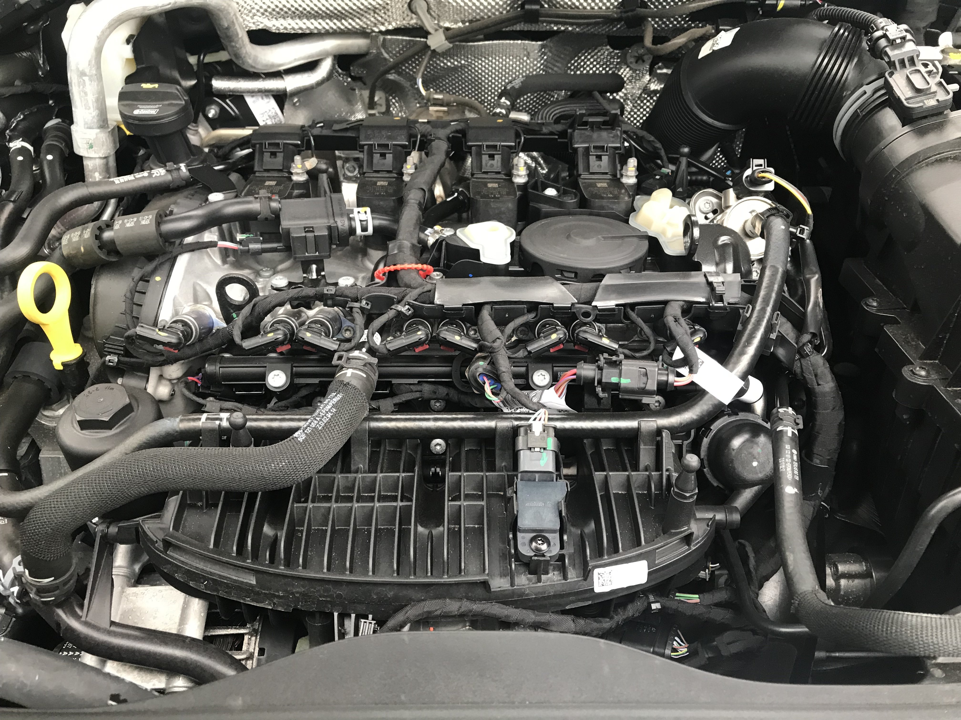

I also have a 2019 Kodiaq with the ea888 gen 3b 2.0 TSi and my one has both direct and port injection, I’ve had a look and you can see the low pressure fuel rail and injectors.
That's interesting - I couldn't find any on-line reference to the 3b engine having this, only assertions that it doesn't.  Is it easy to see, or do things have to be removed first?
@Sweephand if you take the engine dressing cover off you can see the high pressure fuel pump (HPF) on the right hand side, it has a high pressure stainless output and a low pressure output to a plastic distributor bar for the  port injection. This is not present if the port injection is removed.

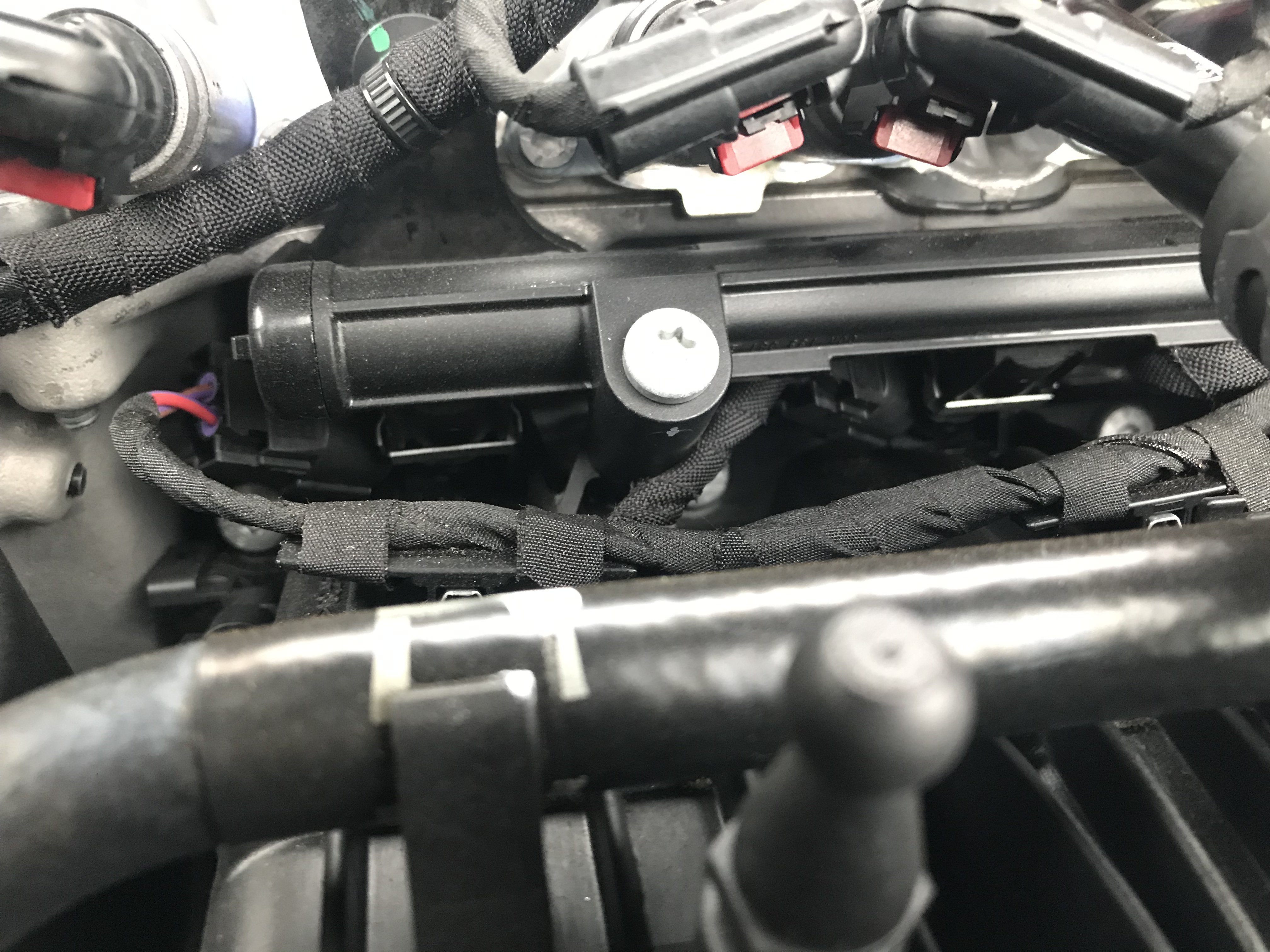

Kodiaq ea888 gen 3b 2.0 Tsi 190 with GPF definitely has MPI see my photo below, the black plastic rail feeds the port injectors.
The Superb MPI topic is here, there is a photo of a S3 engine further down and you’ll see the parts for the MPI are missing.
So if you have a 2.0 TSI and have the black plastic rail shown below you have the MPI and shouldn’t suffer from intake valve issues mentioned in the post.
You can just see the red / purple wires going to one of the port injectors on the left hand side beneath the fuelling rail.
