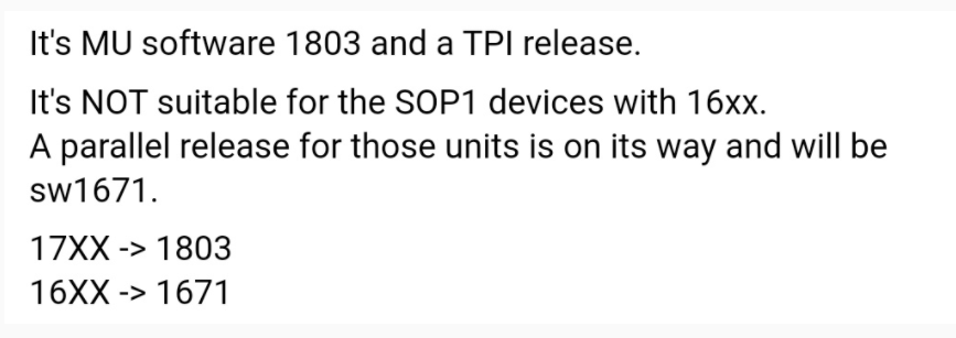

From German forum.
Looks like devices ending with <D will get 1671 SW and devices >D will get 1803 SW version.
What about D itself?
@TheUltraRunnerThanks for this.
Did they mention any changelog or timeline for the 1671?
I believe D are running 17xx already so, they would be included in 18xx
Yeah, I should write ">=D" I guess :biggrin:
@Coume sorry, nothing else was posted beside this picture.
4 hours ago, TheUltraRunner said:
From German forum.
