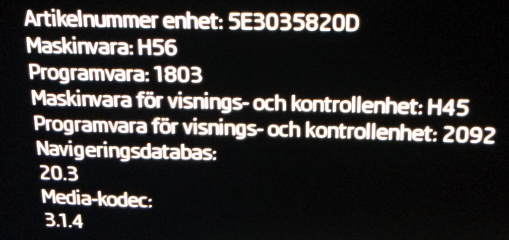

System info car manufactured week 27 2021:
Now I'm curious to know if this PN is the same HW as 5E3035816x and it is a pure SW upgrade or whether there is a BOM revision, etc.
