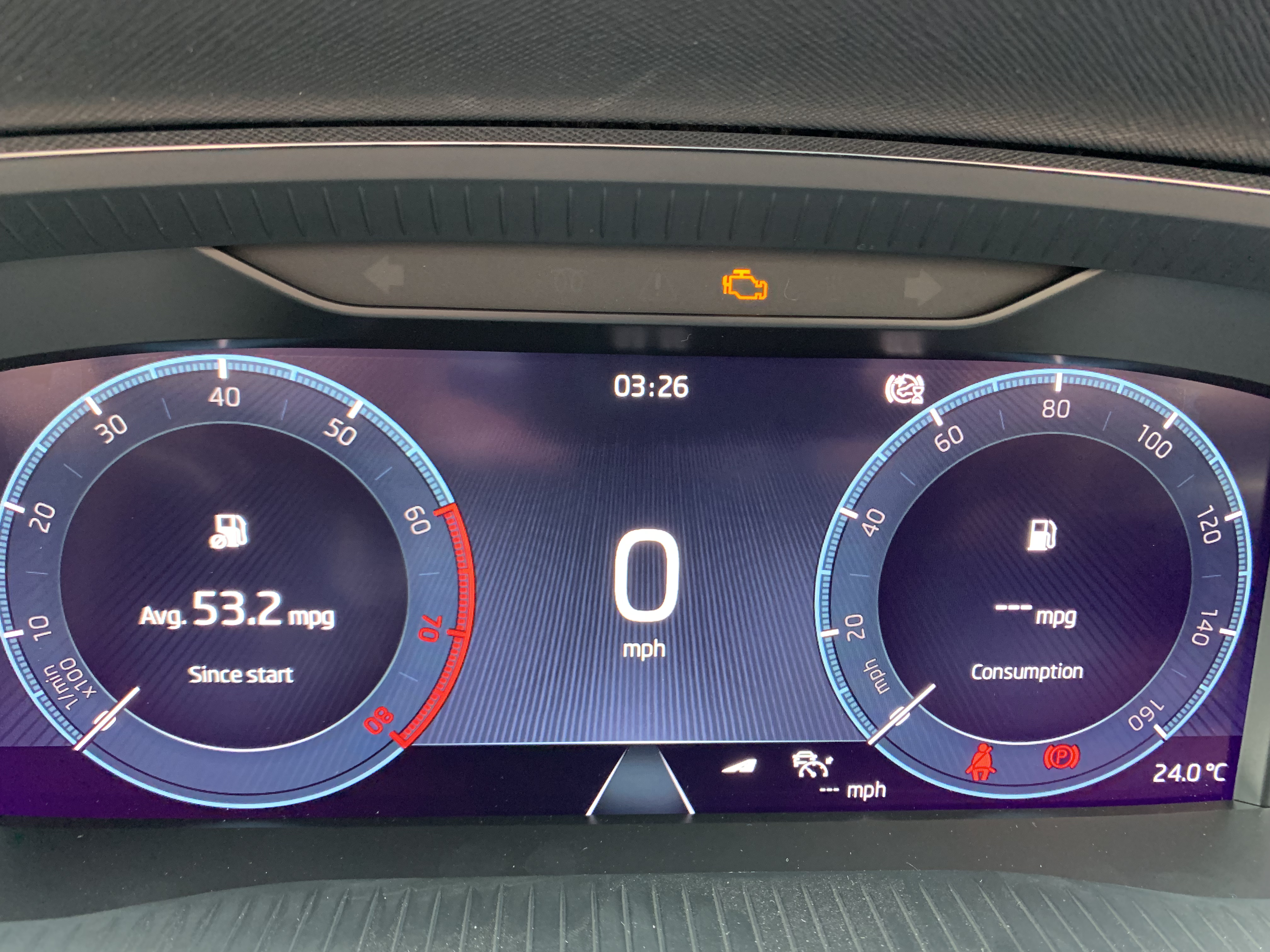

What SW versions are now reported by the MIB?
If they replaced the virtual dashboard, is it safe to say that you have the clock displayed on it too now?
Short answer - yes.
Longer answer - as per the photo at 3.26pm it displays 03:26. A check in the settings and the time is correct, and set to 12 hour display so they forgot the am/pm differentiator! Changing it to 24 hour display it more accurately displays 15:26.

1 hour ago, sneal said:
Short answer - yes.
Great stuff. Having the clock on the dash of the second loaner made me realize how useful it is!
