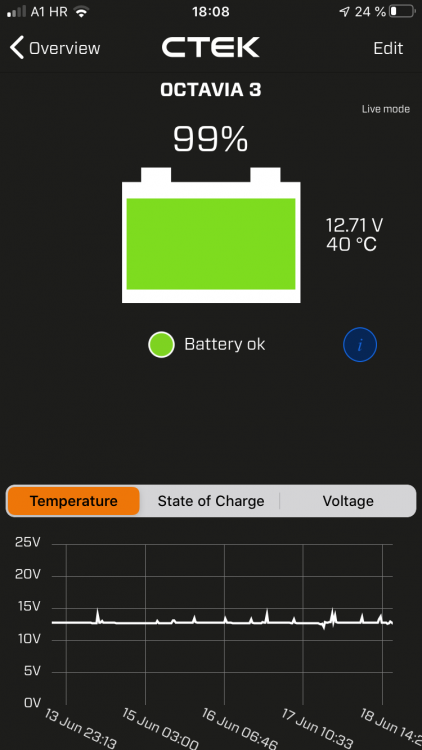

Changed 8 months ago whith no coding an still workingC7C1B11D-4CD2-4A01-A436-AED1BC595EF8.thumb.png.5cfcf3eec10add2e2af97b1db420bb61.png

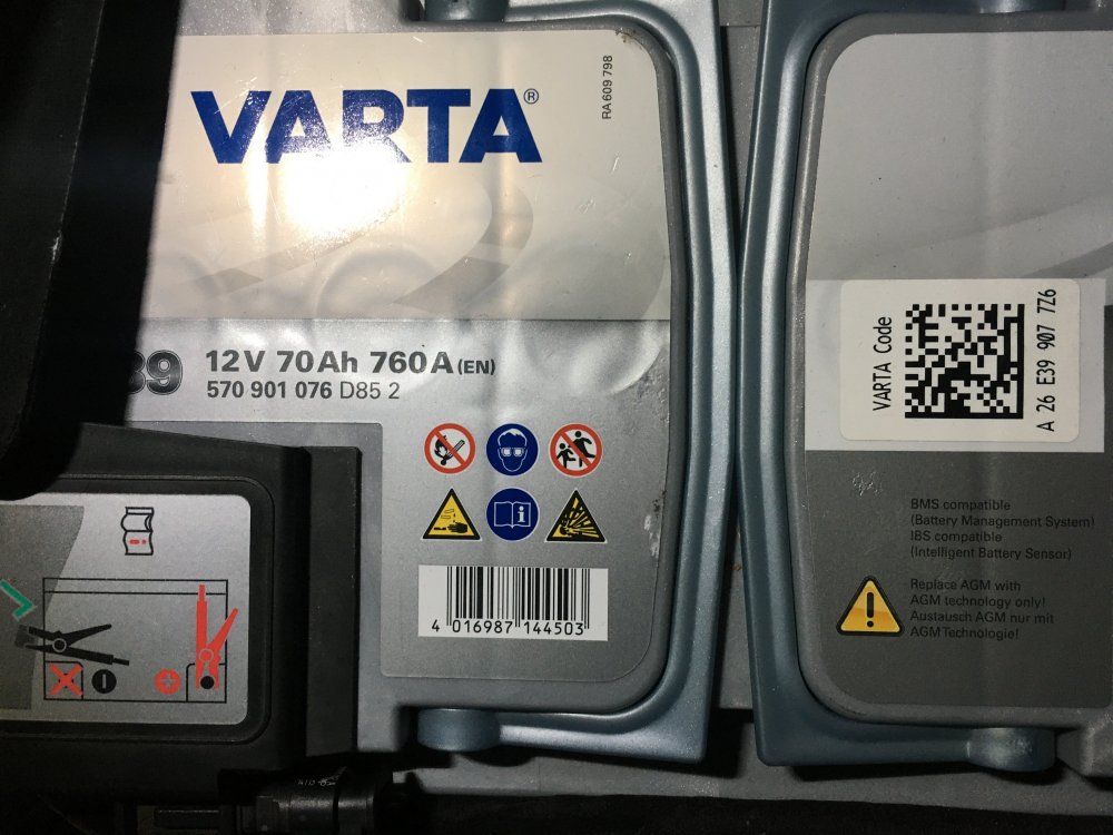

The OEM in there is a Varta AGM, so will make sure they don't change the setting for the battery chemistry!
Just be aware that I do not know of any Octy that was fitted OEM with a Varta AGM. They had cheap EFB batteries usually made by Moll.
There is a chance the battery has already been replaced (original EFB is unlikely to have lasted till now) It may not have been coded correctly in the first place
I am surprised a Varta AGM is causing issue

It's owned from new and it's Varta AGM.
Perhaps Scout spec plus heated screen, mirrors and arse warmers etc. triggered AGM from the factory.
I don't hold a grudge for the Varta battery for dying after >5 years of abuse TBH.
+1
I replaced my AGM with another AGM, never changed any VCDS settings and all was good.  Changed it on the driveway, simple job, a few dashlights when started and they went off after a few mins of driving.

Mine came OEM with a Varta AGM, so I think the EFB / Alternative brands were a bean counter exercise.
