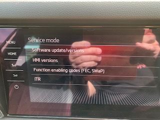

I've downloaded the map update from the vw link,extracted it using 7 zip to a 64gb sd card which i formatted to fat32 with the raspberry pi tool, but the nav unit won't find the files on he sd card it just comes up with an error saying no files found etc,i've followed the instructions below on a different post about the menu system,below  but all i get is a service menu which looks like the photo below,this so frustrating
this is what i get when pressing  the menu button for 10 sec

I've got alternate instructions on how to update via SD card. I've just tried it and I got to #5 where it says the update takes 60 minutes, but unlike the normal update you need to leave it going with the car not running. I'll be updating myself tomorrow.
1. Press and Hold Menu Button for approx. 10 sec until you will see:
Green Menu / Test & Erprobung / SWDL / Picture Viewer ....... please select Green Menu.
2. In the Green Menu select rcc >> swdl >> tick "User Defined SDWL"
3. From the Green Menu Press and Hold again Menu Button for approx.10 sec until you will see: "Green Menu / Test & Erprobung / SWDL / Picture Viewer ......." please select SWDL . and tick "Software Download Manual Download" and press Start Download.
4. Insert SD Card with latest Maps then press Update select "SD card" and press "MIB2 navigation database"
5. Press "Select all" and then press "Start"

On your second method and its got to the point where it's showing Y or Yes against the navigation attributes (Eggnog, NavDB etc) and not Err or an N or No means you are fine to proceed. It's the developers menu.
You either leave the engine running or you follow a strict come back to the car every 15 minutes and open the door (the later I do) this forces the Infotainment unit to remain powered up. Power drops every 20 minutes if you don't open the door. Basically I start it off, come in doors, give myself 15 minutes, go back out, open the door, check, go back in the house, come back out 15 minutes latter.... and watch the finishing touches or go back in the house for another 15 minutes. Once it's finished the menu can be a bit ambiguous least on a Seat. Generally when it appears finished give it another 30 seconds or so and power back up using the on/off.
That's the retro-fitters method if you are using the developers menu and don't want the engine running. Generally the drain on the battery isn't much so I would worry about flattening it. Just remember to open and close the door every 15 minutes :).
The Y / Yes (which ever it is) on the attributes is important since if you see Err / N or No don't start it off since it's done a validation on your file and decided it's not going to work. If you install like this then it will delete the map in the unit and it's then empty or in the Seat case that still uses Mapcare your navigation FeC isn't valid so the map uploads into the unit but is suspended within 30 seconds of selecting a destination and starting navigation off.

I don’t quite understand, you see I get the error that it can’t find anything on the card, but it doesn’t ask if I want to proceed, is there just meant to be 2 files on the card MIB1 & MIB2 as there’s a third file which isn’t in a folder & does it make a difference if I didn’t lock the Ed card so it’s read only when inserrting it into the card reader in the car ?
You present both folders mib1 and mib2 to it off the route directory. Attached is the VW manual which provides the clearest instructions on presentation on the SD card.  Page 3 is what you present to it. The metainfo2.txt file is important plus obvious the mib1 and mib2 folders. It dips into the mib1 folder as well it's a shared mib1 / mib2 high map release covers both bases... some people leave that out being too clever for their boots.
You come across a four file sometimes on these downloads. That isn't required (forget the name of that), but those three lines are required. Two folders in the route and the metafile in the route.
It does a validation and won't proceed if extra characters have got in via the download (the Mac issue) or not using 7zip. Fat32 is best but for the high unit it does reads NTFS. You are suppose to use a class 10 SD 32gb card.
The back end menu via the long hold on the menu button if the developers menu has been enabled bypasses the foreground normal may of doing it. Normally you should be able to get into that but it seemed you had. SWDL will start the import but does a validation check on the signatures but as said you look for the flags Y on the navigation attributes. N or Err isn't a good idea to proceed if you seem them.
I assume you have a regular unit and not a retrofit. Not sure why its not seeing the SD card unless its the issue that its not fat32, 32gb class 10. Finally you did pick say a Tiguan 2019 car with the pro unit off the website. Hit 2020 cars and you get the mib3 downliad.

Thanks for your reply,I have a regular unit fitted as standard in my 2018 Kodiaq, the download I used was in post 1 of the update thread for Tiguan, I never looked to see if there was more than one version, as the Skoda portal kept falling a short way into the download

Mib3 one won't show mib1 and mib2 subdirectories we can say that. Then it's going to be variation from the VW compliance document that I attached either the format of the SD card that it doesn't like or extra characters in the download. It feels like the format generated by your Raspberry Pi if the rest was done on a PC. I just keep to the strict VW spec of the 32gb, class 10 card. Fat32 format on a PC and 7Zip.
Thanks for your input, I only used the raspberry pi format tool on my pc running win7 as other freeware ask for your email address & im sick of spam emails,what other program would you suggest to format the card again?
The one I have used is the SD Associates (SDA) SD Memory Card Formatter
https://www.sdcard.org/downloads/formatter/
.... but then I've never tried the output in a mib2 unit.
The other way is to split the SD card into two units and use the built in Windows formatter. The car would then only see a 32gb card nothing larger.
This approach
Thanks again, I tried the windows formatted the card in exfat32 & the same issues & read elsewhere on briskoda  not to format in ex fat which is what windows offers apart from ntfs
it was easier with the older slower amundsen
I’ve  only just discovered that the card is an sdxc. Not sdhc. As I thought does this make a difference?
I would think the bus speed, class 10 bit is more important than the sdxc, that means it can address more memory. But the unit may not like bring presented with a card greater than its expecting which is 32gb.
QNX is the operating system of the unit so its programmed to specific constraints which is why I always say stick to the VAG recommendations rather than trying to see what you can get away with. Fat32, 32gb SD card, class 10 SDHC, 7 zip on a PC, CleanMydrive and Keka on a Mac etc. Cutting corners or being inventive leads to grief. Those are the posts you read on boards.
I’ve formatted the card yet again  in fat32 this time with athe program you suggested I i will use 7zip to extract ,yet again & in the process of testing the download, the card is 64gb & class10
i thought I would try the Skoda portal again, as it has a self extract,but once again the download failed
I'd buy yourself a 32 GB card as the VW spec on the PDF than go round in circles. They are quite cheap. I operate with three keaping the cars original map release on one, then the last release and the current. One would be sufficient as per the VW PDF
You will need an SD card with a minimum of 32 GB of storage to update your navigation data. Volkswagen recommends the use of a Class 10 SDHC card, which is readily available to buy.
Move off the recommendations at your peril. Take minimum to mean it's got to be 32gb no more and no less.

Well it didn’t work yet again, so I’ve ordered a 32gb sdhc card & will give that a go when that comes tomorrow, if that fails then it’s off to the dealers
