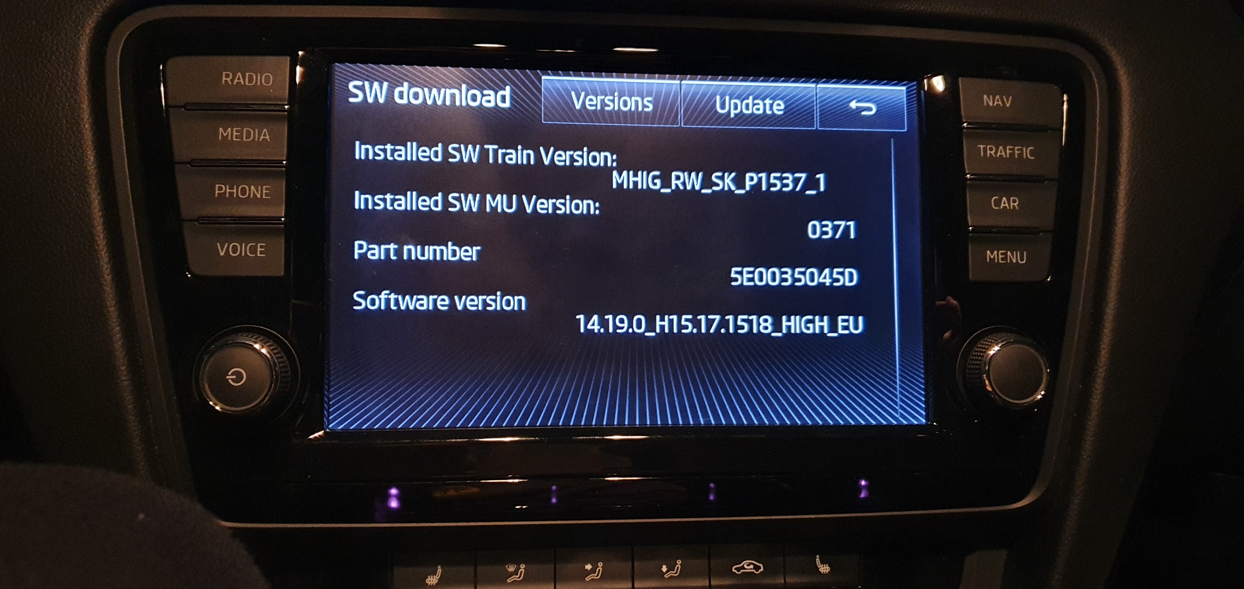

6 hours ago, Rednut said:
Hello from Australia!

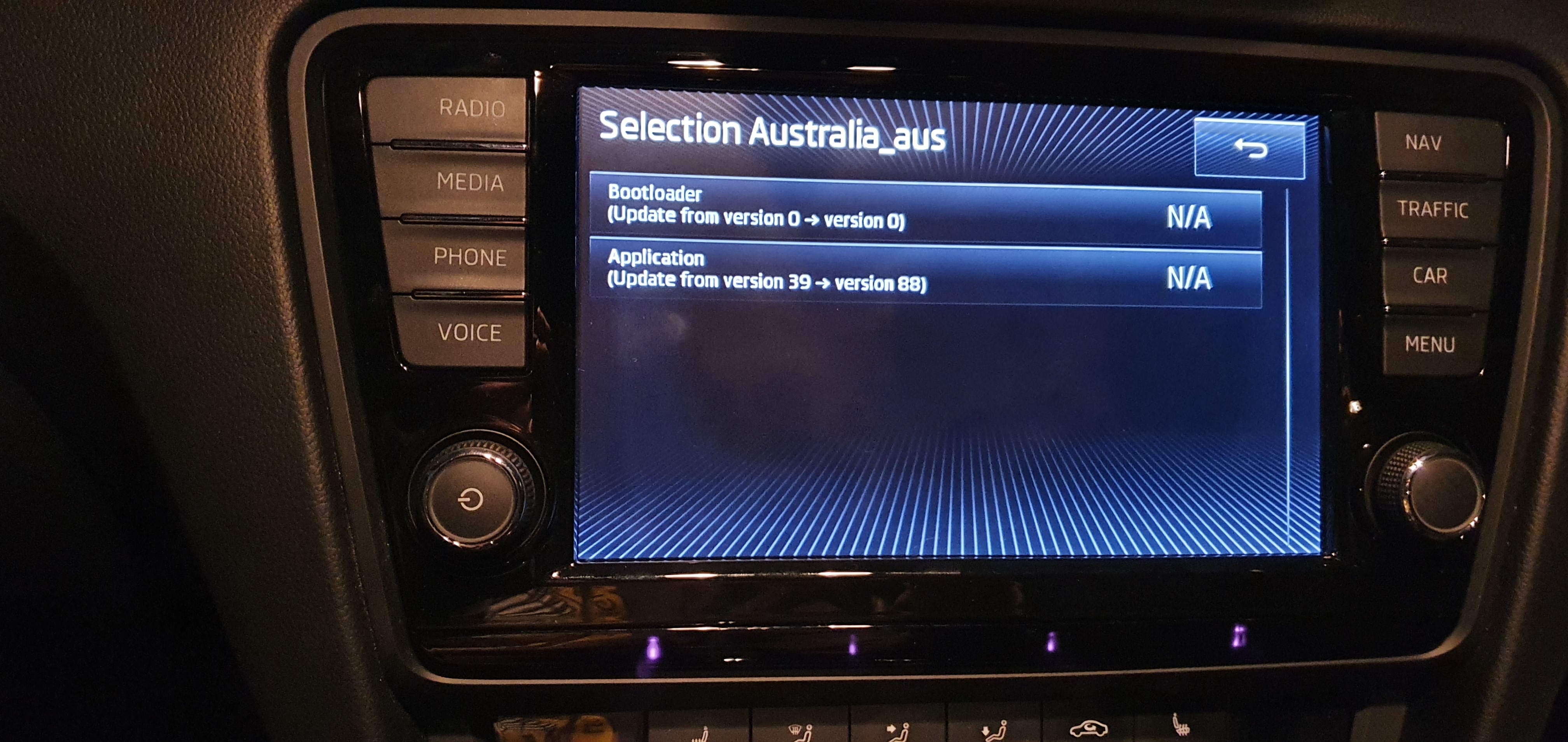

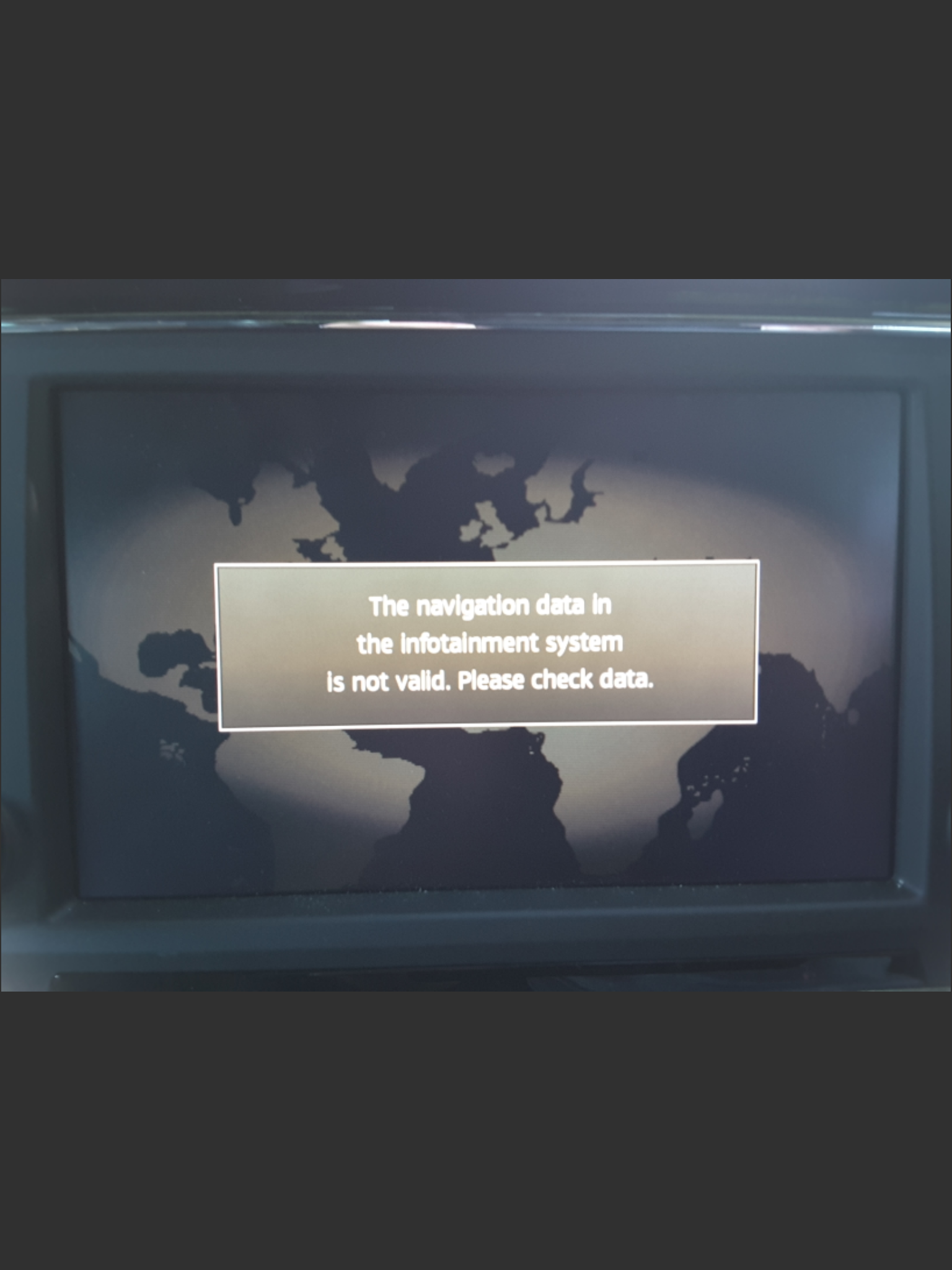

I've been on the hunt online for over a week now trying to work out how to update my maps. I just purchased a MY15.5 Skoda Octavia vRS from the original owner (who didnt even know what an sdcard was, so assuming this system hasnt been updated at all). I've tried multiple updates (high12_p88_row_202022 & high12_p90_mrm_202045) with multiple sdcards (64gb pro, 64gb, 32gb extreme) and a 64gb usb drive. all either formated to exFat (64gb options) and fat32 (32gb sd) (i also tried ntfs with the 64gb drive) - all extracted to the media directly from the zip files. ive been going in via NAV - setup - version Info - update, and i keep getting the error as below.
pics attached are of the Columbus system, map version and the error i keep getting.
Does the system info image show what version of Columbus i have? mib1?mib2?
Do i need to update the firmware before updating to these newer map updates?

That's due to the unit checking that the upload file is in tact and not tampered with against the sla1 signature. OS-X adds rubbish characters to the unpacked so then leads to the unit failing.

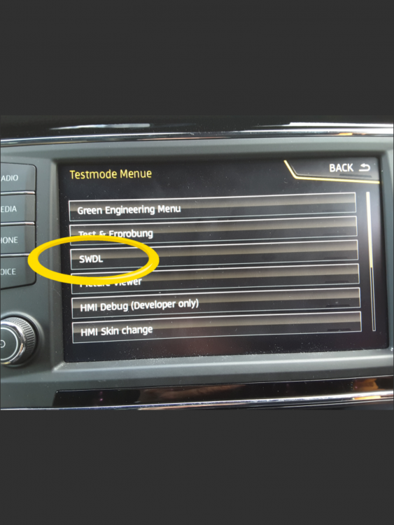

If not that... it is a mib1 unit. There is a Dave on this thread who used the developers menu and said they did it that way. On a mib1 that comes enabled already. Mib2 it's locked down and you use VCDS tools to enable it. Long press on the menu button if it's anything like mib2 brings it up, keep pressing till you see an SWDL option if anything like mib2. Indeed what it says on the Dave post where he links to it following the link. Otherwise called the back end menu, cuts the front end out.
Fkw00d a fellow Ozzie to you referred to that on here... You could chase them down on the threads or PM them in case they had a break thru.
I'd stick to fat32. The presentation is that the metainfo2 file, the two directories for mib1 and mib2 must both be on the route, not one down and no other files or directories should be present except those mentioned.

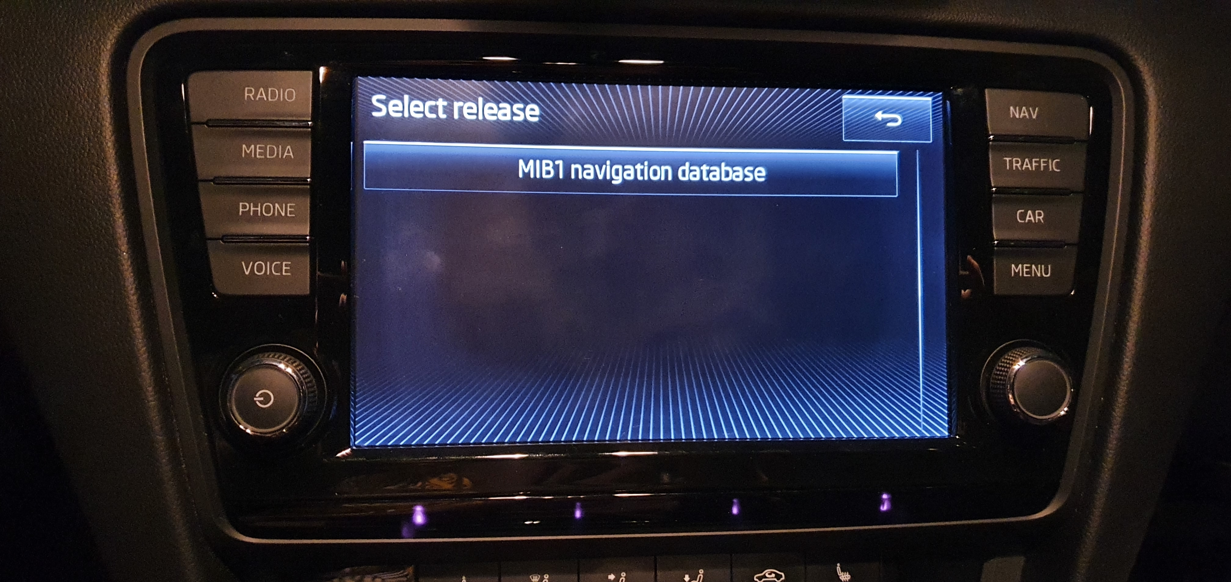

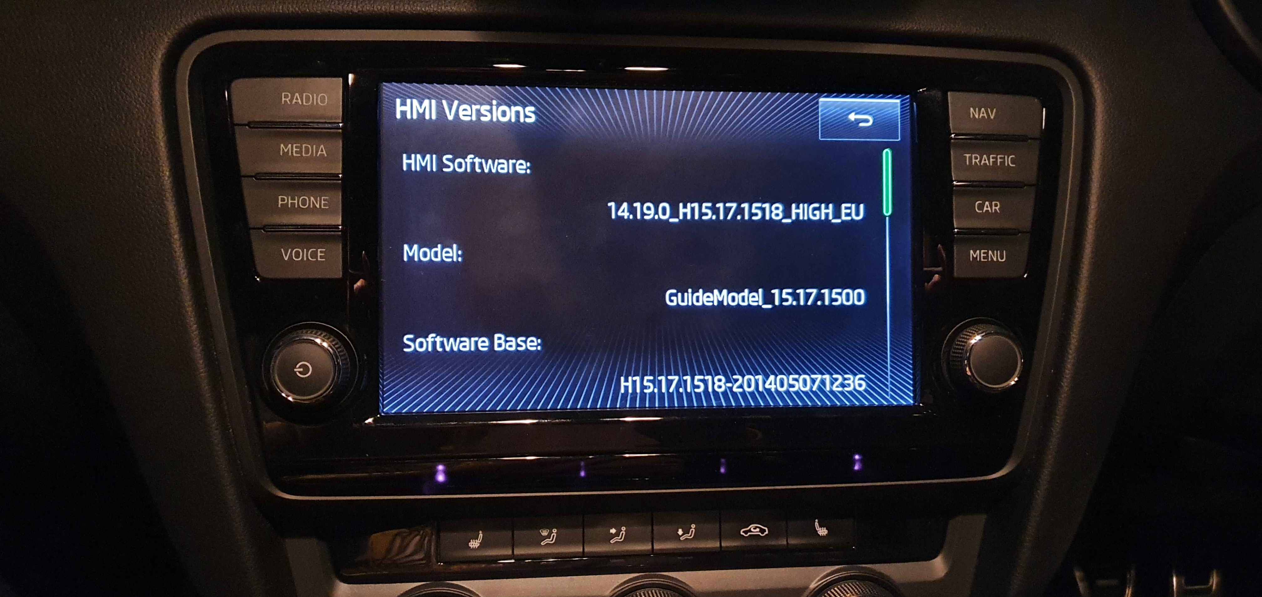

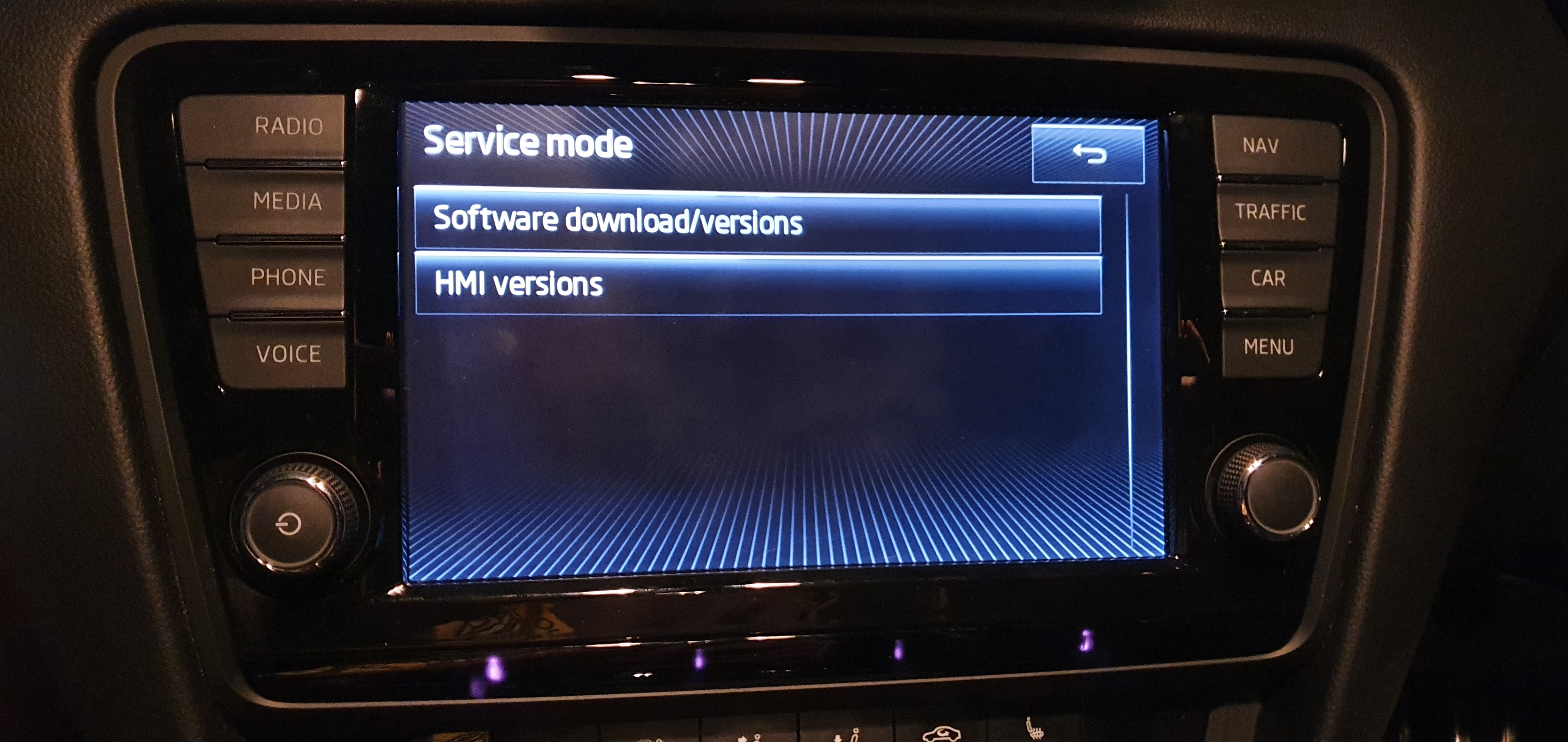

thanks for the replies all! I did msg fkw00d and got a response. I've also since tried service mode and founds some more options. It does look like our system is the MIB1. As below, I currently have the old p88 maps (2019/2020?) on the sd card and it appears to recognise them, but it wont let me update. would updating the firmware remove the 'you sh all not pass' thing? also, no Apple products here!

Hi, I took my eyes off this after Dec `19 until Rednut pinged me. Looks like you went down the same screens as I did. erWin build data for my car says it's a High Radio (Gen1) which is MIB1 I reckon.
I formatted both SD card & USB stick as exFAT & NTFS but don't think I did FAT32; will give that a try this/next weekend and report back
just called the local Skoda centre and they 'dont think its supported anymore' and that 'it probably cant be updated'. i refuse to believe that..

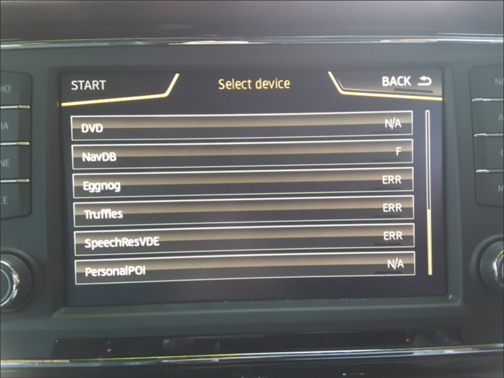

This is where you need a good retrofitter to adjust the navigation FeC in it I reckon if they exist in Australia now. So it's pre when they took Mapcare off Mib1. Adjusting the navigation FeC was something they use to do with VWs in Australia prior to Mapcare being dropped.

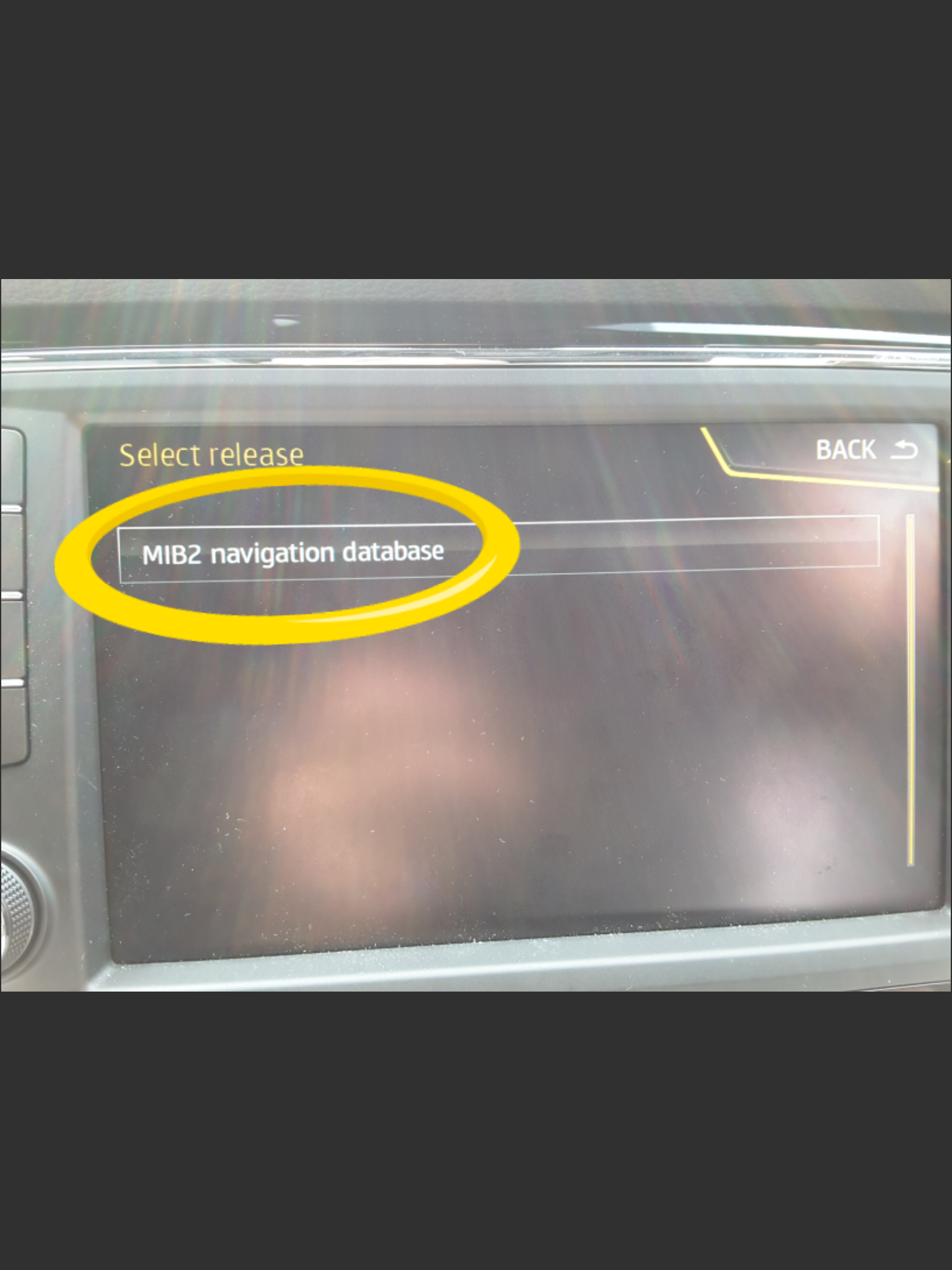

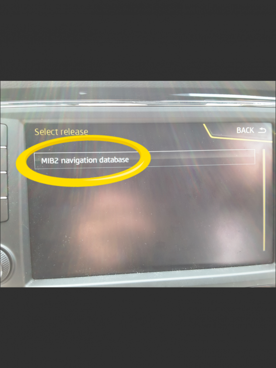

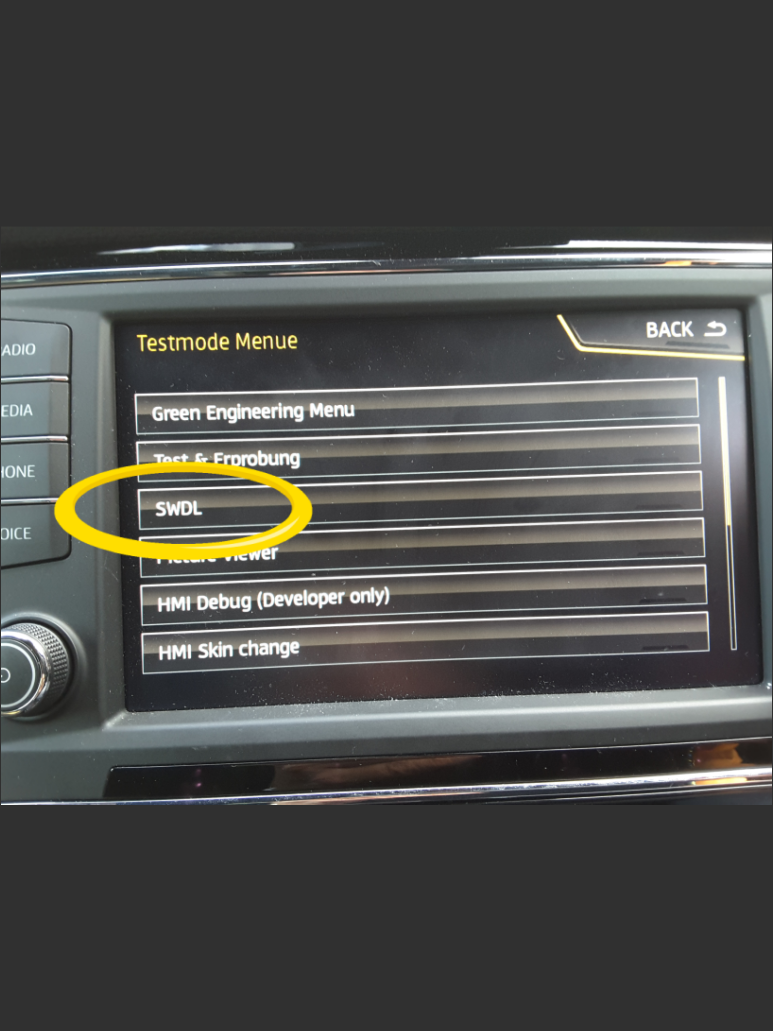

It is a Mib1 high from the build code and Google's. That bar that says "Mib1" means it's read it off the SD card / USB. The "N/A" means non applicable so the update on SD card doesn't tally with the function. You need to be careful that you don't force a navigation update where it's not supported, done that been there on my learning curve with mib2, people before me and people after. If you do that you need a version of the map that tallies with the unit or before... The file named on the screen to restore. I spent a month driving about without navigation till I did that.

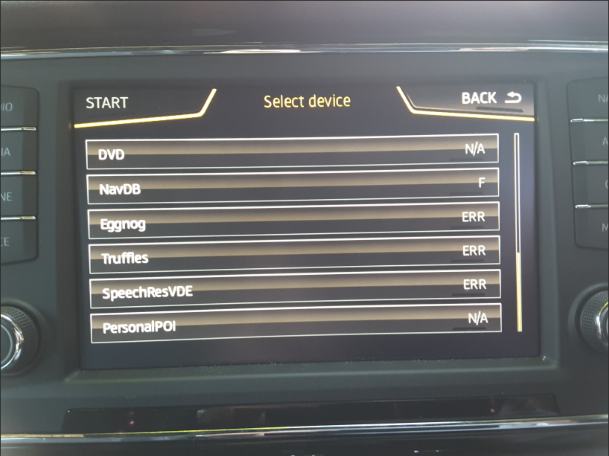

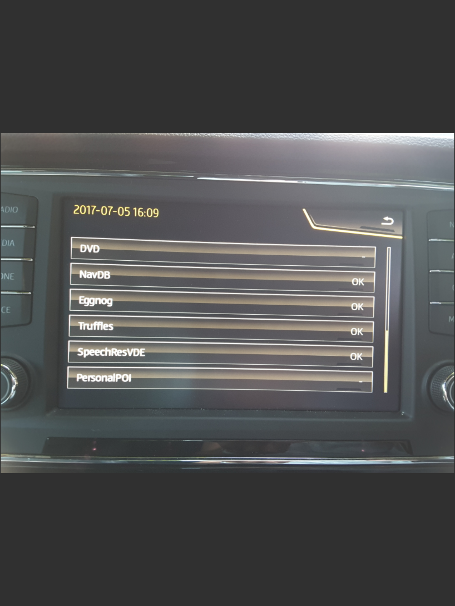

In mib2 high the key before starting off the update via the backend menu is to see a row of Y (for Yes) against NavDB, Eggnog, Truffles, SpeechResVDE via the backend using SWDL. It will be similar for sure in Mib1 high. The navigation FeC protects NavDB which is the cartography. SpeechResVDE is the speech, Eggnog and Truffles are I believe the built in POIs and Names you see on the map. Everything other than NavDB you can update but you kill the navigation if you update NavDB.
Attached are keys screens. If you see the third one with the F and Err means the navigation FeC isn't applicable, the update is beyond the period allowed by Mapcare. If you force an update then you get the forth screen with the OKs in it. Enter a destination, start off navigation and within 30 seconds you get the fifth screen. You then reinstall what the map the car came with (version Or earlier) and find a retrofitter to adjusted the navigation FeC least if it's a mib2. Will be the same for mib1.
DIY activity is beyond the average user to do a navigation FeC update and can wreck the unit. Least on a mib2 high. I saw Mr Fixit wiki had something assembled from web pages last night I guess. A good retrofitter takes a copy of the units settings, does the adjustment but has a backup to restore if it goes wrong. DIY fiddling you wouldn't have that and at £800 or so messing up an infotainment unit by attempting to reprogram the FeCs isn't recommended although some places offer DIY downloads. It took a day for a retrofitter to restore traffic sign recognition back to my car after the updated the FeCs, read road speed signs as kph not mph so told be I was speeding at half the speed it should. They kept saying job done, half a mile down the found it wasn't. Three attempts and three hours later they got it right. Traffic reports need to be enabled via VCDS. The rather poor retrofitter had a reputation for not reabling those. I was forwarned of that one. There is a much better retrofitter in the UK now than the one I used at the time with positive reports. That's where the problem exists is to find a decent one locally. There are people that offer to do it remotely if you buy the USB box and they go online taking over your computer remotely... Not a totally good one either without risk. Extract the unit and parcel it up or a personal visit is the best (latter). The UK ones use one of the three methods.

I think DIY FeC adjustments are a bit too dangerous... best to leave it to the experts, some are better than others. A London based one killed a Seat mib2 high but since it was under warranty the owner got it replaced. Was the same retrofitter that had aligned the FeC period to one year that generated repeat business. e.g. unscrupulous operator. The guy has gone back to Poland, home grown northern retrofitters that do a better job now. Due to Seat in the UK putting mib2 highs on Cupra brand up to 2020 and not supporting Mapcare in the UK, quite a market for their work.
