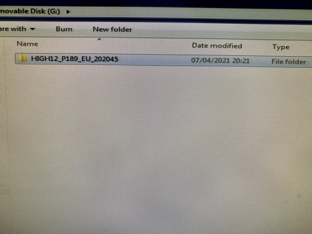

Well I received the 32gb card today, went through the same process & still no joy, it’s still coming up with the error message, so I’ll be ringing the dealership tomorrow to see what they can do
You didnt just copy or download the zip file to the SD card? Thats wrong. You download to your PC hard drive and then unzip to the SD card

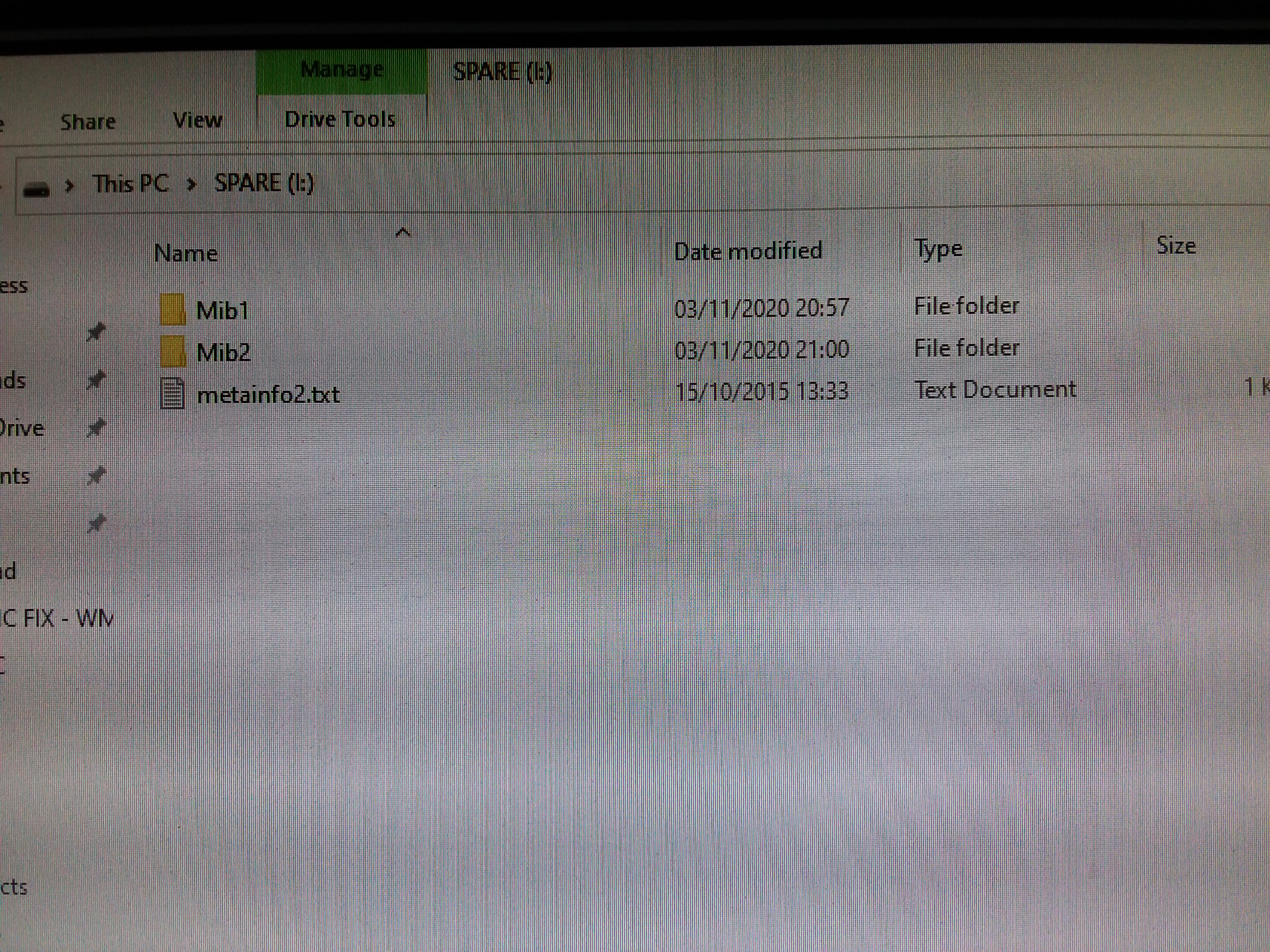

The root folder of your sd card should look like this...
Nope, all along I’ve either unzipped the file to either my pc hard drive & cut & pasted the unzipped file or unzipped directly to the sd card

This is what’s extracted & the mib 1/2 files & meta info txt are in this folder
That's goes unzipped via 7zip onto the card as per Xman's image above. Nothing else on the SD card except the mib1, mib2 and metafile in the route, not one level down.

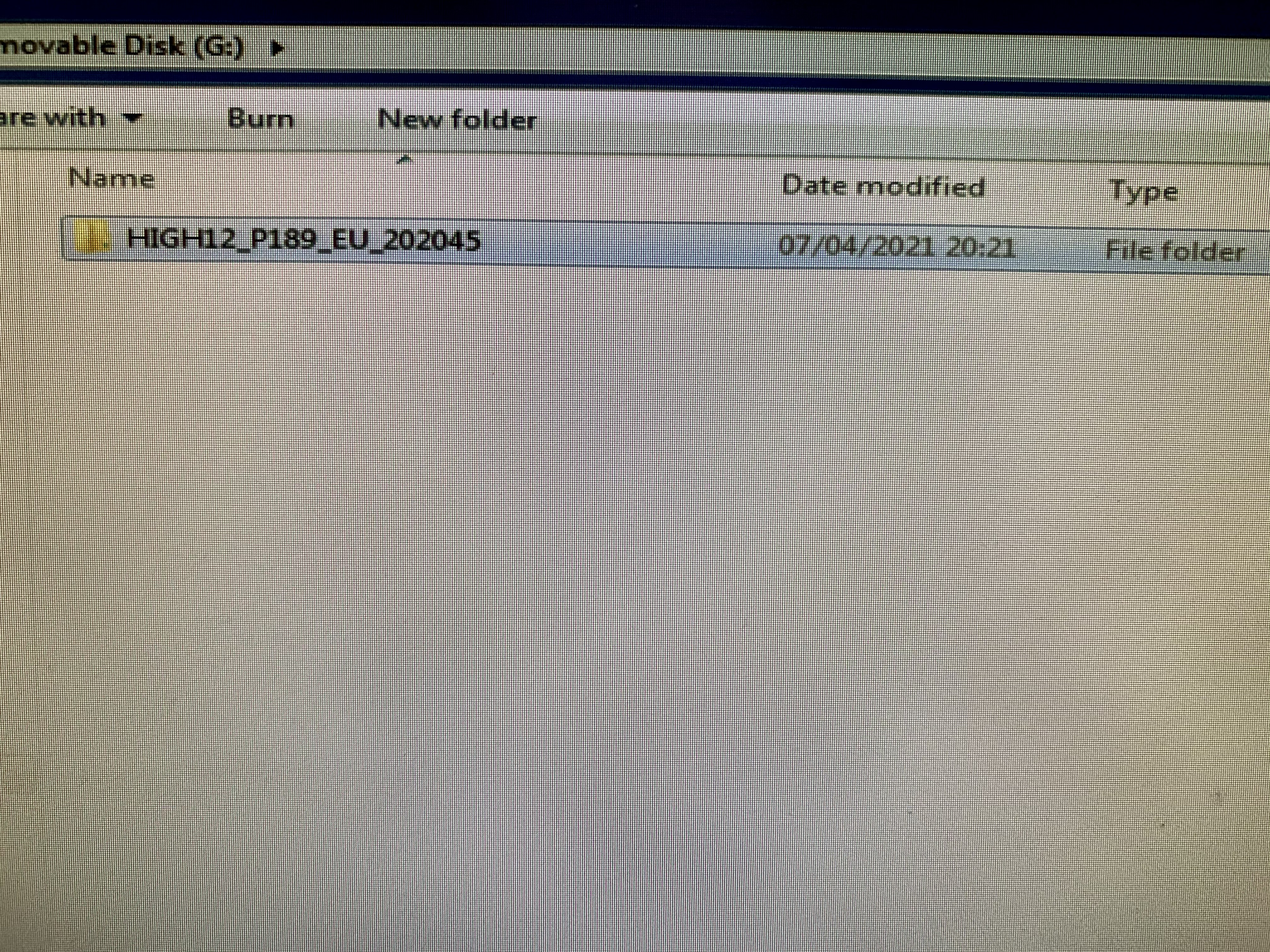

This may sound dumb, the folder shouldn’t be there ?
so do I cut & paste the mib files & metadata & Ditch this folder? If that’s the case it looks like this has been the problem all along
Edited by batemansxxxb
On your SD card on your computer it should look like this after unzipping in 7zip. "I"is my SD drive, yours may be something else.
Right I think I get it now, the unzipped file includes the extra folder, which has to be ditched, so it looks like that was the reason the car couldn’t read the files,I’ll go back & paste the mob etc to my pc & re format the card to get rid of the folder, then paste the mob files & meta data back to the card

You drag and drop those three items out of 7zip onto your HD then drag and drop them onto a clean blank SD card from the HD. That's faster than dropping them directly from 7zip onto the SD card.
It's open archive on the right clip of the mouse on 7zip to see what's in it. Then drag the three items to your HD, then from the HD drag them to a nice clean 32gb, SD card with the spec:).... hopefully that's it.
No need to paste back to your pc. Just edit the sd card
With the sd card on your pc,  open the high12.....folder on the sd card containing mib1, mib2 sub folders and metainfo2.txt, cut and paste the 3 items  back to the root directory of the sd card, you can then delete the (now empty) high12_p189.... folder.
Much faster as all that needs to be done is a directory reshuffle taking a few seconds.

Too late I’m afraid, I did think of that, but wasn’t sure if it would work, so the files are currently being transferred to the pc, then I’ll re format the card & paste the 3 files back to the card....the scenic route I know 😏
Thanks  for all your help guys 😁
It  wasn’t clear in the first post  that you had only to put the 3 files on the card,.

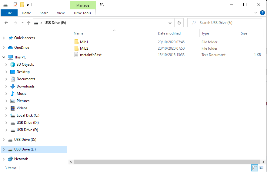

One file and two folders to be exact :). The picture shows it plus Xman's :cool:.
He uses E drive for his SD card mines on I:).

Success!!!😄.  Updated this afternoon, using the 64gb sdxc  as soon as I put the card into the reader it came up update available & took about 40 mins

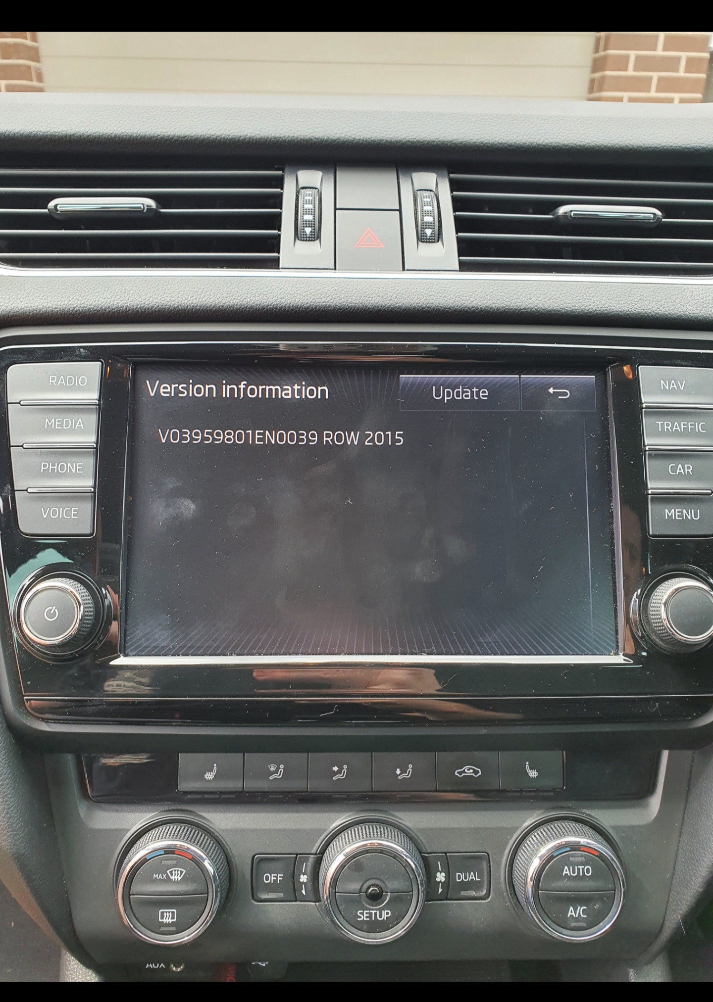

Hello from Australia!

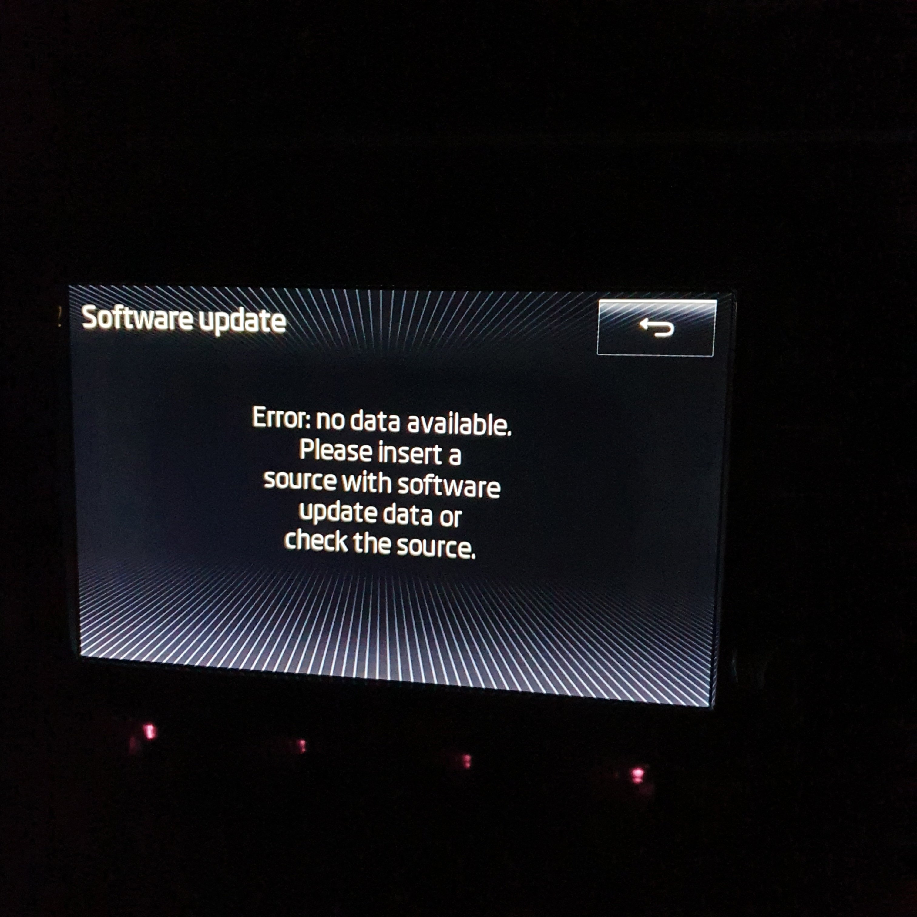

I've been on the hunt online for over a week now trying to work out how to update my maps. I just purchased a MY15.5 Skoda Octavia vRS from the original owner (who didnt even know what an sdcard was, so assuming this system hasnt been updated at all). I've tried multiple updates (high12_p88_row_202022 & high12_p90_mrm_202045) with multiple sdcards (64gb pro, 64gb, 32gb extreme) and a 64gb usb drive. all either formated to exFat (64gb options) and fat32 (32gb sd) (i also tried ntfs with the 64gb drive) - all extracted to the media directly from the zip files. ive been going in via NAV - setup - version Info - update, and i keep getting the error as below.

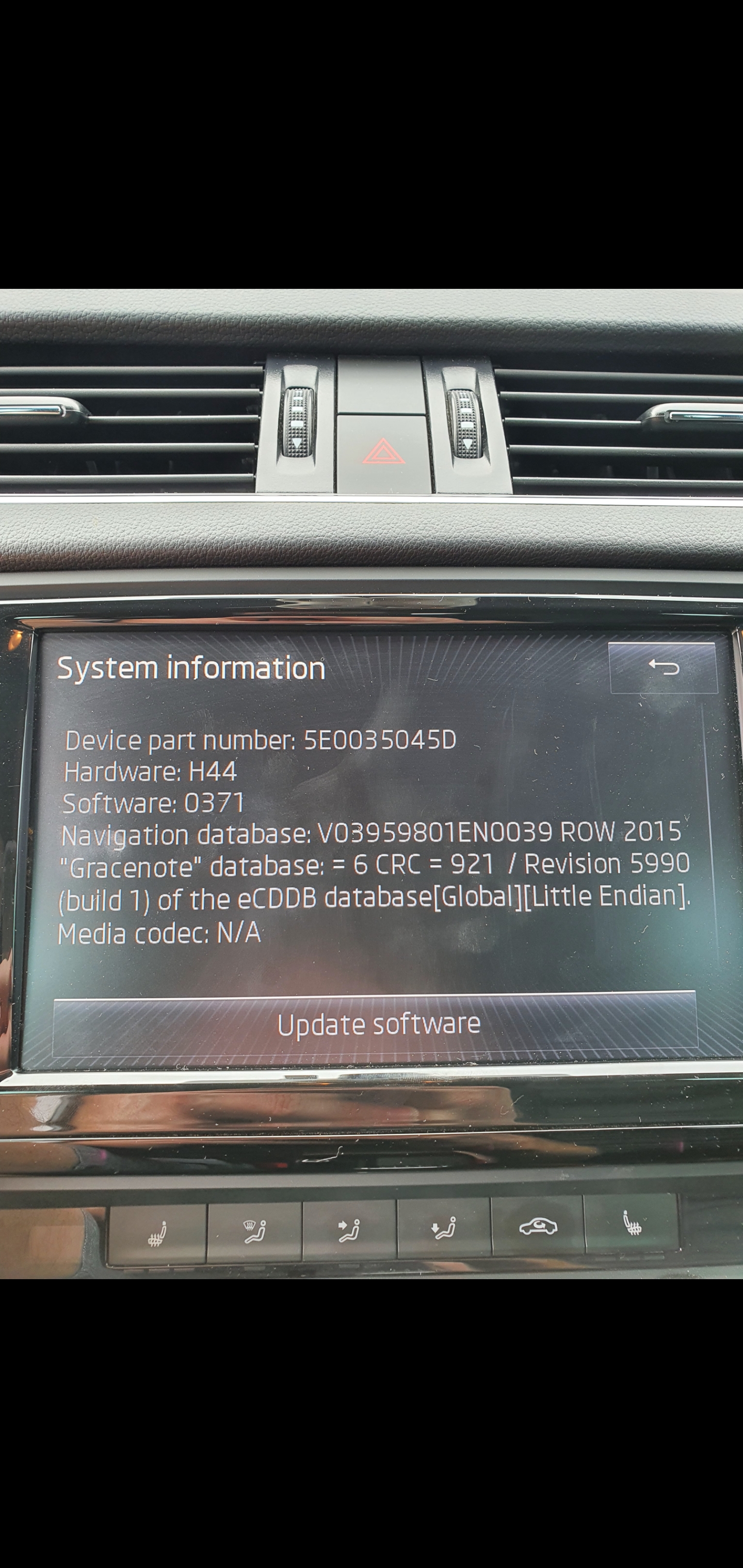

pics attached are of the Columbus system, map version and the error i keep getting.
Does the system info image show what version of Columbus i have? mib1?mib2?
Do i need to update the firmware before updating to these newer map updates?

@Rednut
looks like Mib2 High, but i can be wrong.
another guess, not all regions have got enabled life time updates,
like Audi and Seat owners can upload updates just first few years
