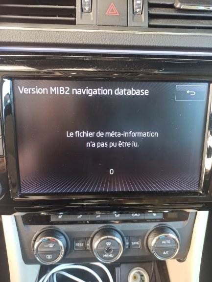

Hello,
I am trying to update with 2021 map my Columbus of MY17 Skoda Superb L&C.
It was updated with success not from my side for the previous uptdate 2018,2019,2020 (done perhaps by Skoda dealer)
I tried every thing several SD card, Skoda files, VW files, update via Menu folder, via NAV, via developers menu, I can't succeed.
When I tried to update via developers menu, it says "metainfo can't be read".
Since the last working update is there a new general FW which would block this new update ?
Have you got any trick to overcome this issue ?
Thanks
@guix74 this is going to be something simple.
The Columbus updates its maps in a different way to the Amunsden.
The error message "cannot find Metadata" says that the you are presenting the .7z file directly to the MIB2 system, instead of the appropriate folders MIB and MIB2 - which should be the root level of the SD Card.

Not using a Mac are you ?.
An integrity check is made on the files for transmission errors and any fiddling within the files. The Mac operating system adds additional rubbish to the files which is why you are suppose to use CleanMydrive and the recommended MAC OS unzipping program, ditto a PC 7zip for unzipping. Other PC unzipping programs can lead to problems.
In the route of media you have the metainfo2.txt file, mib1 and mib2 directories. Attached is the VW guidance. See Mac OS guidance if using a Mac.
If still no success you could always download the files again to the HD. Unzip to the HD with 7 zip if a PC. Then drag and drop to your SD card which is blank. People sometimes manage to get them not in the route. Need to be in the route.
Since its telling you there is a problem with the metainfo2.txt file it means the files are corrupted or not as expected (The Mac question and correct unzipping).

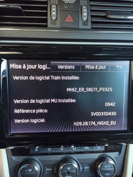

But that is a Columbus since he's showing 0177 an old Mib2 high release. The Metadata file error means it's failed validation. That's why it can't be read in the normal way since its not being seen as a valid update.
Ok how can I manage to overcome this issue ?
You need to get the latest firmware from your Skoda dealer.  They can either do it, or you can see if there is a new version of firmware available to download at https://updateportal.skoda-auto.com/

Potentially - the euro-market is different, so as far as I was aware - unless you had a REALLY old MIB unit, all maps were upgradable.  My logic is that there is a bug in the firmware which is stopping the units from accepting updated maps.
My Columbus was updated 4 times from new in 2017 by the previous owner
Skoda dealer might have been using ODIS rather than popping map cards in it. Frigging some setting in the unit which also closed it off to you.
I'd agree a firmware update might be the solution.

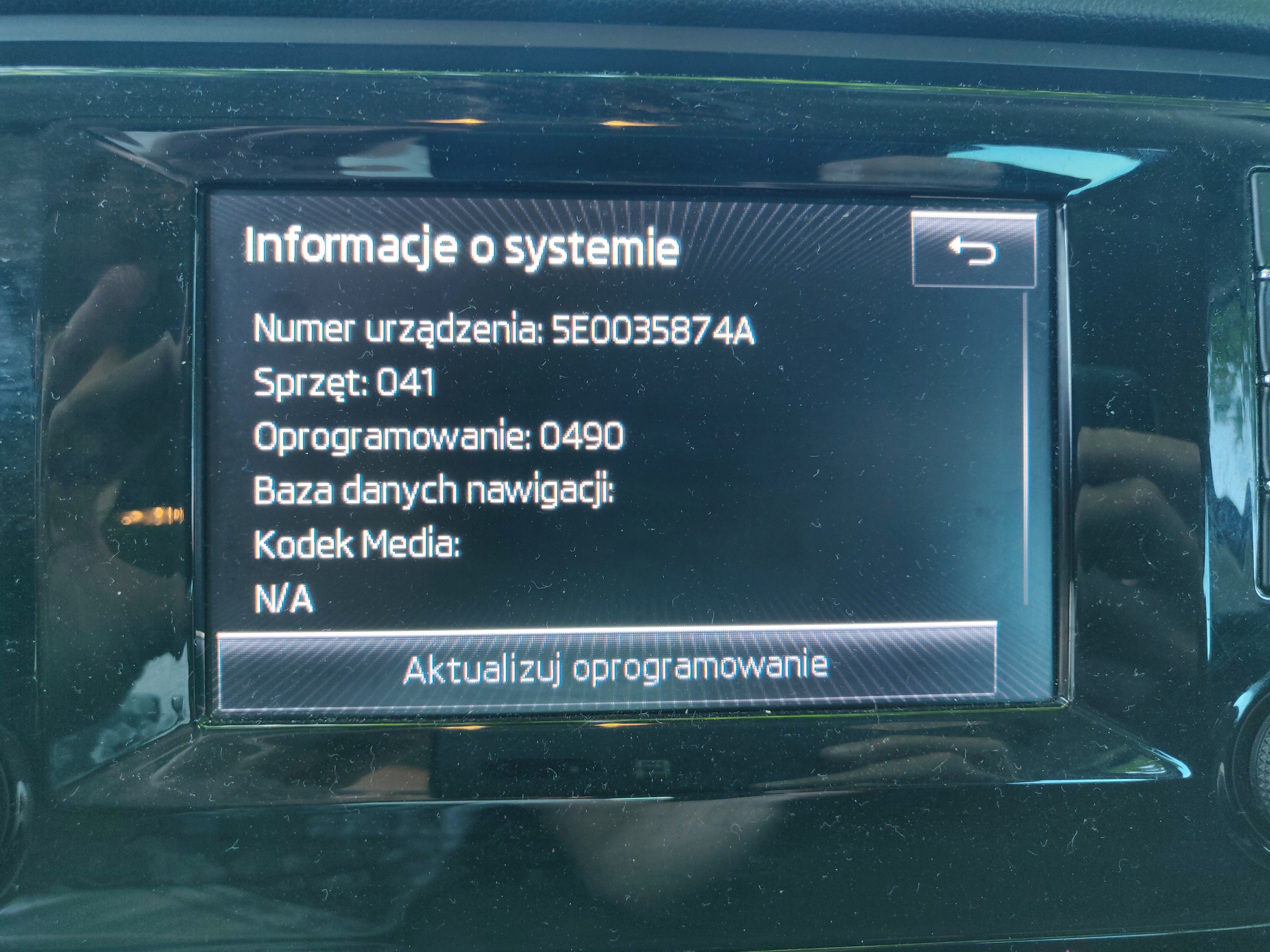

Hello,
I've downloaded ECE map for Skoda. I have O3 2014. I've extracted the file onto my hard disk (NTFS) and then copied it on Samsung Class 10 U3 64 GB SD card formatted in exFAT 128 kB. Car doesn't see any data at all, though it see the SD card.
Through unzipping process I have 50 errors. Is it normal? What can I do differently?

42 minutes ago, ChrisO3 said:
This is my car info:
5E0035874A seems to be an MIB1 Amundsen.
This thread is for the Columbus so you might want to try the maps here:
You'll also need to use an appropriate Skoda/VW SD card :)
