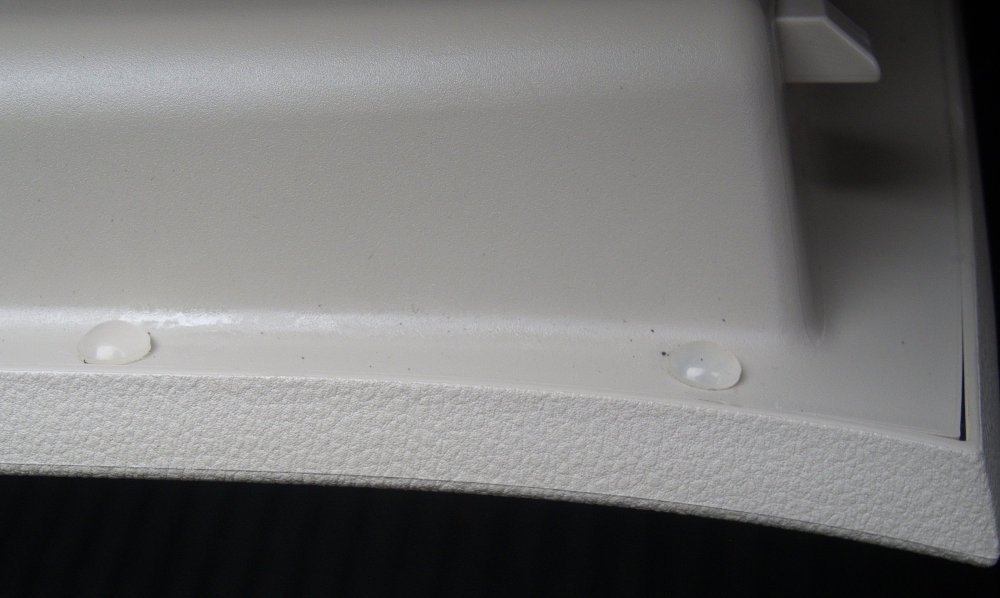

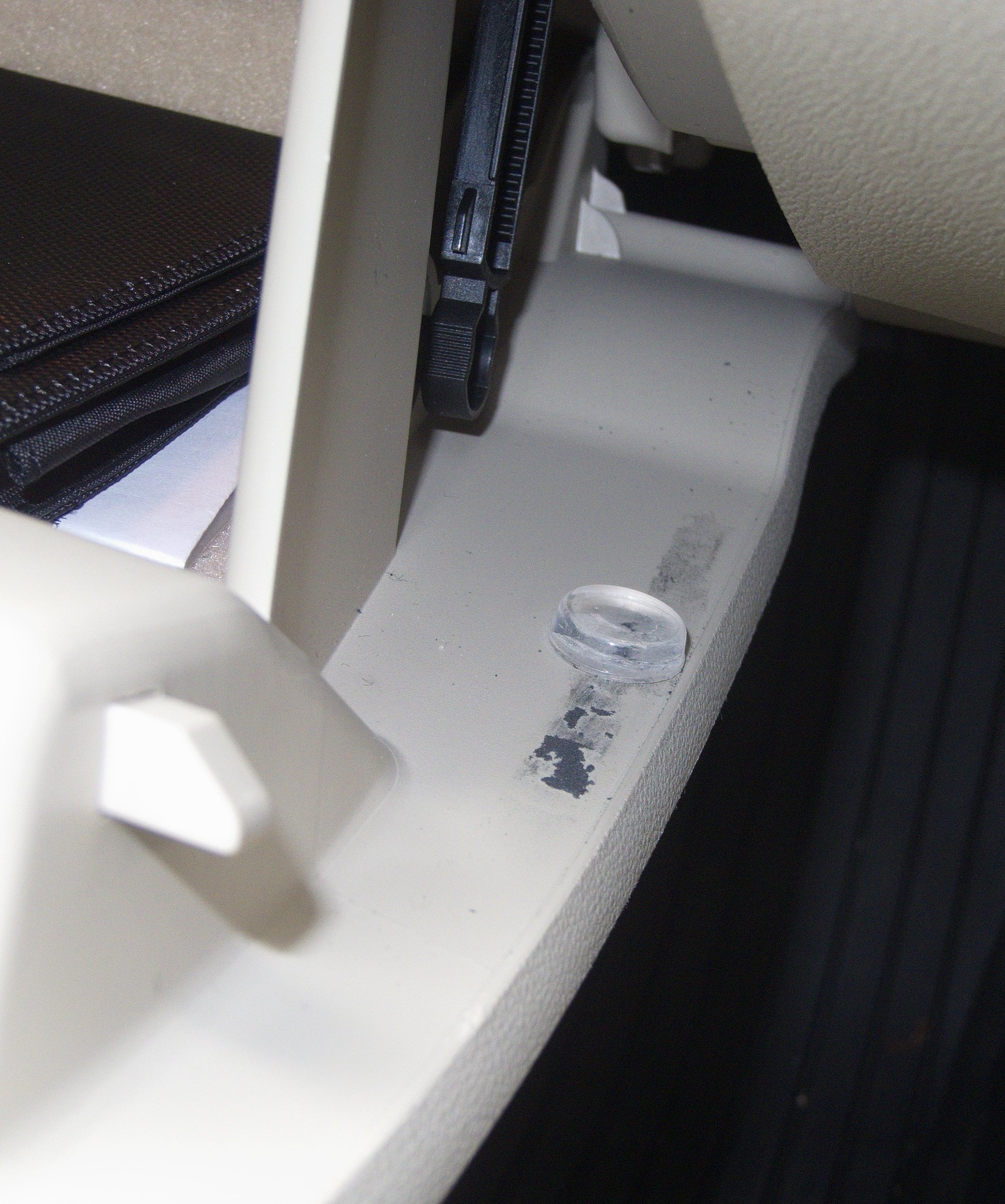

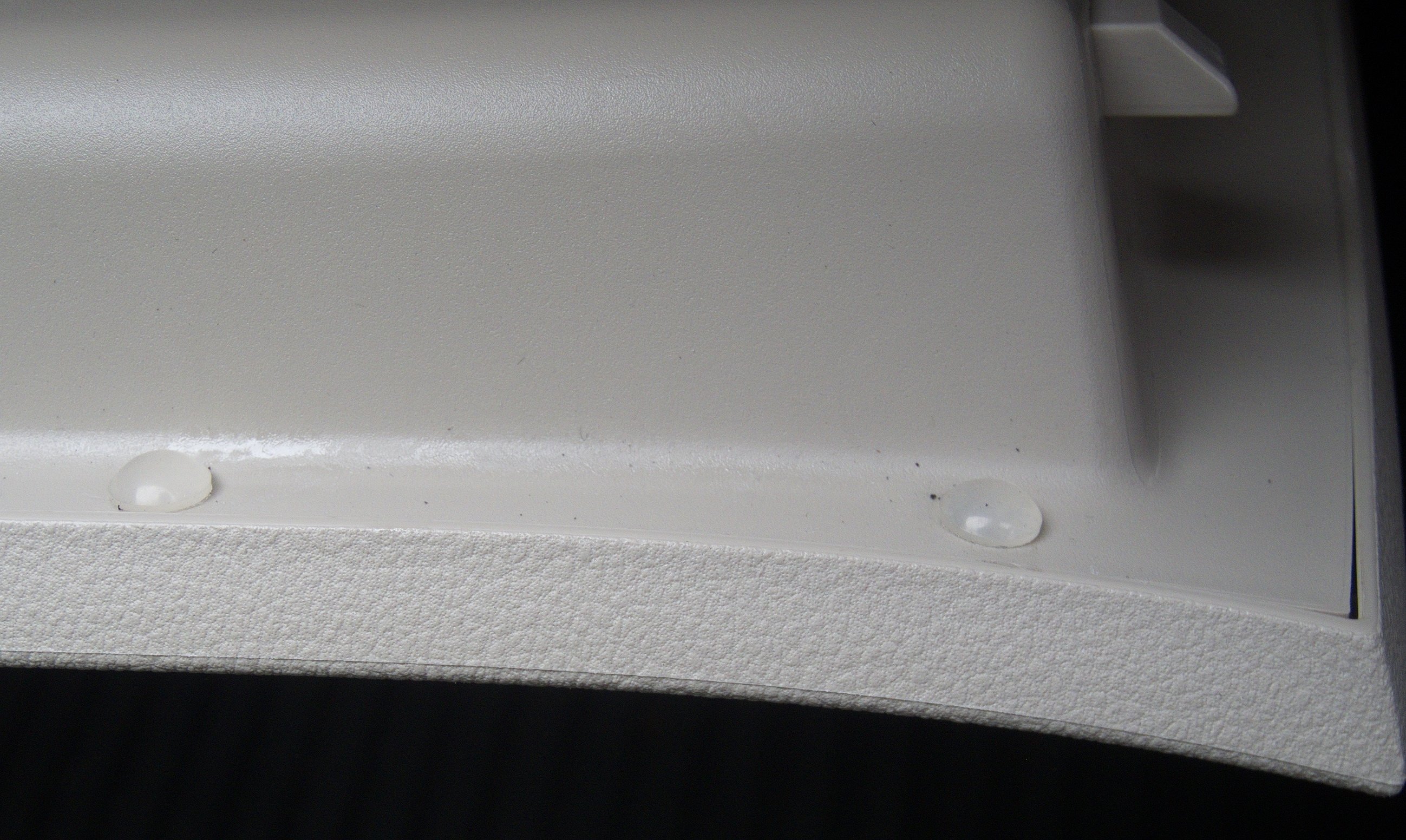

Thank you, I also have a rattling glove box and glad to hear it's not just me!
Same, has anyone found where its coming from? Or how to fix it!
Solved with a little bit of sticky backed foam. The weedy plunger springs in the dash are meant to hold the lid down on its catches - but it's all plastic on plastic with no damping or softness, and scope to move L/R  / up/down a little. Hence the noise.
Fantastic, please can you share a photo of what you did? Thank you!
Dealer told me they think it’s a design flaw with the glove box.  Some hole somewhere that allows it to move too much and the plastic on plastic rattles.  They tried packing the hole with something but say they can’t do any more so fobbed me off to Skoda.  They reckon I need to go to another dealer for a 2nd opinion.
Here you go. I had forgotten the foam tape glue got a bit tired last summer so I had replaced the foam tape with some silicone / rubber dots. 5 small ones along the top edge and one bigger one down each side. Kwality.com.
🤣 I love a good bodge! I'll be following your example and doing the same to mine this weekend.
Thanks very much.

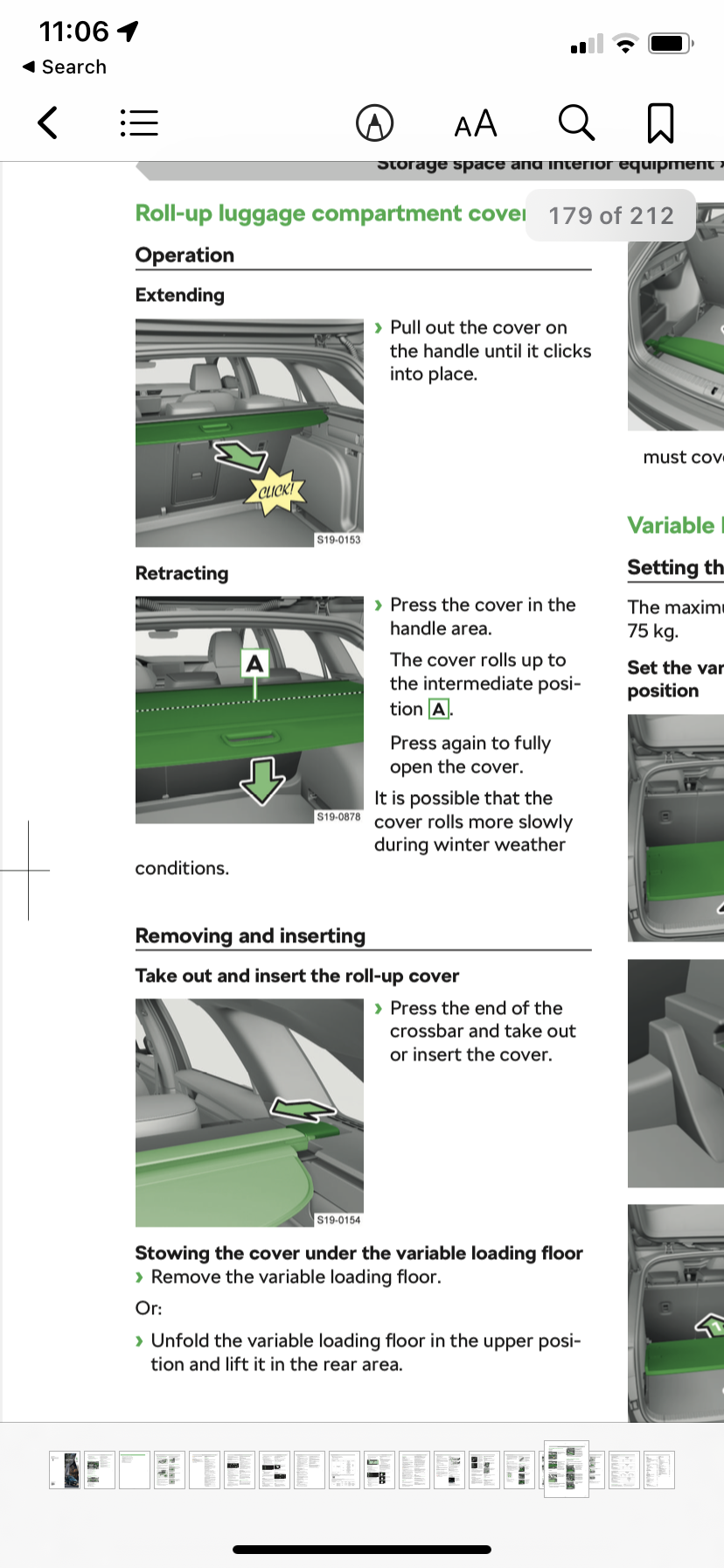

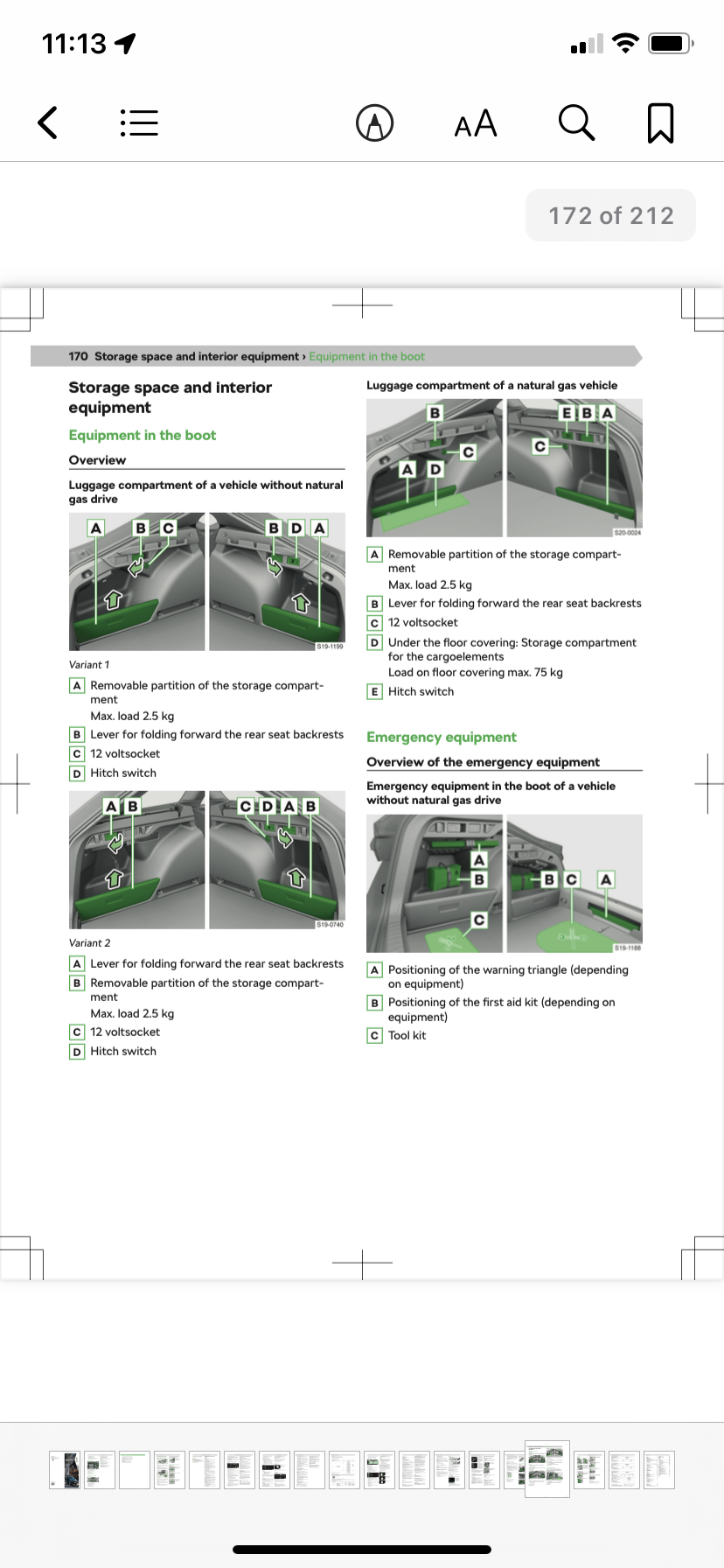

Agreed, but always worth a skim read of the ‘living space’ (cockpit & luggage compartment) pages though. Then dig into the details of other stuff (e.g. infotainment system) as needed.
The brochure also makes reference to USB-C ports in the cockpit and 12v socket in the boot.
After having the car about two days trying to put a lot of bulky items in the boot on a cold winters day, the last thing you’d expect is to be unable to remove the luggage cover because someone secretly redesigned it to be two pushes rather than one! I had the manual out too, couldn’t find it in time. As I said not intuitive, if they want to change things like that, the best way is to tell people when they collect their new car. I thought the cover was faulty and didn’t want to break it…
