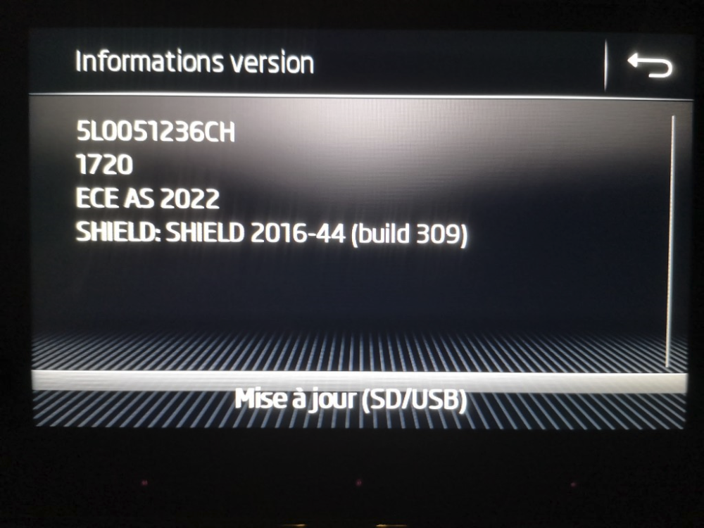

Hello again guys,
Now that I've a decent SD Card reader, I noticed the card from my Skoda is a 16GB model. Whatever !
I did download the entire Europe map from Skoda (STD2_1720_EU_A1_202145.zip) and removed all unecessary languages, keeping only the French one.
Then the Skoda notice says :
I didn't find these paths on my navigation system, but when I have a look to the software versions, I can see that it matches the file I previously downloaded.
So I assume the upgrade completed successfully. What do you think ?
Many thanks !
On a Seat it just does it after the language edit doesn't give you any commenter. It is a short term solution since at some point it is likely to out grow what you are deleting so a 32gb card or a zone may be used.
To test it you can put the unit in demo mode under advanced setting... That's how I test these type of edit.... saves wasting fuel.
Yes it is very close with a 16GB card. Deletion of 44 unused languages saves me 750MB, but large enough to copy all files. I think we can buy MIB2 compatible 32GB sdcard for a reasonnable price.
14 minutes ago, Tell said:
To test it you can put the unit in demo mode under advanced setting... That how I test these type of edit.... saves wasting fuel.
Will have a look and let you know ! Thx
