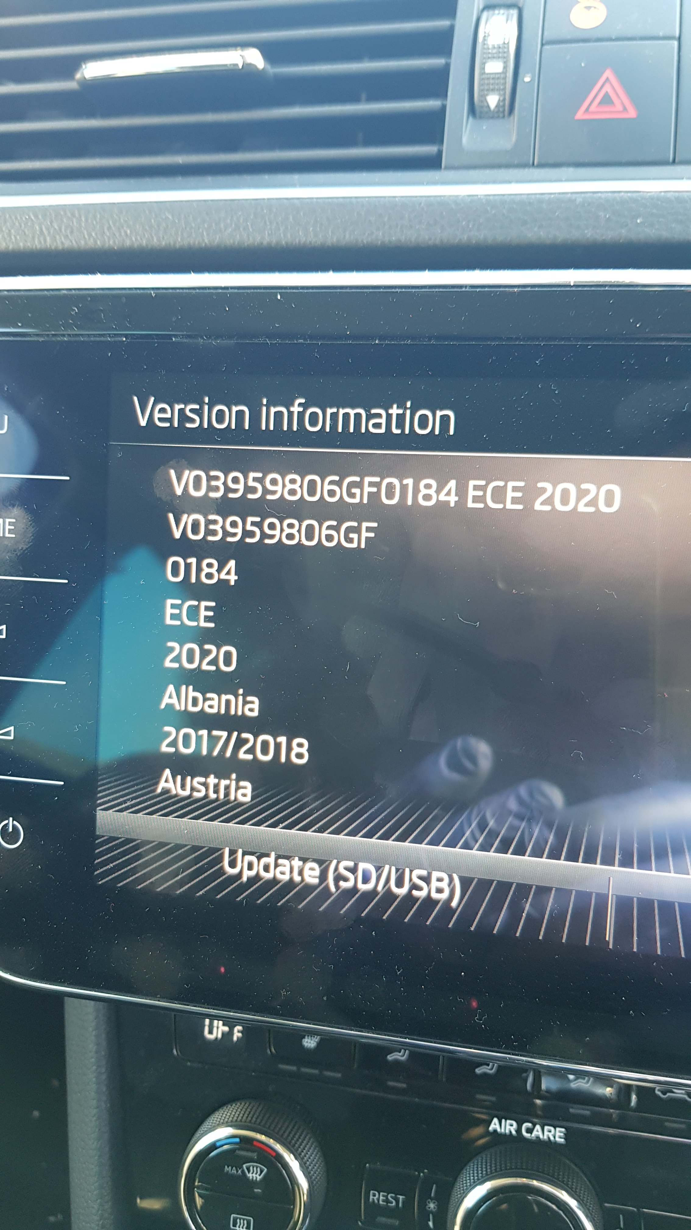

I'm trying to update to the latest maps but it can never find any info on the sd card. I've tried different cards, formatted them in different ways., used updates from the skoda website using the vin  used updates from links on here. Nothing works.
Not sure what the problemem is. Do I need a newish version on the nav before I can get the latest? My current ones are below.

Was it in Fat32 on a 32gb SD card and not using a mac. Following the Vag guidance I attached further up. Stick to the VW download, unzip using 7zip, you shouldnt have problems.

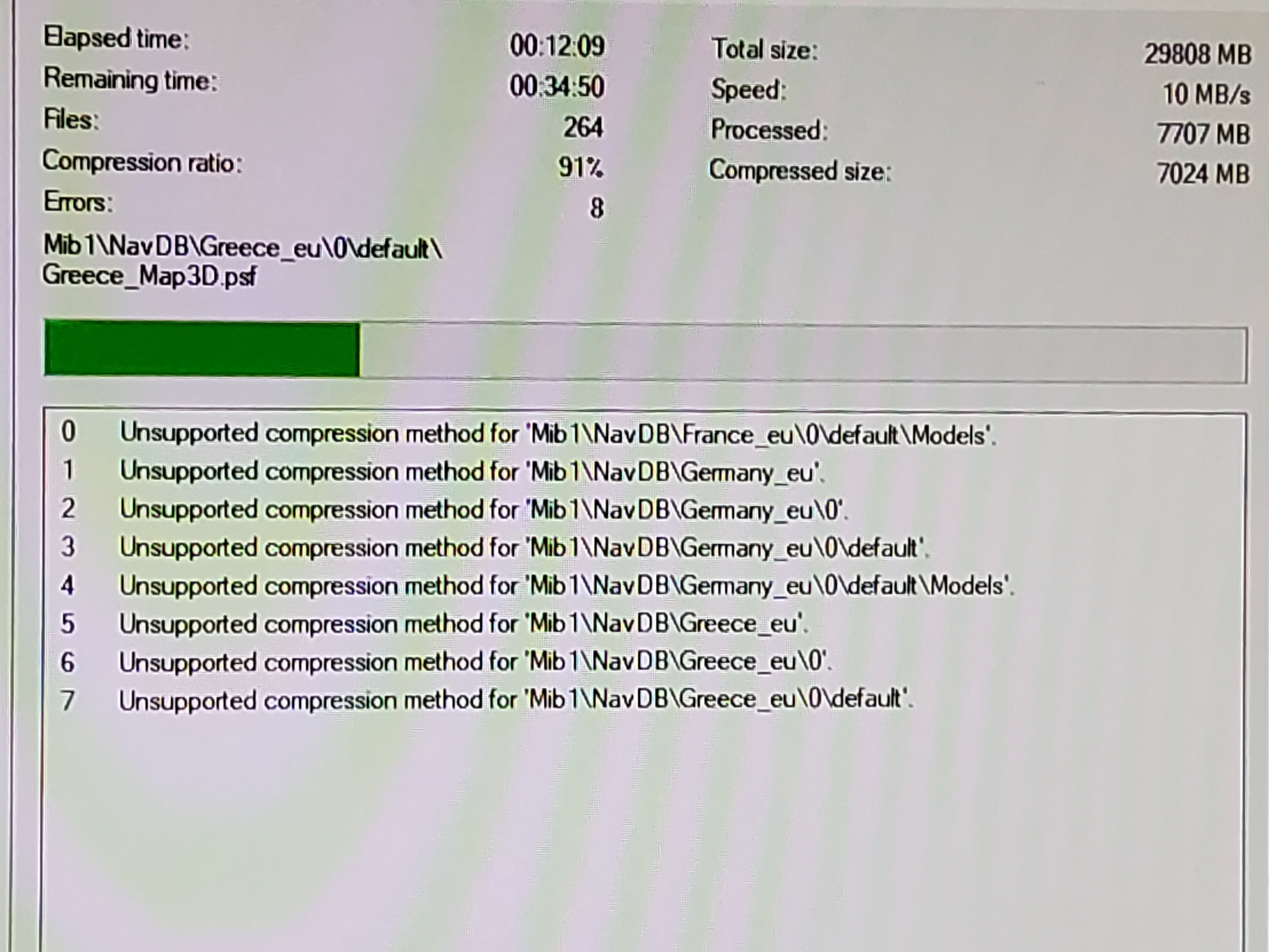

7zip just has errors which don't occur with other zip software.
Read down from this post.
Known issue with 7zip on the Skoda site. You can use the built in unzipped in Windows Filemanager or use the VW download with 7zip. Skoda changed their compression software so it throws up errors on 7zip since they use variable levels of compression. The built in Windows tool is more accepting. MartiniB uses another tool as he says.
It then comes up latter in the thread with naysayers checked it again and posted up the analysis. Probably best to still to the VW download that MartiniB posted at the top of the thread with 7zip or use the Filemanager build in one.

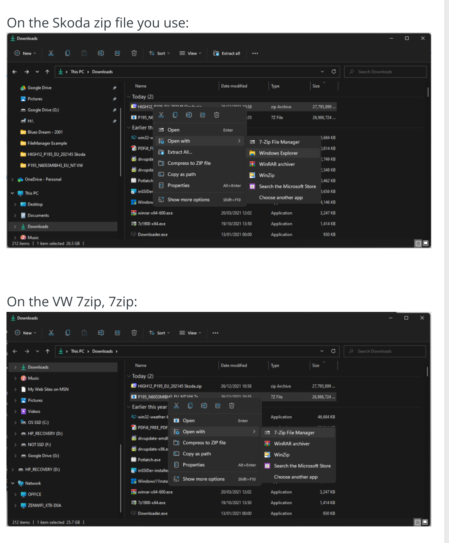

Two images. If you use the Skoda file, open as that example that uses the built in Windows unzipped, right click. Second image if VW file, open with 7zip.
Zip files, sit on it. Right click, Click Windows Explorer... that's the built in one which comes free with Windows, it does the job. Drag and drop to a directory you created for it. Then copy all of that onto a blank SD card, fat32, 32gb. No issues.
Posted that up before when people got confused. Basically Skoda are zipping the files in a way that 7zip throws up errors but we knew that at the start of the thread. So we don't use 7zip on them but use the Windows built in method. No issues or in MartiniB's case his favourite unzipping software 😉.

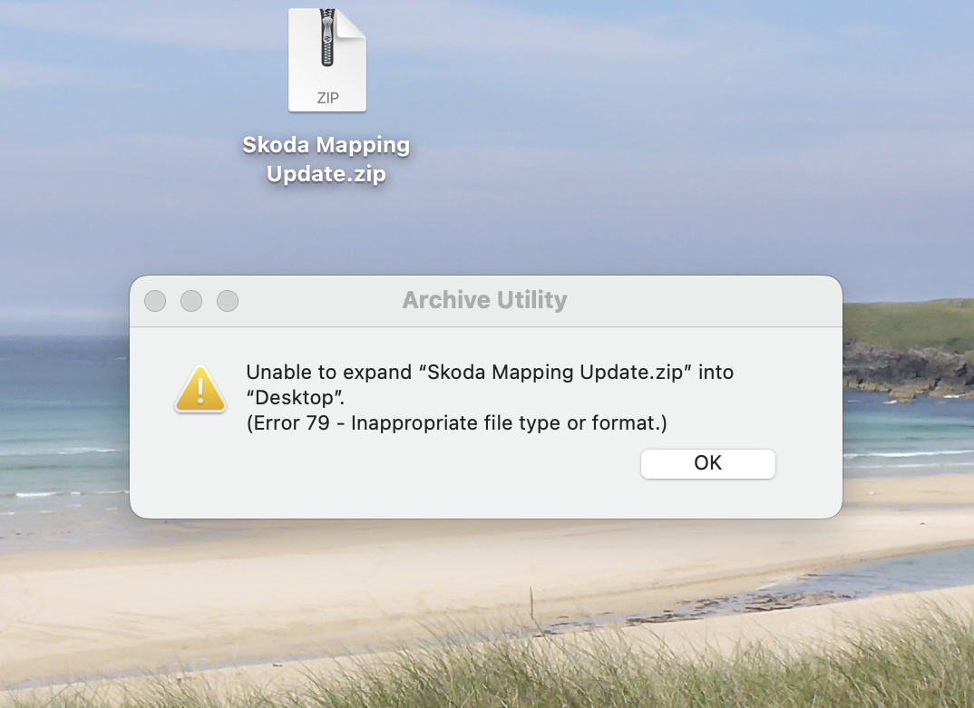

I tried a download onto my Macbook - all went well with the zip. Won't open to release files - Error Code 79 Inappropriate File or Format. Advice please because I've been blocked by Skoda on Twitter having posted a complaint earlier in the year.

Suggest you use MartiniB's VW link in the first post of the thread. All the same files, just zipped differently. Skoda had a weird compression on this year's release which causes unzipping programs to stumble. Since you are using Mac the VW recommendation is:
If the map update is performed using the Apple® OS X operating system you may find that
Discover Pro does not recognise the map material or displays it incorrectly. This is due to a
lack of compatibility between the “7 zip” program and the OS-X operating system. In addition,
the OS-X operating system has a tendency to create hidden additional files on external data
media. We therefore recommend that OS X users use the “Keka” unzipping program. We also
recommend using the “CleanMyDrive” program to remove any hidden files.
You use Keka as the unzip program and you must use CleanMyDrive app run on the SD card. The unit does a full signature check on the map material import. MacOS can add additional characters into the file which then leads to the validation failing. CleanMyDrive hoovers out all of the Mac bloat characters stuff put in the file by the Mac system. Just one character variation will knock the import out. In your case its stumbling on the unzip, but you still need the CleanMyDrive in.

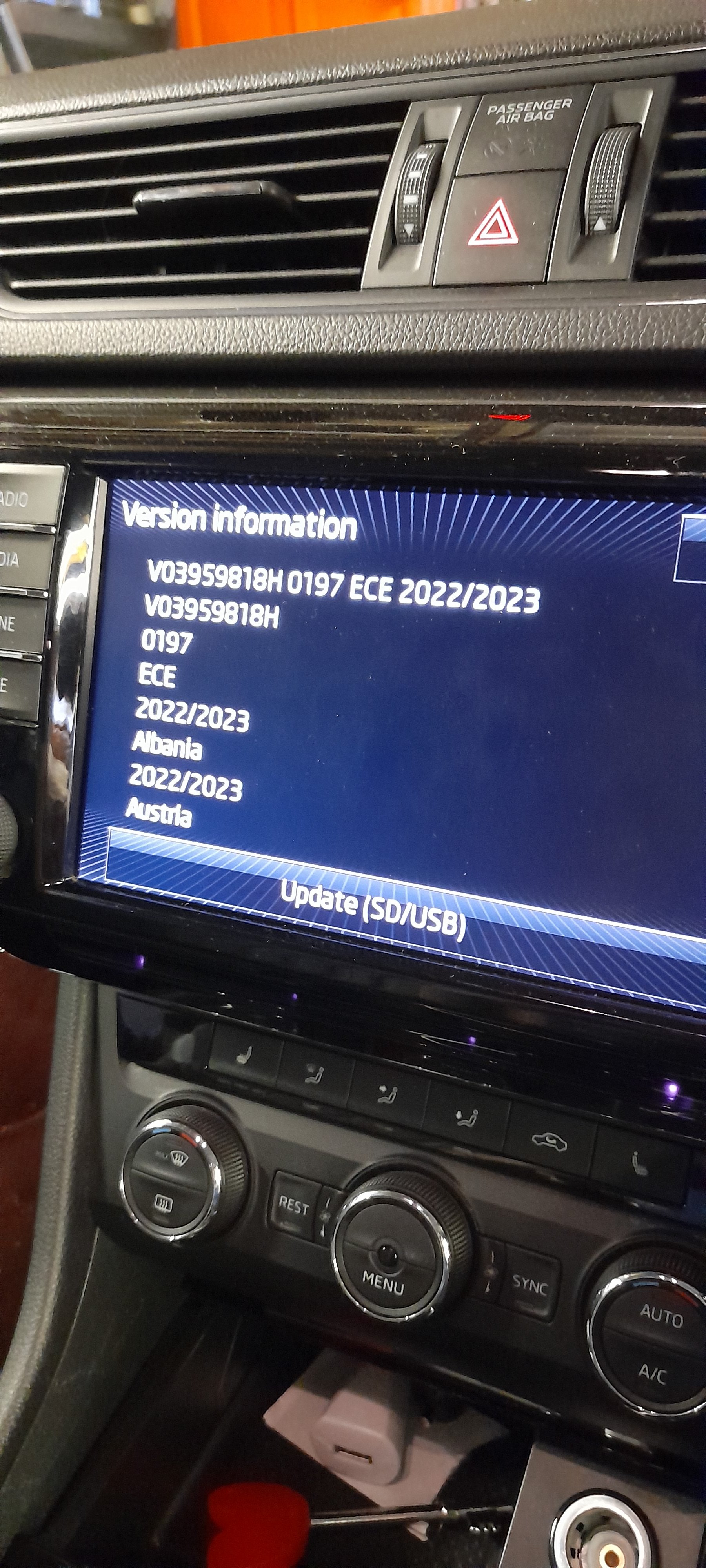

I thought this may be of interest, I have just installed update 0197 ECE 2022/23
just downloaded from skoda portal using my vin
unzipped straight to a 64 gig sd card and installed on my columbus in around an hour.
