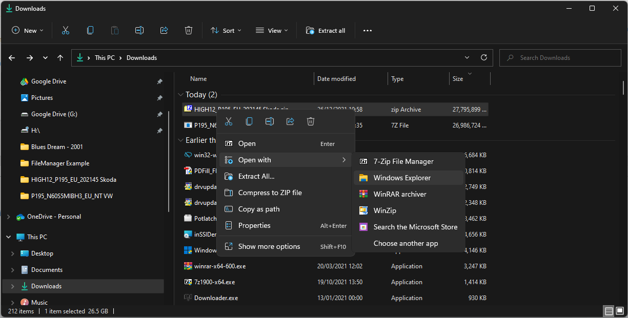

My post 31st October shows the File Manager right click into Windows Explorer the built in free method that works with the Skoda files. MartiniB links he posts up for Skoda files are identical to the ones on the Skoda board with VIN when they go live. Once unzipped all serial VAG files are the same across brand. 😉

I used Windows 11 in built no issues. You might have had a data error on your comparison. The old test is if it doesn't unzip don't use since its corrupted. Hence the October 22-30 conversations. If you read the thread people succeeded with three different unzip programs without error. That Skoda one is being installed fine on Seats I know that using the inbuilt unzip of Windows and MartiniB's links.... but either way VW and Seat servers run better so best to take it from their (links above).

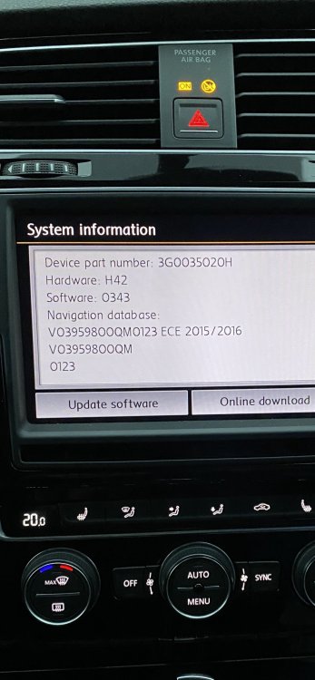

This is my headunit. I don’t have any sd cards in slots 1 or 2. I am told it is mib2 . The Nav works fine. Maps are held on the hard drive.
I need to access the hard drive which i think is the problem. Downloading the maps onto sd card to then update the hard drive i am told i cannot do myself.

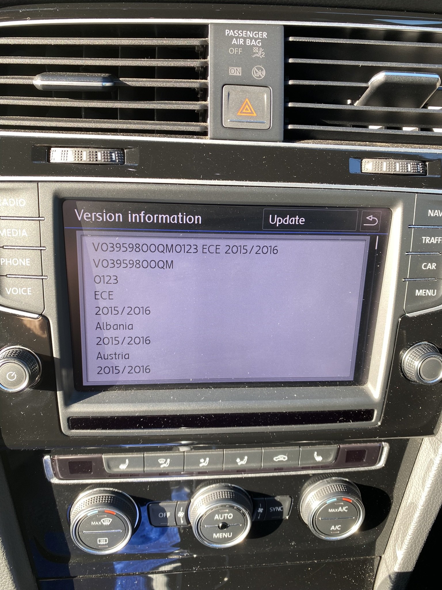

Another image

So you are saying its possible to update the hard drive this way ? Three specialists have said it is not possible.

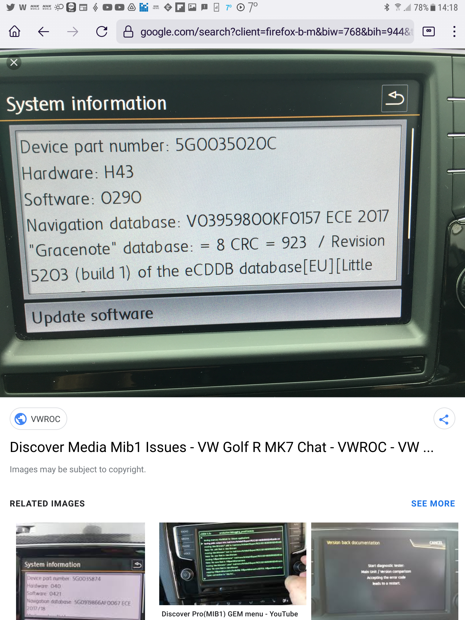

The screen you need in the car is the one with the Part number on it. That's generally on setting, not within the navigation menu. You put the units part number into Google and look at the images. Read what is printed on the unit sticker. It's going to tell you whether mib 1 high or mib 2 high. Tap the Part number in of yours into a Google to resolve.

by shown title of current maps,
i can guess for sure, it is correct device for these maps, Mib2H

I think to be sure the original poster needs to get the part number and Google as above. You might right thou. I'd do it on the part number thou.

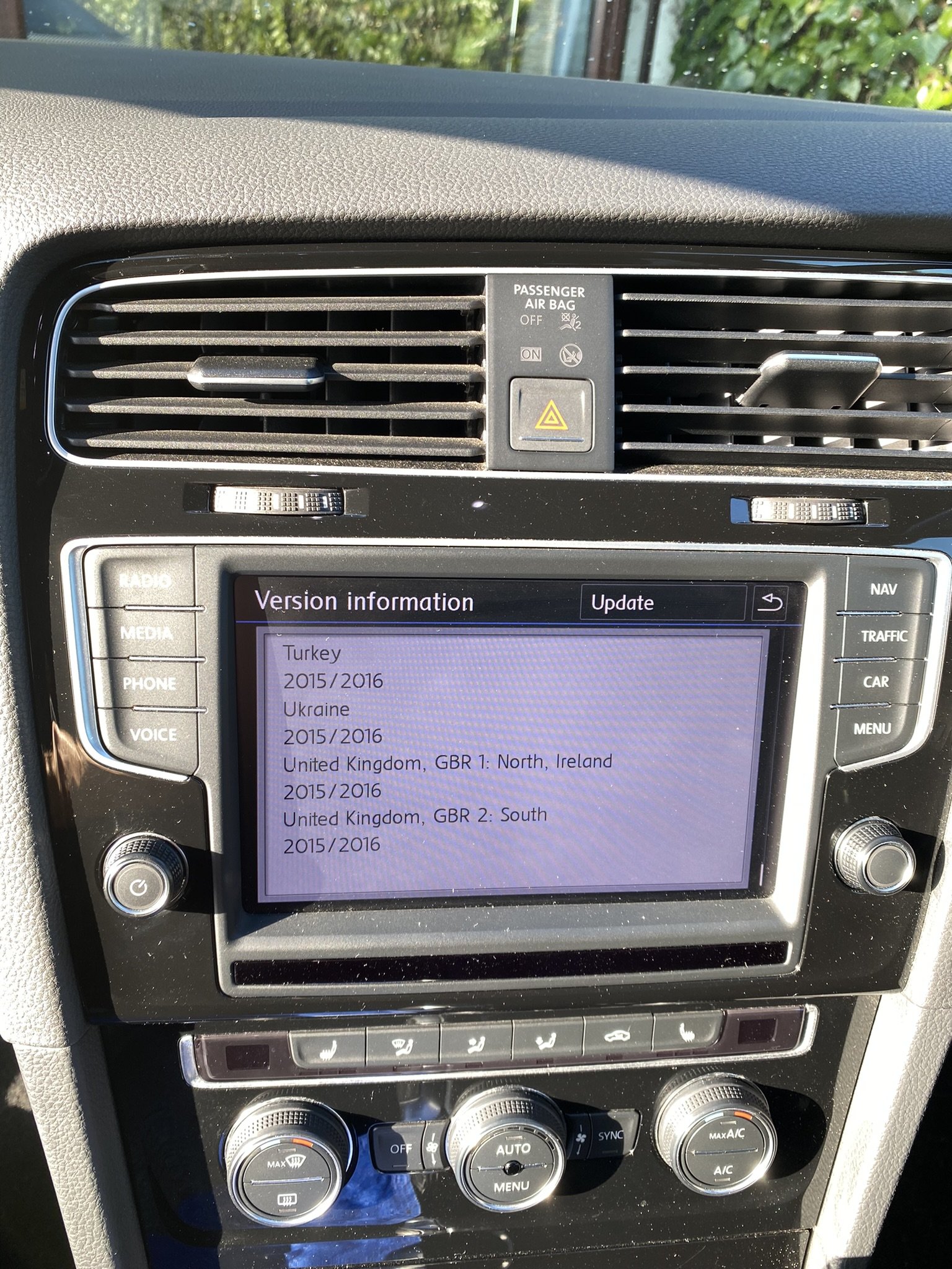

This is the screenshot from my system
Have spoken to my local VW Main Dealer, who don’t have an answer yet for me.

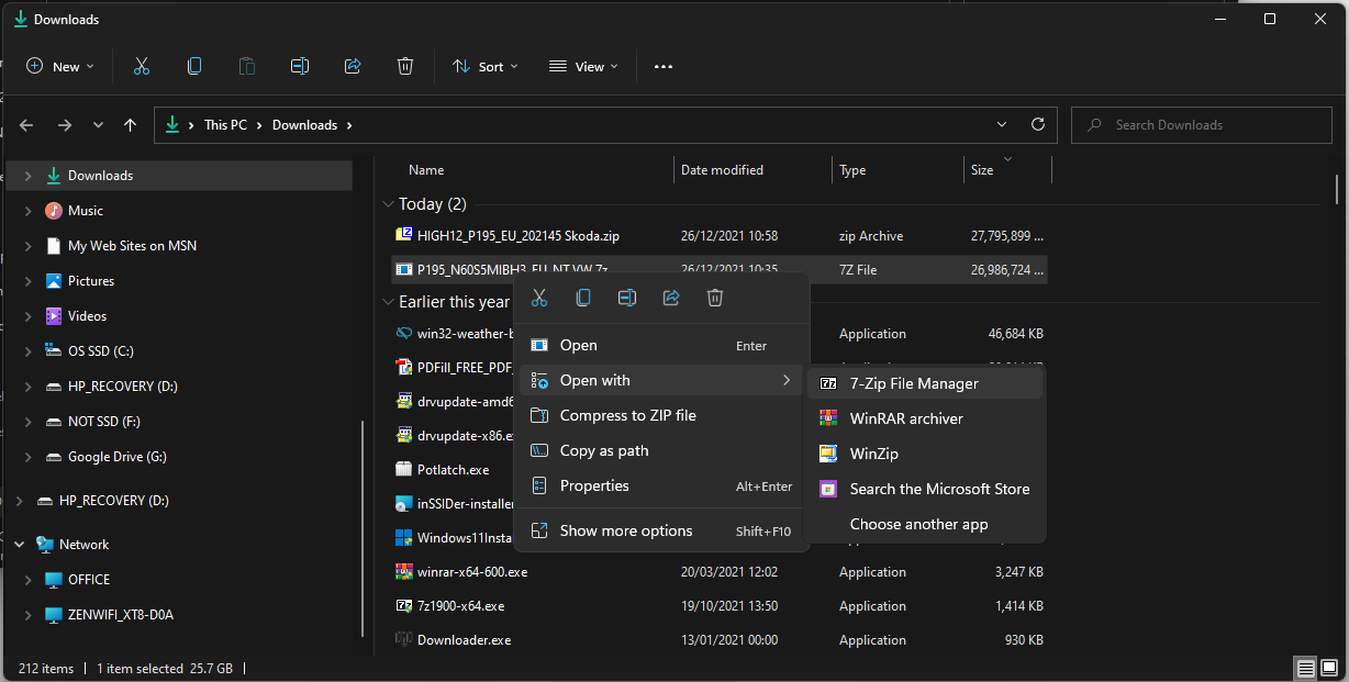

Not a problem. I'd pay attention to how you unzip it, built in Windows unzipped as I went into above in the thread if you use the Skoda download, 7 zip if you use the VW download. It's just zipped differently, same file.

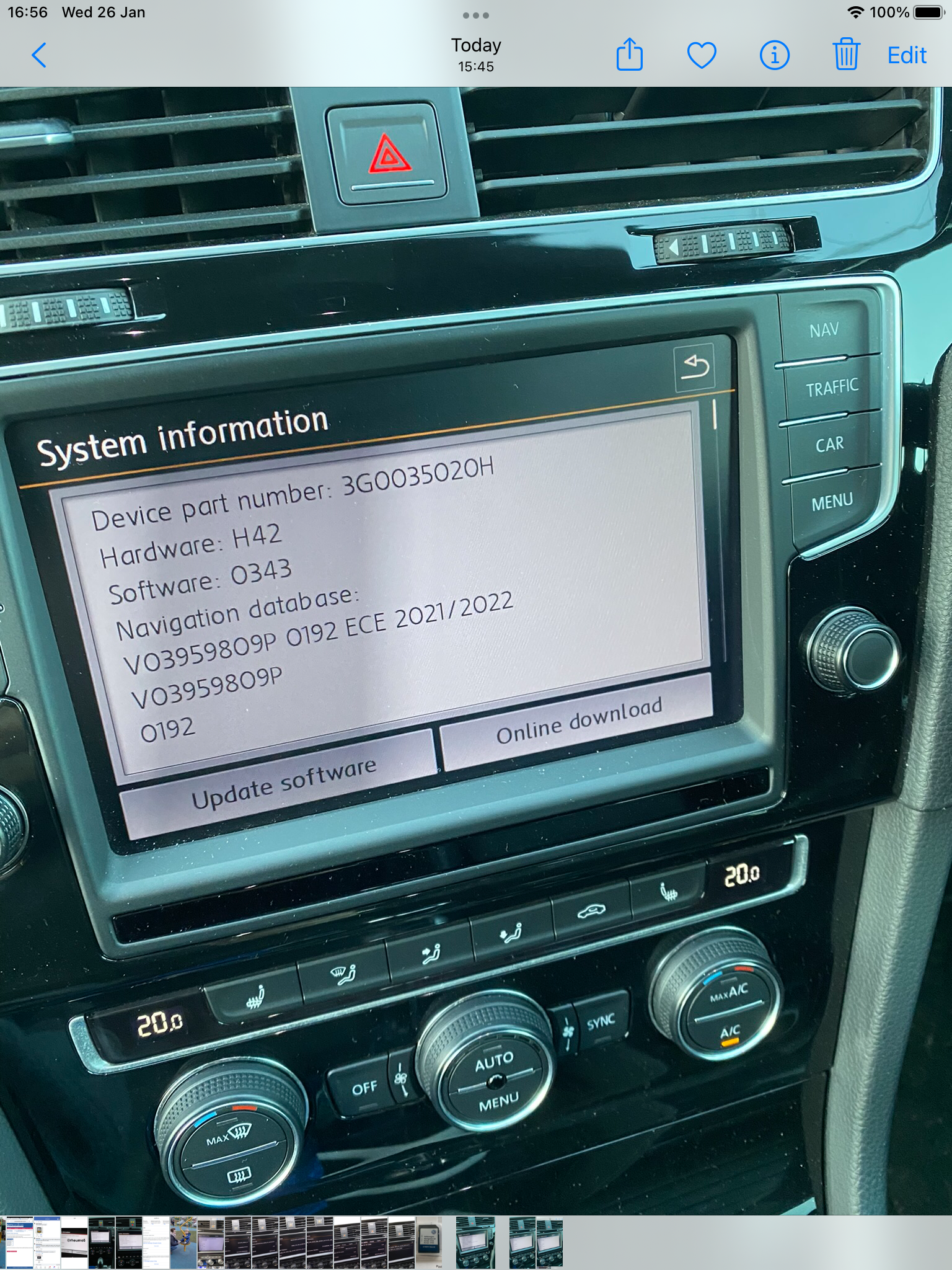

Well before i looked into updating the sat nav properly and got seriously frustrated about it i had ordered an update sd card from ebay.
it arrived today, so i tried it and it appears to have updated my maps to 21/22.
Took no time at all.
This is my screenshots after
