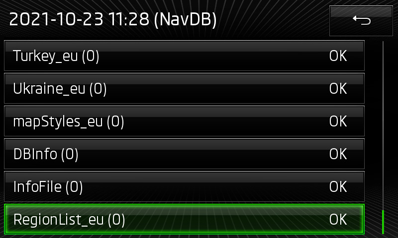

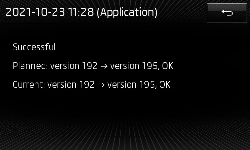

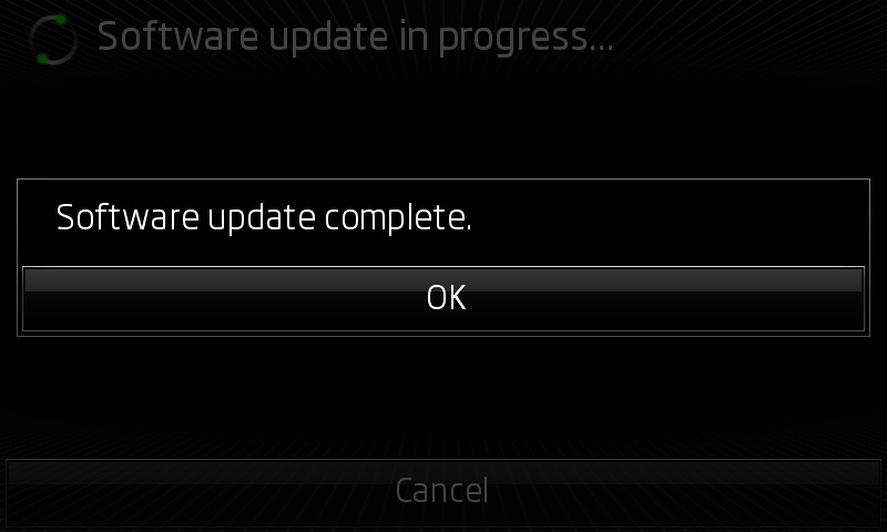

Fitted on a 32gb FAT32 SD card, installed fine. Works in the car. I believe they have Seat FeCs back in on this release due to no missing line on the info screen that you had before when it used the Skoda FeC. e.g. it came with a Seat part number.
(did the double check on the download just in case using Edge the second time, early in the day te downloads on Firefox were checking terminated but still unzipped, looked at the Firefox Furbo Download manager to check all came across inn the end ... zip file size compared fine between the Firefox download and the Edge one overnight - boot and braces approach. 7zip gave errors during unzipping yet gave the same unzipped file size - used the built in Filemanager unzip of the two in the end)
As long as you get the file size after unzipping finishing in 045 after unzipping as above, all should be good. 7 zip thru up many "errors" but did give the same output size as the Windows Explorer (It's proper name within the File Manager). This is a variation from the VAG recommendation to use 7zip but then these files were not zipped in 7zip. I think that's the issue. Possibly it goes unwritten now they expect Skoda customers to use the Windows inbuilt unzipping program, namely Windows Explorer, right click on properties under Windows File Manager to find it on the zip file.
The above screen you have is indeed my back end mib2 high import check, the navigation attributes all showed Y which is good to go, 40 minutes later we get changed to OK when viewed and we are good to go.
Seat part number this time. 192 it was missed out but the Skoda FeC in the unit took the import but didn't populate the part number area using the "Mib collective" Mib Tool. So it's running thru on the Seat life time FeC on my unit this time round.

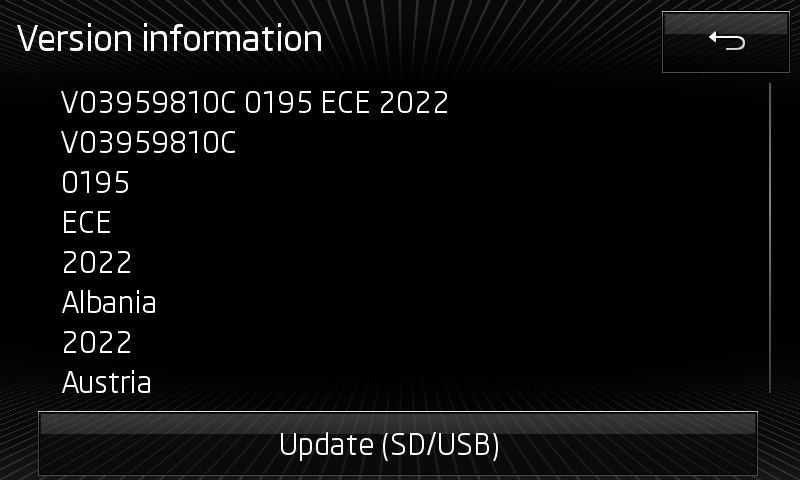

When I plugged the sd card it didn’t automatically prompt me to update sp go to nav > settings > version info then click update

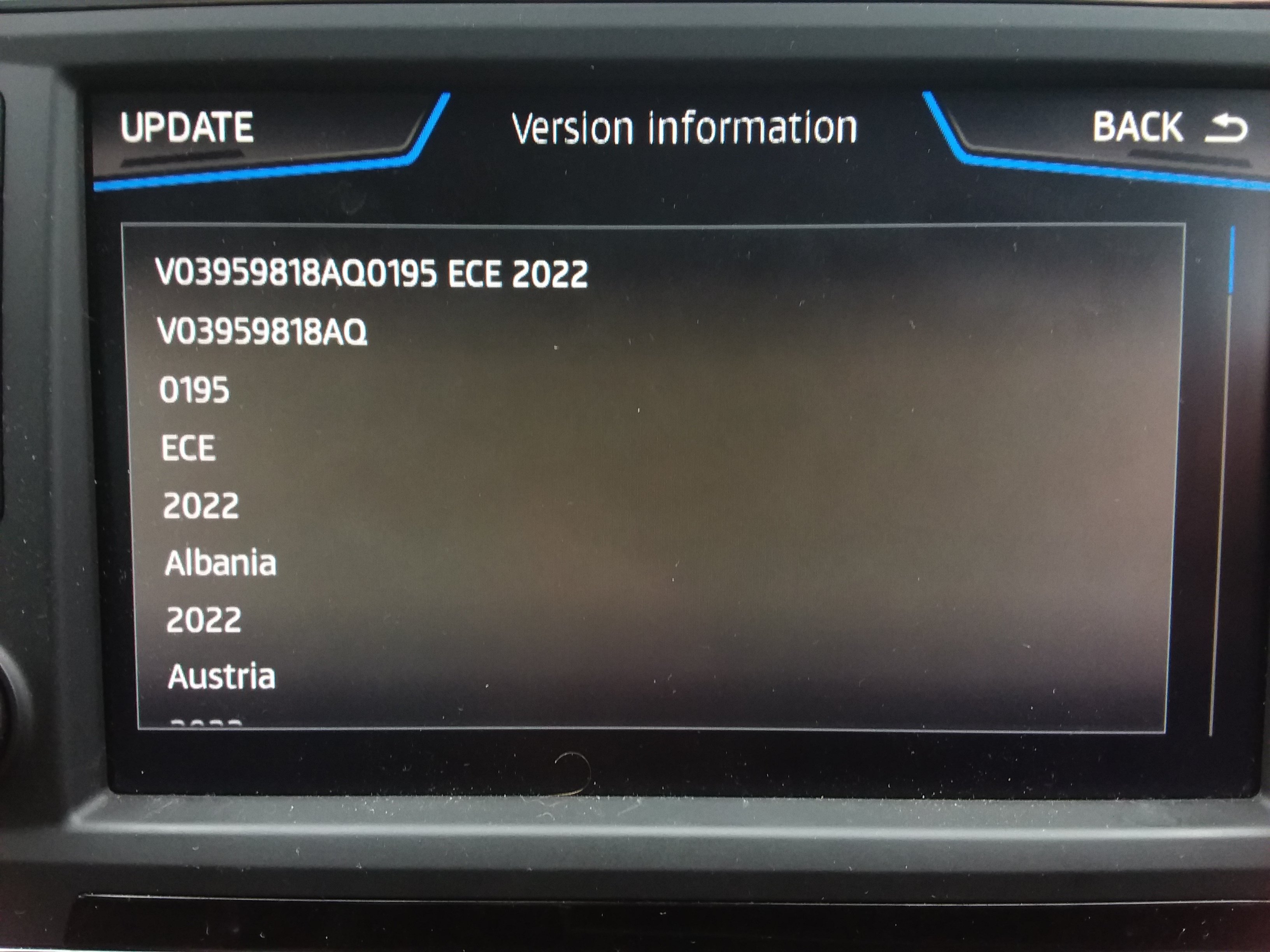

Updated today, works perfect.
