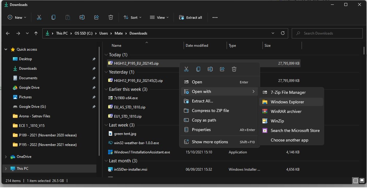

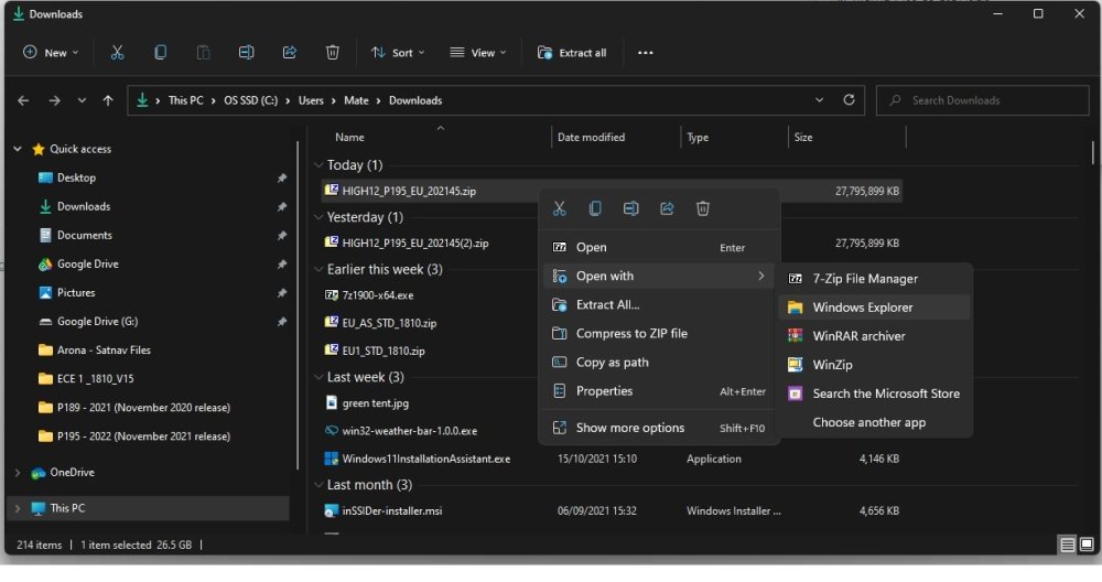

You might find that Microsoft use the same code in their File Manager built in unzipped. I used the built in option of Windows 11, right click, drag and drop. No issues. Expect it's the same in Windows 10... so did you try that ?. 7zip moaned but generated the same output but I opted to use the File Manager built in option. Think they used a varying level of compression on those files which upsets 7 zip.

Have you read the posts above? Unzip using Windows (right click, "extract all") rather than 7Zip or similar. I bet your download is OK, it's just been zipped oddly by VAG.
The VW portal link is kinder using 7zip on their zip file. As mentioned earlier it seems that Skoda mismanufactured the 7zip file to use with 7zip. It moans but works whilst the Windows built in one works without moaning. VW zip works on either and no moaning 😍.
I don't think I gave the File Manager example screen here, open with the built in Windows Explorer, sit on the download, right clicks and Open With Windows Explorer.... so easy:

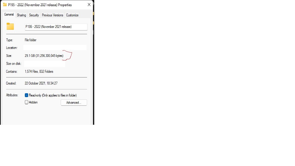

The unzipped should have this size then you know you are in business:

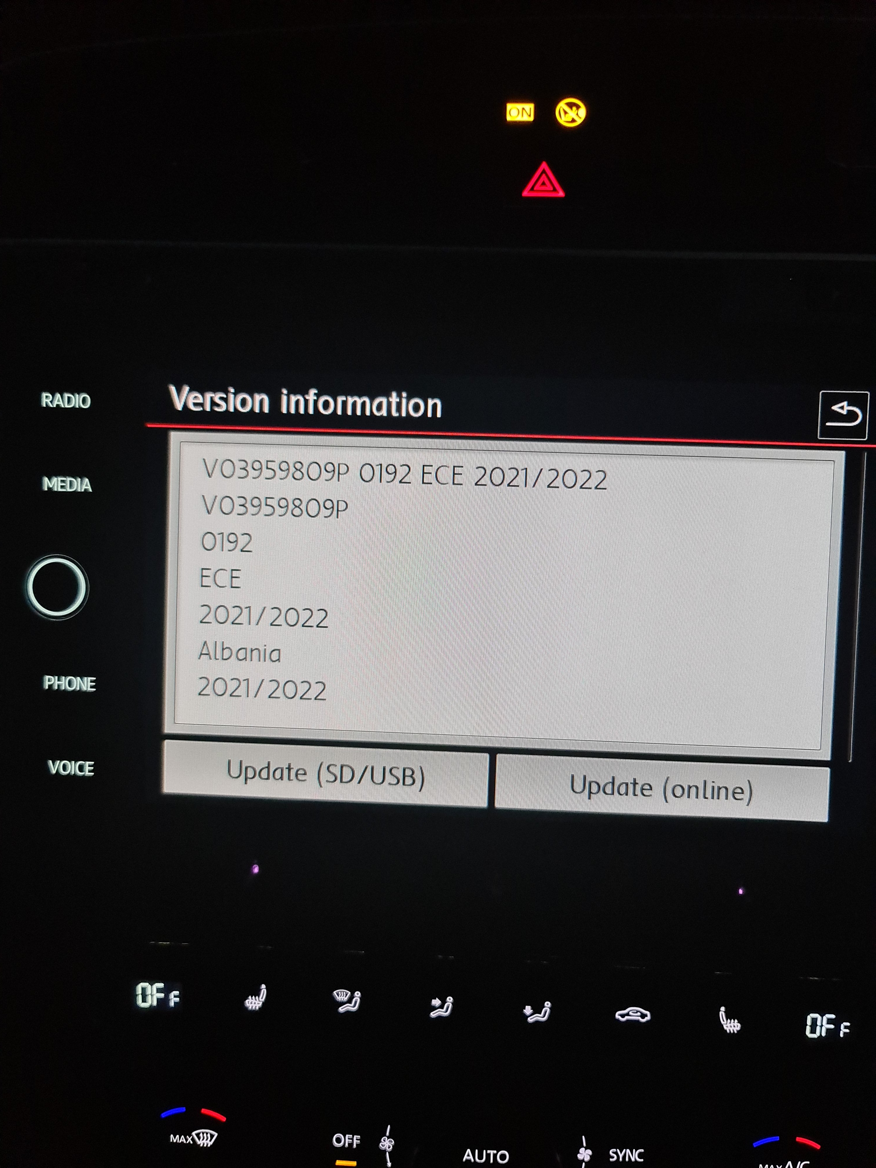

hi martin which one do i need to download 2022 maps for my golf 2015
Reckon he'll need a photo of the screen with hardware part number, firmware number and map serial number. Mib 1 / Mib 2 / standard or high. Four combinations to resolve.

hi have enclose the info
That's a MIB2 High showing the previous release of the maps so either of these:
