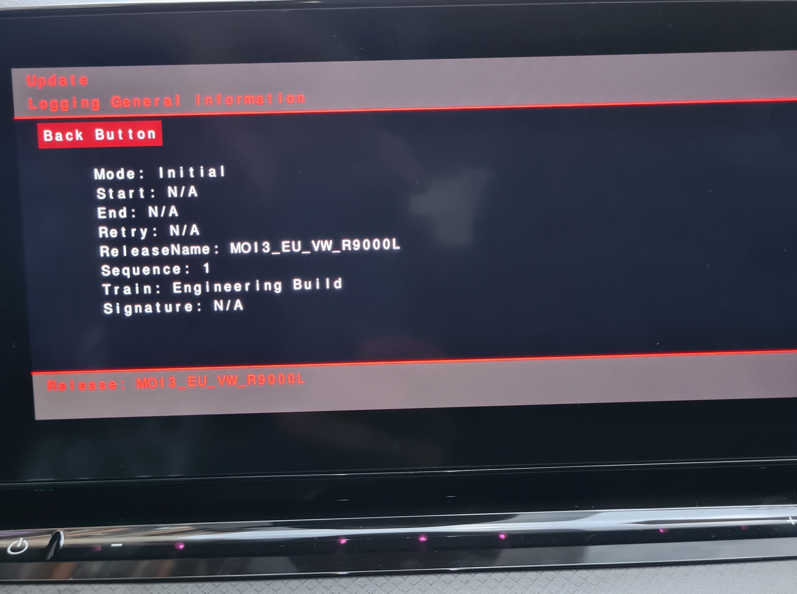

I have used the second one and it works great.
This was the previous state of infotainment

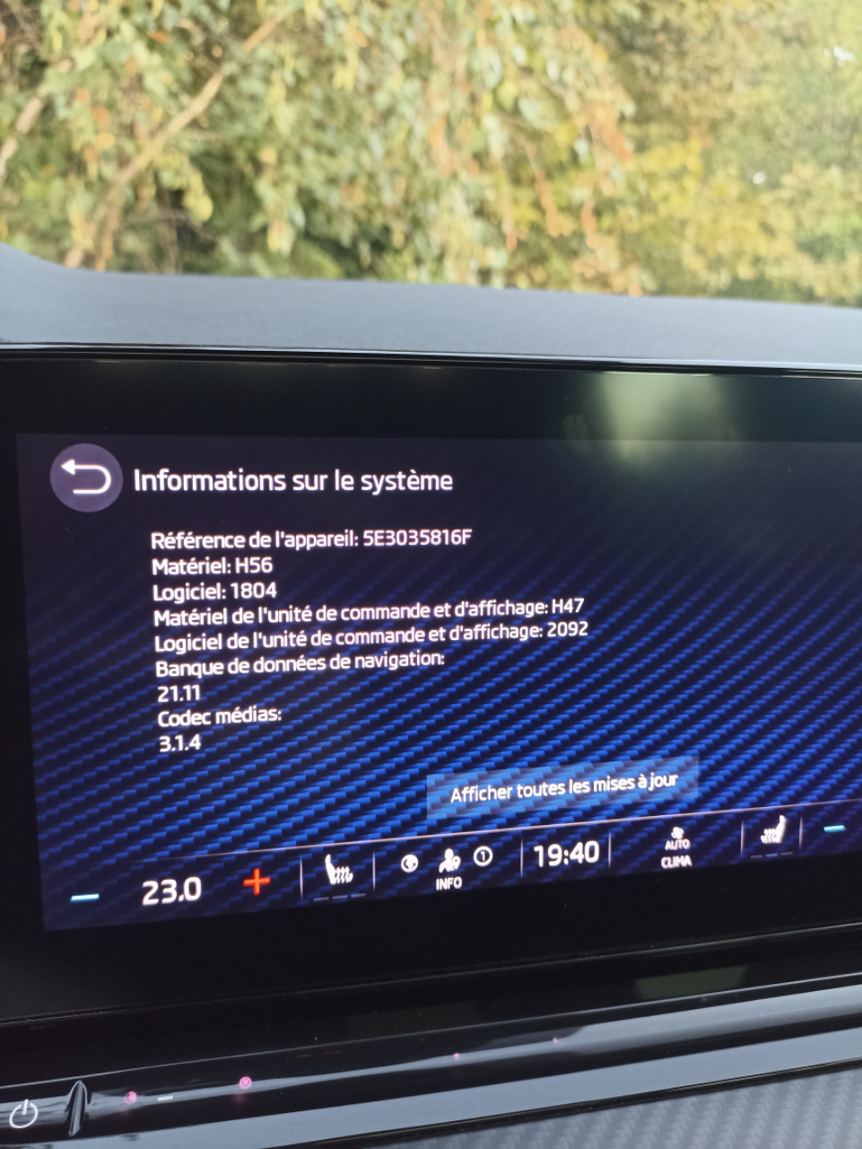

Hi all, is it possible to upgrade from 1804 to 1941 ?
I saw on the forum some H56 hardware with 1941.
Thanks.
IIRC you have to do it in stages from lower number firmware revisions, you can't make a big jump. Ask your dealer for advice.
Should be direct upgrade.
