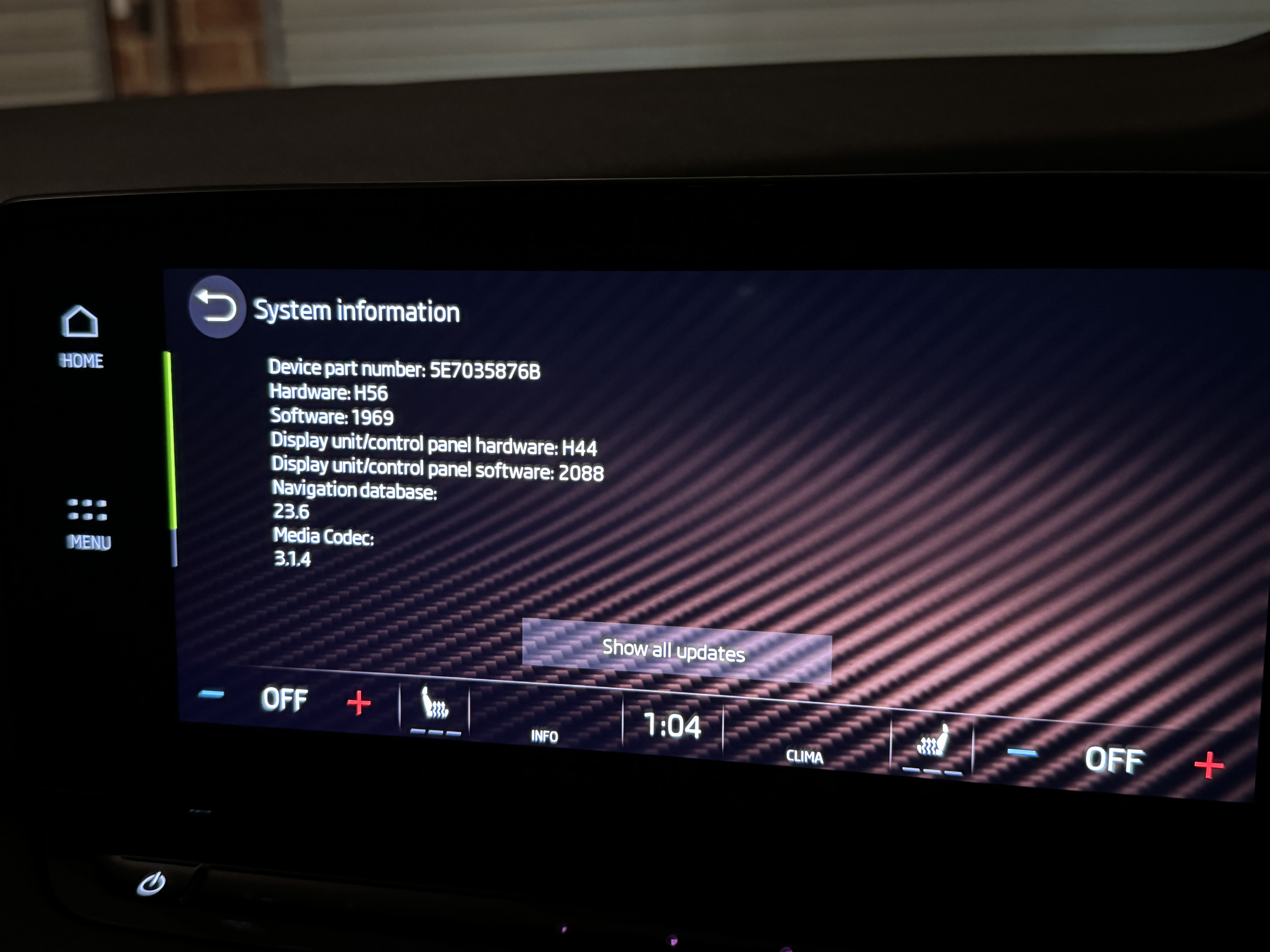

h58
1941
pue: h47
pue: 2103

On 07/06/2024 at 16:51, aaaaplay said:
Once it’s updated to 1941 you’ll get all those features. My head unit is the same hardware from early 2021 but it’s running 1969 and it’s smooth like butter.
Did you get 1969 from dealer? I had issues before getting1941 from dealer almost a year ago and from then smooth sailing.
I guess not, afaik dealers still stick with 1941
On 28/06/2024 at 15:50, vran22 said:
Sorry yes, i meant screen..
I received from skoda factory that dealer need to perform first update to 1969.
Because this update is also carrying fix for sound auto min to max and screen turning on / off.. So they need to perform update first if update dont fix issues they will change display.

On 28/06/2024 at 15:19, Rookie97 said:
Hello,
I wanted to report my issues… I just wrote to the service today and will inform you how they will resolve them.
When I listen to the radio or have CarPlay on, I hear clicking sounds (like I’m pressing buttons on the multimedia system, it goes click click), the multimedia system resets 100 times during the drive (black screen + Škoda logo). At the same time, front assist, cruise control, etc., stop working for a second or two…
Sometimes, these problems don't occur at all.
It's hard to go on a longer drive with such issues.
Additionally, sometimes the multimedia system doesn’t want to turn off after I leave and lock the car…
I started experiencing exactly the same issues in last few days. Could it be that this started because of some update or some online service? These issues had mostly be resolved with fw 1941. It's strange that many owners started having problems again now...
On 03/07/2024 at 17:26, vran22 said:
I said that i heard that 1969 dont fix thoose issue because already some installed manually but they said problem stays with thoose who did it manualy because components was not reset correctly and it has to be done with offically software odis or odin what is called.
Well update to 1969 didnt fix issues and i called skoda dealer to report back to skoda factory so that they approve switch of display.
