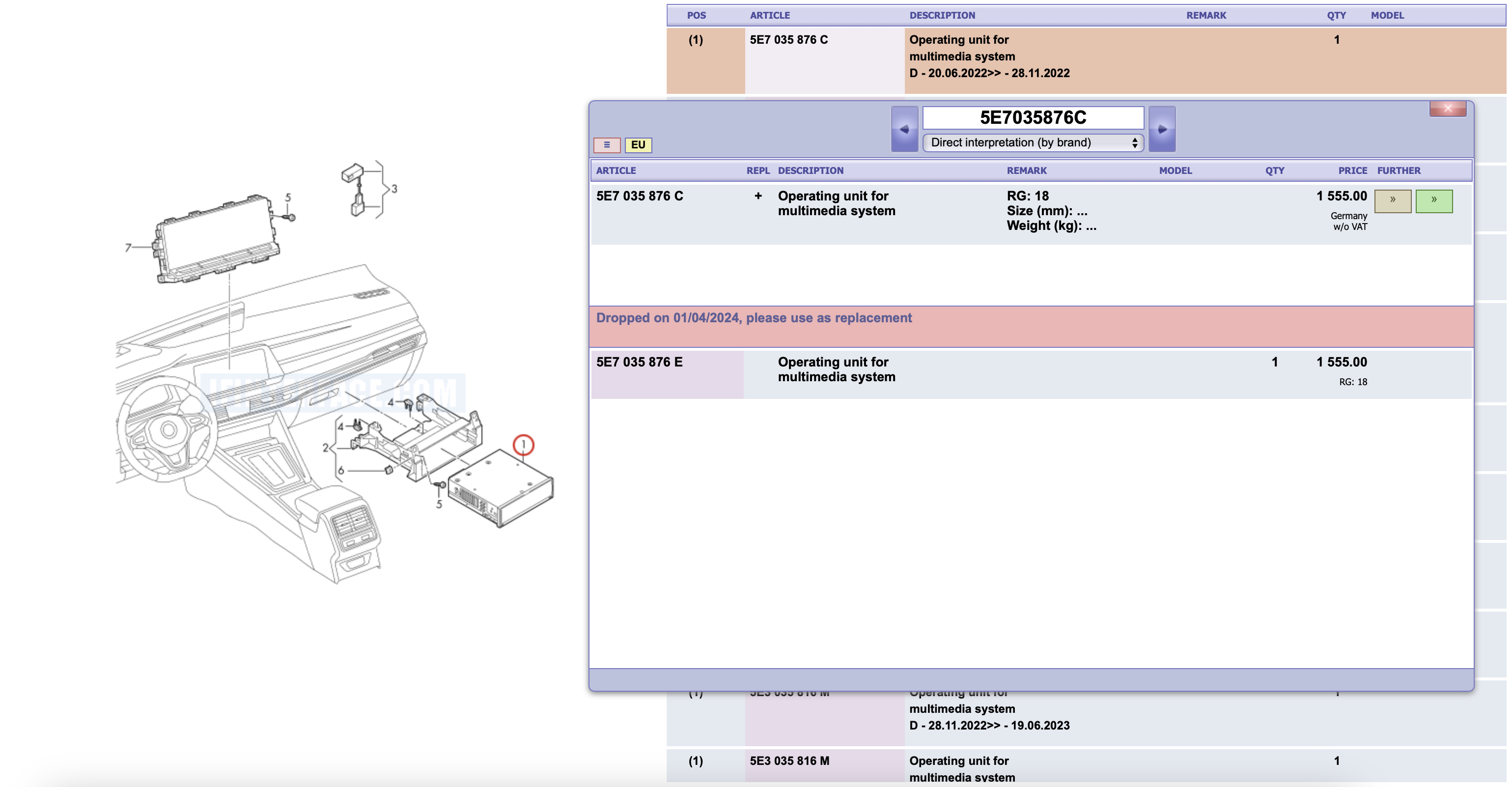

1 hour ago, Edela said:
They will place the same part according to your VIN, so no changes there. Though before accepting the car, check that all SW is updated to the same version as before. When they were changing my infotainment, they were giving me car back with 1668 every time 🤦‍♂️ If they change only screen, I guess that might not be the case, though I can never be sure that people working on front desk know what they are talking about and what exactly will be changed. So better to double check.
If you have a current unit then it should be replaced by the same current unit...... If your car is older and has an older HW variant it will most likely get a newer current variant fitted as that is what they will be able to order. 😉 👍
I can confirm.
Some of the multimedia units will have a notice advising to use a newer part revision.
