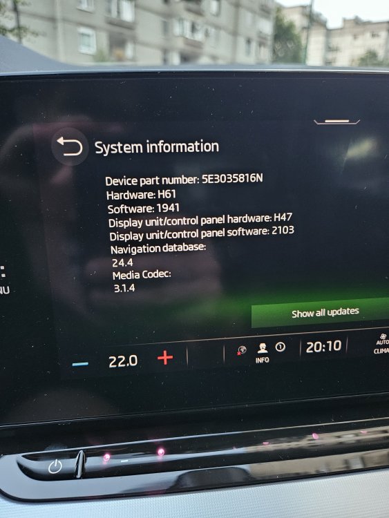

On 05/06/2024 at 09:40, kiter76 said:
The only way is to substitute the display unit. Mine substituted under guarantee yesterday changed its version from:
Unit display hardware version from H44 to H49
Unit display software version from 2088 to 2103
It seems this display unit is the one from 2023 that solved this annoying problem
At the moment all is fine.
Hello,
Did this replacement solve the problems?
I bought one Octavia IV in 2024, which already has Unit display hardware version H49 + Unit display software 2103.
thank you very much

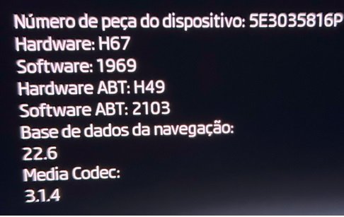

Hello all,
As many other people I also have infotainment restart, sound clicking problem.
My car wasn't used by last 6 days (I am at holiday now) and yesterday problem appear.
As I see it is globally problem, and should be fixed.
My history is also similar to another user here. I am second owner od the car. When I bought i couldn't change master owner. I went to the official service then they do some updates (and also change user name and details on their online system).
After that everything works great till yesterday.
Problem exist even i switch to privacy mode (incognito icon).
What i did (and still have problems):
removed my phones from car
clear cache and data in Android Auto app
disconnect any phone from infotainment
restart infotainment (10sec)
I think if it is global problem should be fixed for free (for first use, bring master user function) i paid over 150€ for fix.
Now the radio terribly crash... Most annoying is Spotify reconnect so music start and stop...
Fun fact:
If someone have HUD display, it still works and show arrow how to drive - so navigation work.
Could someone explain how to do update? Step by step and how to fit firmware to my version of car? Here is some details:
Hardware: H56
Software: 1941
Hardware ABT: H44
Software ABT: 2088
Navigation Database: 23.6
Codecs: 3.1.4
Btw.: Anyone tried to update map?

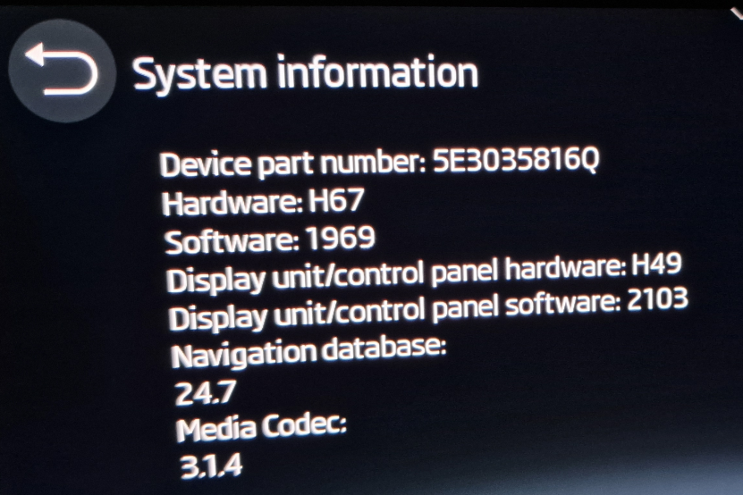

So update to 1941 fixed some issues, then we updated to 1969 but problem still exists, now skoda factory said to replace screen in warranty.
22 minutes ago, vran22 said:
For me they would change screen.
You are lucky cause they will not charge You for that... They replace screen and "pc"? Do You have more information about replacement?
Yes, because its around 1000€. I have currently only information that parts are on way and have date for replacement. Will report when they will change.
Well, today I got little update - little travel during update and no clicking or radio reboot.
