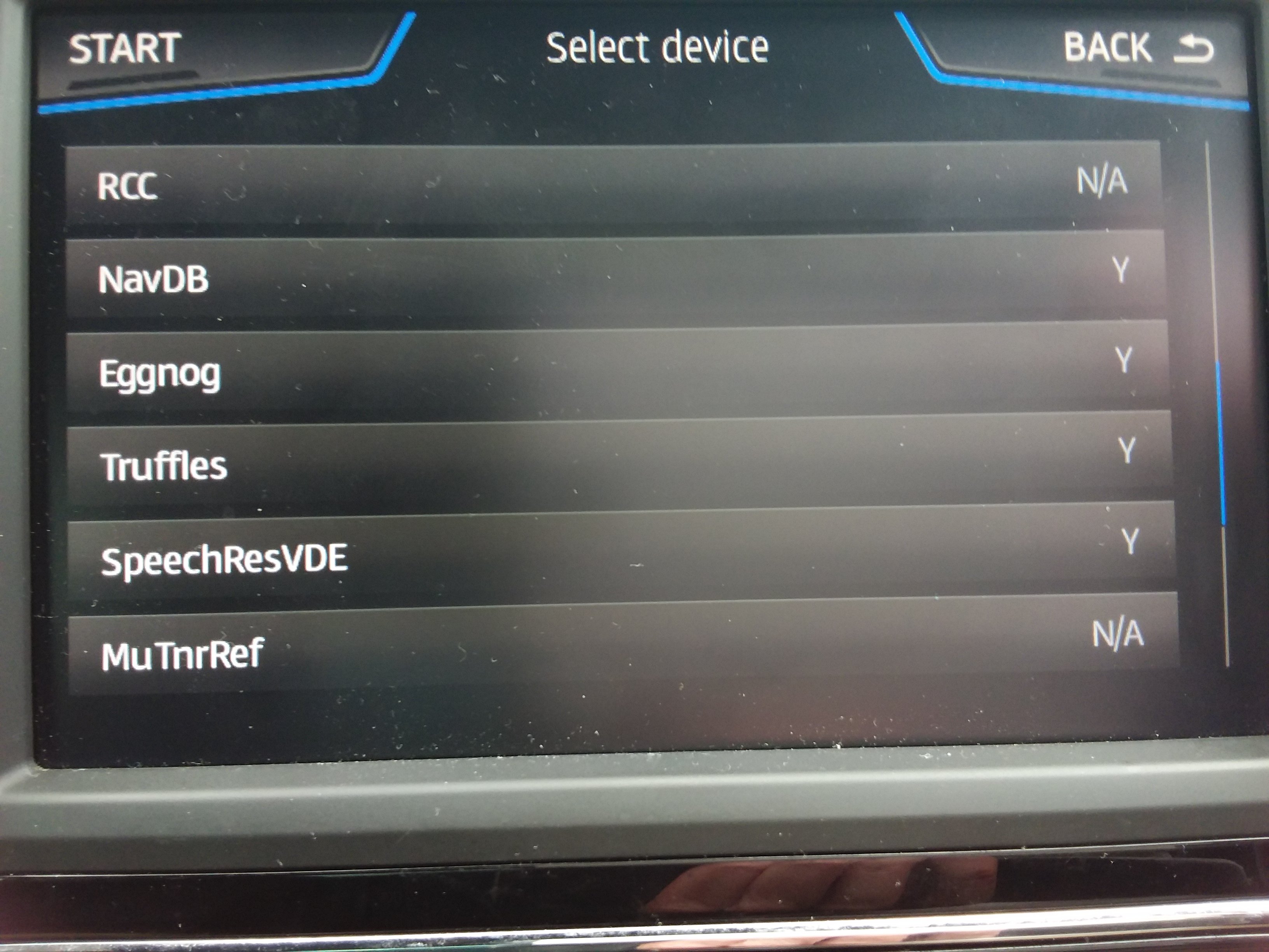

When i try and do the update i can see the folders but they are all N/A and i can't actually do anything, i wonder why. I tried the VW version too and no luck. I was thinking to do a previous version and see if i can get a 2023 update going at least.

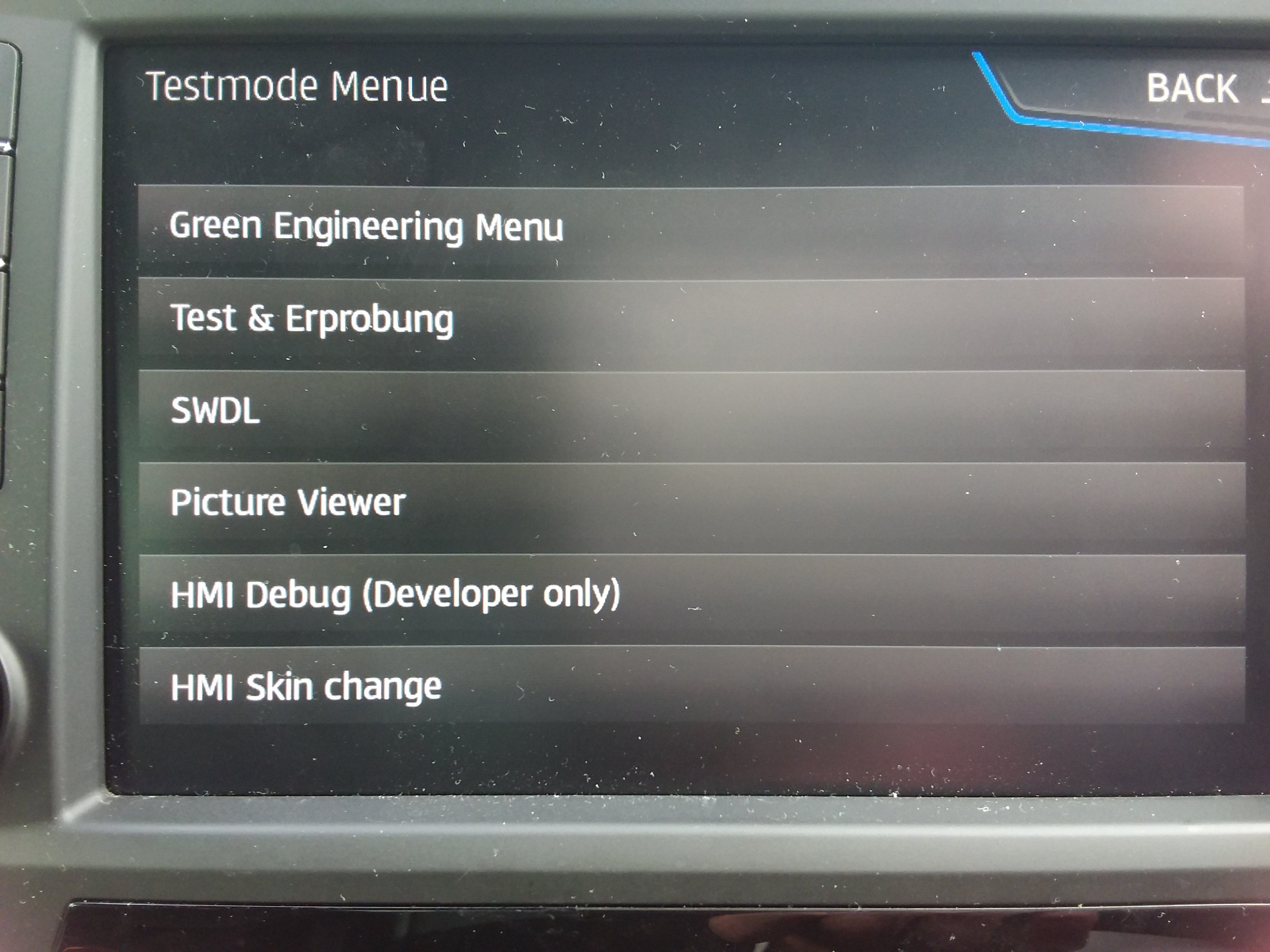

If you can't load up the 2023-24 maps, then if you want to fix it yourself, then it's the SWDL menu. Mib1 high it was open, mib2 it's locked down. You have to unlock the developers menu. Unlocking is the same for Skoda as Seat. In this guide I show how to do it in Obdeleven Pro
https://www.seatcupra.net/forums/threads/obdeleven-tool-for-vcds-type-of-activity-working-ones-for-the-ateca.438134/page-2#post-4730643
You can also do it with VCDS and other tools these days. Once unlocked and it stays unlocked once done to get to the SWDL menu you hold onto the menu but, that gives you screen 1 (which you haven't found yet), hold on for longer and you get screen 2 with SWDL on it. Success.
Hitting SWDL then gives you bench access to the units update firmware, maps, user POIs. You can downgrade and upgrade maps or firmware with this menu. Why I think the unit may be stuffed on the map update is I've stuffed mine before. If the VW files issued were wrong and we know the first one was then it can have consequences so you force a map update. The menu has manual on it, you dance around that selecting all and go. Engine doesn't need to be running but you need to keep the door open or open and close it every 15 minutes to keep power to the unit. After about 40 minutes it will do it. You see the map entities of Eggnogg, Navdb etc. They all get updated and you come back out of the menu with a reboot once done.
As I said it's that menu which is used for firmware downgrading as well. It's universal. The normal update one only goes forwards not backwards if you have something in it which is recognised as newer. If your map memory is empty then you could go backwards. If you had SWDL enabled you'd upgrade with that second map file, the one that is said to be fine you could skip testing the 2023-24 map. Manual, highlight all whatever, start in SWDL. You do dance between the screens. I use swdl to upgrade the maps since I can see what is happening rather than the user / customer based one. I've always done it that way.

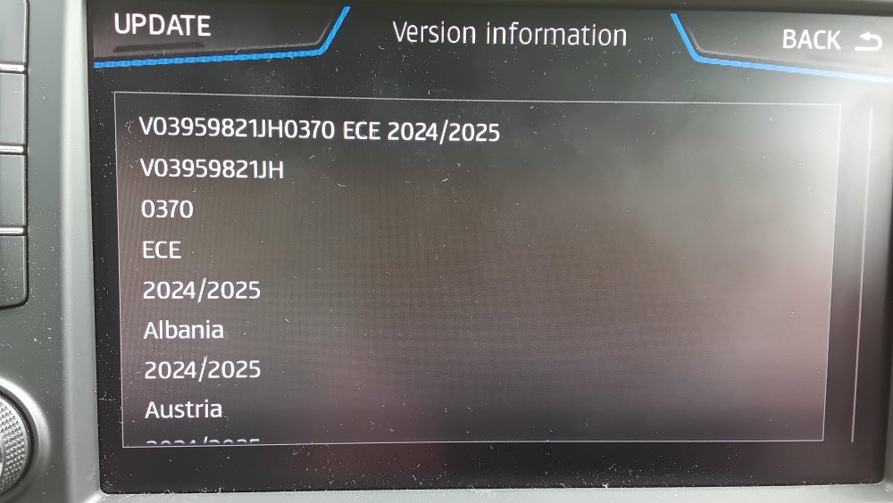

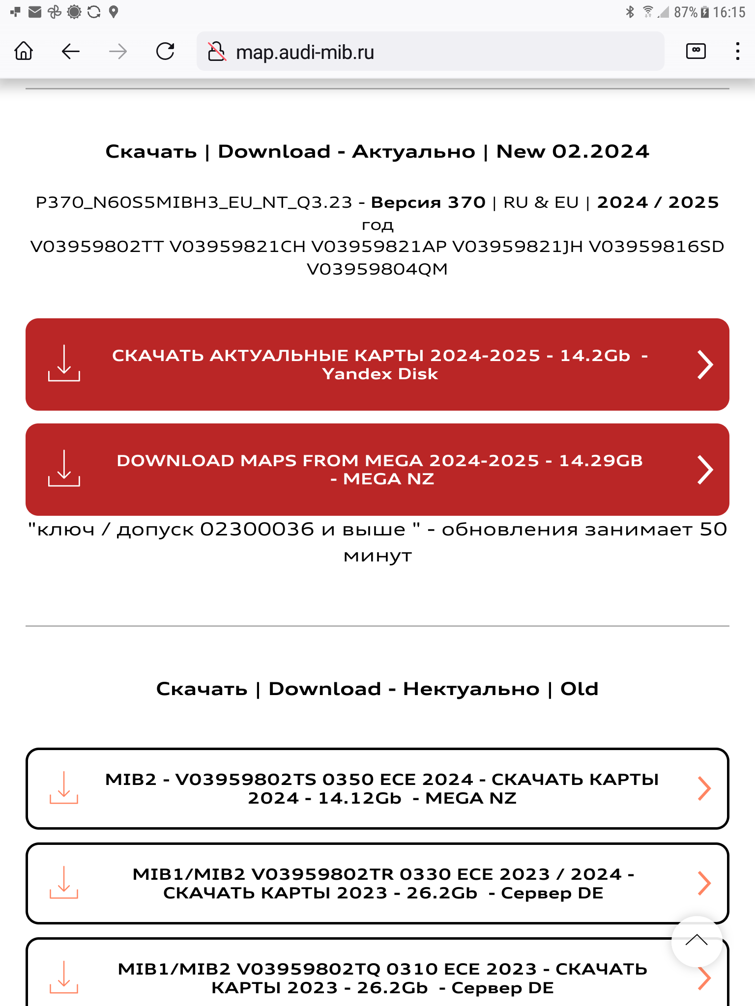

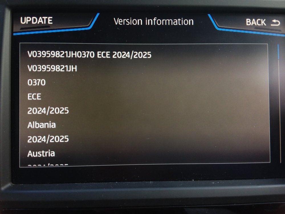

Here we go ECE 370 2024/2025 Mib2 high:
I use the Russian link you gave me @BooBoo124 as above taking the second link in the page:
http://map.audi-mib.ru/
Namely the Mega link for release 370 not Yandex that needed Russian mobile number. The Mega hint if you don't have a paid bandwidth is to use a VPN. Every time it says you have exceeded your allowance or wait 5hr, change IP address and hit refresh 😉 .

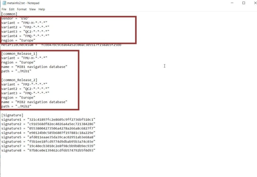

The file has two links at the top to promote their web site. Ignore them. The materiel is signed with an SLA1 signature so can't be edited unless you are a member of five eyes on something so it's not modded and cant be from when it was sewn up by the manufacturers. We dont have to worry about that.
The file has grown by 0.2gb from the last release. I did check some areas before and after and indeed this is an update to the geography. Got more roads in it.
As mused I reckon with connect services they probably got production down to a fine art so this one is laying about from the freeze cut off in November. I've seen November named else where for this probably based on the mibsolution link. Dates are when they wrote this to the file, not Audi on this. This would normally ship in June 2024. The Russian page says next update December. Think they have their maths wrong. December if official but they will get it September 🤣.

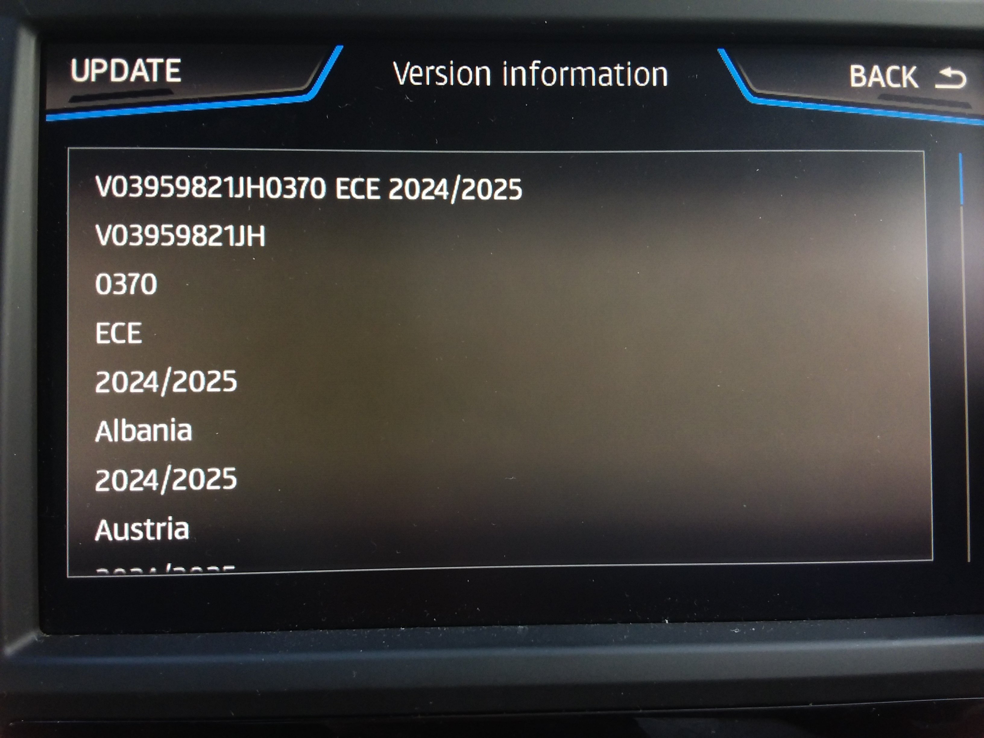

I'll be using this. Did the demo navigation run, fine. Inrix TMC works fine. No issues.

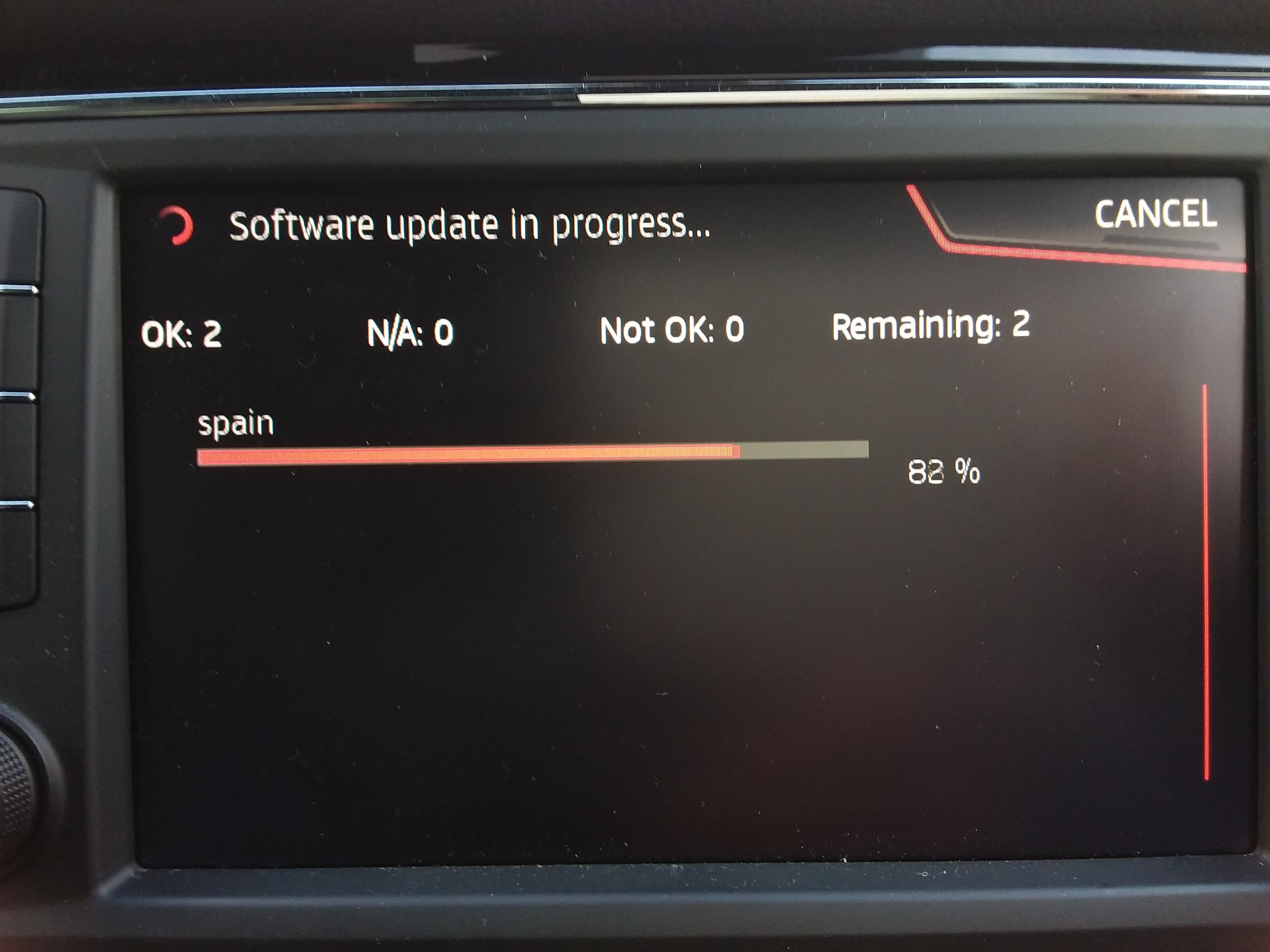

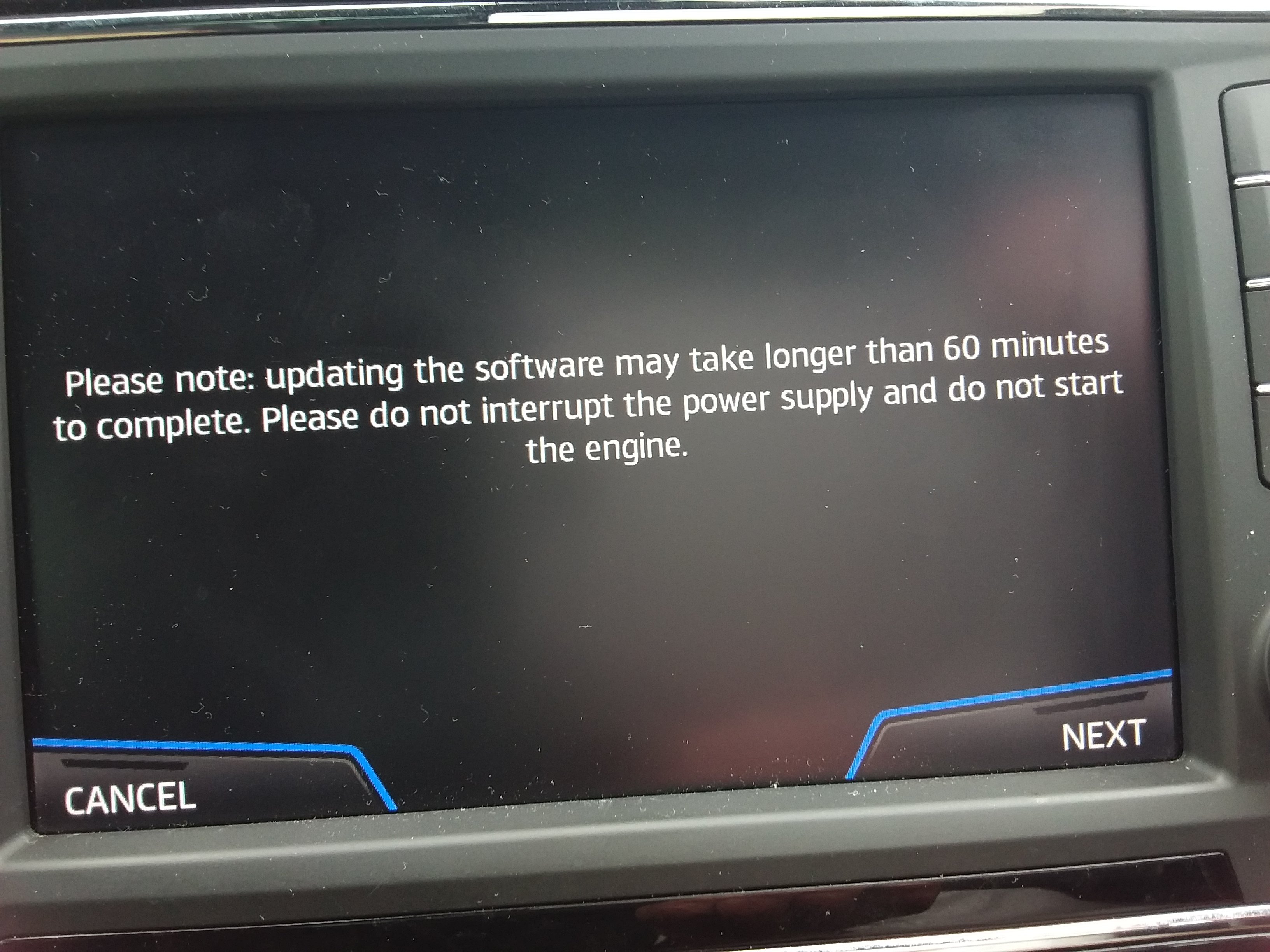

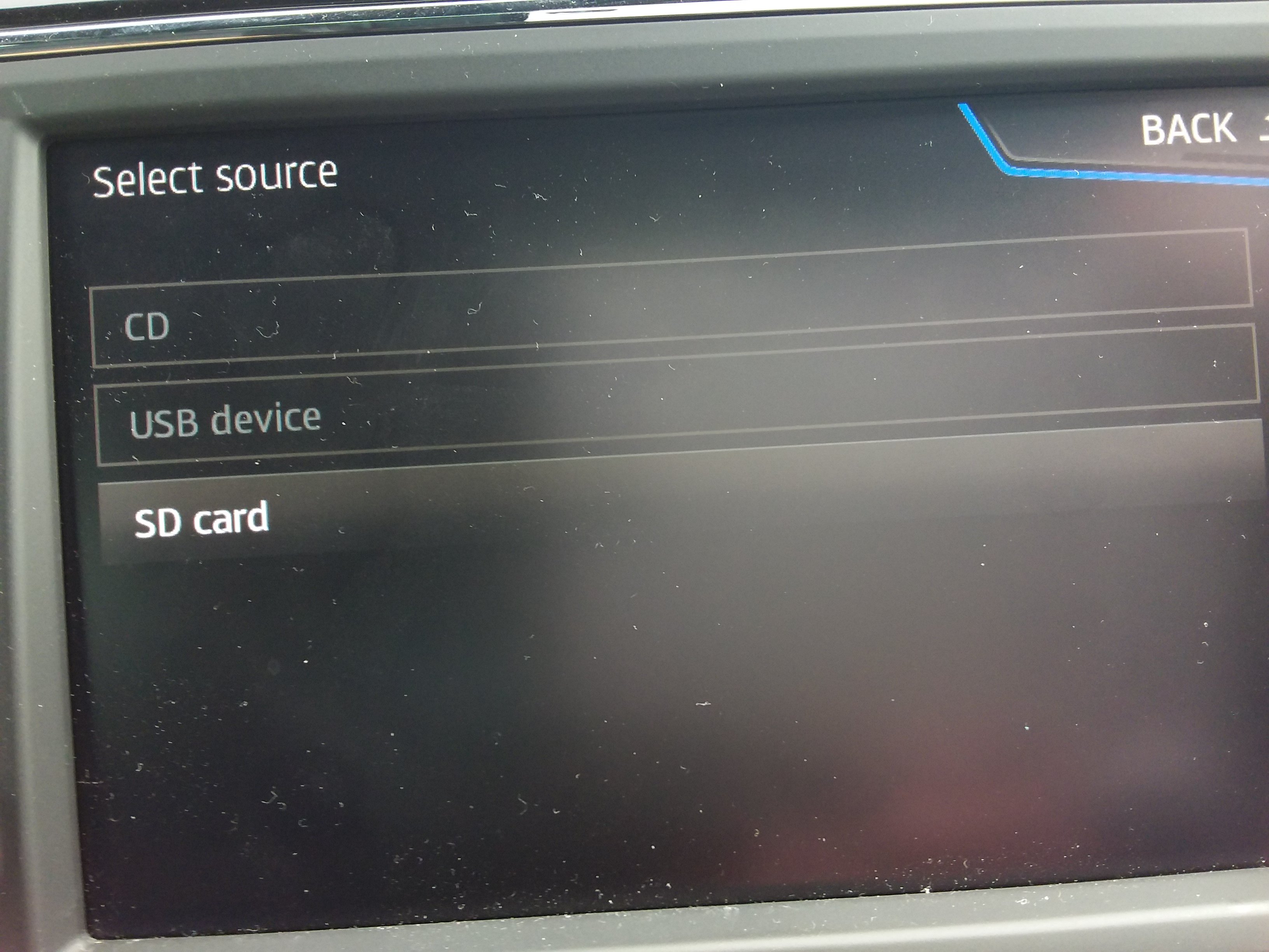

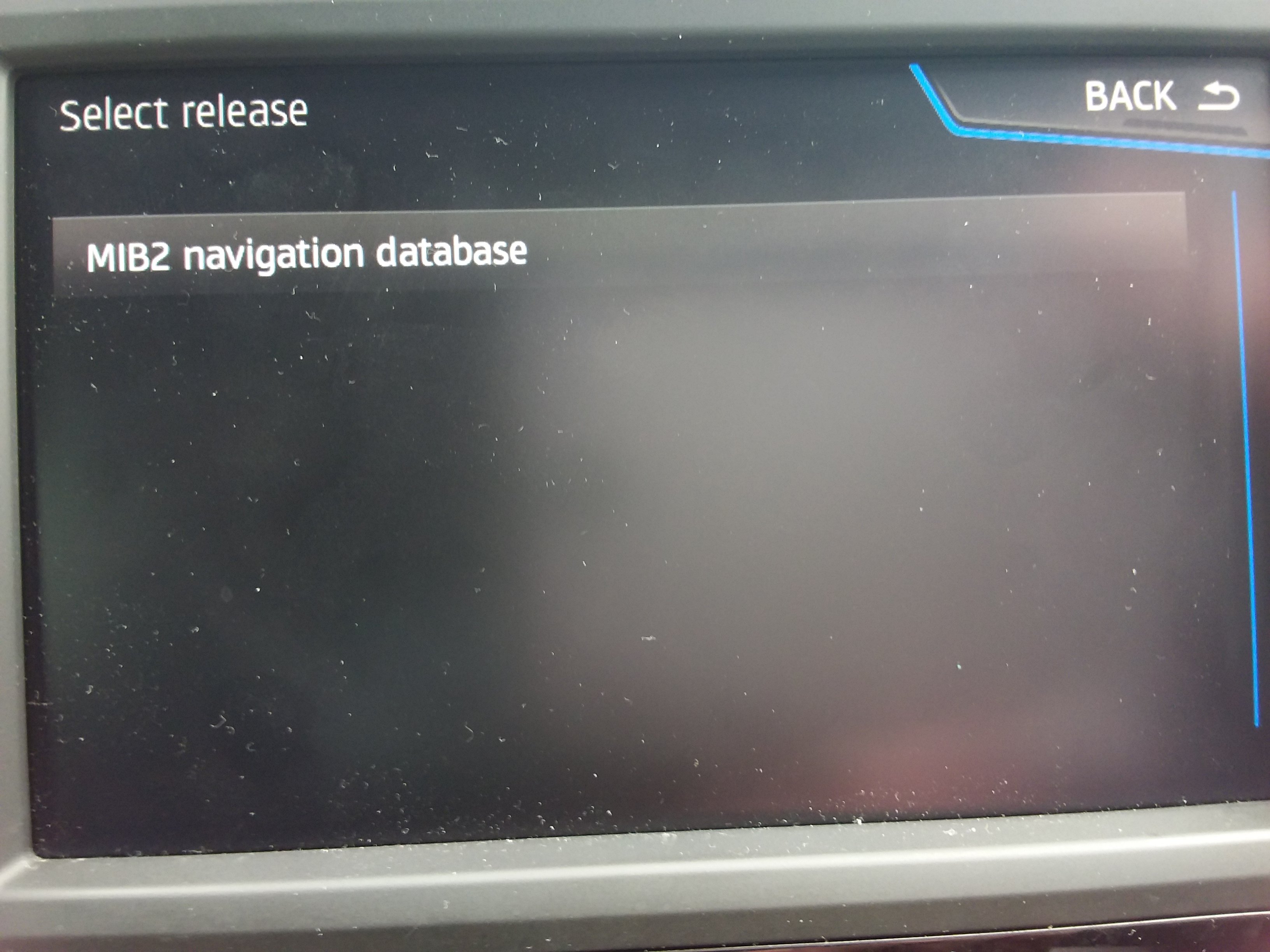

SWDL screen example. Once the developers menu of the infotainment has been enabled via VCDS or Obdeleven a long hold on the menu button brings up the menu with the FeCs on it, keep holding till you see this:
Then you hit SWDL with the map update in the slot:

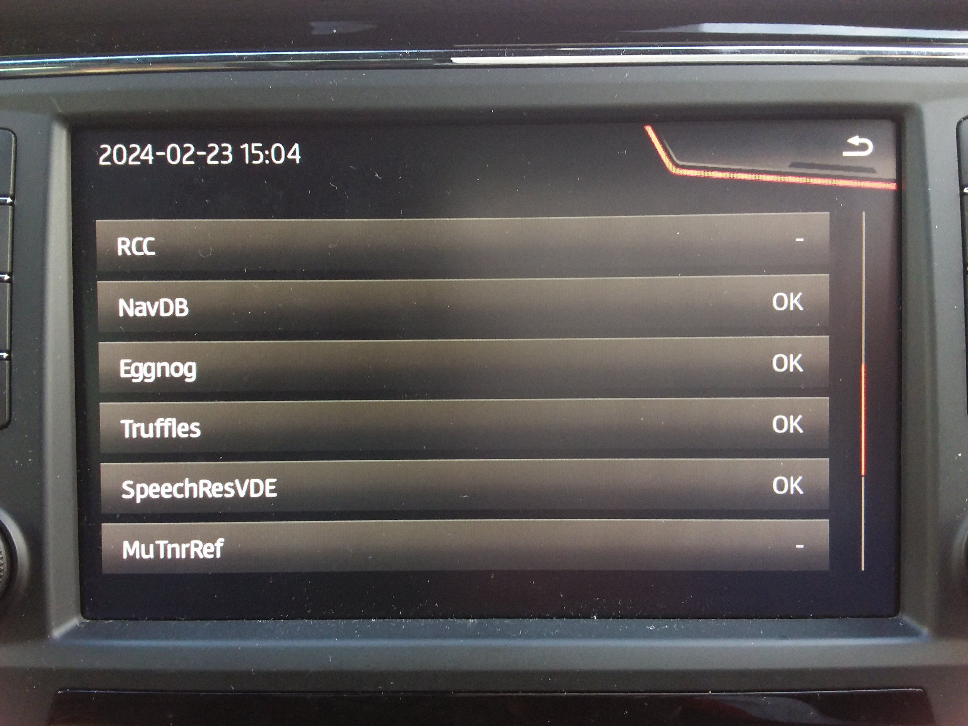

Tap SD card.
Tap the panel above.
It then shows navigation entities that can be updated. Y means it can be done.
You get the option of manual update or do all. You can dance about the screen as to which you want to load in. In this example do all.

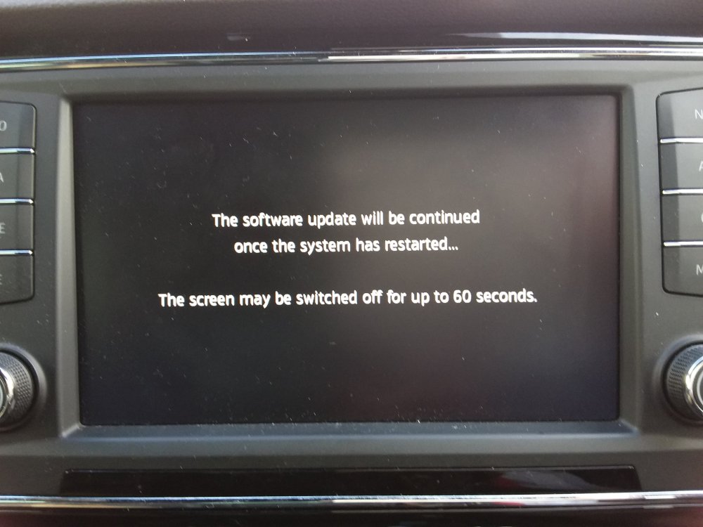

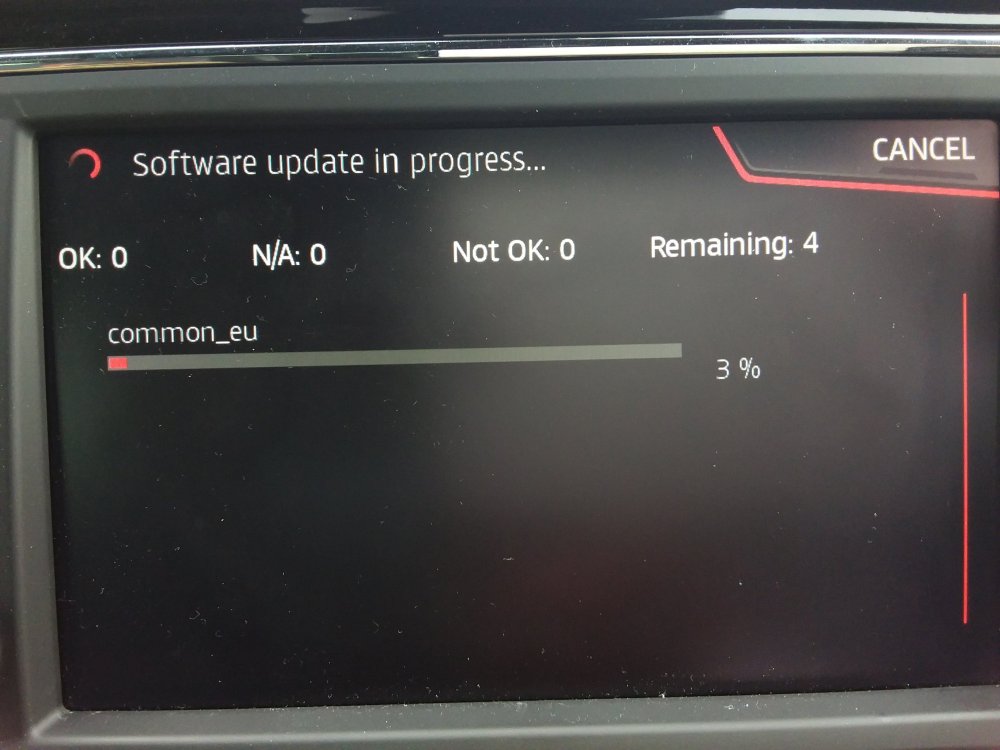

Off it goes but you must keep the car door open or open and close it every 15 minutes to stop power down, you don't need the engine running. Looking at 40 minutes at this stage.

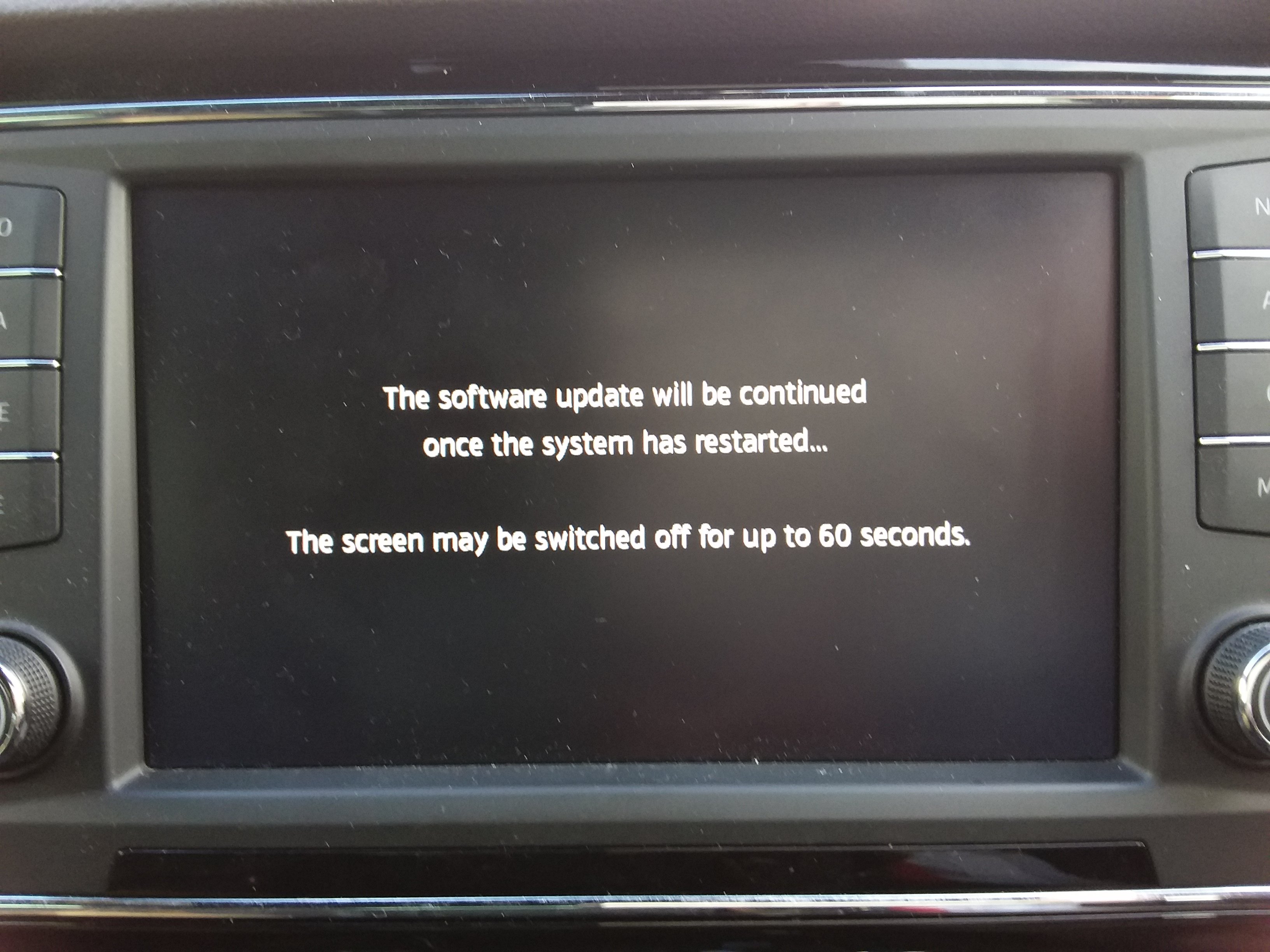

Progressing:
Means looking good:

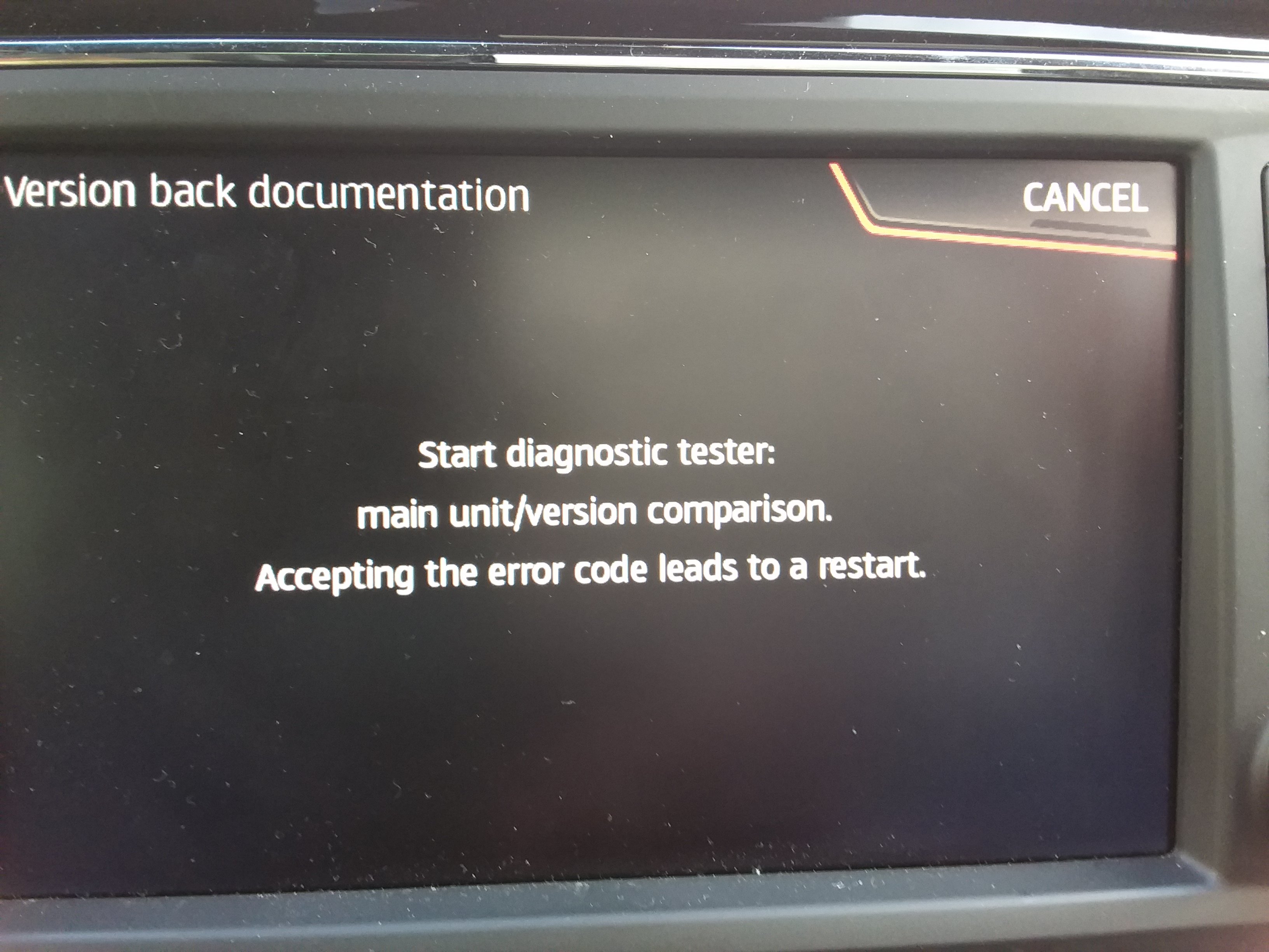

We press cancel and it comes out... with a reboot
Final stage...

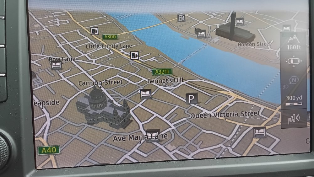

Then done.
It allows you to revert map updates and revert software updates. Has it's uses.
