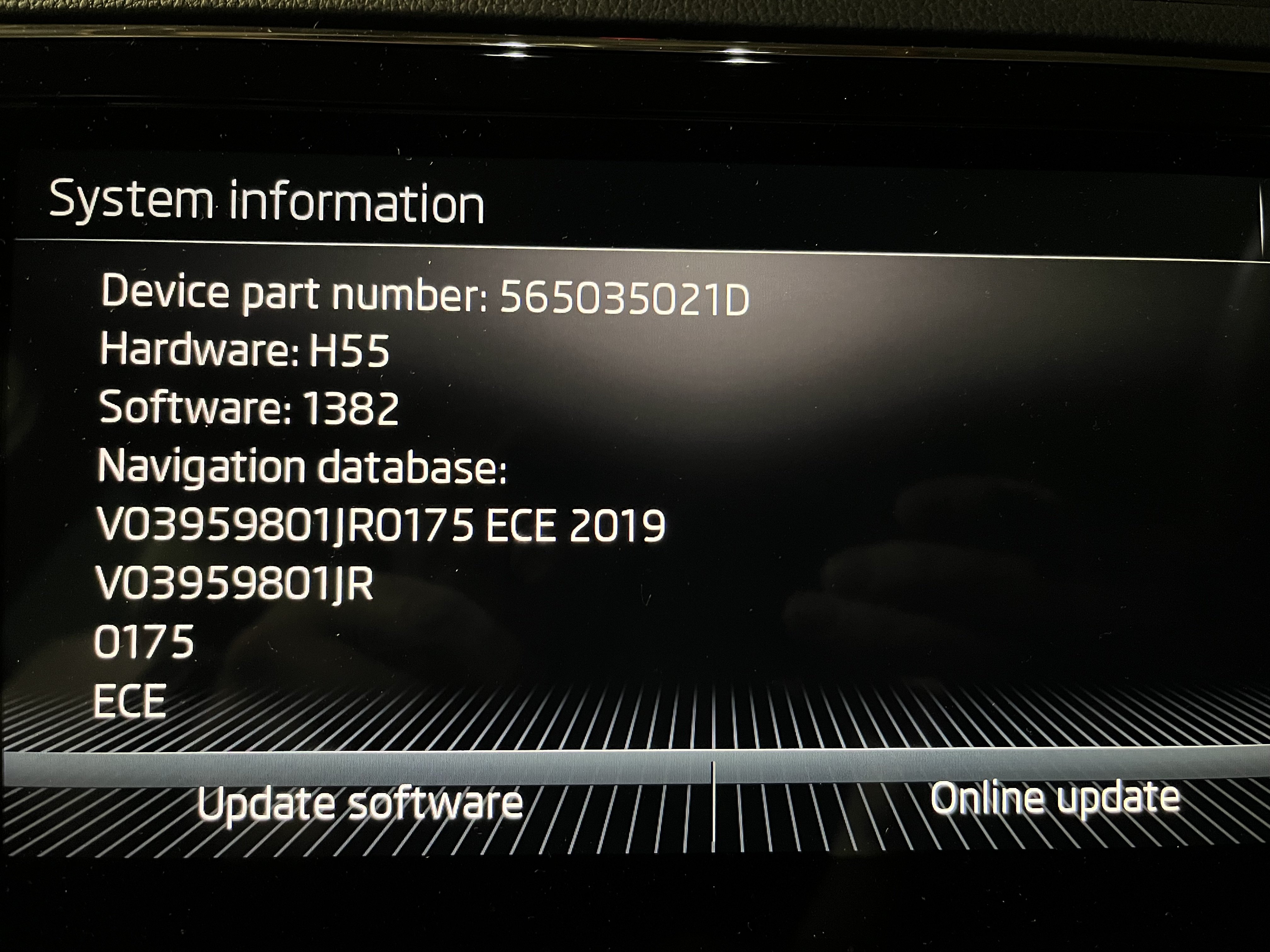

Trying to update from this to the latest file. Is that too much of a jump?
downloaded from portal and extracted, then transferred to a 64gb SD set to exfat. System shows no update available when card entered and update initiated in system settings.
You can jump as big as you like on a Skoda or VW they have life long FeCs, Seat and Audi need navigation FeC surgery. No mac involved where you should run CleanMyDrive on the drive once on the external media ?. Only the use of Macs requires that. They put dross in the files which cause the signature check to fail so it would not see the update since it failed the integrity check.

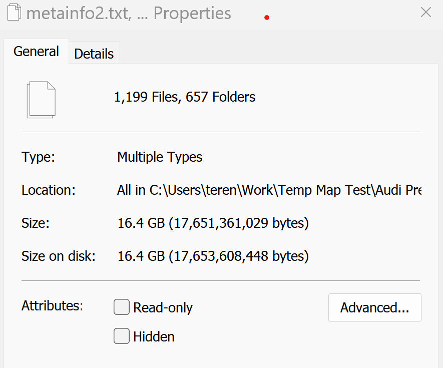

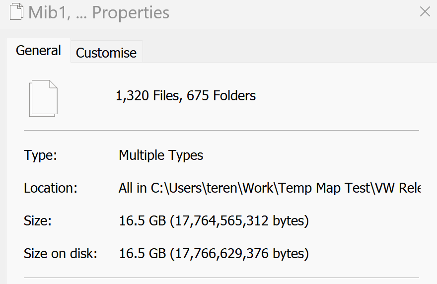

Applying the scientific method here 🤫. The VW link unzipped fine using this link
https://vw-maps-cdn.lighthouselabs.eu/vw-maps/P370_N60S5MIBH3_EU.7z
I took MartiniB's first one editing 370 in.
VW unzipped:
Audi unzipped total with the Russian additional files removed:
It's grown from the Audi release. Given the Audi one was signed and loaded up fine our Russian comrades could not have fiddled with the directories so it's a new regenerated release. Doing a spot check on the file dates the Audi release shows 22/02/23. These 14/07/23 that’s found in

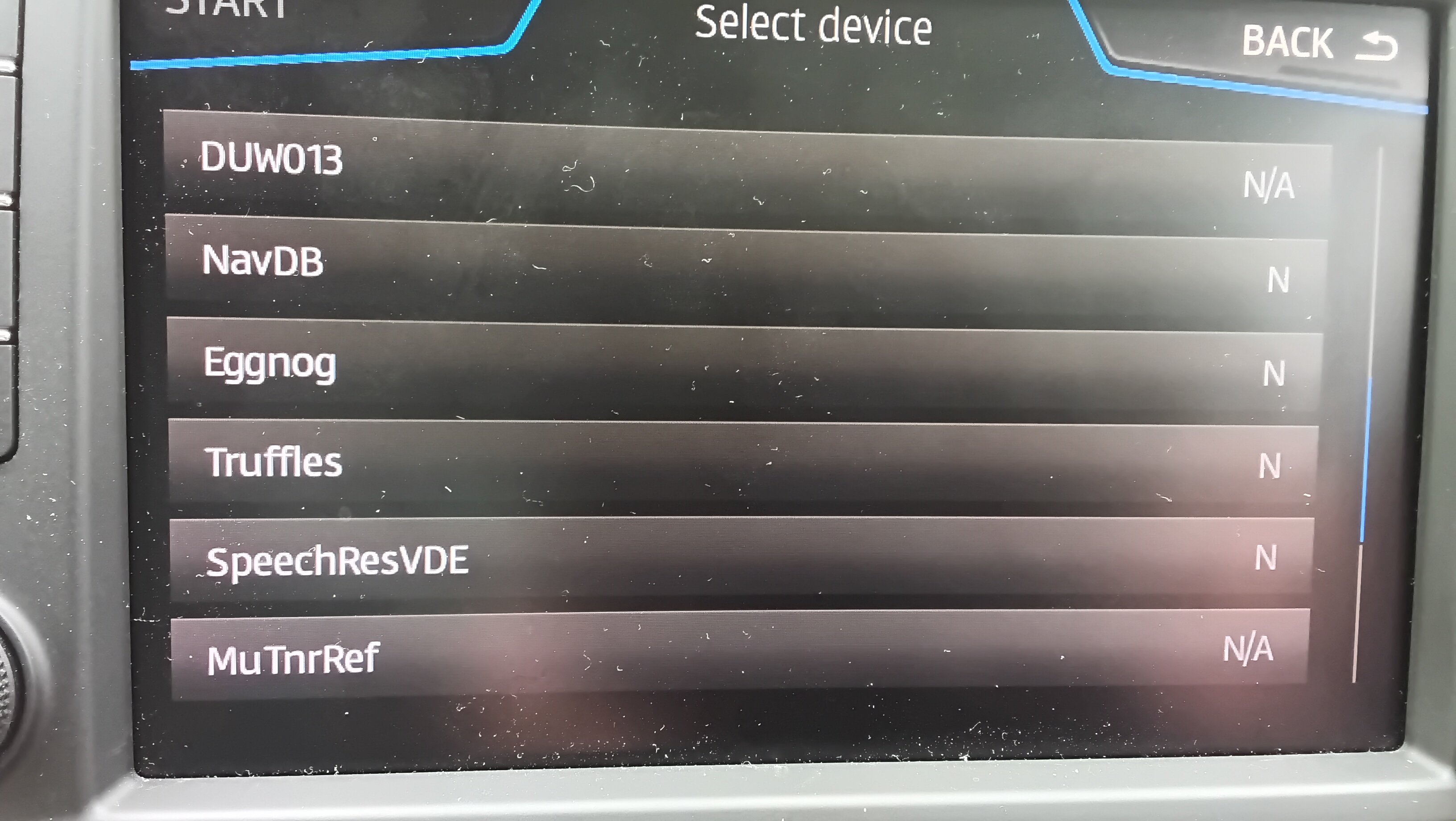

OK it tells me there is no work to do. That is to say each of the entities in the previous 370 release are the same as this. That's to say the VW mib2 high only release is the same as the earlier Audi 370 one.
The N means it's the same release. I took the easy option of not forcing a reload.

And lastly @MartiniB I installed over the Audi release, you have to use SWDL manual download, start and select all and start to do that.
Result success screen:
Ofcourse if you were on 350 you'd install as you normally do. Since I already had 370 installed and it had said, yes you got it, for the hell of it and to respond to a question about whether 3D mapping was still in it, yes it is. Failed comparison someone had done between the combined normal mib1/2 high files as the mib2 high only one.

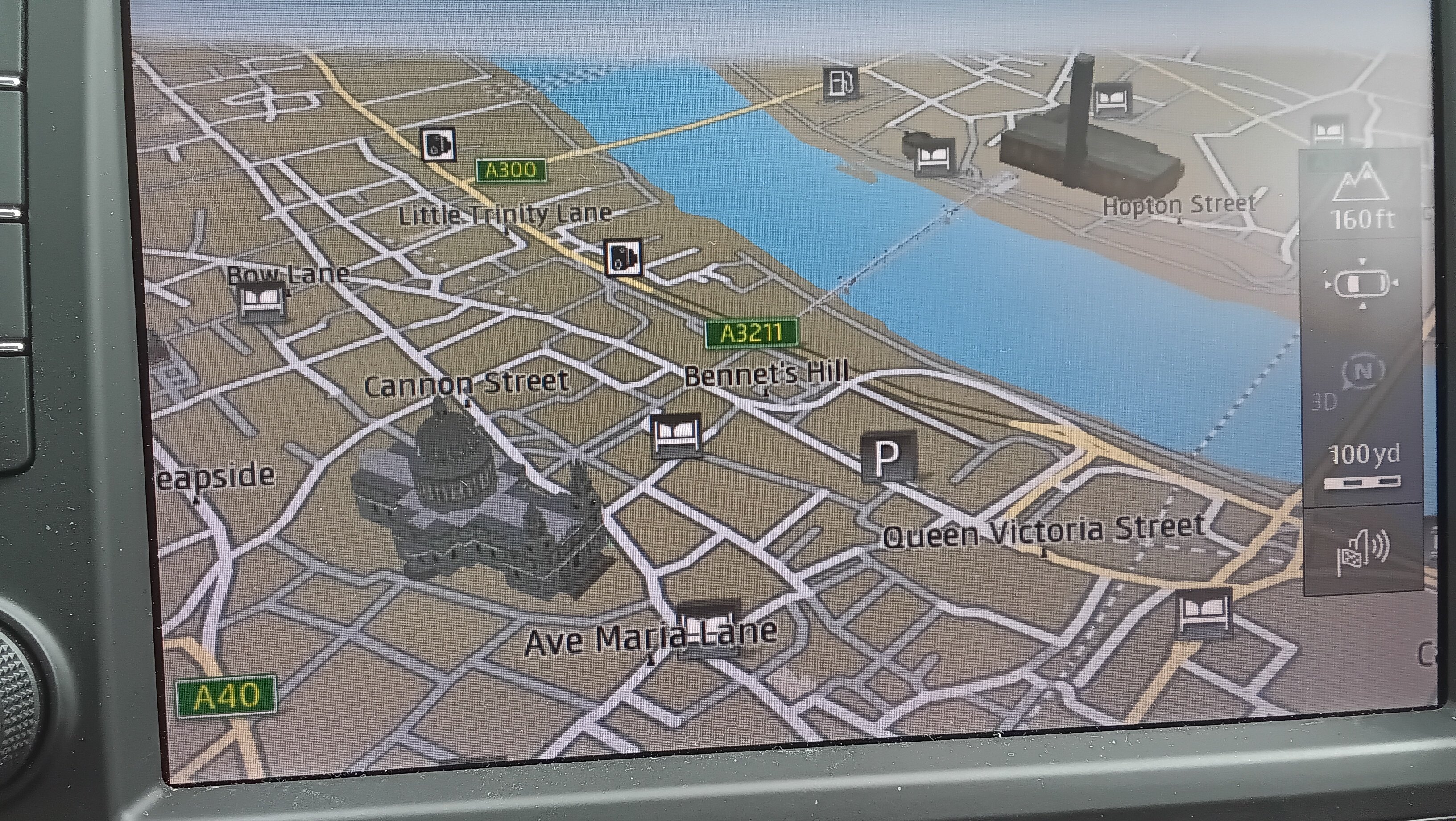

You want it on auto zoom. You have probably toggled it off or it's come up that way. Auto zoom is when a box is drawn around the button that shows in your case metrics or imperial in the UK.
This is the Seat version of the mib2 layout. In this case you see 100yd with that ruler marking. Tap that box. It causes auto zoom to go on. Box round it, its in, no box it's off.
Reckon that's it. Auto zoom and it should work fine. I've been using the Audi version of 370 for several months. My real test is Tuesday. But I reckon that's your issue.
Normally. Set destination then tap to auto zoom. I always use 3D and the split screen on. Off in this photo.
Hmm think you meant mib2 BTW. Not sure what would happen if you managed to load this file onto a mib1 high unit. You'd expect it to reject it. If that's the issue you'd have to use SWDL to force the old 350 into the unit.
BTW you don't need to drive around to test auto zoom. You can put the unit into demo mode, under advanced setting or similar name. Select a destination and it will start a demonstration mock drive if it's a mib2 high atleast. It should do the zooms.

 BTW. No issues with auto zoom in this release put it in demo mode and worked fine.
