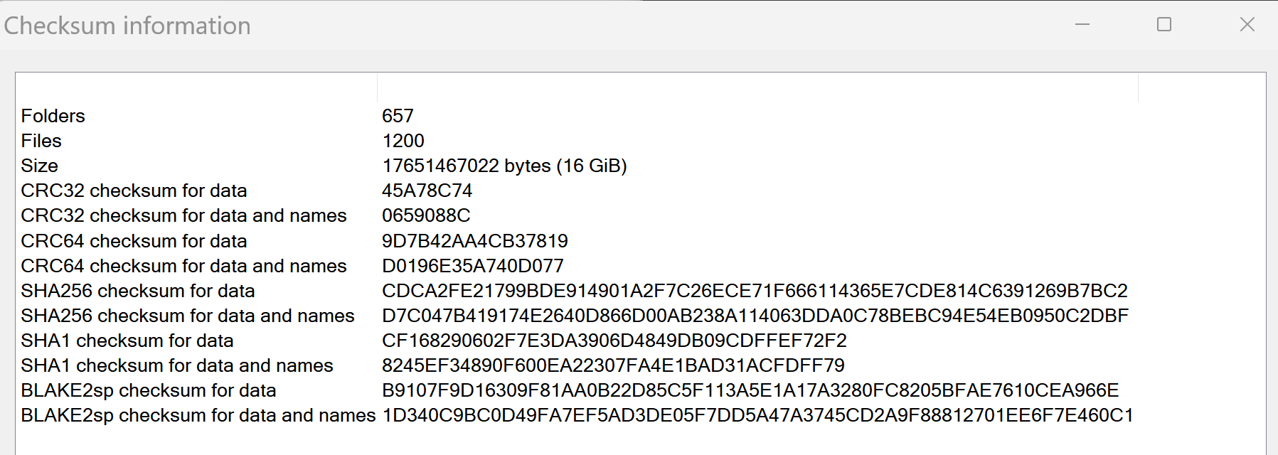

Done a comparison now of the Google Drive one and
http://map.audi-mib.ru/
If you remove the two Russian files they put in above which don't have a bearing, the contents of the files are identical with the CRC check (basically a data fingerprint check of the contents for being identical):

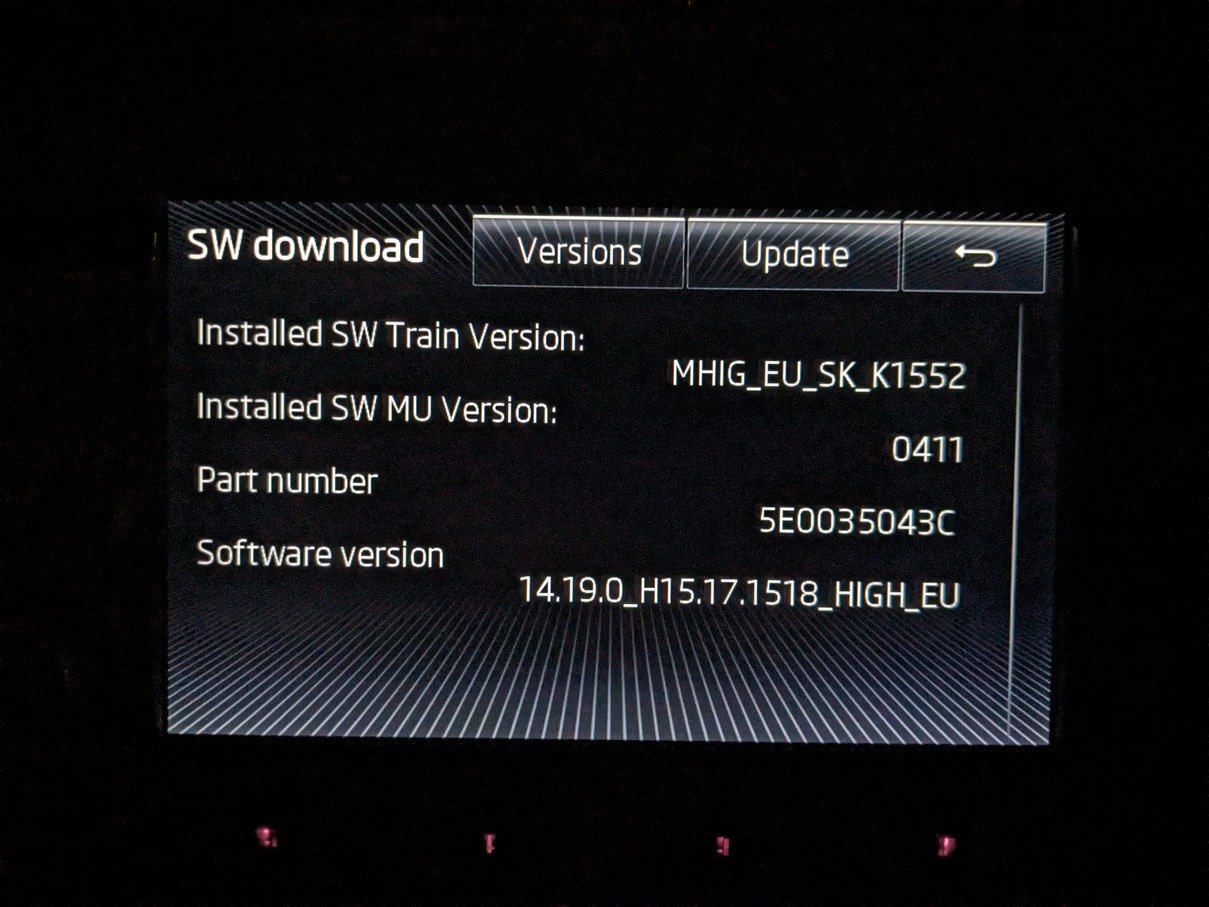

For my MIB 1 Columbus - are the maps shown on Skoda's update portal the most up to date or should I be getting them from mib-helper.com? Looking at the file names they both mention P350, so I'm hoping that means they're both the most up to date.
On the firmware side I've updated my system to 411 and fortunately no errors; I was concerned as I especially had CANTON and apparently there can be issues regarding the external amp.
I'm pleasantly surprised re: the maps. I thought VAG just stopped updating MIB1 platforms altogether a few years back. My street might actually be on the map now as opposed to a random field.
