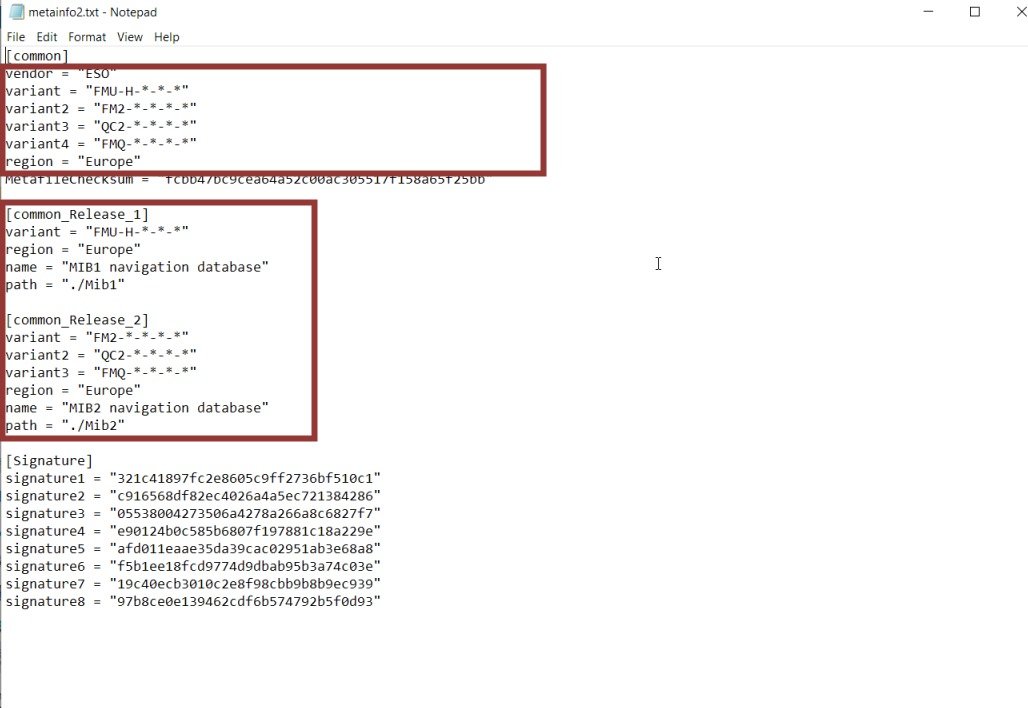

Map P390 metainfo2
1 hour ago, Island123 said:
Map P390 metainfo2
It's a programmers hash it doesn't work with mib1 high whatever the metafiles say. They took the mib1 files out. The history is mib2 high came along and they grafted that on. Specific mib2 high files are in the mib2 high directory but the common stuff is in the mib1 directory. The catch is the mib1 only specific stuff they took out of the mib1 directory. That's why the download reduced drastically in size. Audi behind their pay wall always shipped the mib2 high only download. So it's nothing new. It just came to the rest of the Vag brands six months ago as they discontinued mib1 high support.

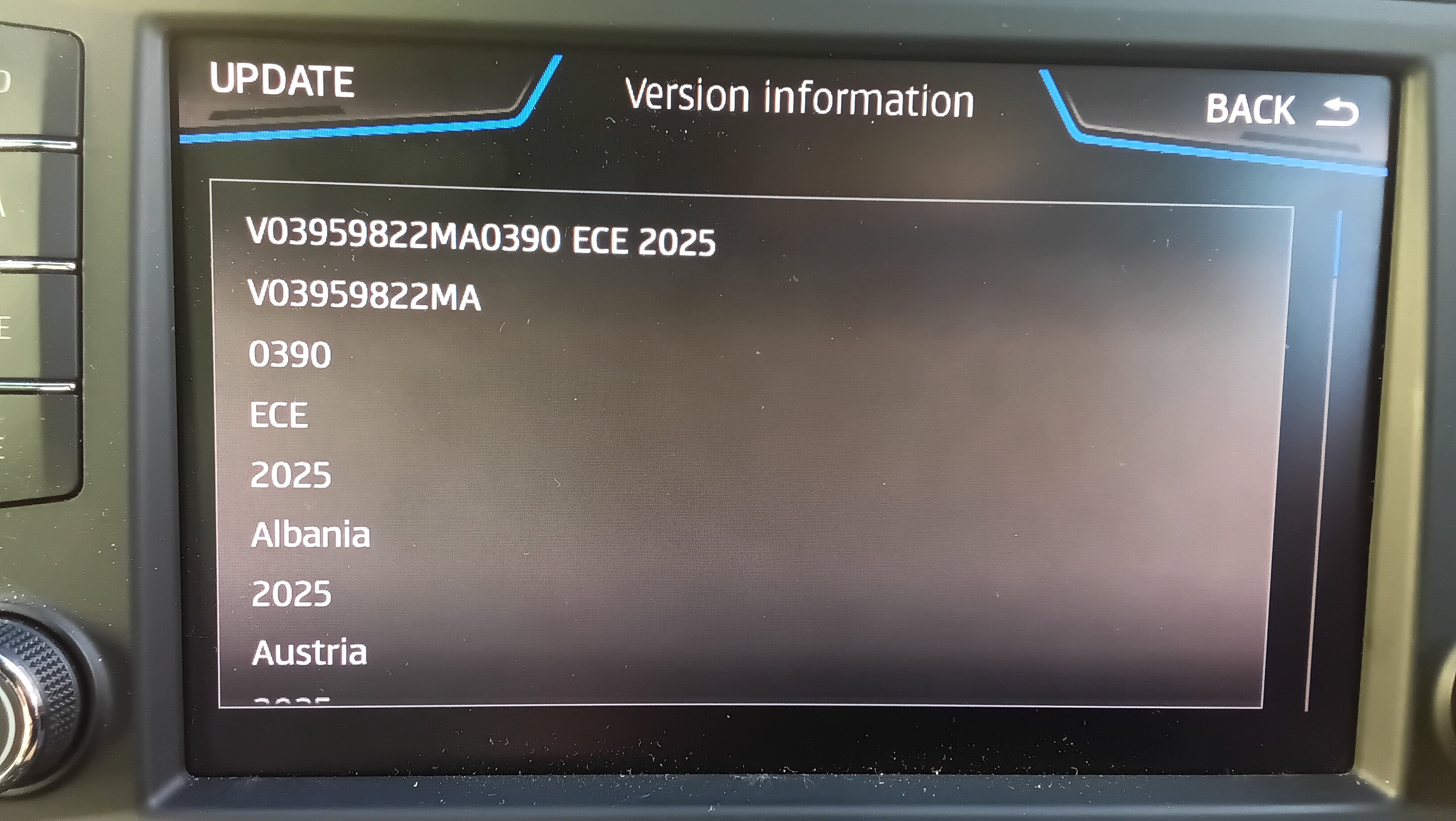

The customary success screen on a Seat mib2 high. Thanks @MartiniB for your hard work.
Maybe it's a P350 version map upgrade only option. In Volvo, there is an option to only update existing maps if they are not older than the last two update releases, only corrections are updated, not the entire map

No Vag work with a complete memory overwrite of the maps. 350 and below the VW, Skoda and Seat releases was a combined mib1 / mib2 release. Just the way they did it. From 370 mib2 high only. It all came up with the release of 370 and why it had decreased in size. Answer all the specific mib1 high files only has been taken out. We had seen it previously or rather some had, that had used the Audi version which loads happily into other mib2 high general Vag cars. Audi had always so I was told by @pcbbc released them like that. He's an Audi driver and knew about the mib2 high only releases of Audi. That practice had not happened till 370 on the other Vag brands.
What's more important is that there is no point in mib1 high drivers spending much time trying to get these files to work. They won't. The backend menu of SWDL will load them in but you'll loose your maps so have to scramble to find 350. We have been there, done that with one poster. An Aussie on the RoW release six months ago.
