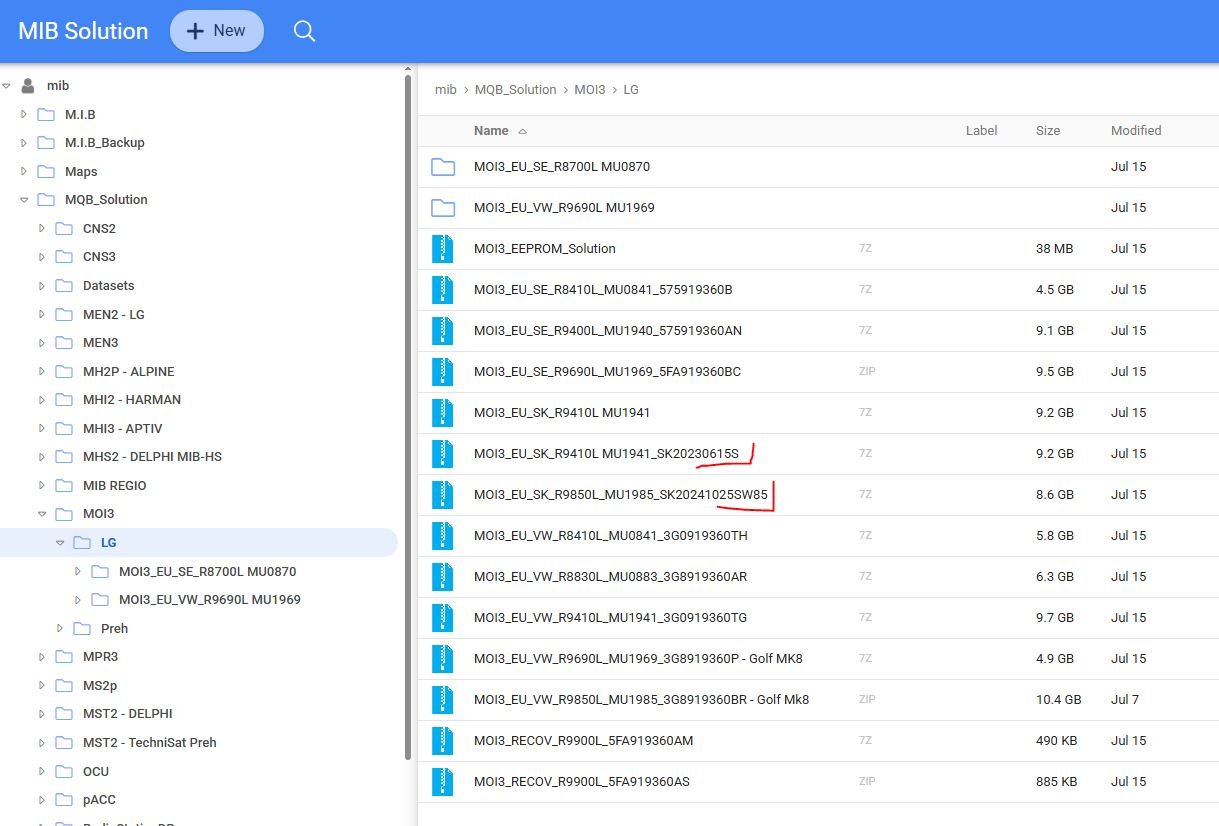

Does any one know how to download skoda 1969 software
There should be a link on here for it somewhere, search through the entire thread from the beginning
Hello,
I have bought 2020 octavia combi first edition. I live in Croatia. My current firmare version is:
Device part number: 5E3035816F
Hardware: H56
Software: 1806
Display unit hardware: H44
Display unit software: 2088
Navigation Database: 23.11
Media Codec: 3.1.4
Because I cant make myself as primary user and link car to MyŠkoda app (factory reset didn't help), I want to update firmware.
After reading this topic, i will try to update to version 1941 first. While I wait for USB-C drive, can you guys check if I have all the correct informations:
-Firmware is located on MIBsolution.one -> MQB_Solution ->MOI3 -> LG -> MOI3_EU_SK_R9410L MU1941_SK20230615S
-USB drive formatted to exFat
-car hood lifted
-not sure about the engine, because i saw both versions here in replys - 1) Only ignition turned on, lights and clima off, battery fully charged or connected to charger OR 2) engine running during update process
-wait untill everything is updated and restarted (around 30 minutes)
-factory reset and that's it.
