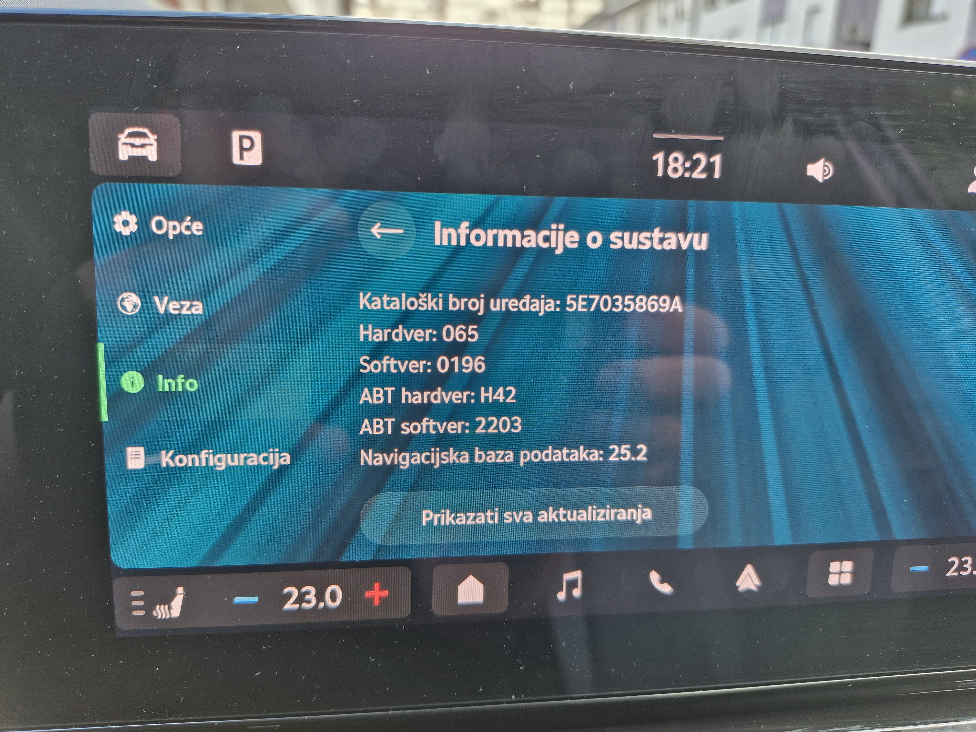

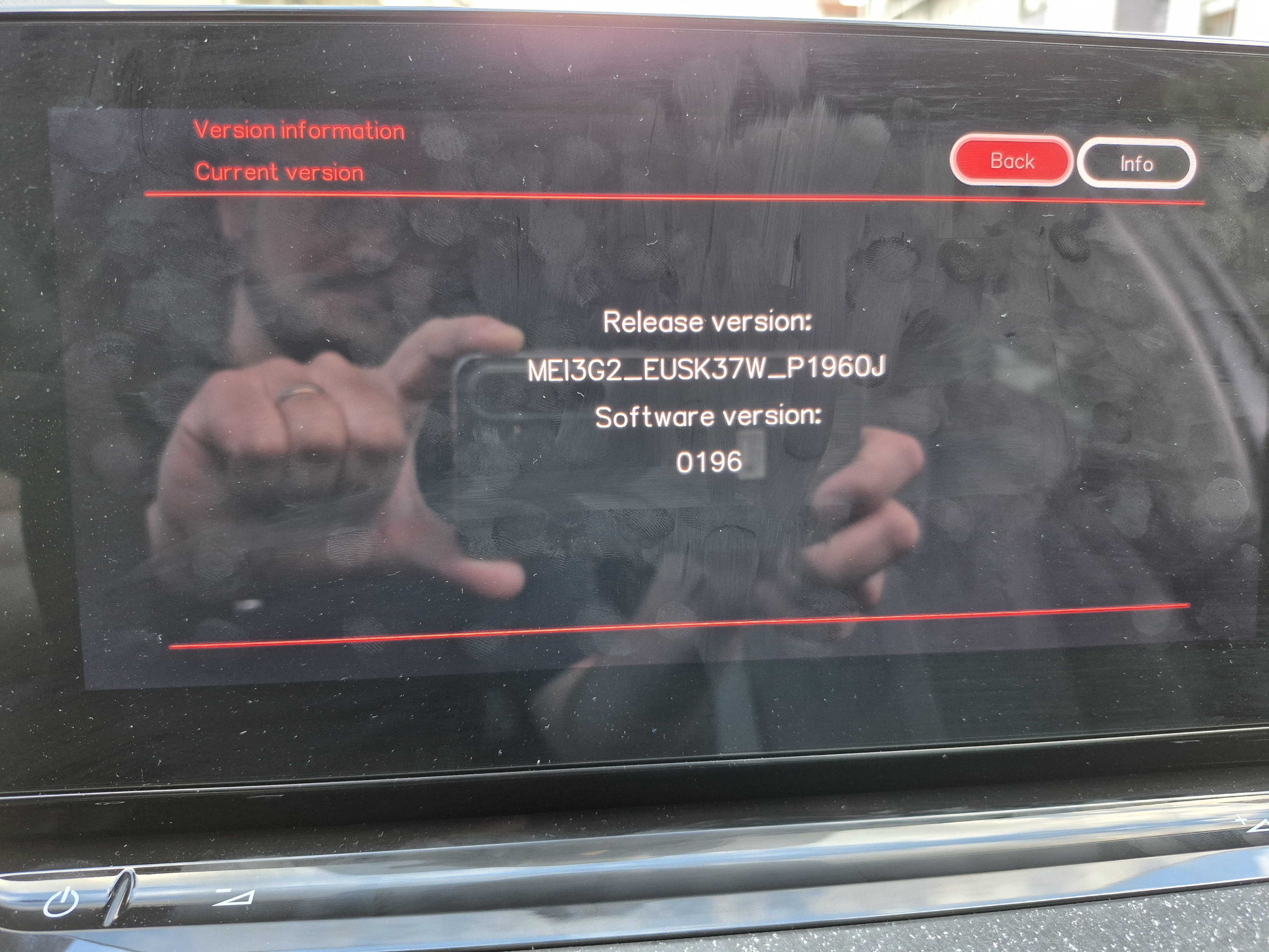

hello ! any update? is this the latest?
I've got new Octavia FL, bought it less than a month ago.
However, my sw version 0196 seems completely different than amy version mentioned here.
Does anyone know is this super old or super new version?20250519_182150.jpg20250519_181635.jpg
FL version, is having different software.. Not same as first edition of MK4 octavia.
Ok, makes sense. My infotainment is 10inch though, not the new 13inch one.

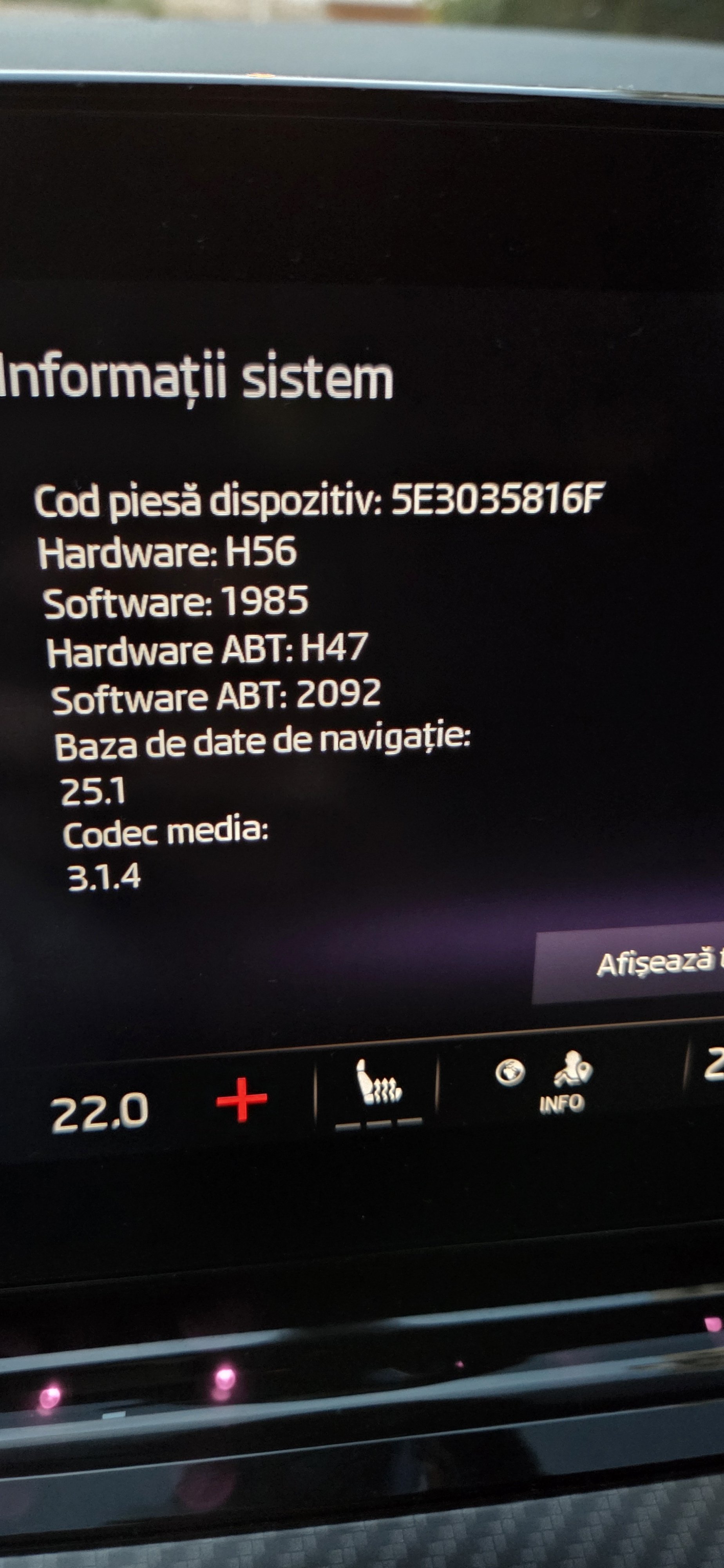

Hey there,
First-time poster here.
I'm currently looking for the package of software version 1969 (MOI3_EU_SK_R9690L).
I've seen many links shared here, but unfortunately, none of them seem to be working anymore.
I was able to find versions 1941, 1969, and 1985 on mibsolution, but the identifier for version 1969 is different (VW or SE instead of SK).
So... is there anyone here who can help me out? Or am I just too blind to find the compatible version on mibsolution?
My current plan is to update in smaller steps (1941 -> 1969 _> 1985).
My configuration is the same as shown in the picture provided by "ionbetonnn" (part number, hardware number, and also ABT).
Thanks in advance!

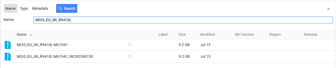

Hi everyone,
If anyone’s wondering whether it worked - yes, it did!
Here's what I did:
- Updated main software from 1804 to 1941 -> MOI3_EU_SK_R9410L
- Updated main software from 1941 to 1985 -> MOI3_EU_SK_R9850L
- Updated radio software from 1.31.48 (version after the 1985 update) to 1.31.58 -> MQB3_LGe_Europe_v1.31.58
- Everything else will update automatically when you're done -> just give it some time
My original system information:
Device part number: 5E3035816F
Hardware: H56
Software: 1804 (now: 1985)
ABT hardware: H47
ABT software: 2092
Navigation database: 20.7 (now: 25.8 -> will update automatically from now on)
Media codec: 3.1.4
Radio database: 1.30.24 (now: 1.31.58)
You can find the main software on mibsolution.
For the radio software, it’s better to check phonostar and enter your VW part number, not the Skoda one, as it won’t return results otherwise (Skoda part number: 5E3035816F -> VW part number: 3G5035820D). I found the VW part number by searching through various forums.
So far the system seems to boot faster, works more smoothly, and feels generally more stable (e.g., no sound issues with Android Auto).

Hi @Wabbelbabbel,
Few questions regarding your instruction:
1) Which exactly files you used for updating to 1941 version because I found two files for this version on mibsolution:
2) Where exactly did you find VW part number related to your Skoda part number for radio software? Because I couldn't find anything similar (my Skoda part number - 5E3035816G).
Thank you for your help in advance!

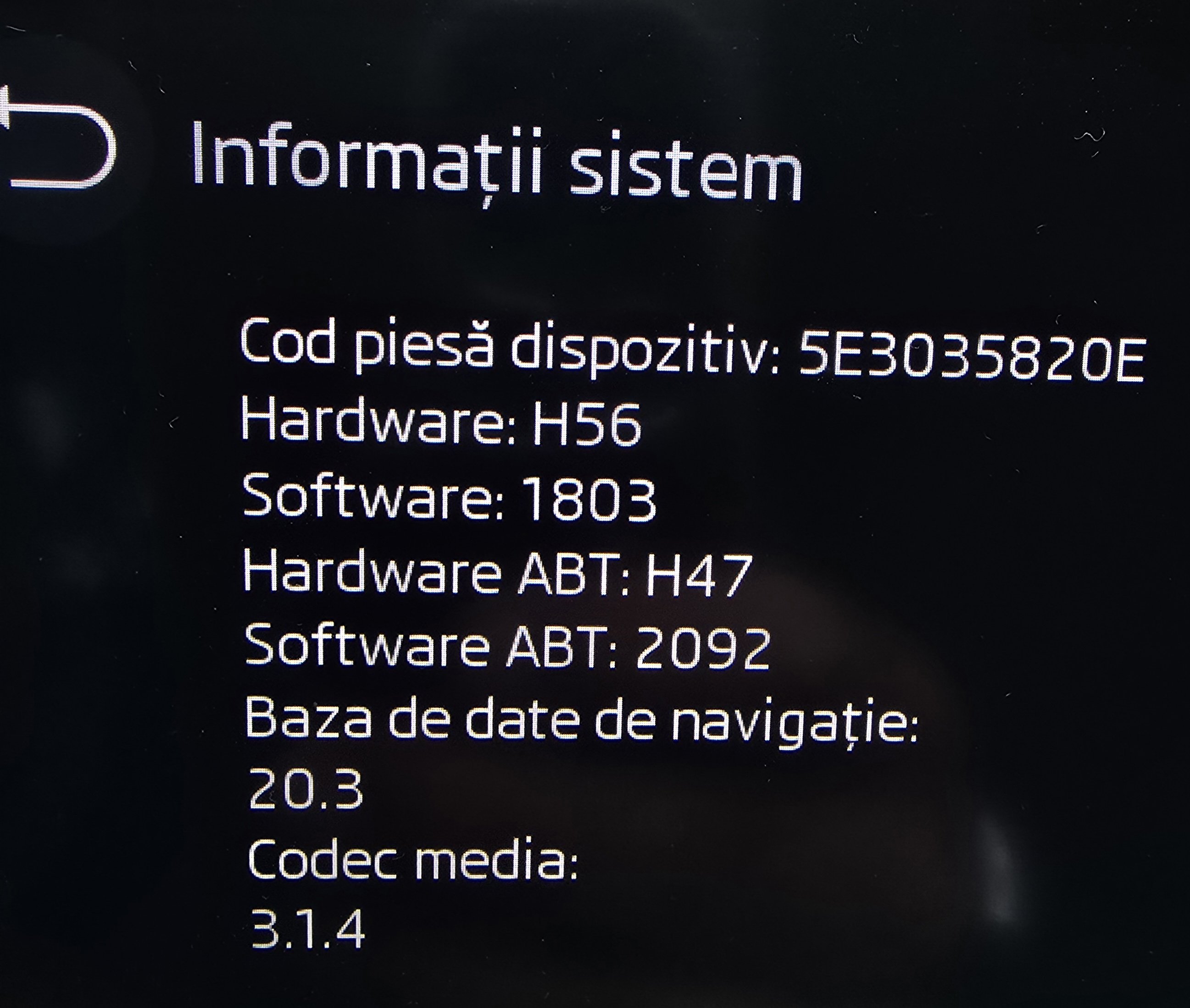

Hello my friends! Can you help me updating the firmware for my unit?
What is step by step the order for uodates!
Are THIS VERSIONS good for my unit?
For this version, I do it in two steps: 1803->1941->1989.
1. Download both files, unzip them on your computer.
2. Copy the contents of 1941 to a flash drive (preferably a good, branded USB-C) to the root directory.
3. Insert the flash drive into the USB-C port.
4. Open/tilt the hood.
5. Start the engine (it's best not to drain the battery).
6. Hold down the Menu button until the tablet enters service mode.
7. Select "Update" and select the USB-C port where the flash drive is (it will be highlighted).
8. Select "Install."
9. Wait, wait, wait - 2-3 restarts and it's done. The whole process takes about 15-20 minutes.
10. After a while, an additional fix will probably be released via OTA.
11. Repeat the procedure with the 1989 file.
12. Enjoy the new software. ;)
If you need more information or help, send me a private message.
