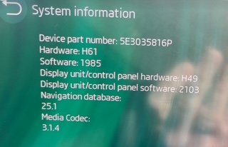

Had ours updated to 1941 last year at the dealer. Recently noticed it’s OTA updated to 1985 on our 2024 and touch wood other than car play being it’s normal hit and miss self all previous glitches etc. seem to be resolved

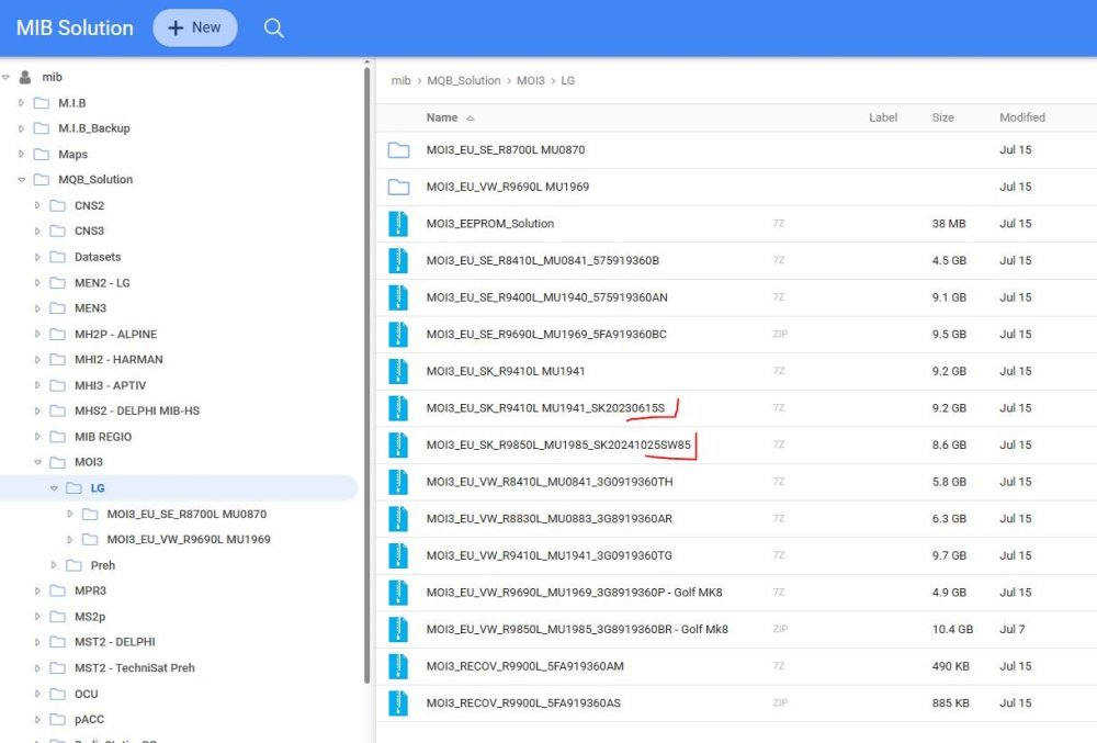

I currently have version 1668 installed and want to update it to the latest possible version. However, I understand that in order to update to the newest version, I first need to install version 1896. Unfortunately, I haven't been able to find this version anywhere.
Could you please share a link where I can download version 1896?
Is it possible to reinstall 1985 ? mine is very buggy and i am getting an error on my OBD11, error U105400

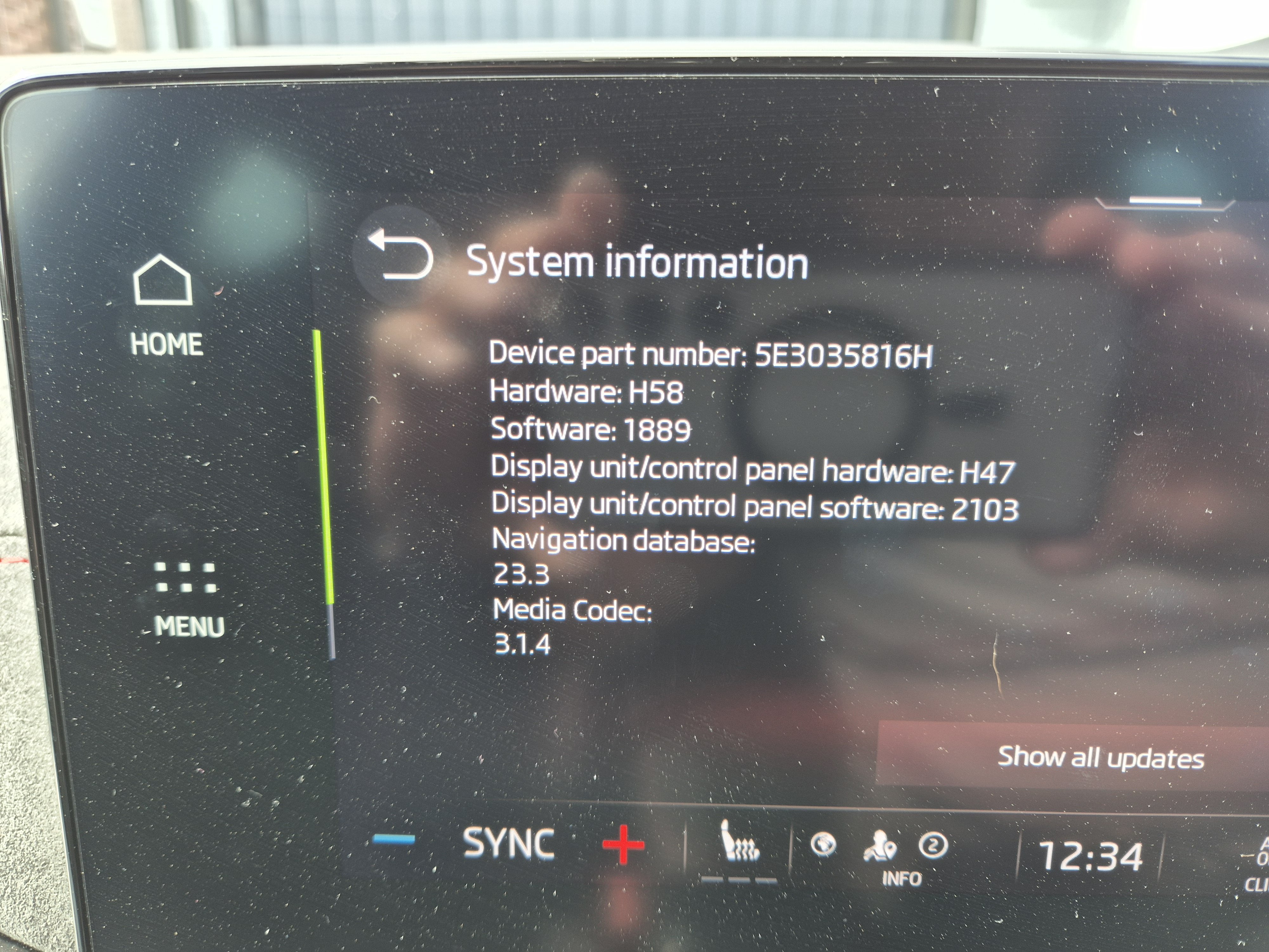

As a newbie only recently becoming the proud owner of a 2022 vRS a couple of weeks ago, I've already experienced a spell of endless re-booting so I have been reading this thread with interest. Some of the earlier links to updates are dead now but I have downloaded 1941 and 1985. Checking my settings I am on update 1889 so my question is, can I go straight to 1985 or are there recommended intermediate jumps to follow please.
Thanks in advance,
Kevin
for peace of mind do it in two steps: 1941->1985.

Well I'm now on 1985 thanks to the advice on here. If I get any more problems I know it wont be down the that now and will be more determined with the dealer next time.

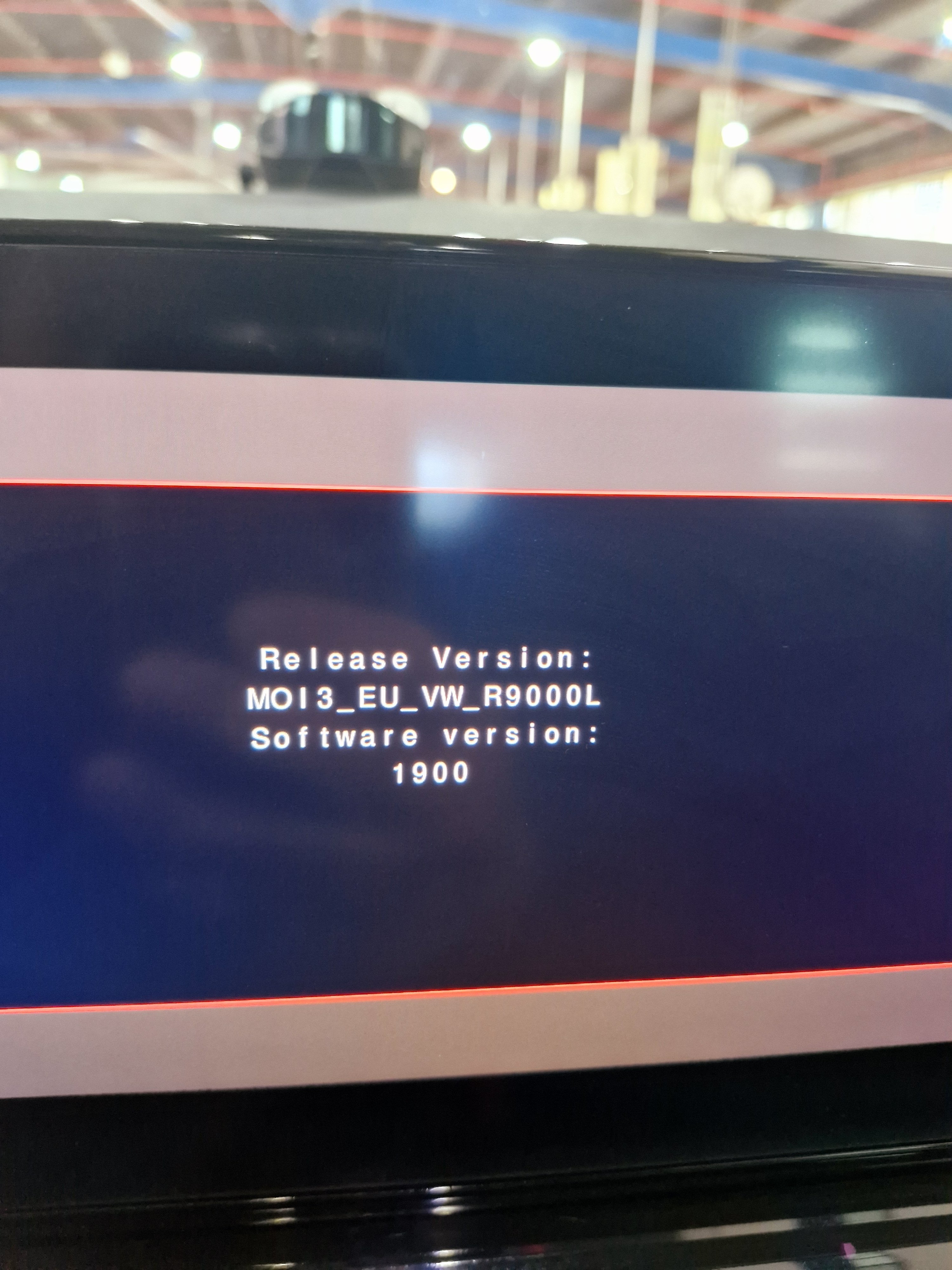

Hello everyone,
I'm new here but I read everything you all wrote and I appreciate your help.
It seems that the software I have installed actually belongs to VW. Can I still perform the software update?
