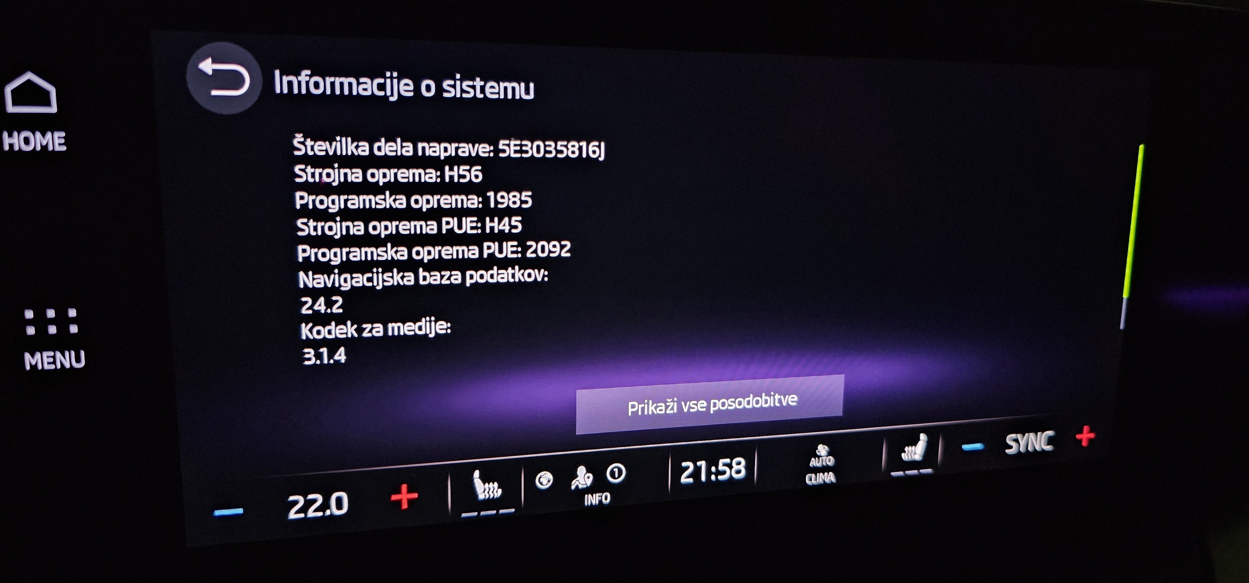

Well i see that already 1985 is out :)
36 minutes ago, vran22 said:
I had issues that volume was going to max by itself, turning on and off. Turning radio while car was locked etc. And also bad touch response.
ah fair.  i wonder if 1985 will come to AUS. i dont see any change logs posted yet.
1985? What are the improvements?
Spotify, Tidal, contacts etc. in fullscreen, some say it's smoother and faster

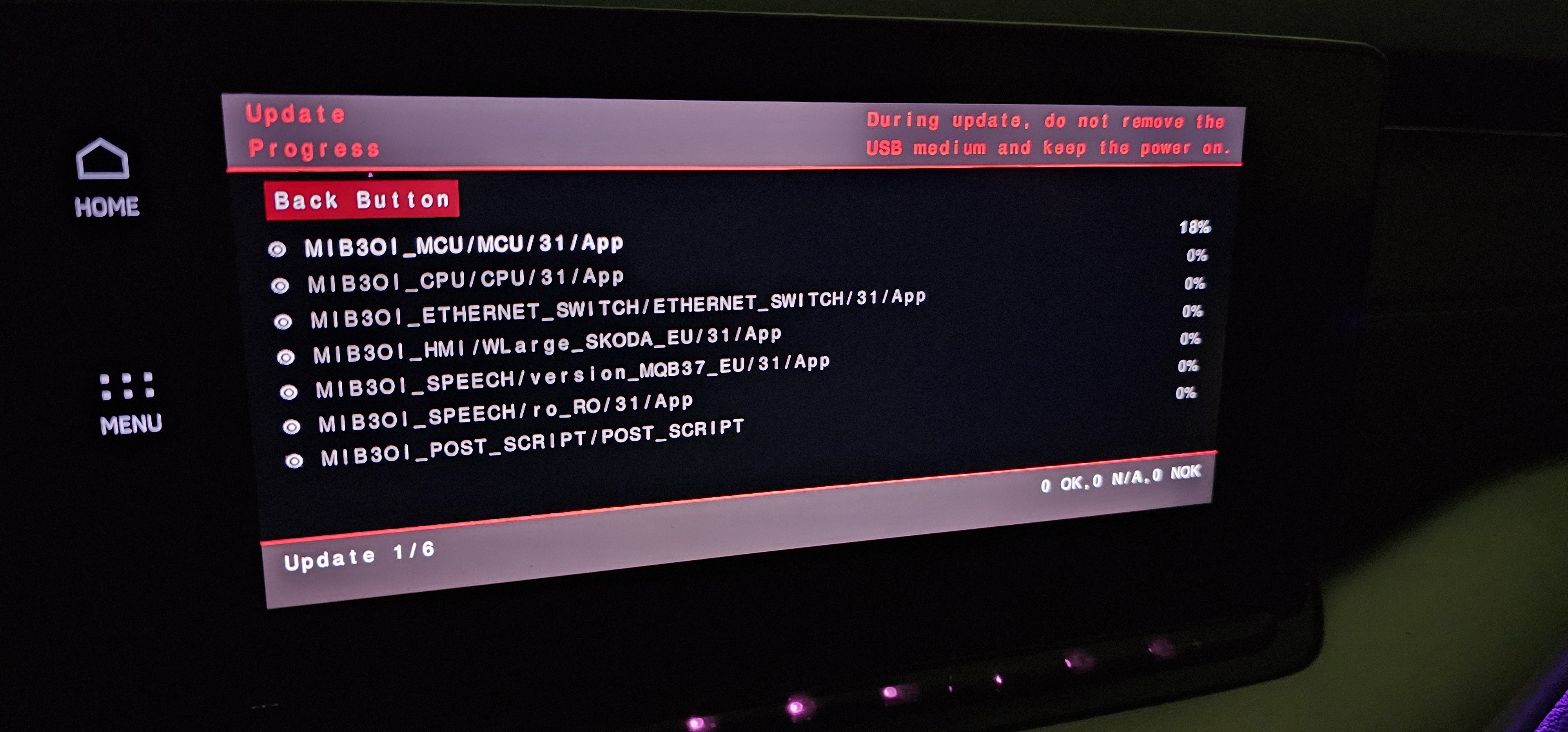

How do you do the update?
No problem as usual..
Anyone got a step by step guide to updating yourself?
1. you need a good, branded USB-C pendrive (I do not recommend adapters)
2. format it in exFat
3. unzip the downloaded file on your computer and only then copy the contents (two folders) to the root directory of the pendrive
4. open/tilt the car hood
5. turn on the ignition (you can start the engine if there is a possibility of the battery being discharged)
6. insert the pendrive into the USB-C port
7. enter service mode by holding the MENU button for a few seconds
8. follow the messages
9. arm yourself with patience - if this is your first time, you can skip the coffee :)
10. 15-20 minutes of adrenaline and you're done!
https://youtu.be/9Sd6mpX3D2c
